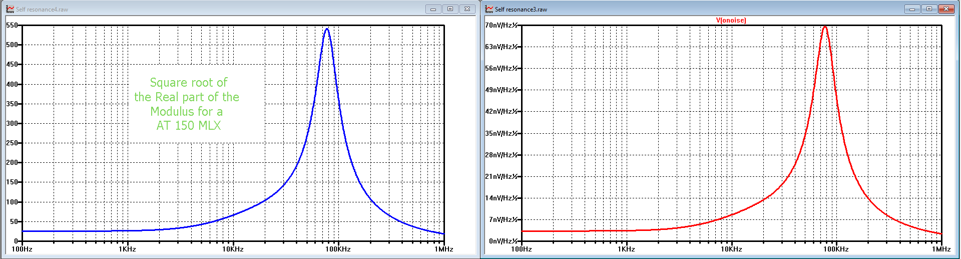

When taking the sqrt of the Re part of the modulus of the AT150 MLX (noise goes with the sqrt of R) and plotting the noise that LTSpice calculates for this very Cart, both curves are exactly the same in shape.Put another way, if the noise is not white where does the extra energy come from?
LD
The calculated noise here obviously follows the thermal noise math.

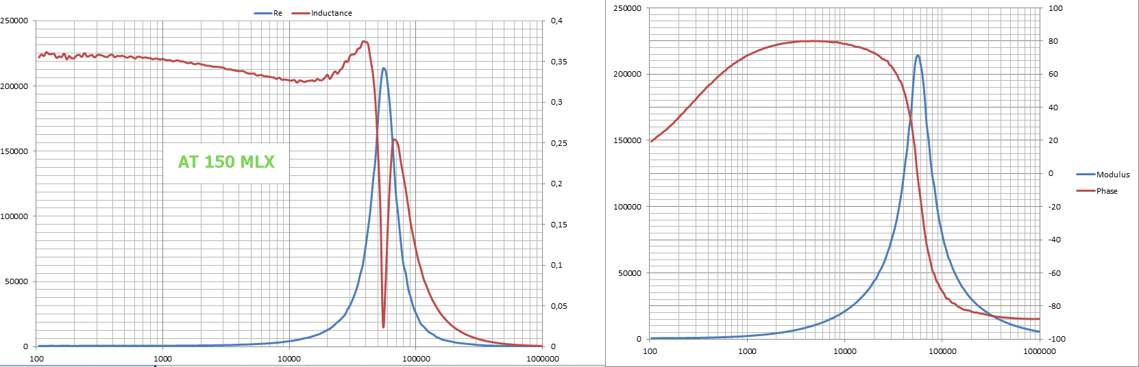

After having played with several set-ups, I finally chose for the most simple one.
I have a programmable USB scope, a Picotec 5243B, with built in function generator.
With an input impedance of 14pF//1Meg, a frequency range up to 100Mhz resulting in 100uV input noise (or 10nVRtHz), applying 5mV to the Cart means a S/N ratio of 34dB.
Originally my plan was to insert an amp in between with a lower noise contribution, but results are good enough to calculate the replacement cicuits.
See first image below.

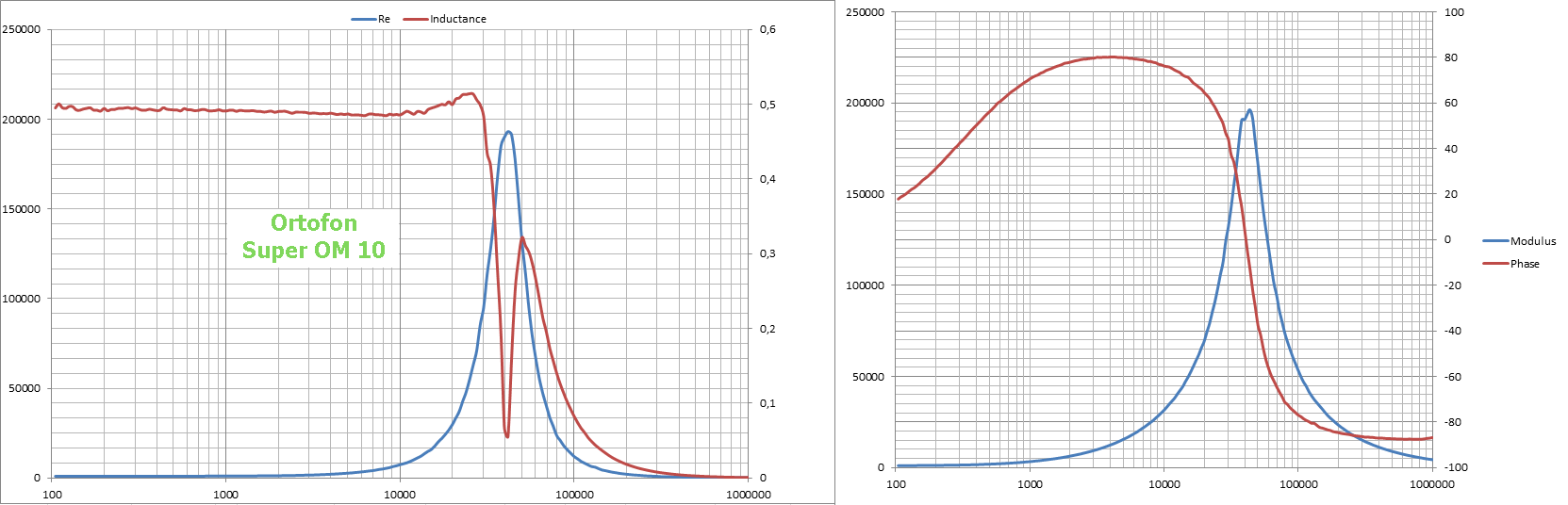

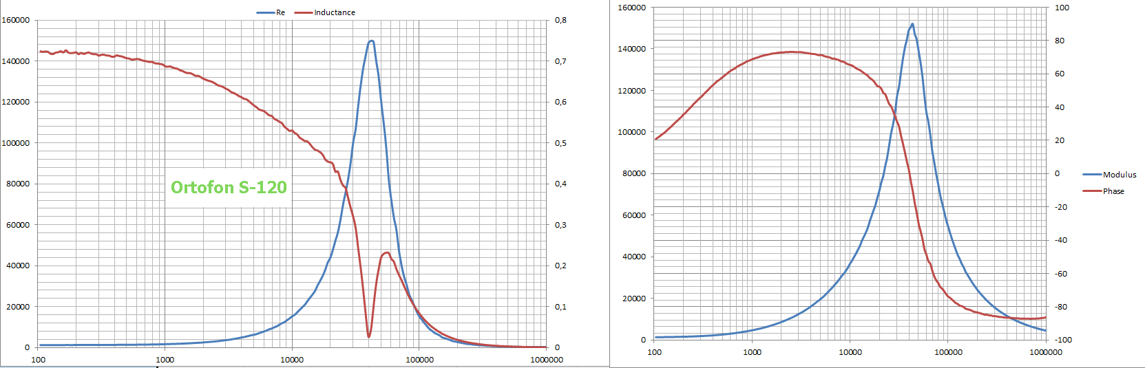

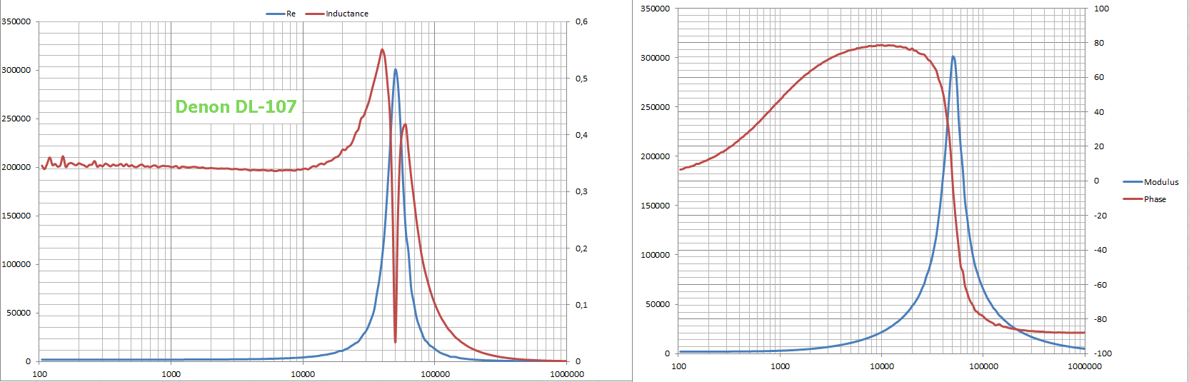

From the measured bode diagrams, I extracted the Cart's modulus and phase. From modulus and phase, I calculated the Imaginary and the Real value and the inductance.
Measured results from the 5 Carts that Bill made available are in the second to sixth image.

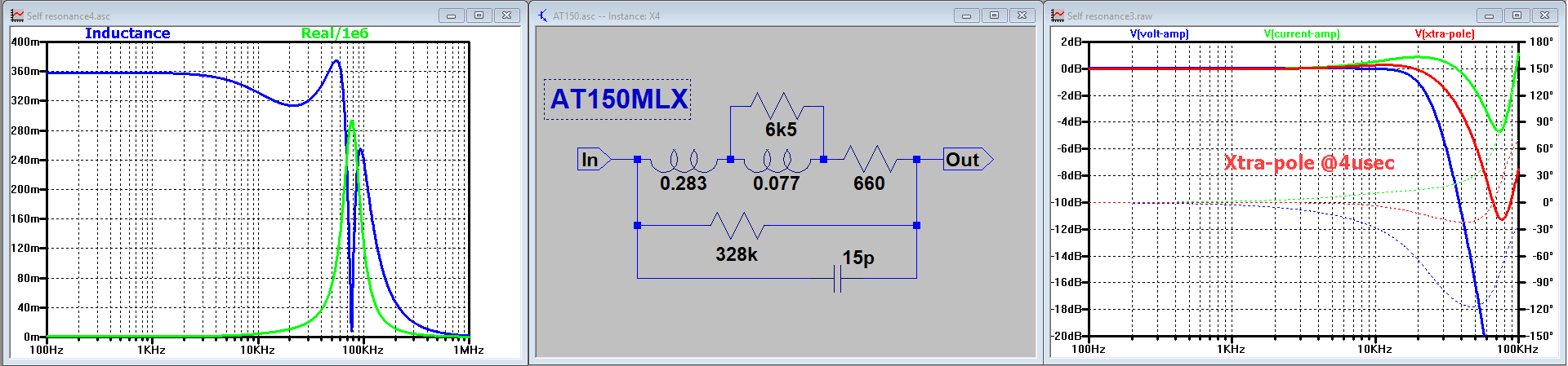

Next step is to get the Cart's replacement circuit using LTSpice, still with the scope's 14pF//1Meg in place till perfectly matching the measured results.
Once found, I remove the 14pF//1Meg from the sim to finally get the exact inductance and transfer curves.
See the seventh image, in this case for the final AT 150 MLX, the other 4 Carts soon to follow.

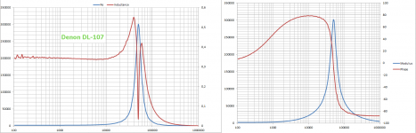

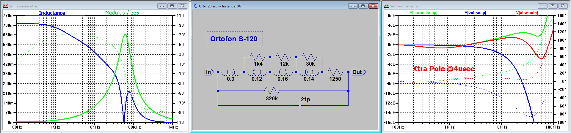

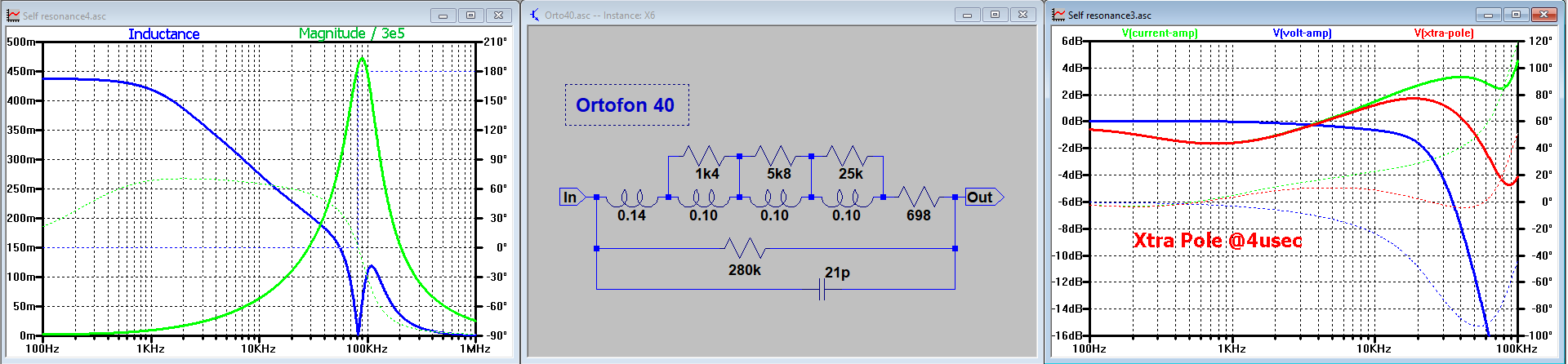

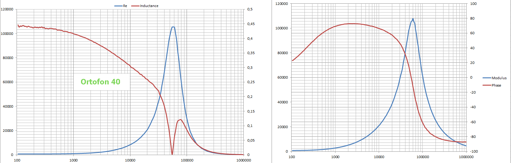

Now the results for the Ortofon 40 and the Ortofon S-120.
Quite obvious, while trying to find the replacement circuit, was that a single split coil model is too simple.
In this case I have split the coil in 4 pieces to give satisfiable results.
The effect on the FR becomes quite clear, for both types of preamps.
Tomorrow I will redo the AT150MLX, now with more coil splits, letting the inductance roll off to start a bit earlier.
Hans
Hans
I would note that the S-120 was never intended by Ortofon to give output much above 18kHz. I have it (LD fault) as a potential mono cartridge and also for it's tracking ability, at least at LF where it is superb. With a chunky DJ high output winding I would expect it to be the least tameable. I may end up pleasantly suprised!

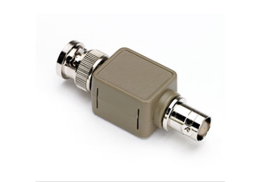

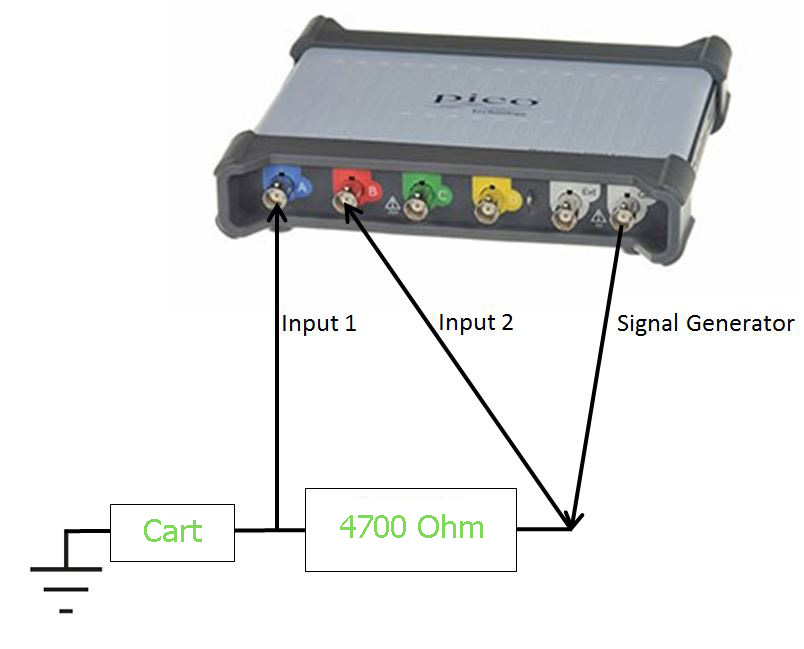

Thanks for your suggestions.You may be able to improve the SNR with an attenuation network on the output so you can run the Picoscope at near full level. Possibly a 50 Ohm resistor in series with a 5 Ohm resistor (or .5 Ohm for around 40 dB of attenuation. Then the noise in the source (its not that great) will be reduced with the signal. you could also use a stereo head amp to boost the measured signals going back to the Picoscope. If its nonflat the difference will still be accurate as long as the channels track.
The signal in the Picoscope is digitally generated.
For low levels it only has a few steps with awful quantisation noise.
For that reason I have a -20db and a -40dB attenuator to insert in the line, see image below. But then there is still the 100uV noise from the input itself.
I turned out that -20dB attenuation from the signal generator was enough when using 300mV pk-pk @ -70dB noise, more attenuation did not bring an advantage.
This gives ca. 10mV eff on the Cart with ca. 40dB S/N. With the 4k7 resistor in series, current through the Cart is still a very low 2uA max.
Hans

Just stumbled across a whole different issue.
When working on the Super OM10, I didn't understand the large difference in Inductance that George recently measured of 580mH versus my measurements of slightly under 500mH
That's why I experimented measuring with different voltages, and indeed above 10mV on the cart, Inductance ramps up quite rapidly and even more noticeable, inductance versus frequency gets a different shape.
In the other direction from 10mv I can go to 2mV, a factor 5, with no measurable changes.
The other Carts have more stable properties.
Just wanted to let you know.

Bill,Hans, very interesting as the superOM is rated at 4mV for 5cm/s output, so 10mV is not impossible. The S120 is rated at 10mV for the same stimulus
10mV is still fine, I'm talking of voltages 5 times as much or even more where inductance is ramping up rapidly.
