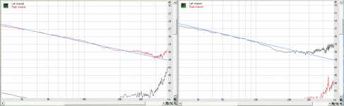

Thankd for your .wav file and see it attached below processed by RMAA.
Very different from what I have, and deviation from the red line already starts at 20kHz ??
I wonder how that can be.

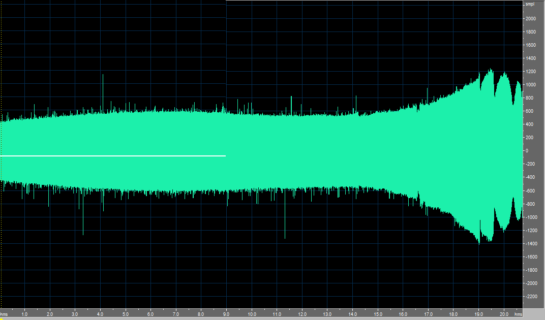

Yeah I agree, I came to the same result.Hans you can read it right off of the scale on the right, peak 1250 codes min 480 codes (approximately) 8.3dB difference.
It might not be the best LP on the world, but why can there be such a huge difference with my recording, it's a total mystery to me.

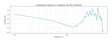

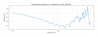

Hmm. I took the phono stage down to ~150pF, but I need to verify that. At any rate, same setting I used on the first 1-50kHz sweep with the P100CMK4. Since that sweep I did change the XLR to mini XLR on my arm cable, as I converted an SH-305 SUT to balanced with mini XLR.

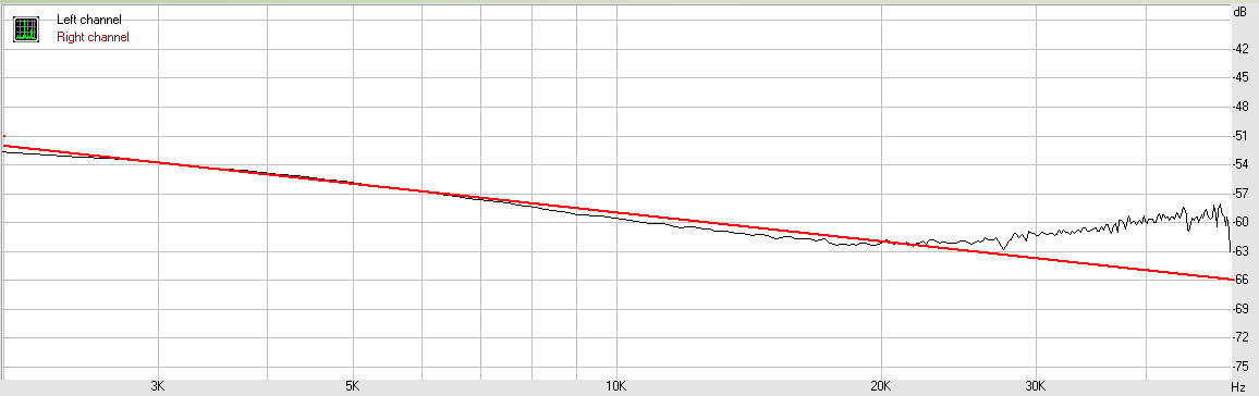

JP,
Here are as promised the .wav files of both channels.
Image below shows the deviation from 2kHz up to 50kHz from L (black) and R channel (red) from the straight 0dB line (blue).
It is obvious that the R channel has a flatter FR. Maybe what you showed was the L channel.
Would be interesting to see both channels from you too.
