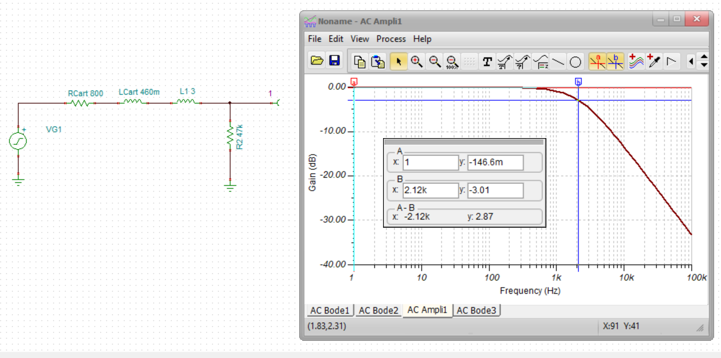

A bit oblique -- putting T5 ahead of the first stage using 47k load -- a Hammond 3H costs $14:

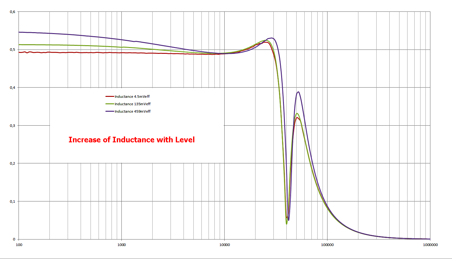

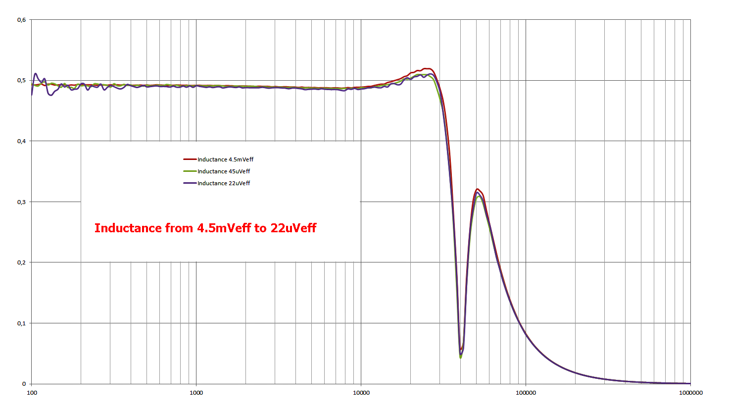

LD, no problem that you missed my posting, because in the meantime I could reduce filter bandwidth to a few Herz, giving even more detailed and accurate info.
Now I can say that I see no difference in the inductance with or without Stylus Assembly.
Below 2 images , one with Level going up from 4.5mVeff to 450mVeff , showing the increase in inductance when level goes up and a second set going down from 4.5mVeff to 22uVeff where the inductance doesn't change.
450mVeff on the Cart seems a lot, but with the 4k7 in series current max is only 80uA.
Hans

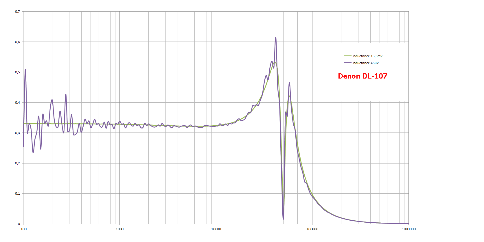

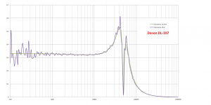

Since the Denon DL-107 Cart was quite special in its characteristics, I tested this one also, just before it goes to someone else, for the effect of level on the inductance.
Since Rc of this Cart is very large, it is noisier at 45uV as the Ortofon OM 10 with the used 4k7 in series.
A different series resistor would have given a better result, but it is quite obvious from the image below that also this Cart has a constant Inductance value from 13.5mV to 45uV, a range of almost 50dB.
This is yet another "prove" that Inductance of a Cart is independent of level within the Audio level range.
Hans
