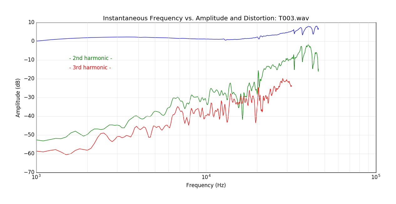

This is where I am on the plot routine, there are a couple of details (as always) I need to note. Thanks for your inputs.

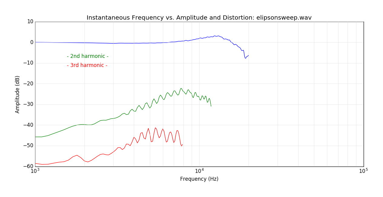

Very nice indeed. I have a sweep from my Elipson test record uploaded and it would be interesting to see how the distortion looks like with this record and cartridge (Shure V15V/JICO).
Now this is only 25 Hz - 20 kHz and the cart drops above 17 kHz with this loading so it may be less interesting for the topic of performance of cartridge in the ultrasonic region.
Dropbox - Elipson sweep.wav - Simplify your life
Pretty nice performance (left channel shown) the sweep is a lot cleaner than most. The sweep looks like ~40sec/decade so the ripples in the THD appear equally spaced and at the rotational frequency. This is interesting the other plots have noise that might mask this. I have a lot of errands to run today I might compare channels later.
BTW we have been concentrating on resonances and other high frequency misbehavior so the plots are still only ~1kHz and up, not much of interest below that.

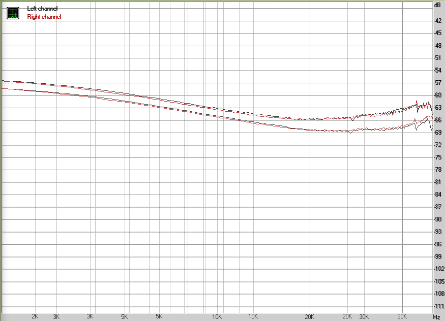

I took your 45rpm recording from 2kHz to 50kHz and compared it to your 33rpm recording from 1.5kHz to 37kHz and combined them in one image.
They should be perfectly parallel with 2.6dB in level between them because of the 1.35 higher speed.
This is roughly the case to within +/-1dB.
You can also see a few anomalies with both speeds shortly before the high end, which can only mean that they are record related.

I noticed that the distortion on the right channel was lower. I also removed everything but a small slot around from a section centered on the second harmonic and you can see the AM of the seconds at .55Hz fairly clearly.

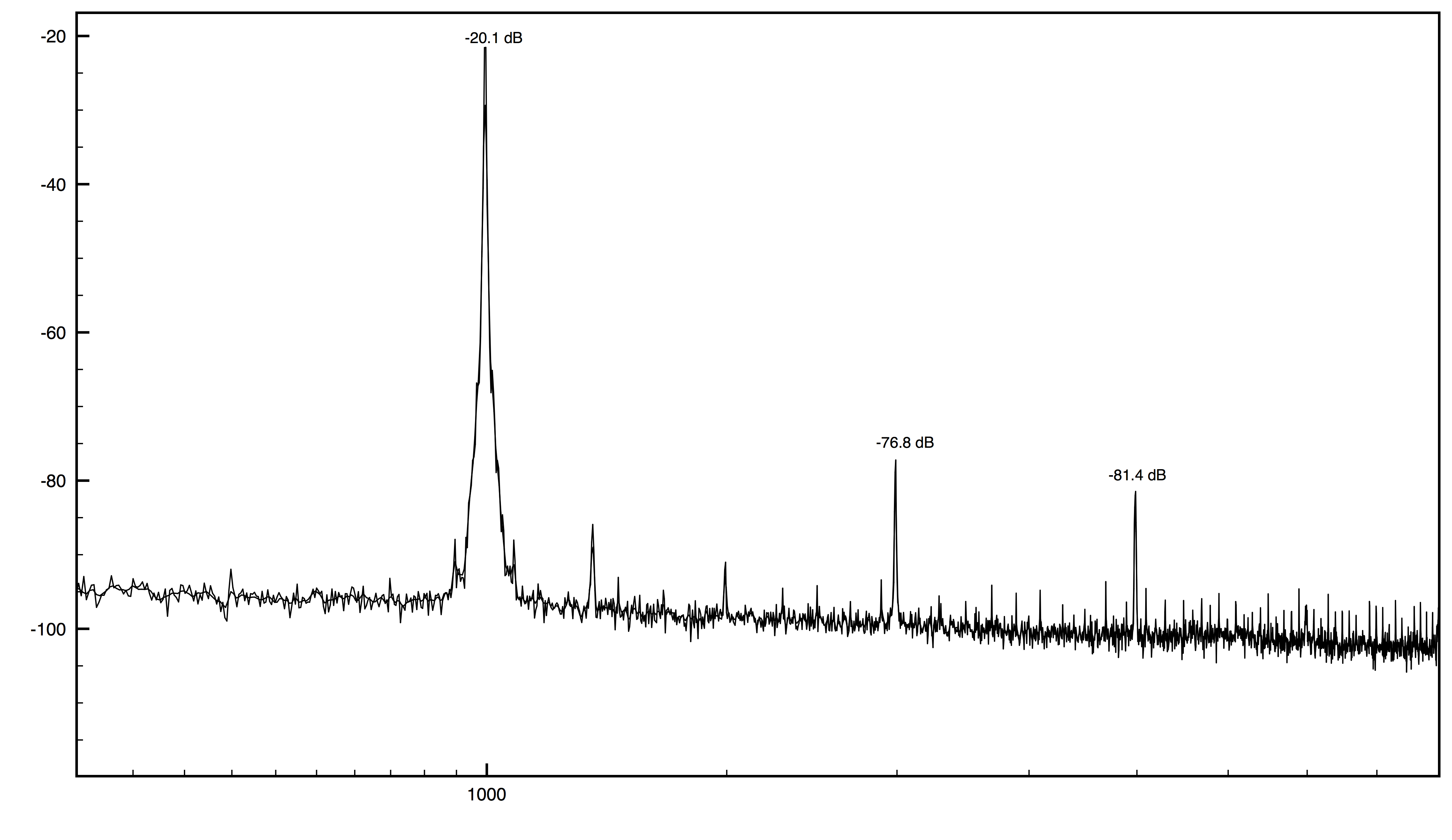

Below 2 images , one with Level going up from 4.5mVeff to 450mVeff
I think there is a wavy pattern in the fr response also in my previous graph with the Elipson (but not the Ortofon) post #1112.
What I still don't understand is the ≈ -46 dB 2nd harmonic @1000 Hz from your algorithm compared the ≈ -56 dB that I get, so I will look further into this. Third harmonic is about the same though.

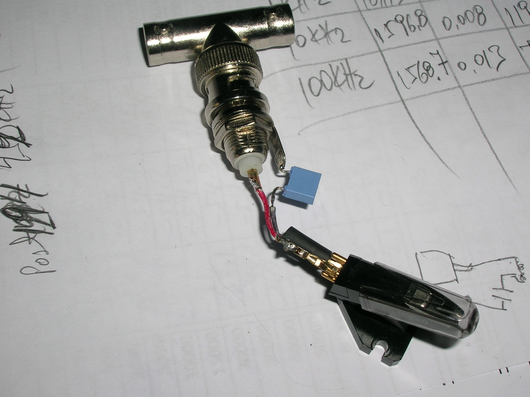

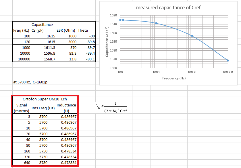

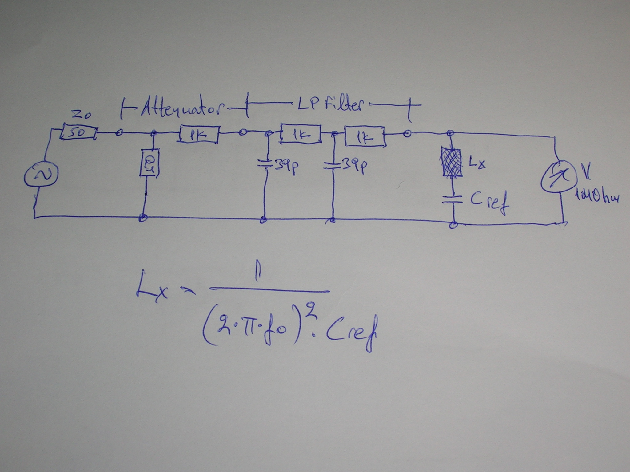

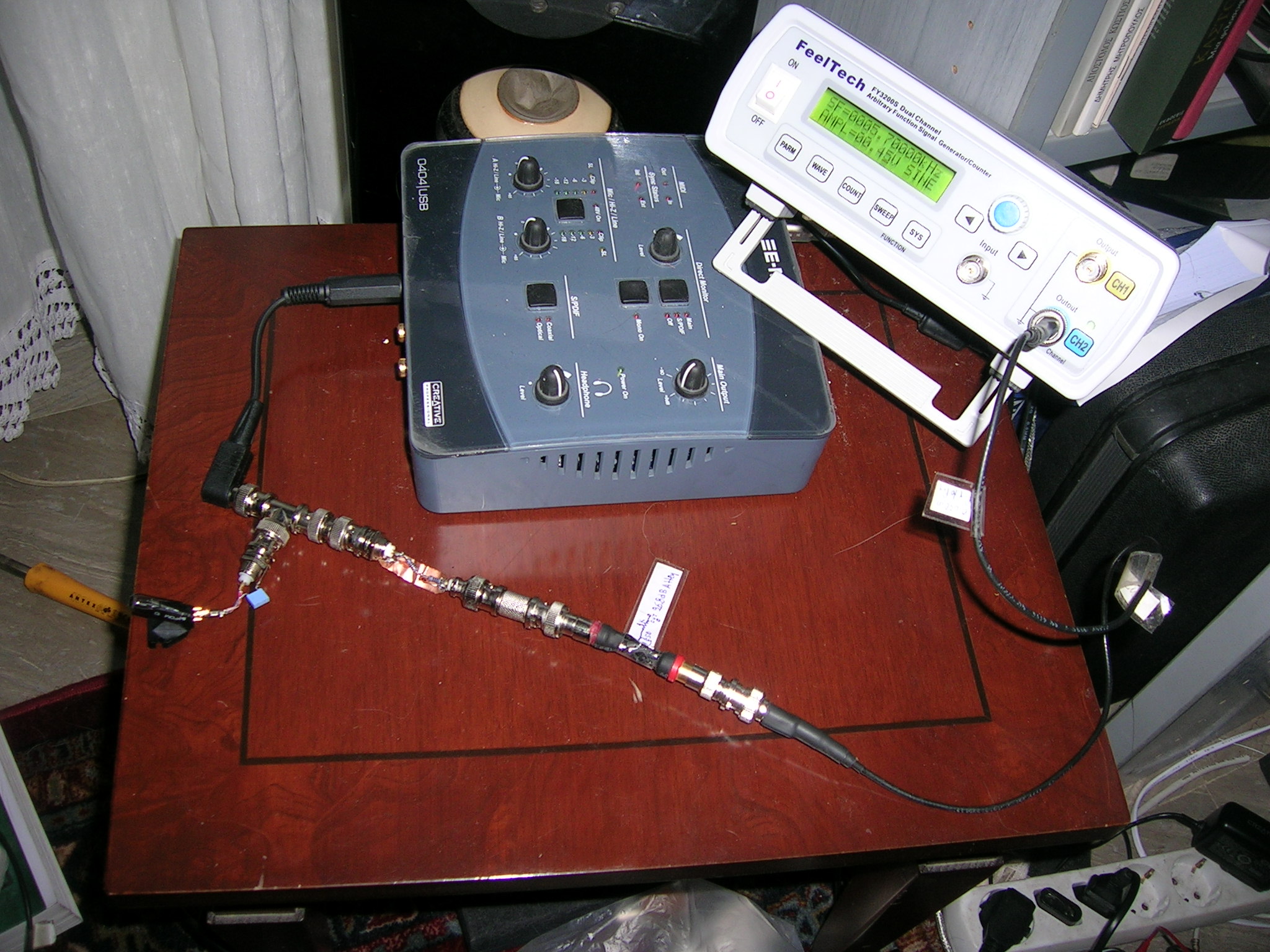

Hi George,Hi Hans
I run a test for inductance change vs signal level on the L channel of Bill’s Super OM10 using the resonance method. I don’t find any change, only a slight drop at very high signal levels.
The second and most important discrepancy when comparing your measurements on Super OM10 and mine is that I find the self resonance occurring at around 70kHz no matter how I test it, while your measurements show it at 40kHz.
What do you think can cause that much difference?
George

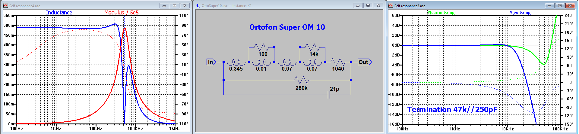

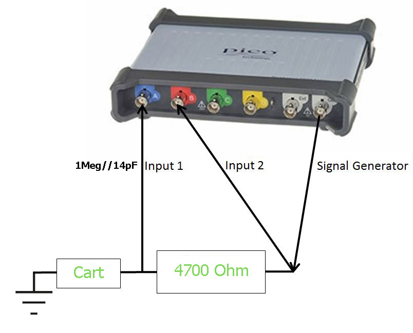

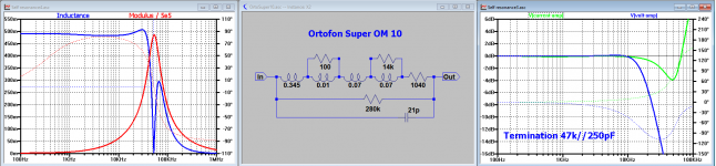

Good to know what these differences may cause.

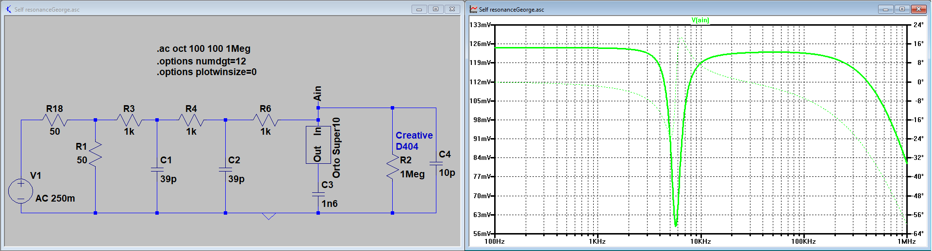

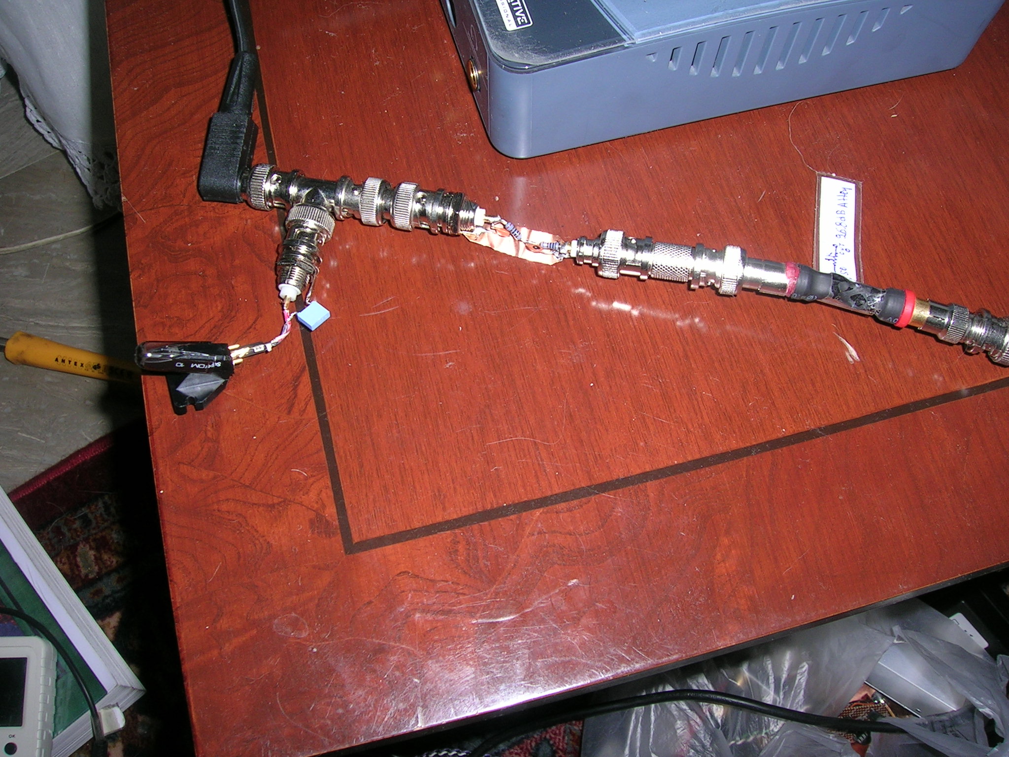

To start with Fres.
My test gear has an 1Meg//14pF input, see image below.
After having made the run from 100Hz to 1MHz, I have imitated the same magnitude and phase with LTspice still with 1Meg//14pF, thereby being able to modelling the replacement circuit.
Once LTSpice and my measurement where 100% identical, I removed the 1Meg//14pF and made the final run resulting in the picture below, showing an Fres = 53kHz.
Hans
