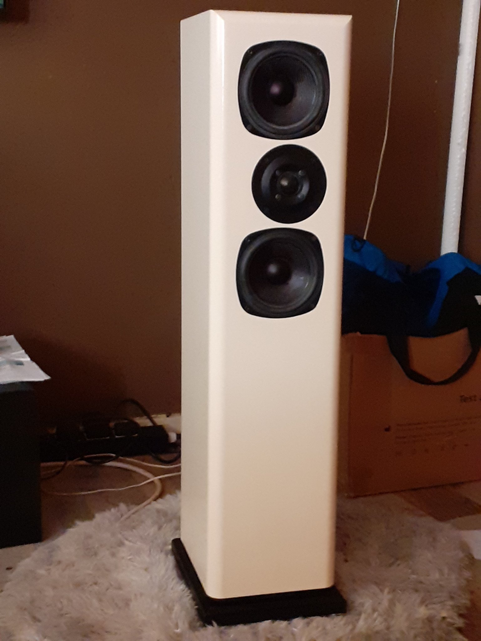

what do you think ?
The finish of the enclosure looks good.
Is your experimentation with tube length etc. over yet?
The speaker has 5" bass drivers.
The recommended minimum port size for this driver size is 2" (50 mm) in diameter.
Choose a plastic pipe with an internal diameter close to 2" and cut it up into various lengths, e.g., 50 mm; 100 mm; 200 mm etc.
Cut a hole in the base plate to suit the outside diameter of the pipe to ensure a snug fit of the pipe in the base plate.
Now experiment away until you find the length of pipe that gives the most pleasing bass response.
You would experiment with just one of the speakers of course till you find the optimum.

Thanks Dave , but , im a joiner , could you dumb it down a bit for me
Ahhh I see , you say minimum , what would be the maximum ? and would a larger diameter make any difference ?
As Dave has said, as the diameter goes up the length of the port goes up. So you are limited by what length of straight pipe you can fit vertically in the enclosure (unless you want to start folding the pipe using elbows).
For that reason, I say start experimenting with the minimum suitable diameter.
Larger diameter means less air turbulence, so less port noise at high volumes - but too large can result in too long a pipe.
OK , I have been recalculating and recalculating and something somewhere is wrong .
With a box volume of 0.821 ft3 , a port diameter of 2" and a tuning frequency of 45hz I am getting a port length of 1.101.3 mm ??????????
I am not asking for the answer just some guidance as to where I am going wrong
