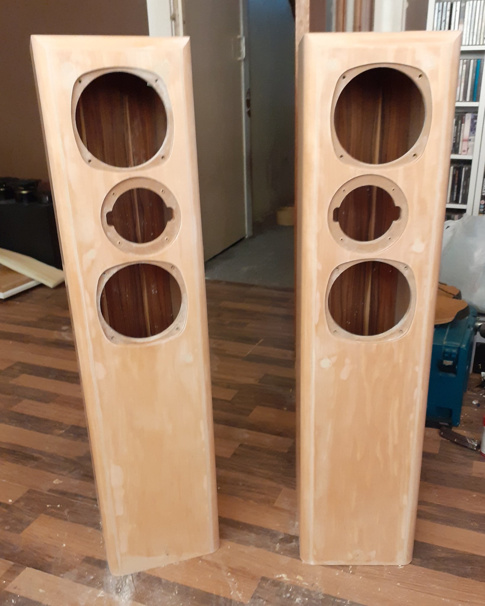

I was aiming to get myself an estimated starting point , using the 2" minimum suggested , but , all the calculations I have done say it is not possible .
I want to spend as little time as possible finishing them as I want to be listening and I can not do this until the placement is sorted , and I can not find there optimum position until they are finished .
Hi and thankyou for your reply , the measurements are actually 845 x 200 x 245 and the wall thickness of 25mm was taken into account , that said I do not know for sure that the answer is correct as I have no idea what I am doing .Is 0.821 cuft correct for the box vol? I looked up the speakers (https://www.hifiengine.com/manual_library/castle/stirling-3.shtml) and the listed external dimensions were 870 x 200 x 240 mm, which becomes 0.04176 m^3 which is 1.47... cu ft. But these are external dimensions so box vol is prob smaller, and maybe 0.8 cu ft is correct...

I thought this would be a simple enclosure refurb , as a carpenter this is easy ...........
870 x 200 x 240
How thickis the material?
I’d guess 15mm, so 30 litres, just over a cubic foot insternal (less any bracing). Doesn’t account for any difference in height due to the plinth and spacers.
Just under 28 litres if 18mm, ie a ft3

With a box volume of 0.821 ft3 , a port diameter of 2" and a tuning frequency of 45hz I am getting a port length of 1.101.3 mm ??????????
If it's of any relevance at all, I've extracted the following information from my David Weems book.
For a tuning frequency of 45 Hz and a port of diameter 2 inches, he calculates the following port lengths:
0.75 cu ft: 4 inches
1 cu ft: 2.75 inches.

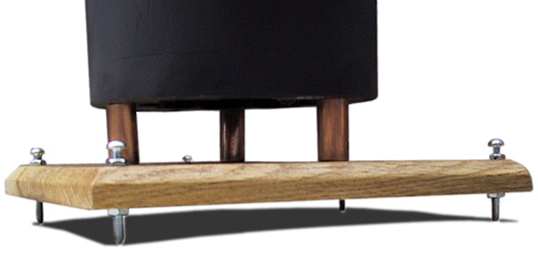

So , Ive been having a mare these last few days , but , I think I may finally be happy .
I bought a 2.5" parcel tube 1m long and have spent the last few days , cutting and listening and cutting and listening and found that I preferred 2.5" x 4" , but , could not find any substantial plastic tubing at said diameter , so , out of frustration and anger I bought 2 5" long flared ports which are approx. 1.75" in diameter and flare to 2.5" and I think they are better , or maybe Ive just had enough haha .
But as always with these things , I have discovered , or caused , another issue .
As they are small floor standers the tweeter does not sit at ear level and although the soundstage is wide and deep , it now seems quite low , almost as though I am looking down at the band .
I have tilted the speakers back as far as they go , and this made a big difference , but , its still not quite right .
My thoughts on solving this are to make a box , big enough to bring the tweeter to ear level , approx. 250mm , that will fix to the underneath of the plinths and fill said box with sand .
Is this a good idea ? is it ridiculous ? please help I have no idea .

I'm surprised that Castle hasn't placed the tweeter at a typical arm chair seated ear level. That begs the question, what are you sitting on?
Visually, a 10" extension in height could make the speakers look out of proportion. Audibly, you can but try it and note the effect.
Before committing yourself to constructing a sand-filled box, I suggest you experiment with raising the enclosures by any means at your disposal. For example, my garage is overflowing with piles of old electronics magazines that I would use to do the job temporarily!
P.S. Nice badges.
P.S. Nice badges.
Haha just a ordinary 2 seater couch mate .
Yeah Im surprised myself about that .
Excellent idea my friend , just so happens I have a stack of carpet tiles that will be ideal , I can start with a few and gradually increase the height until I find the spot .
I am a tad concerned about how they will look , was thinking maybe I will do the extension the same dimensions as the speakers and make a new plinth rather than extending the original plinth .
