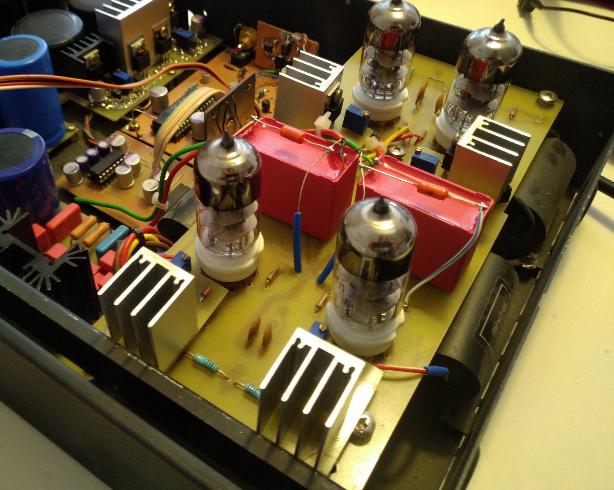

Pictured are four CCS with DN2540 and 2SK3557 as bottom mosfet in my old DAC, they worked for years without any problems. But the picture will say something more, the CCSs themselves are located right next to the tubes without any long wires. The temperature of the heat sinks was around 80C.

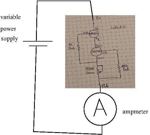

This is how I test it outside the amp.
After finding out the resistance, I replace the trimpot with a resistor.

Breadboard a non-cascode version of CCS, ie single nmos with one resistor and one VR to test 10M90S.
The circuit is in the 10M90S datasheet.
https://www.mouser.com/datasheet/2/240/DS98729A(IXCP-CY10M90S)-1547388.pdf

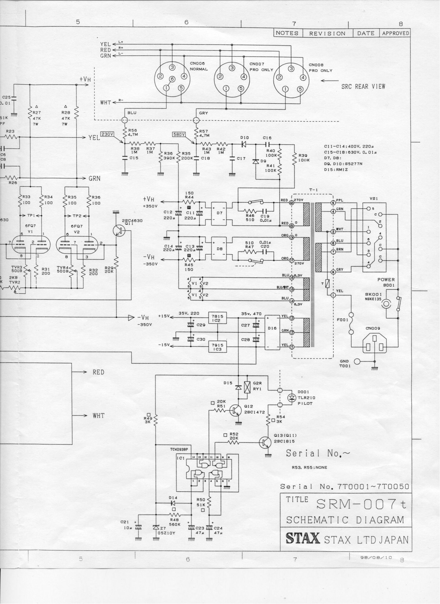

It is really RMS? What is it driving?B+ is about 350V, signal output (R+ vs. R-) exceeds 400V RMS.

The Stax headphone put high capacitive load between anodes, and there is high peek swings too.
If CCS hasn't enough prevention (no, or too low gate stoppers, long wires, no -few ten...hundred nF- capacitor on B+), possible oscillation occurs -even at MHz region-.
If CCS oscillates, the FETs dissipation (large swing, oscillated current) will growing rapidly, in worst case device would damaging.

- the 10nF PS capacitor shown in the STAX drawing is too small to stabilise a Power FET. I prefer a 100n-470n (type: STACKED MKP) attached to the CCS PCB's input terminal, and a wide ground return. If that is difficult, use a 47µF 400V (ordinary type Panasonic M series; Nichicon VR - not a low ESR type!) electrolytic mounted in the amplifier, and connect to the CCS with 1mm Ø wire - and no film caps. This method leans on the elko ESR to damp out any oscillations.
