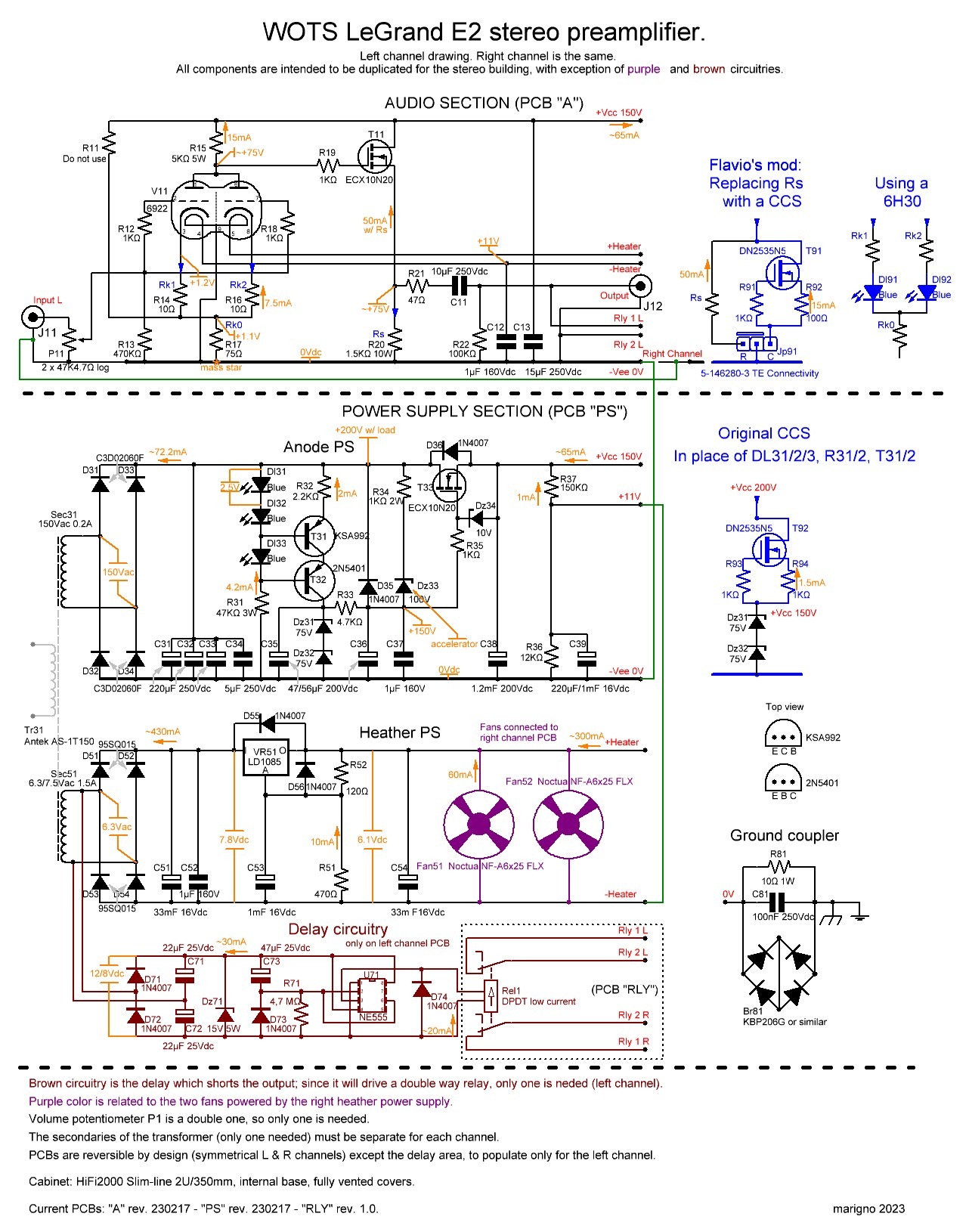

The problem with low currents and DN2540 applies to cascoded pairs of them. In cascode: increasing Vgs (to get lower current) with larger source resistor is negated by the upper FET's increasing Vgs, which increases the Vds of the lower FET (increases current).
You should be able to get 1mA with a single DN2540, but it may not be very stable with temperature.
The Datasheet SOA should be carefully compared to your circuit voltages, and heatsinking applied if the power burn is more than 500mW. Running more than 325V across DN2540s can cause voltage failures - transients at power OFF are often responsible.
You don't say what the voltage is, but if the SOA is respected, 1.3 to 1.7mA or so can be directed to a zener with a LND150 at IDSS - no source resistor at all. Use a resistor to drop some voltage, if it is too high.

I enclose here the schematic of the application: I tried to use the DN2535/40 as a CCS in the power supply, but it didn't work. The DN2535/40 was acting as a short, overheating itself, and the zener diodes. So I replaced the DN2535/40 with a cascode CCS ad the issue was solved. Then I made the mod to the audio output source follower, loading it with a CCS instead of a resistor. The CCS was made out of a DN2535/40. This mod was working very badly, my friend Flavio had to select a couple of DN2535/40 out of a bunch of ten and the sound came out correctly, better than using the resistor.

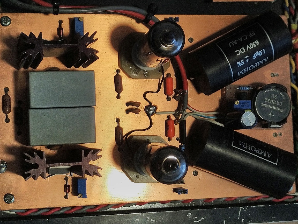

@marigno, in the picture is CCS with DN2540(sot89) and BSS159(sot23) in cascade, current 2mA, voltage drop 90V, used as CCS in my HV regulator for tubes.
DN2540 sometimes gives strange results on testers, which does not mean that it is not good and DN2540 is easily destroyed with careless handling and static electricity even before it is soldered to the PCB, so you need to be careful with it.

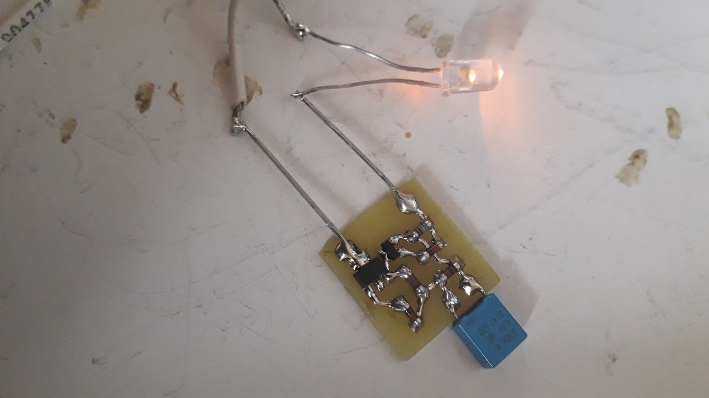

@heatsink12 ,in my tube IV stage I used IXTP08N100D2(on heatsinks) and two 2SK3557-7 in parallel at 15mA, 150V voltage drop, much better result than with two DN2540. I only protected 2SK3557 with a 10V zener diode. I recommend the use of two 2SK3557 because their Ids vary a lot and should be matched in that case.
The solution I presented in the post 15 was much better, a huge difference in sound, a more open sound image, more details ... and since then I no longer use jfets in CCSs even for a voltage drop of 2.5V(two BSS139) .
Instead of BSS159, you can also use BSS126, but pay attention to max Ids.
