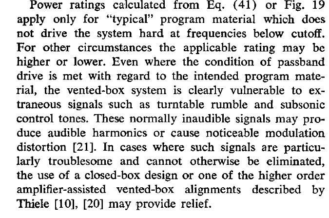

A Vented Box (AKA Reflex) actually has a fourth order response (24dB/octave), which you can design for any of the usual high pass filter functions (Butterworth, equal ripple Chebyshev, etc).
And yes, at sufficiently low frequency remote from the port and driver resonances the driver motion approximates that of an open baffle, so you absolutely need subsonic filtering, either active or passive.

To quote from one of Small's 9 seminal papers published in 1973-4 in JAES, this from "Vented-Box Loudspeaker Systems Part II, Large Signal Analysis"
Cross-feed rumble filters overcome this effect without messing around with a sixth order amplifier-assisted reflex alignment.
If you use a first order crossfeed circuit at 80Hz (ask me one day why 80Hz is fine) will have 20dB attenuation at 4Hz and 40dB at 0.5Hz. I usually also have a traditional highpass set at ~ 10Hz for another -20dB at 1Hz.
The main component of record warp is 0.55Hz (33.3 RPM) to 0.75Hz (45RPM). With the crossfeed and highpass first order we get around 60dB down for rerod warp fundamentals.
Are we really concerned with signals around 60dB down?
I have not found them problematic with a first order crossfeed and open baffles or vented boxes. It's very simple and effective.
