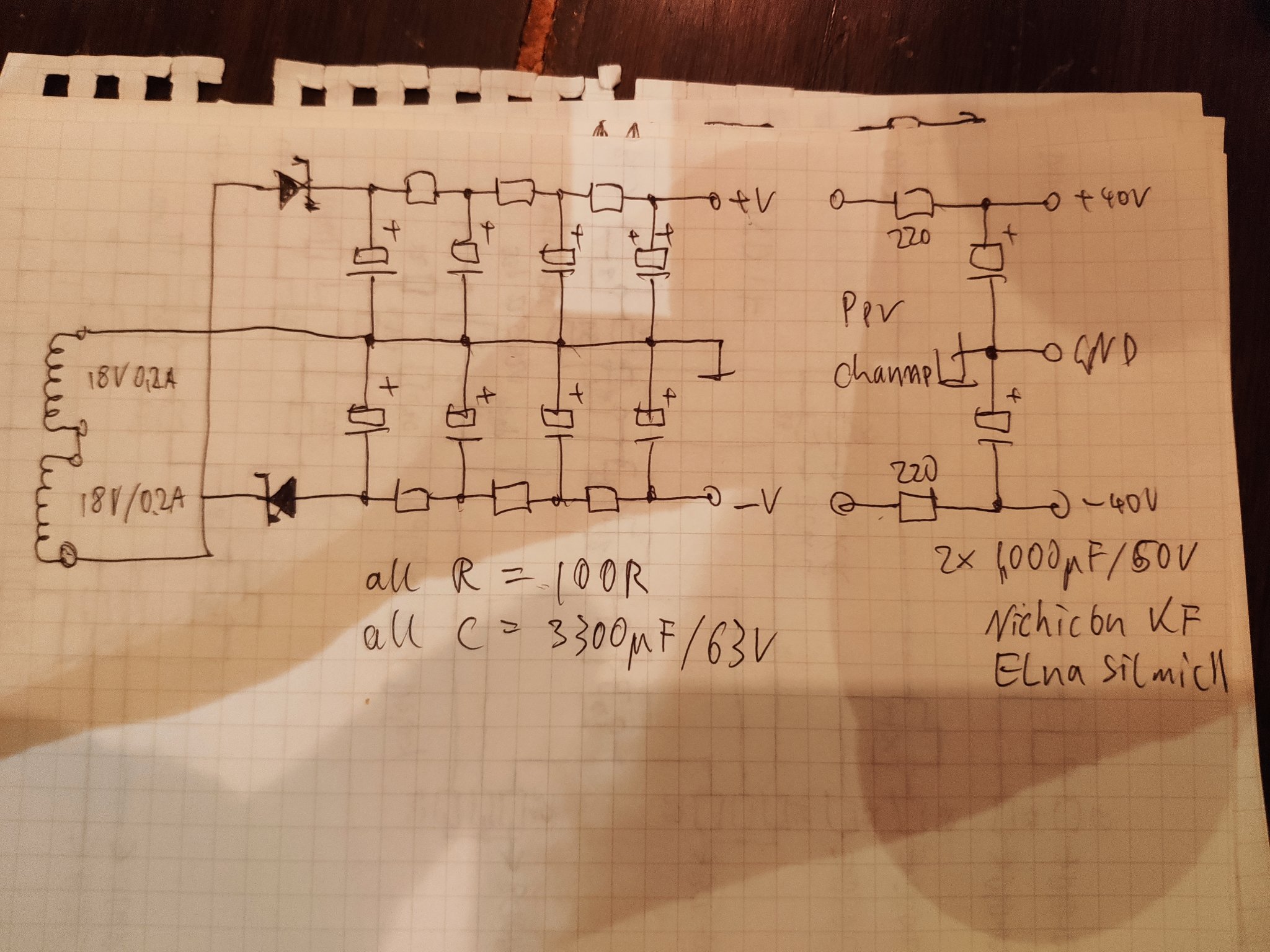

Try any transformer 18V + 18V with over 200mA, sends is in series, use a voltage doubler, 3,300uF/63V and 150V schottky diodes should be fine.
This should give around +/- 56V, so we have 16V to burn. Use 100R + 3,300uF RC cells in series:
Voltage Doubler +/- 56V -> RC -> RC -> RC
At that point we have a 60dB per decade filter with a 2Hz turnover. At 20Hz we kill noise by 60dB, at 200Hz by 120dB. Here don't worry too much about capacitor quality, low ESR is useful, but don't loose sleep.
Final filter splits out to L/R with 220R and nivlce "Audio Grade" caps (Nichicon KZ or Elna Silmic II, 1,000uF minimum.
The PSU has no choice, except to be dead silent. And it should get us to around +/-40V.
The buffer has some interrelation with the EQ part. Keep the PSU lines together.
Thor
PSU as recommend

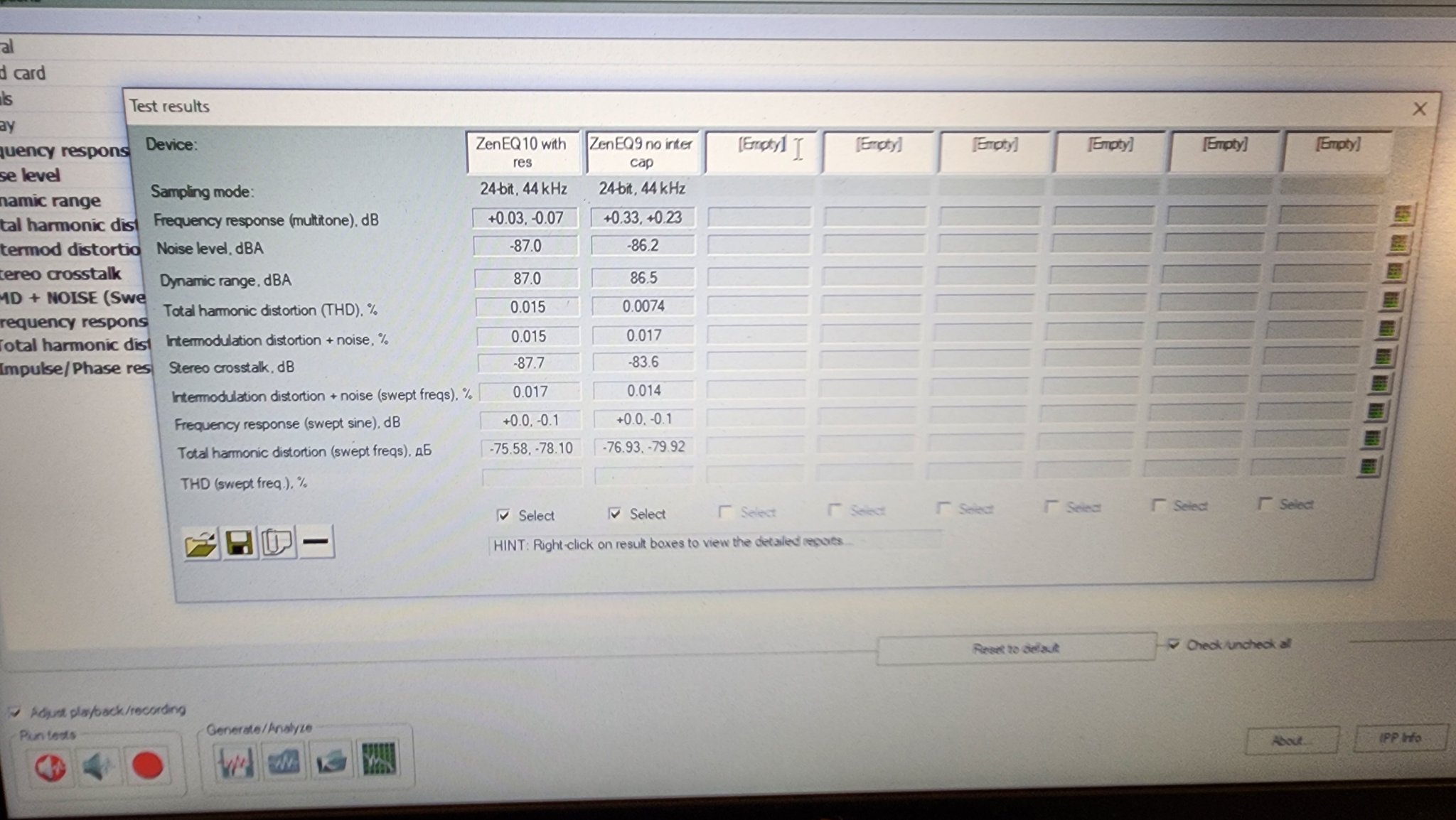

Adding 3.6k res to ground increases distortion from 0.0074% to 0.015%.
Did the gain go up 6dB? Then output level is up 6dB and HD should be up 6dB for the same input. Also, +/-30V is 25% below design center.
The 1k resistor in the Sziklai circuit can be adjusted. You can try from no resistor (J-Fet drain current = PNP base current) to around 120 Ohm (~ 5mA in both FET and BJT).
This will change noise and harmonic profile. The 1k is a generic place holder that works, but without tuning to any specific outcome.
Listening tests using a stereo pot as resistor are probably advisable, to get the best sound.

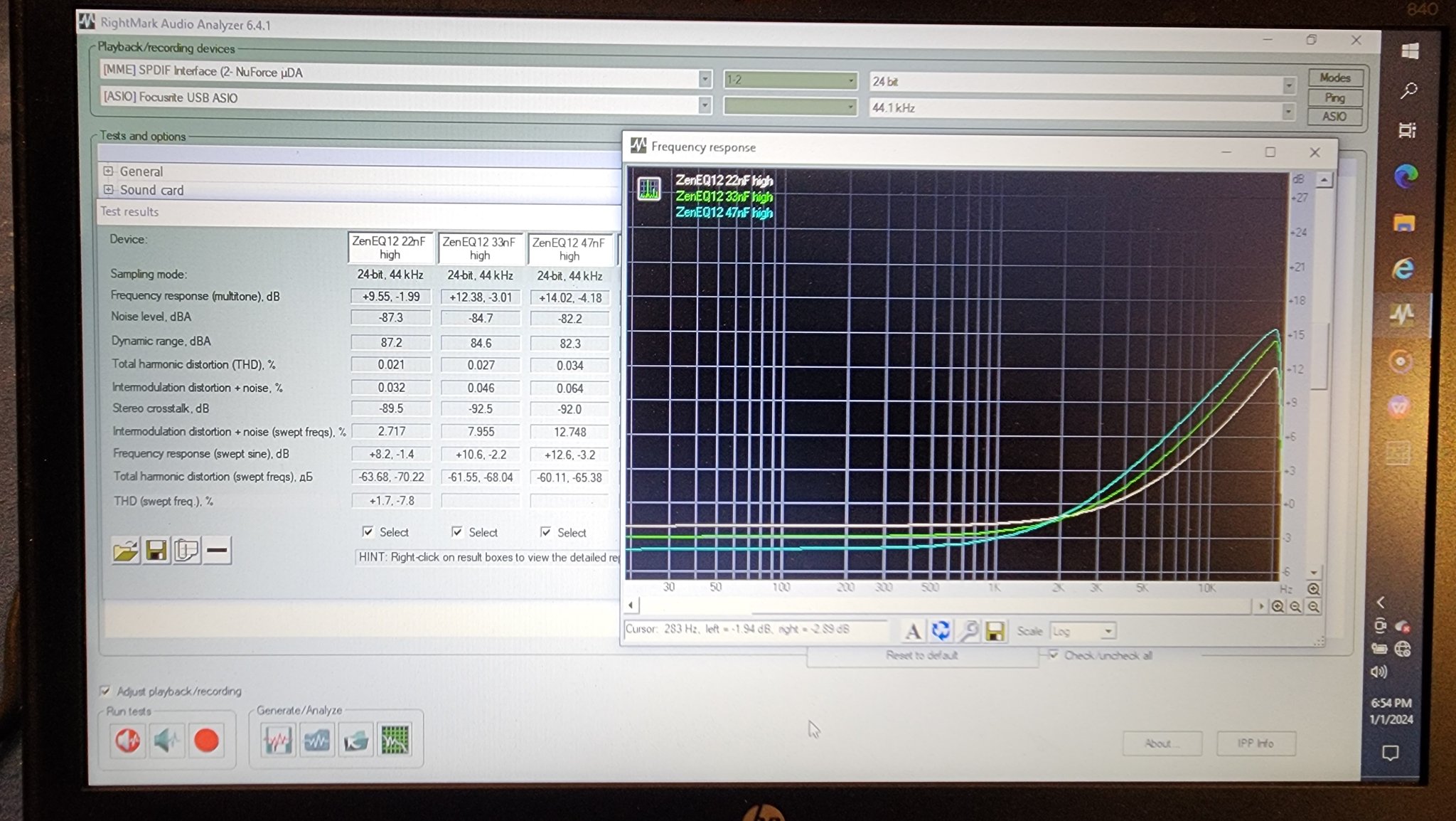

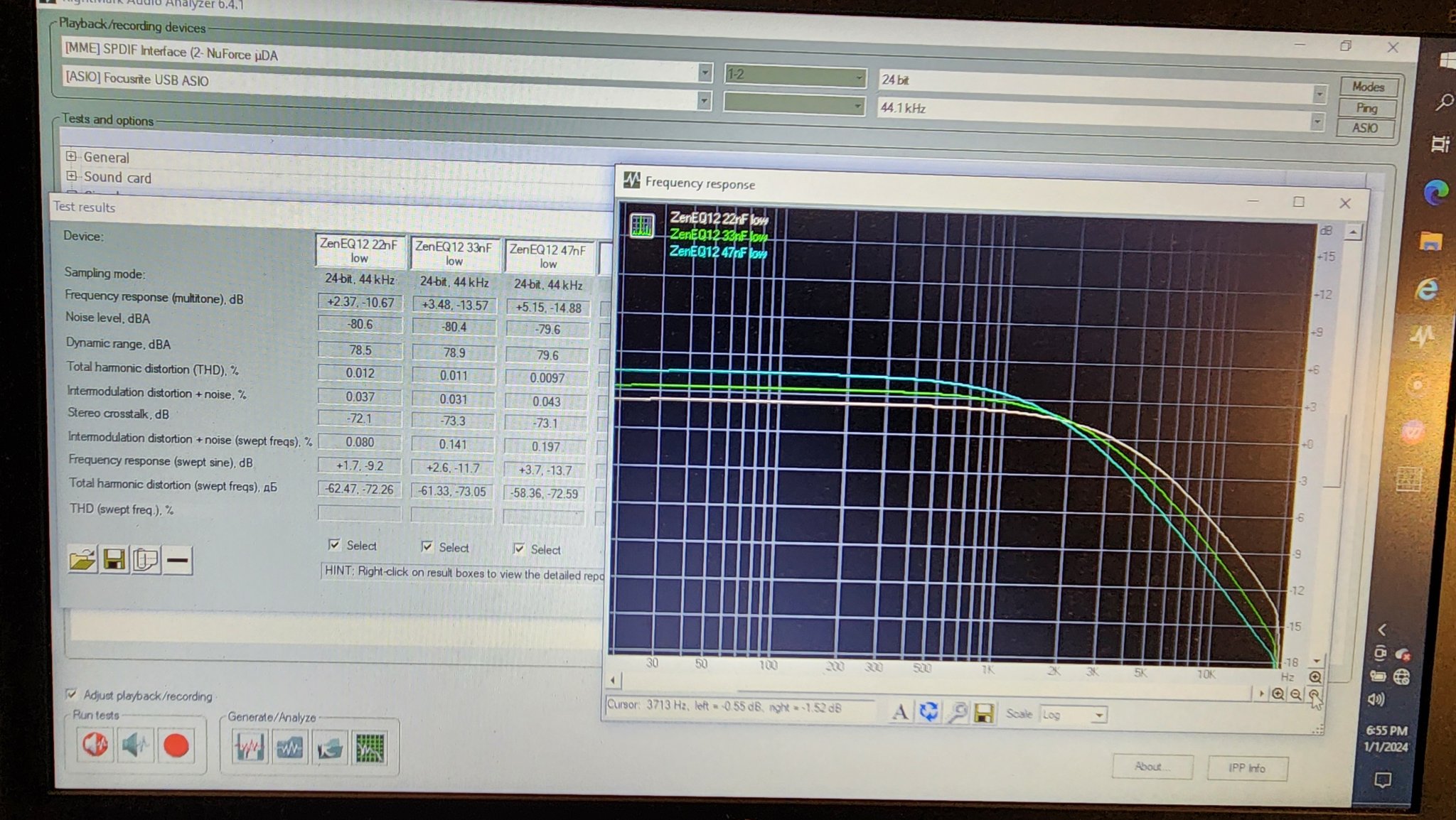

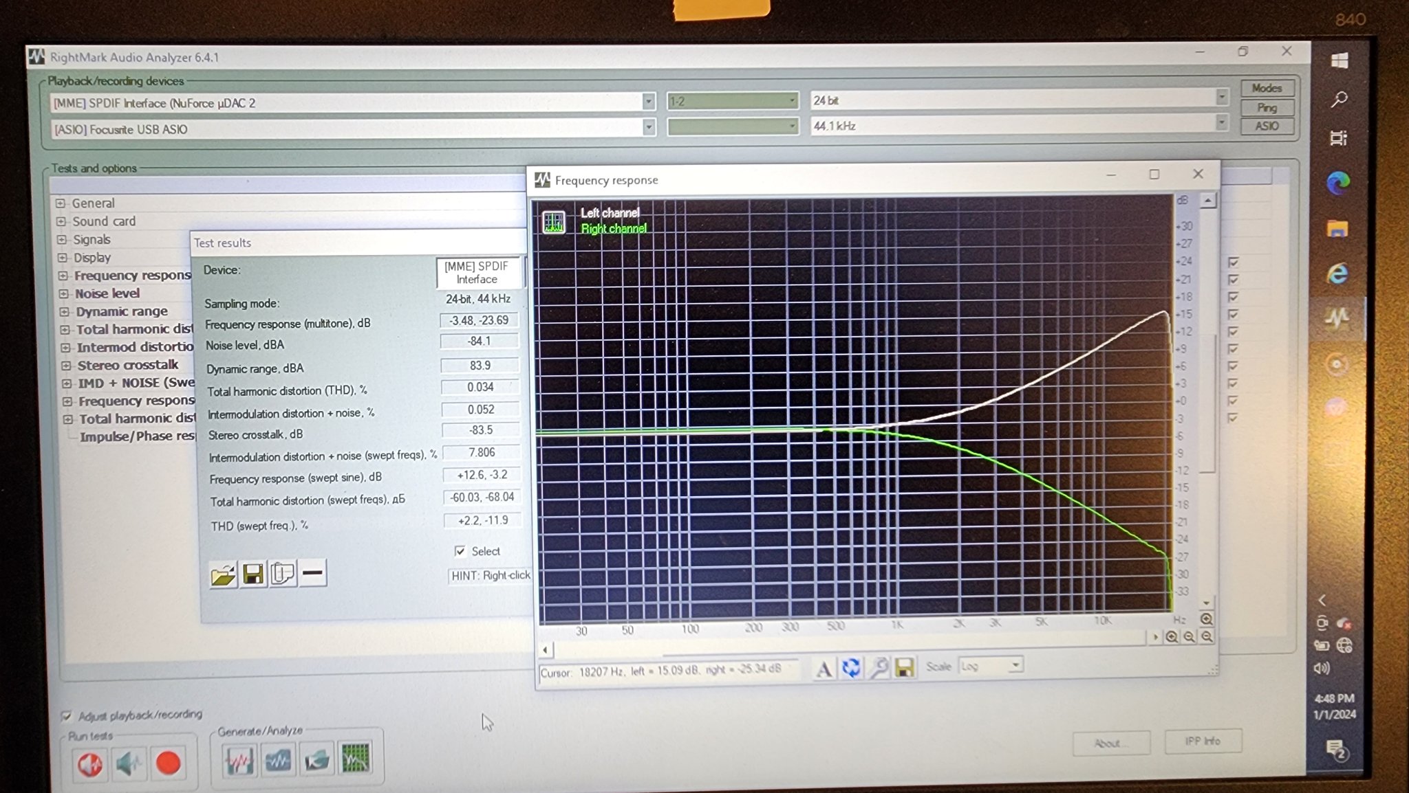

I found 0.8mH inductor, not shielded, for crossovers. Just as test, i wired highest filter. I am mainly interested in extreme ends.
This is how fr response looks like in two positions.
I will definitely modify later. I want to lift much higher, not affecting upper mid, just the highest fr. 47nF will be optimized, likely 33nF or even 27nF. Will test later.
Circuit has more buzz, since its just a prototype birds nest. Schielding will be extremely important.
This circuit I presented is based on the Cello palette, which is best understood as (re) mastering EQ. It is not a graphic EQ with narrow bands that each have equal amounts of boost or cut.
The intent of this EQ is to gently re-balance the tonality of recording that are colored by microphones, monitors and other recording chain limitations.
As such slopes are broad. It's not a big, it's intentional.
Thor

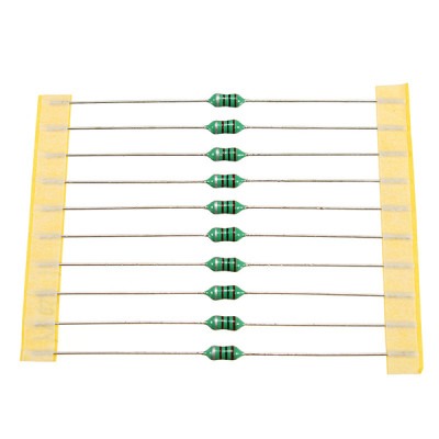

Is there a way to wind these inductors by self?
Of course, you need a winder and suitable wire, bobbins and cores.
Are they air cored ?

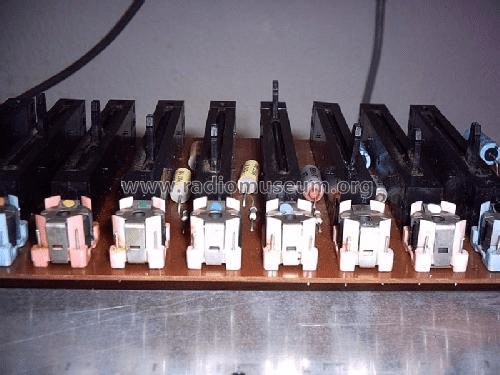

A 2H Air core would be huge. Commonly so-called Pot Cores were used for such EQ's like in this picture:
An alternative was shown in post #23, with electronic "inductors" for the two LF bands and real, off the shelf (Mouser) inductors for the four upper bands.
