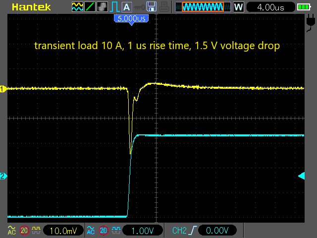

I'm still struggling with my capacitance multiplier.
Do you measure oscillation at the actual Cap Mx circuit, or are you just concerned, based on the simulation results, that Cap Mx circuit is only marginally stable?
Used models are very detailed and you do account for the PCB tracks inductance. However, adding parasitic capacitances, brings model one step closer to the real circuit. Add “.option cshunt=2e-12”.

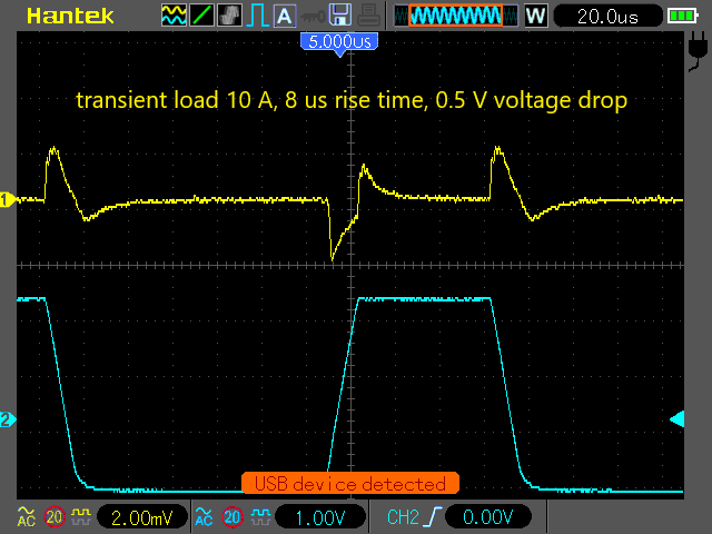

My limited experience in comparing calculated phase margin and actual circuit behavior is that there is a difference large enough. As I don’t have a network analyzer to measure actual phase margin, indirect method was used.
There is a relation between transient response under load or Q factor and circuit phase margin. Paper is attached. Practical summary is at the picture nr. 6.
Simple current sink, driven by tone generator, was used to provide square wave load at the power supply output, with desired frequency, load current and rise time. Observing response with oscilloscope, measured phase margin under targeted load conditions was always better than 50°, while Tian probe calculation predicted about 20° margin at best.
  • Phase margin and quality factor.pdf

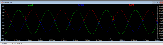

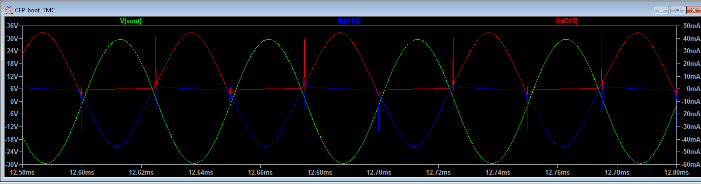

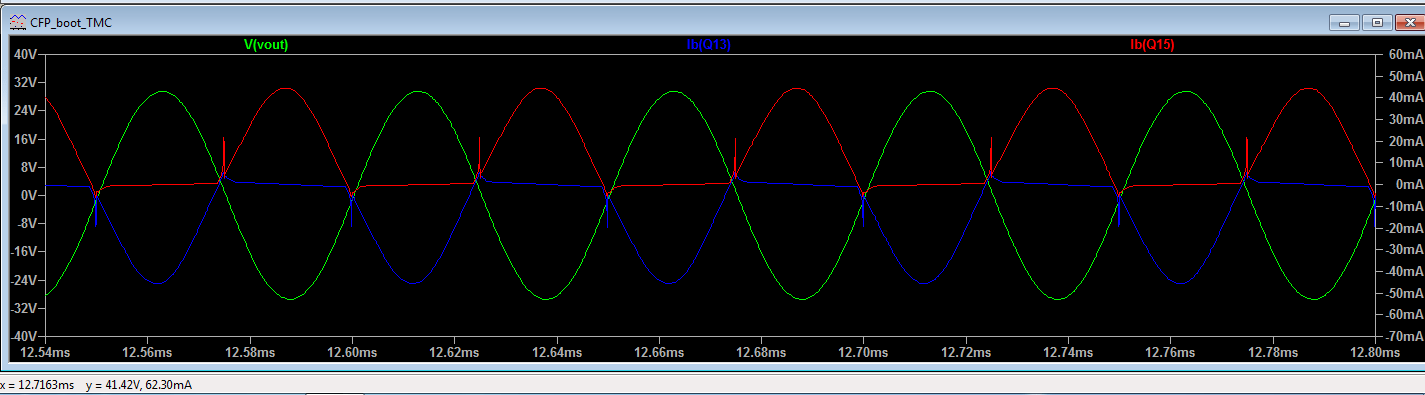

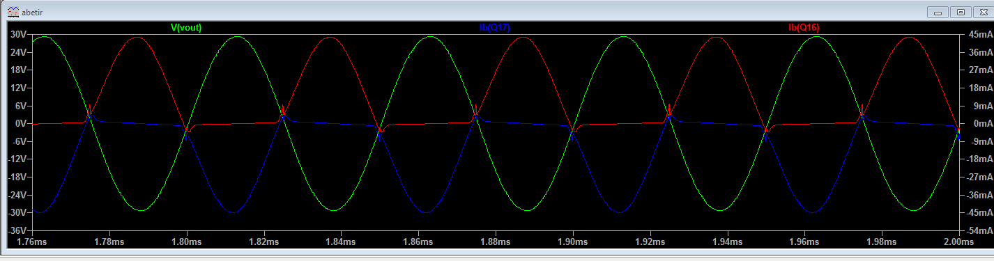

Hi guys,
Here is an interesting simulated results in attaching a small degenerators at the driver trannies.To my knowledge the degens was discussed years ago, and I've read that a trade off exist's by losing some loop gain.
Simulated results executed at 20KHz max power, bias current 25ma per device. The red and blue lines are the output bases and the spike appears at the higher frequencies only, regardless of the output power be it 1W or max power. Topology used TMC + bootstrap + enhanced VAS. Longer spikes 'no degens' shorter spikes 'with degens.'
The last graph is 'as built' , an old project of mine using differential VAS with degens (of course 🙂).
(BTW I''m referring to the output stage.)

The CFP is doing well, the problem is the PDN attached. Sorry I phrased this wrong. Any low ESR capacitor at the output makes the CFP go unstable. In my case this is the small decoupling caps I have in parallel to the large high ESR electrolytic cap.
I agree and also have observed that stability in simulation and reality differ significantly from another. Making simulation closer to reality helps.

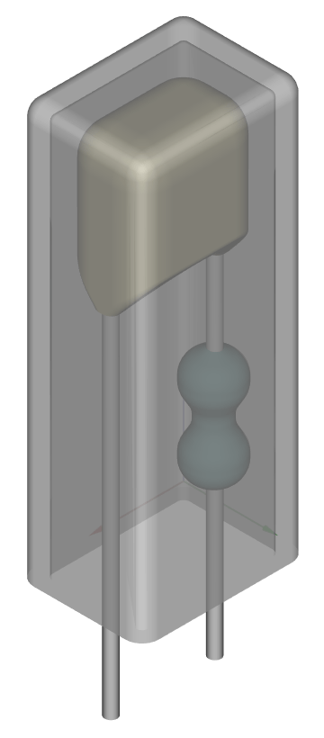

A 100nF (or any other capacitance in this range) with 100mOhm ESR would be lovely. Can you please let me know a suitable part number?
According to my research, ceramics are closer to 10mOhm ESR unfortunately.
Capacitors with deliberately increased ESR would be perfect.
I did some research and found out that such parts even exist: Look for "controlled ESR" capacitors.
This is a brilliant idea, but those caps are expensive, hard to find and seem available only in low voltage capability.
Of course, one can build such parts from just a resistor and capacitor with just a bit more inductance involved.
I even think about your proposal do do this. Both parts potted in a tiny plastic enclosure would be rugged, look nice and professional.
I would sell them for a fortune each as magical audio decoupling capacitors and other than so many audiophool parts they would even do something useful actually.
Hmm you're right, I can't find any at 100mOhms, they're all 30-something. Unfortunately I don't remember how I measured that value, or what caps I used...
Anyway, if you want a controlled ESR cap that's in stock, one solution is to use SMD MLCC and SMD chip resistor in series. It increases inductance a little bit, which can be compensated by putting two in parallel. So with 2 caps and 2 resistors, you get about the same inductance as one cap, but you get the ESR too.
