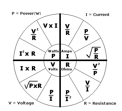

We're tech guys right ? So we don't talk only about Watts but we mainly talk about Ampères when speaker cable is concerned. 1200 Watt can be 1200V x 1A or 1V at 1200A. The latter situation asks for a pretty thick copper bus while the first situation could do with a thin wire. A power amp generally does not put out 1200V. Speakers generally are low in (varying) impedance so they want mucho Ampères at a certain low voltage. We therefore choose speaker cabling mainly based on the current rating.

I knew that fact, that amplifier outputs low voltage bug big current, for example around 14v for 100W. I am certainly a novice in all this, but is not it like A LOT more than enough that cable for my speaker needs? After some calculations, I found that the cable is supposed to handle around 10A. How much current should my 15" boss speaker drain on a 2ohm load and around 200watts? I have no idea, anyway I touched the cable and runs cold, which means its ok. 😀. The power supply that I am using to feed the amplifier, is 8A.

This is what you need. Anyone working with electricity should know Ohms Law by head. After 30 years I still know nearly all formula variations (except the ones with root mean square for some reason) by head, it is of practical use nearly every day in my case.

Let's suppose the load (2 Ohm resistor) is a lightbulb designed for 40V operation. What will happen ?
In that case, I think we will have a voltage drop because the cable consuming half of the current, so the bulb won't bright at 100% because only getting half of the energy?
You are in the right direction (but not right) with the wrong assumptions as you did not use Ohms Law. It would not burn at 100% that is true but what is the voltage at the bulb ?
The current is the same at all places in the chain, the voltage drops to half at the load. No Ohms Law, no real understanding of principles 😉
I = U/R. Total resistance is 2 + 2 = 4 Ohm. 40V/4 Ohm = 10A.
U = I x R, so the load gets 10A x 2 Ohm = 20V
Bulb is designed for 40V but gets 20V.....no bright light.
Print out the Ohms Law circle, hang it at the wall of your workbench. Now use it and be enlightened. Wars are started by assumptions, peace is kept by calculations (that is Jean-Pauls Law BTW only to be recognised 30 years after my death) 🙂
