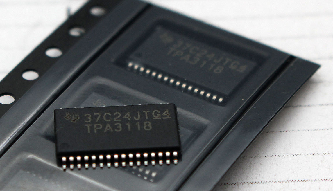

Oh boy, nice looking "tpa3118", especially the dot looks real nice.
(I mean it doesn't look like a Texas Instruments TPA-3118 chip to me, you could ask TI on their support forum )

XRK's 1st post of the recent Sanwu board.
http://www.diyaudio.com/forums/clas...ding-them-everything-comes-5.html#post4585203
Suggest removing R27 to lower the gain to 20dB. Then try it again.
For advice how to mod a fake Sanwu pcb with a fake TI tpa3118 best post in counterfeit semiconductor section 😀
Compare the markings on my chip with xrk's board on post#241 here:
http://www.diyaudio.com/forums/clas...ing-them-everything-comes-25.html#post4585203
They look very similar. I don't think my board is any more fake than xrk's. As I said, it sings rather well. I'm just not too enamoured by the slight harshness and would like to improve things.

Dear jls001. The pin 1 of chip is marked with a dimple (no whiskey) better called recessed dot maybe, that disappears when you shave the chip to remove original markings. Your chip has a laser or ink dot, to make it look like an unshaved chip.

Should they really fake them?
This is genuine TI:
