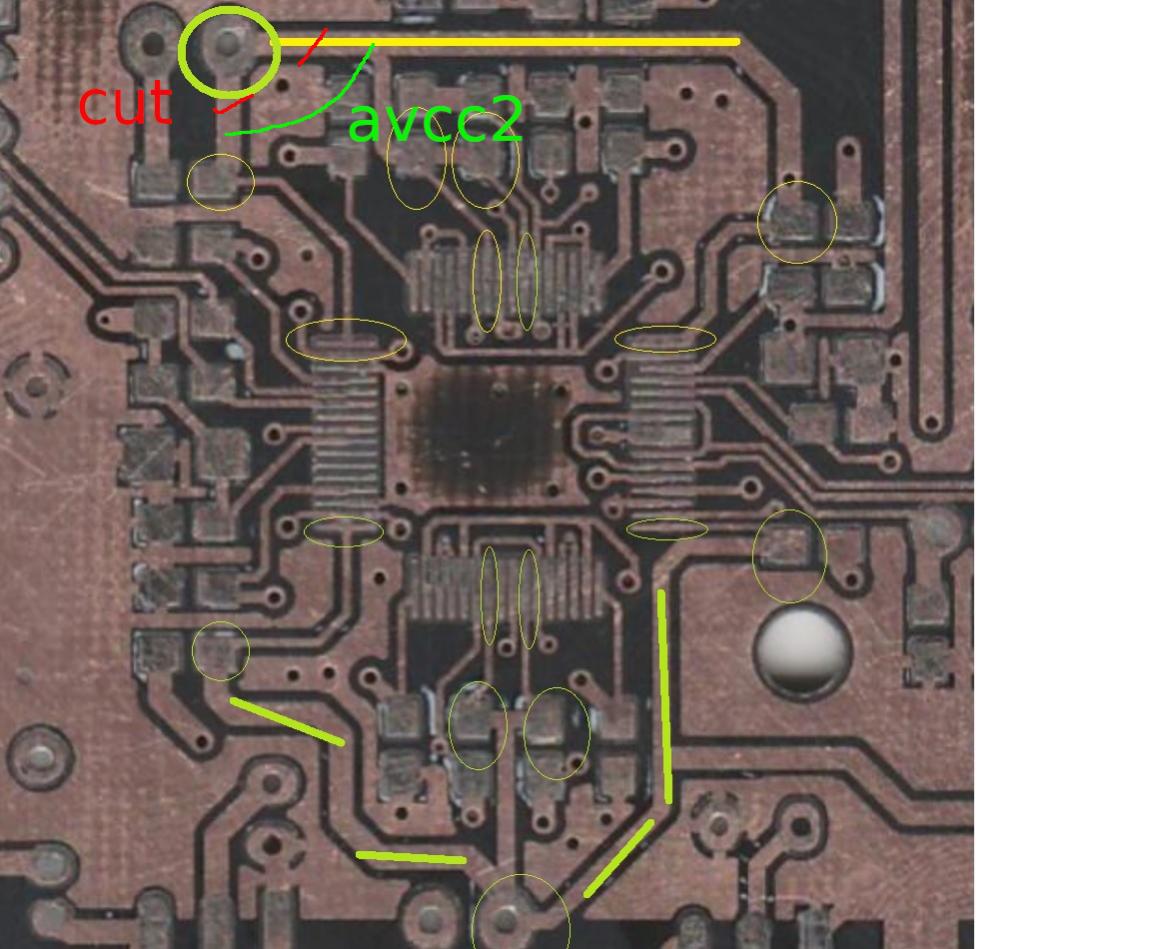

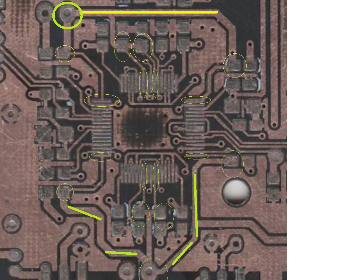

If that nice looking black board is the one I recall, I rejected it because both left and right AVCC supply traces were tied together somewhere in a multilayer board and impossible to separate.
I bought the same board (9038 version). Has anyone succeeded to separate the 2 AVCC?
it's pretty easy to separate. The via is done by electrolytic cap pin near the microcontroller connector. I removed the cap, cut the two traces to the pin then bridge the two traces together. I'm testing a lt3042 reg as supply for avcc, as expected it's not good because of the high current transients, i've added a NPN transistor it is much better ( -15db better on 2nd harmonic)

HI, can you please post a Photo - just to be sure?
Meanwhile I did also some investigation. on the attached Photo we can see the yellow and green marked L and R traces. I think if I drill the red marked whole with a bigger driller, than the connection Will be lost. possibly your solution is safer (not known what is inside).
Anyway, very strange board, I checked the sides and have noticed that it is 4 layer board - sticking is not visible for me. at all.

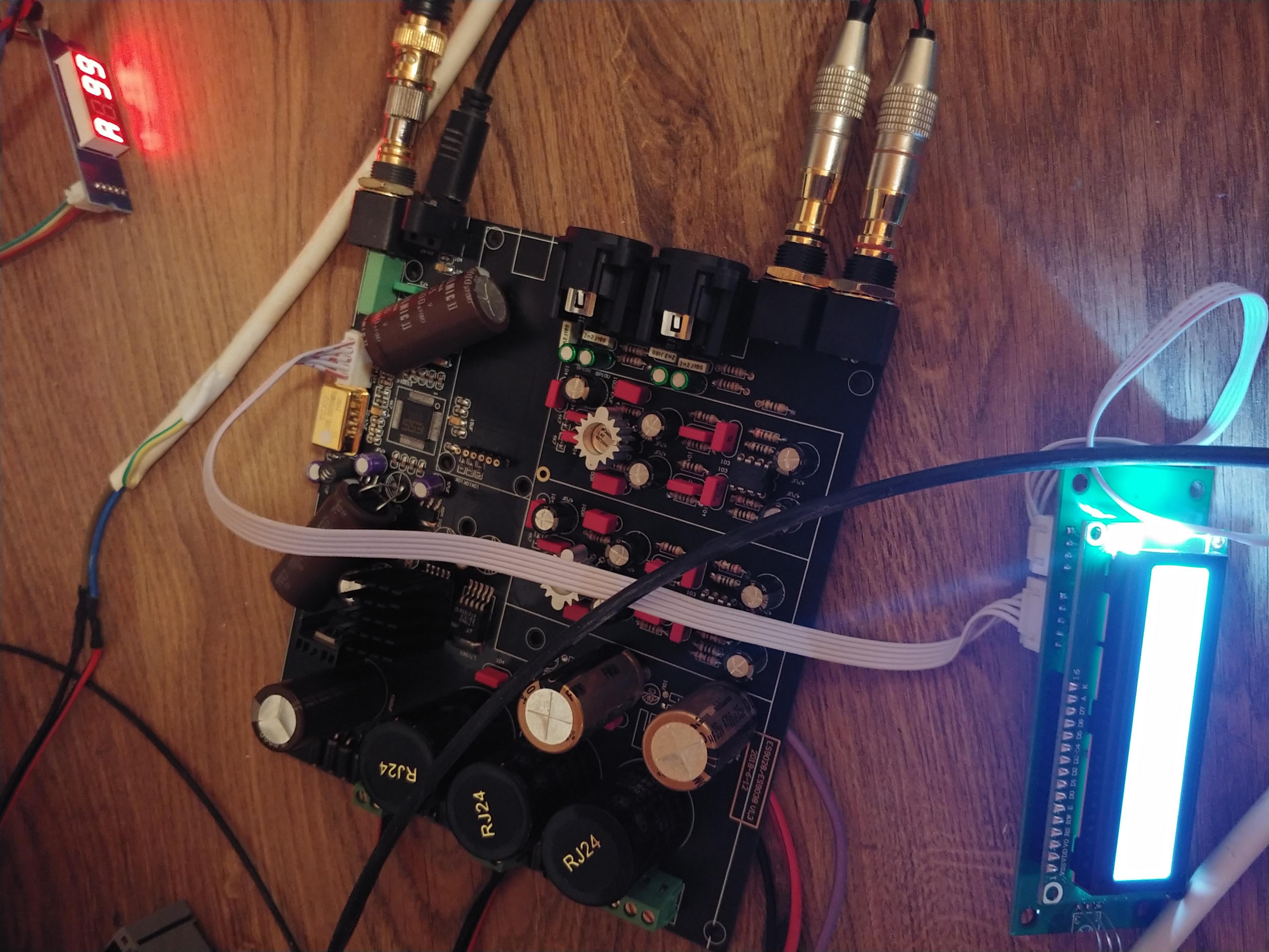

a first try.
Changed the power of the output stage to my former SALAS shunt reg.
Added some Strong caps. also. (nichicon audio)
To avcc added 2 1000uF silmic II + 2 10uF x7r - brute force.
49720 + opa27 ICs (i dont have 49710)
The sound is better, but very far from the q2m yet.
