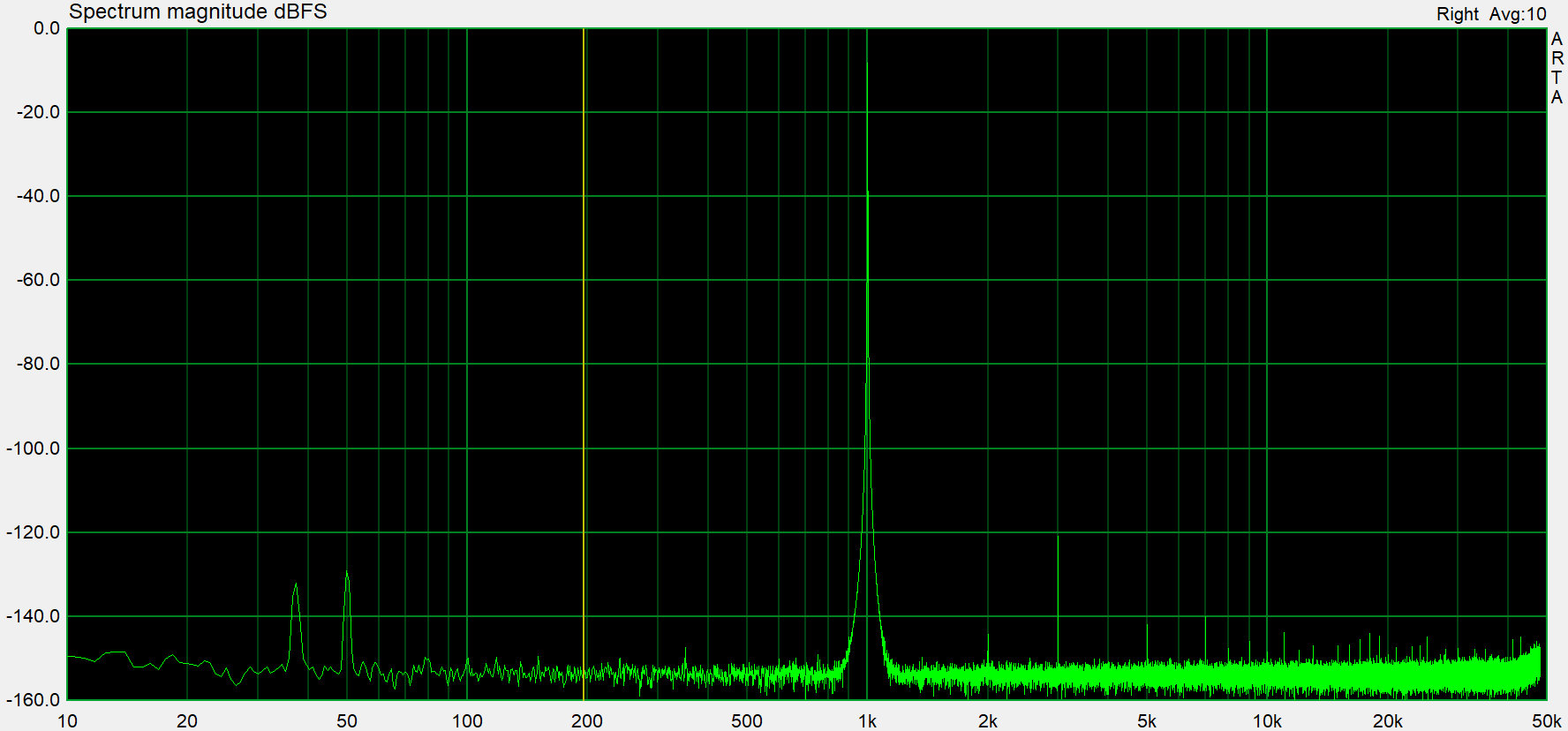

No it's always with the lt3042 for one avcc, I've changed the i/v opa from ne5532 to op1612 it's much better ( I've also added again the 100pf caps), I've not yet done the mesure with khadas tone but the es9038pro board seems to be far better now.
I added lme49720 49710.
But the advantage can be heared if the power is good. I read it somewhere and also experienced.
I dont know.what is the relation between the 1612 and 49720.
I've started to use the lt3042/49720/ lm49600 as avcc source. For now, it's not good (maybe the wires are a bit long), I will try again with shorter wire, and more integrated circuits. I've also removed all the 47uf caps around opamps and replaced with 1uf metalized polyester film, it seems to help.

I haven't removed all the 47uF - this can be a good idea - but I feel somehow much risky to do modifications on this board than the q2m was. (definitely the price is much higher - just to destroy) And anyway the details now are on a level which are acceptable - at least for a while 🙂
I think the next step should be to change the I/V, but currently no idea yet which would be the best idea to handle the 60mA on the best way.

I've apply few mods of this thread on my ES9038Pro board ( Thank You 😉 )
- Removed 47uF Fake Silmic II caps, and replaced with Wima MKS 10uF
- Remplaced the two LT1963 3.3 regulators with Dual LT3042 board (33K resistor for 3.3V & 22uF Tantalum cap for CSet)
- Aluminium & copper shield beetween transformers & DAC Board
- IEC filter and safty earth connection
Huge improvement in term of resolution and spacialisation
I've removed the two 47uF caps on the DAC Board, just after the new regulation board.
Make a real difference ! More relax sound ... Less is More
