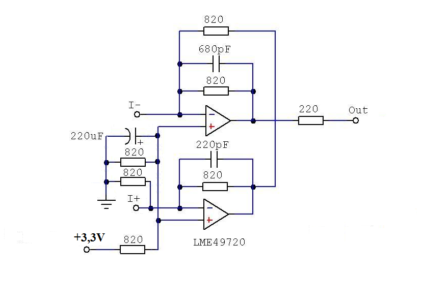

Amazing and cheap boardThe original board shows the third harmonic of the 1kHz 0dB at around -87dB. After the buffer was replaced with this one simple schematic with the +/-15V supply :
http://content30-foto.inbox.lv/albums/v/viccc/ES9018K2M/ESbuf.jpg
Now the 1kHz 0dB looks that:
http://content30-foto.inbox.lv/albums/v/viccc/ES9018K2M/1kHz0dB.jpg
1kHz -3dB:
http://content30-foto.inbox.lv/albums/v/viccc/ES9018K2M/1kHz.jpg
The mix of 19kHz -6.1dB and 20kHz -6.1dB:
http://content30-foto.inbox.lv/albums/v/viccc/ES9018K2M/19kHz-20kHz.jpg
All this was played from the wav files 44.1kHz 16 bit under WXP>foobar USB Asio out>E-MU0202>I2S>ES9018K2M
Also the the ES9018K2M runs from the E-MUs crystal oscillator 22.579Mhz.
Victor

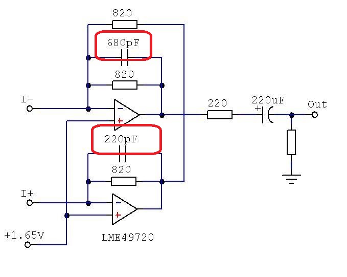

I know it was posted back in 2017 but I was wondering about the schematic. Specifically one capacitor is 220pF and the other is 680pF. I just wanted to verify that those are the correct values and that the two capacitors are a different value.
Victor's revised output stage attached below.

If balanced outputs are used then I would suggest to add more filtering to the balanced outputs as ESS now does for their evaluation boards. That might take one more dual opamp per channel.
Also, one might note that Victor's two opamp output stage uses less than usually recommended filtering.

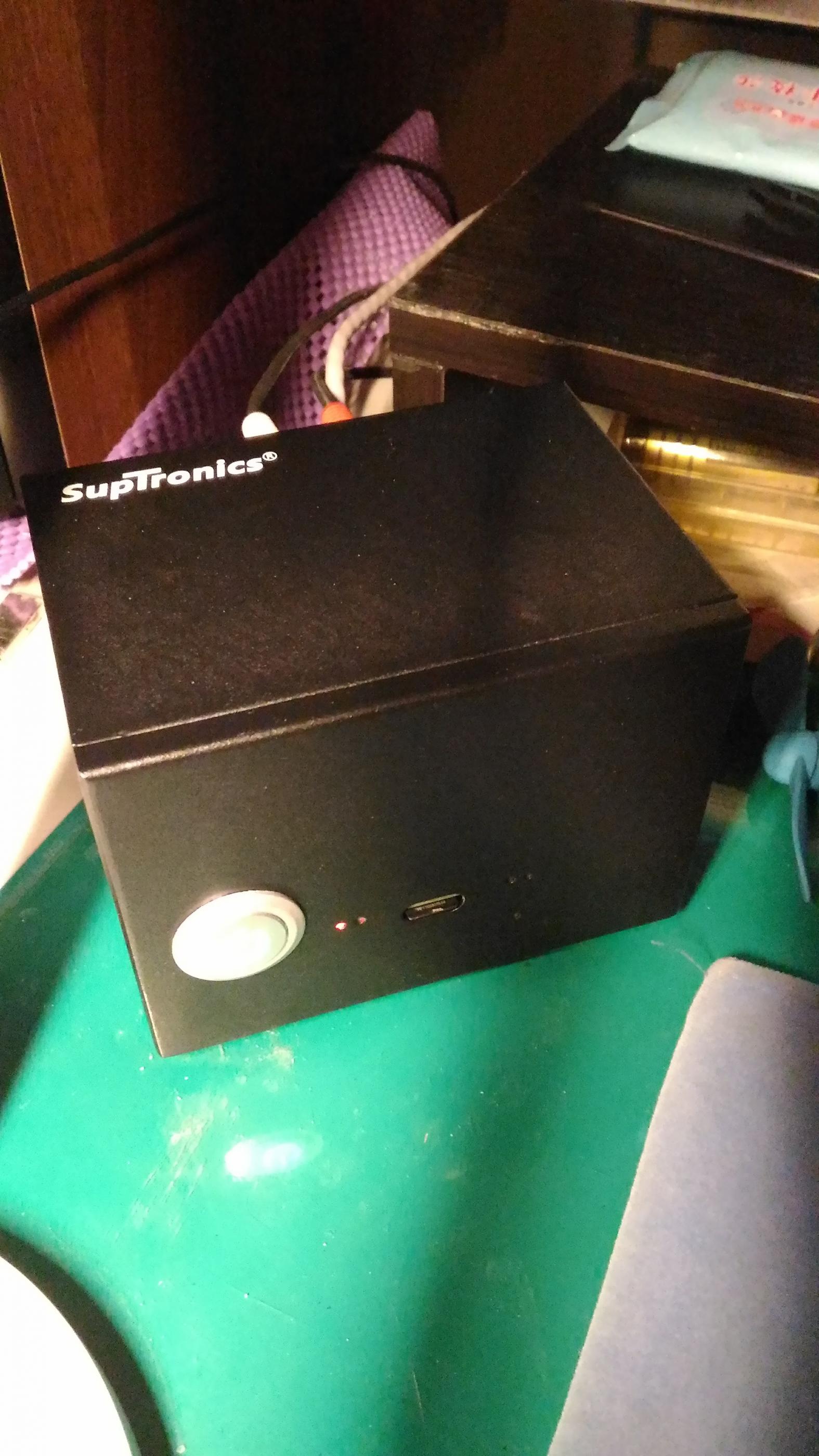

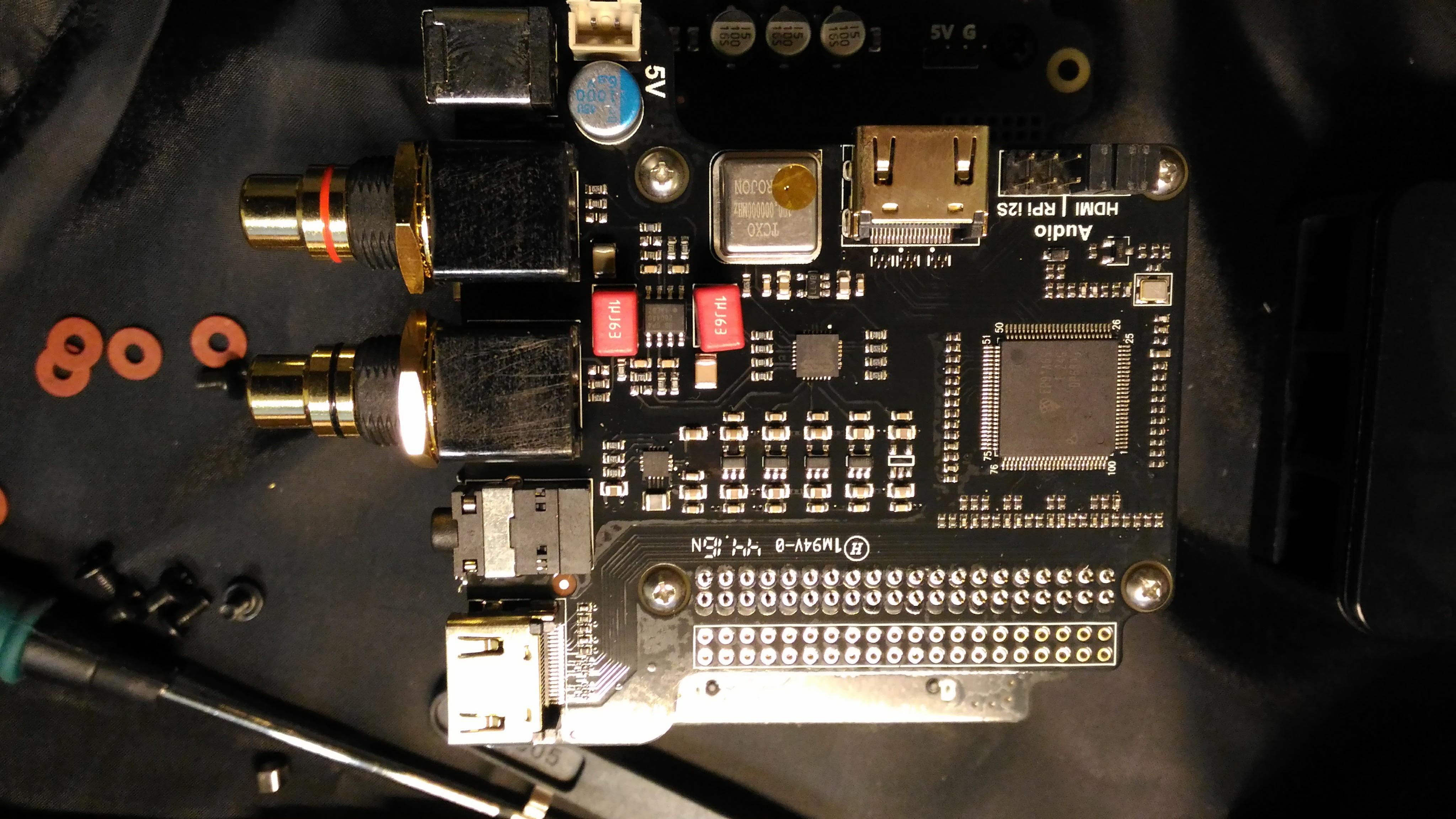

Where to buy? Can you tell me?I have receive the suptronics x4000k diy kit and installed last night. Please forget my poor English....
View attachment 608236 View attachment 608235 View attachment 608234
This kit include:
1) Metal Box. It is a tiny box and almost like 3 cigarette box.
2) DAC Board. Use ES9018K2M and can connect raspberry pi by I2S or HDMI I2S. I think the I2S of HDMI is much better than the ones of raspberry pi.
3) 2.5 HD Board. That board use USB port.
4) Power Supple. DC 5V 4A adapter for all kit.
5) Tools. A screwdriver & a tweezers.
That is a useful kit. I have try ES9023/PCM5102/PCM5122, and I do not like the sound. I think that is due to the quality of pi's I2S. Then I try to use to CS8421 with PCM1794 and feel better.
That kit is specially in I2S of HDMI. I am trying it....

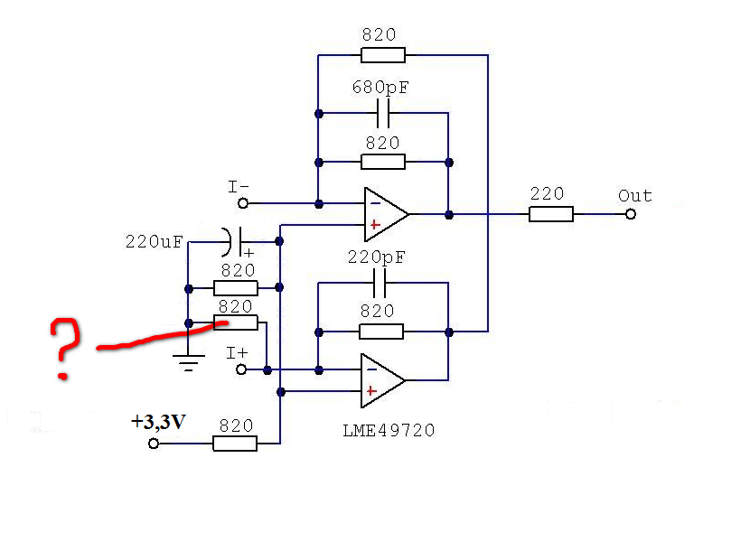

why add a resistor ?Victor's revised output stage attached below.
Also, my notes show the following information:
Chinese ES9018K2M I2S DAC - Page 16 - diyAudio
DVCC - without changes. AVCC has 3 x 1800uF capacitors in parallel with the onboard tantalum capacitor.
