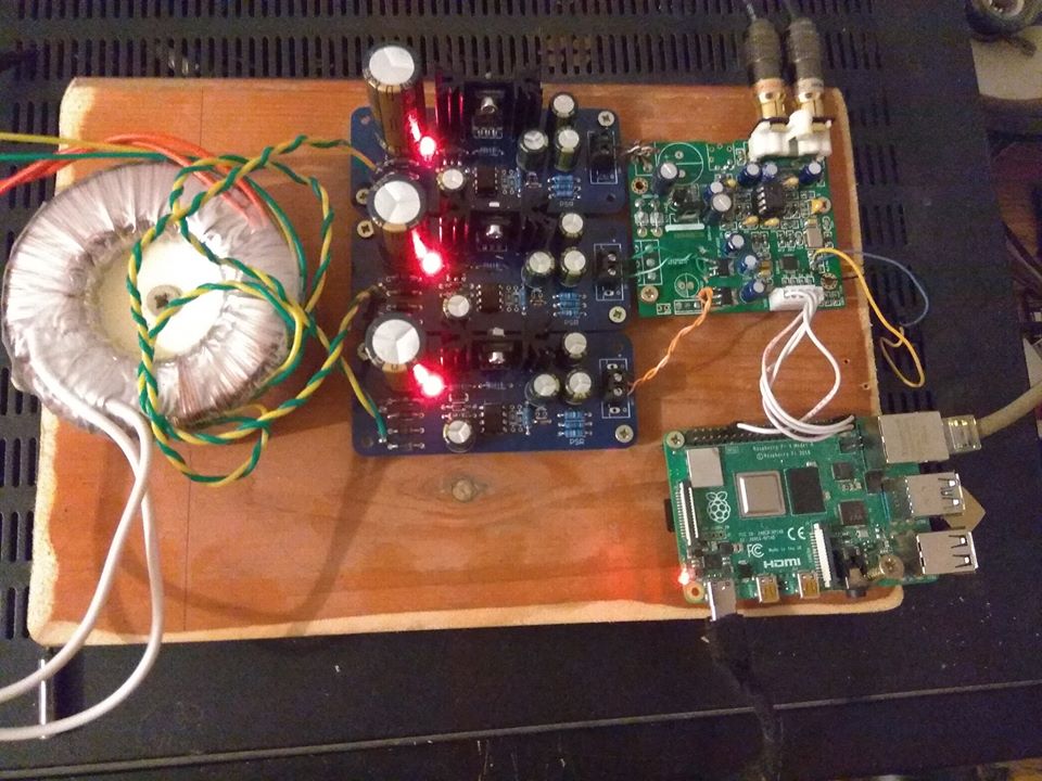

I must confess I did not read the whole thread but have a thing to contribute someone may find useful: I built a Volumio setup using the ES9018K2M including some tweaks and a python-based driver to go with it.

I have a question: this combo can play DSF files?
Hi Istvan,
I do not use this format but I just checked. It plays DSD files no problem. I tested stereo files in 11.2896Mbit/s and 5.6448Mbit/s and both worked fine, just make sure to set it to 'DSD direct' playback.
I use FLAC for high quality audio tested up to 24BIT/192kHz, 16bit works as well with my python driver running but is very distorted without setting the proper registers in the DAC.

Thanks for the reply!
This is my interpretation: I'm using 3 of Walt Young's Superregs, one for analog stage, and 2 for digital (directly to 1117 regulator's inputs)
The next stage is +/- power supply for opamp and change capacitors to betters.
