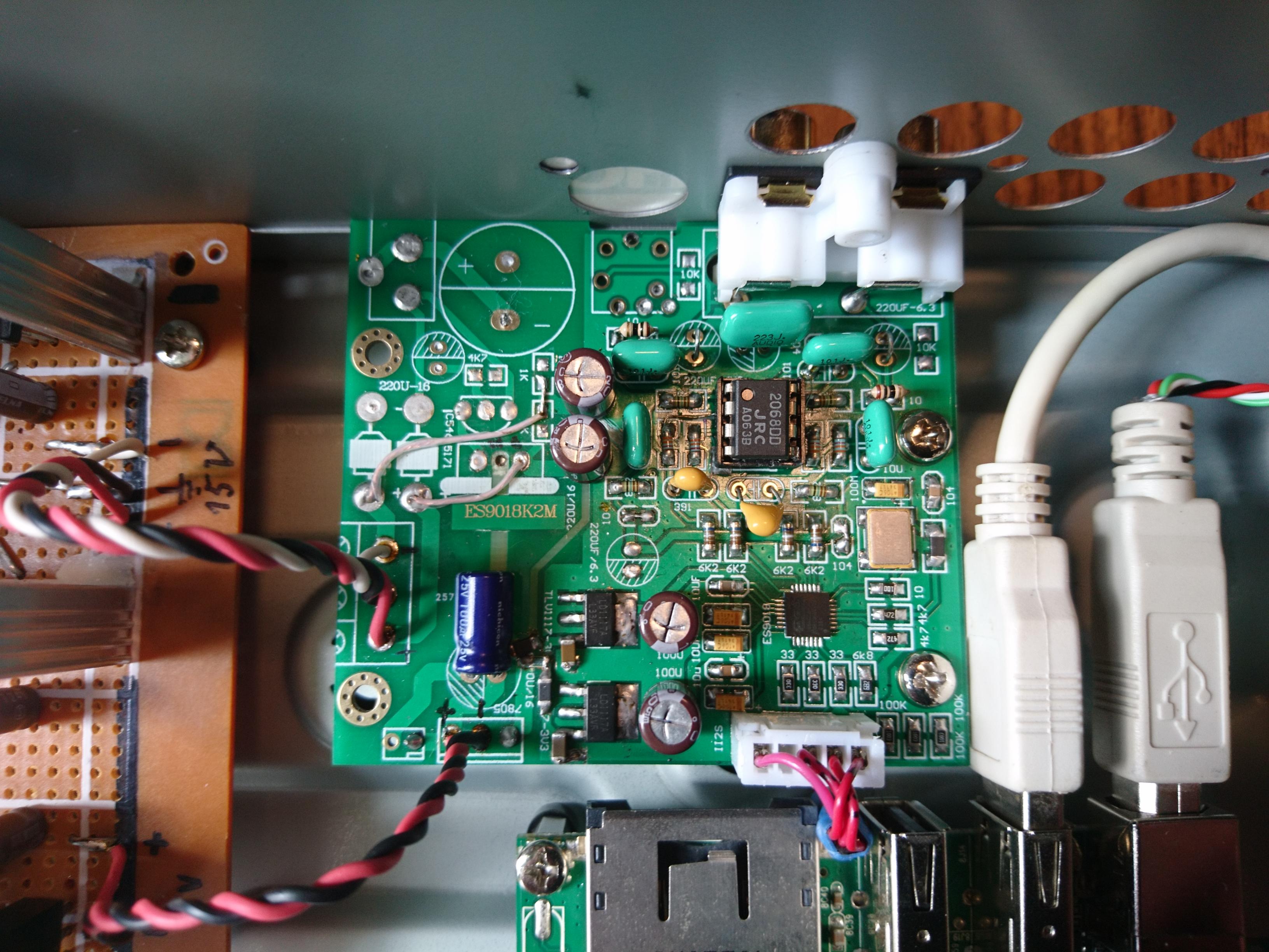

For anyone here to find out about the original question regarding that exact type of ES9018K2M board I found some additional info I was not able to find in this thread nor anywhere else as collected info.
I have I2C volume control up and running on this board thanks to the hifiduino project. The code to fully control the chip over I2C can be found here:
https://hifiduino.wordpress.com/2014/06/13/sw-control-for-es9018k2m/
It took me quite a while to figure out the correct pins on this chip, SCL is pin 3 and SDA is pin 4, they both have a 4k7 pullup resistor to 3.3V that can be tapped easily.
Example to adjust the volume of both left and right channel with Arduino:
What I found with this type of board is that the bypassing caps are placed very badly. This results in a lot of noise being output by the DAC itself and I was unable to solve this. The amplifier noise level when the DAC is disabled (no I2S signal input) is reasonably low i.e. not measurable with a scope and also not audible (with cheap headphones directly on the board output). But as soon as the DAC gets a signal the noise is clearly audible and even visible on a scope. The level I measured is about 80mV (!). Changing the attenuation over I2C does not change the noise level. Also the I tracked the noise to be coming from the BCK signal as it shows peaks at exactly that frequency (5MHz in my case).
With the board not being very well designed I don't think it is possible to get rid of this noise so I ordered a different one, just a little more expensive but way better placement of the digital filter caps. Curious to see if that board performs any better.

Hey yall. I had the ess 9028 model of the same board. I dont know if that one comes with an lm317 but mine did. It was a generic. Luckiest thing happenned to me. I put a heatsink on and it snapped off after about a month. Lucky because I had a few st micro lm 317Ts sitting around. Soldered one in, attached heatsink and bleaough boy! The sound became better. It originally had issues around 1hr of continuous use. Those issues all gone. Sound a million times better imho plus in my humble reconstruction from memory. Hope the info helps others. Next great improvement... replacing the crappy generic ne5532 chip that comes with it With a Texas Instruments NE5532. Sounds the other million times better. Now a great unit. I agree 80% volume or certainly <100 sounds best. Im using dc input. Along with an amanero Any thoughts about ac being better? Ive got a massive supply and thing really sounds great with all fixes mentioned

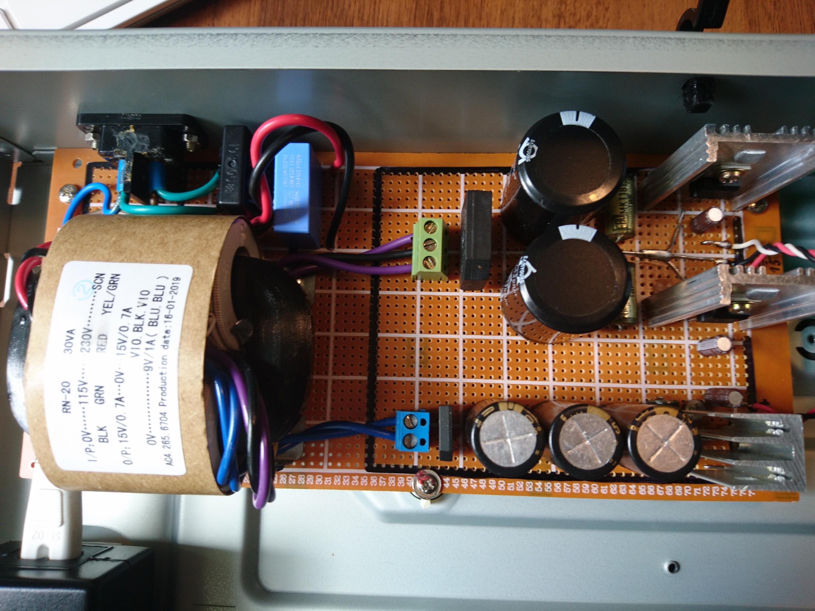

The 15-015 VAC connector is useless. You only have 2 Diodes there (even not perfect for the AC-DC conversion), and just a single reg, so it does not make sense to power the board with a dual voltage trafo. I use the board with a DC of ca. 11V plugged into the round DC plug.
2 diodes is enough for a balanced trafo. Considering it has 3 inputs there inc. neutral that seems lkke the only way. Not much of a filter beyond that. Agree with you there the 9028 filter, or general ac jnput on that cheapest chinese board looks pretty crappy and not able to give my lab psu a run for its money even with a massive balanced trafo. Still wondering if by some miracle it could sound better. Also nervous about connecting to the thing so havent tested yet. Hmmm

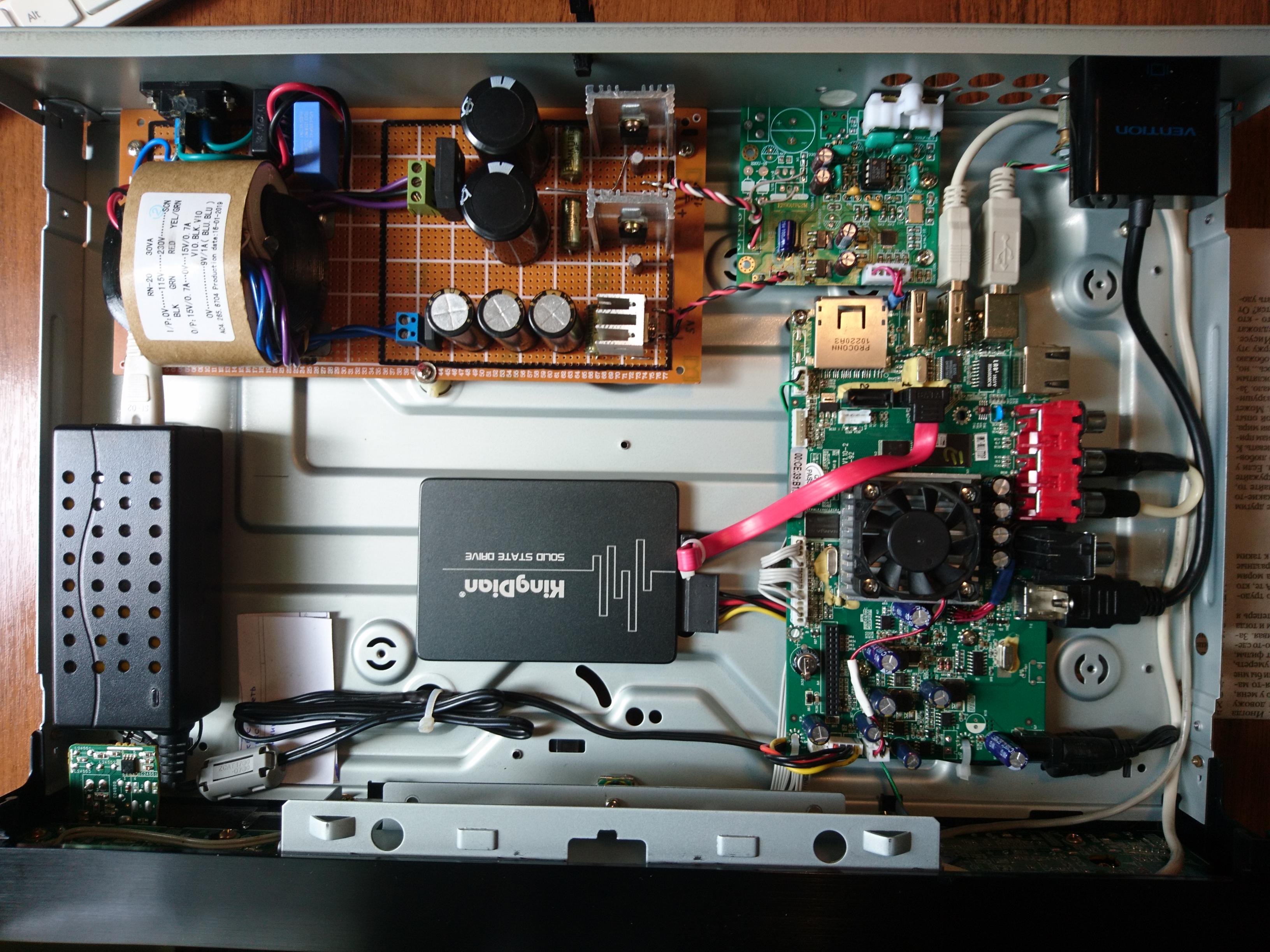

Refined food opa2134 feeds + \ - 15v
I hesitate to ask, and the circuit of the power supply and the circuit Board 3.3 volts can put? I see on the Board native Soviet resistors are
- Digital Line Level
- Chinese ES9018K2M I2S DAC
