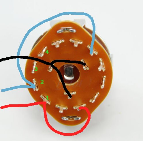

Using a rotary switch to change inputs. No switching noises ! Very smooth operation.🙂

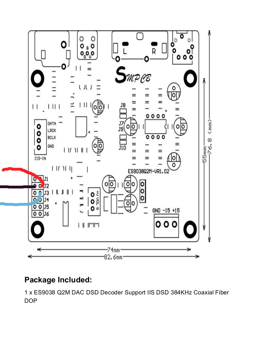

Would you be so kind to draw some sort of schematics?
No idea as to how it would perform using i2s direct as there are no drivers (yet?)
Maybe on the drivers AUDIOPHONICS I-Sabre DAC ES9028Q2M Raspberry Pi
Of the switch and connection ? Attached..
3pole 4position switch.
Position 1 connects as if jumper J2=optical spdif in,
position 2 as if jumper J3=coax spdif in,
position 3 as if jumpered both J2 & J3=i2s in,
position4 no connection so acts as mute.
It matters not which pin the black wire connects to on that side on the board header as they are all shorted to each other.

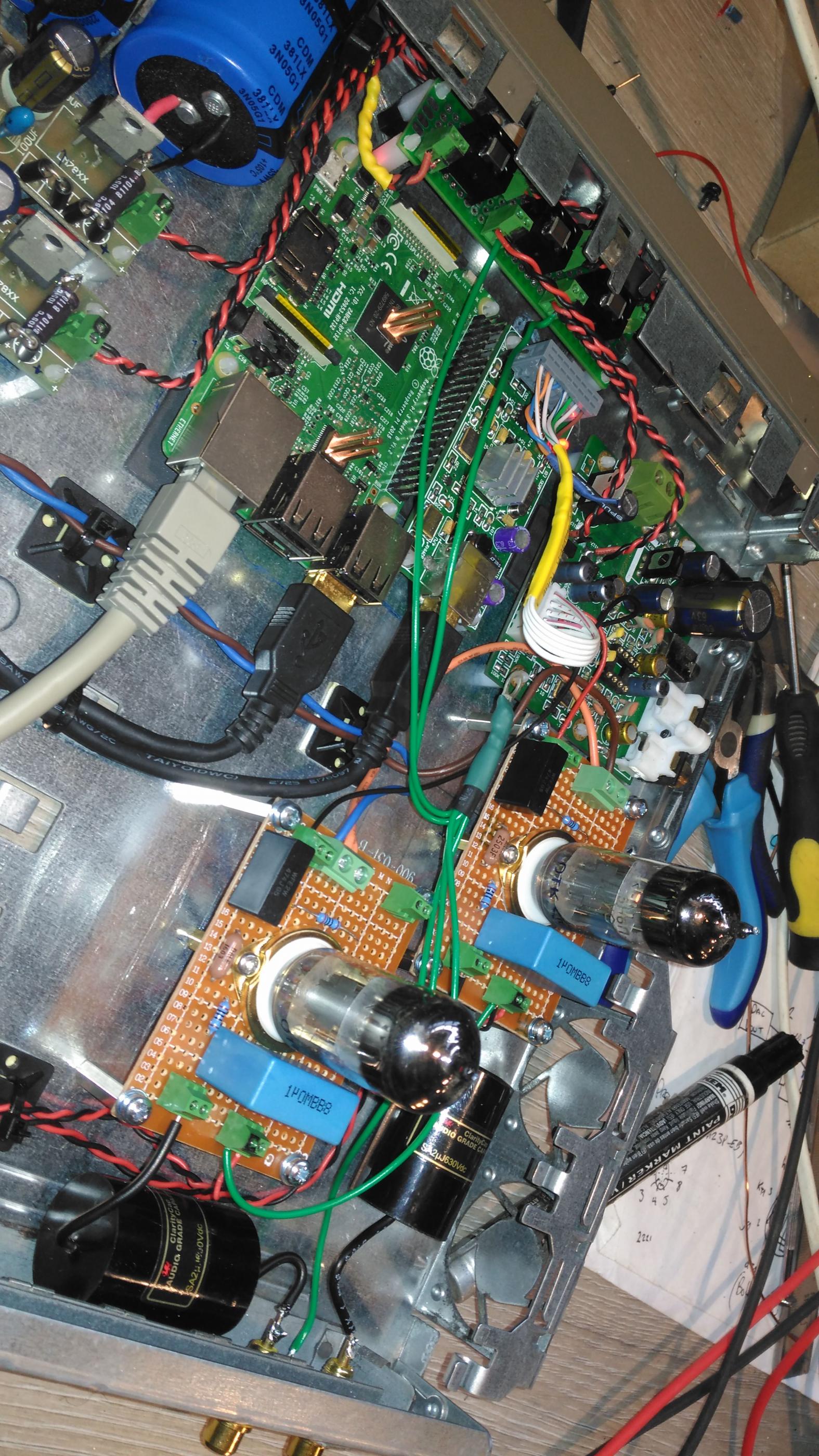

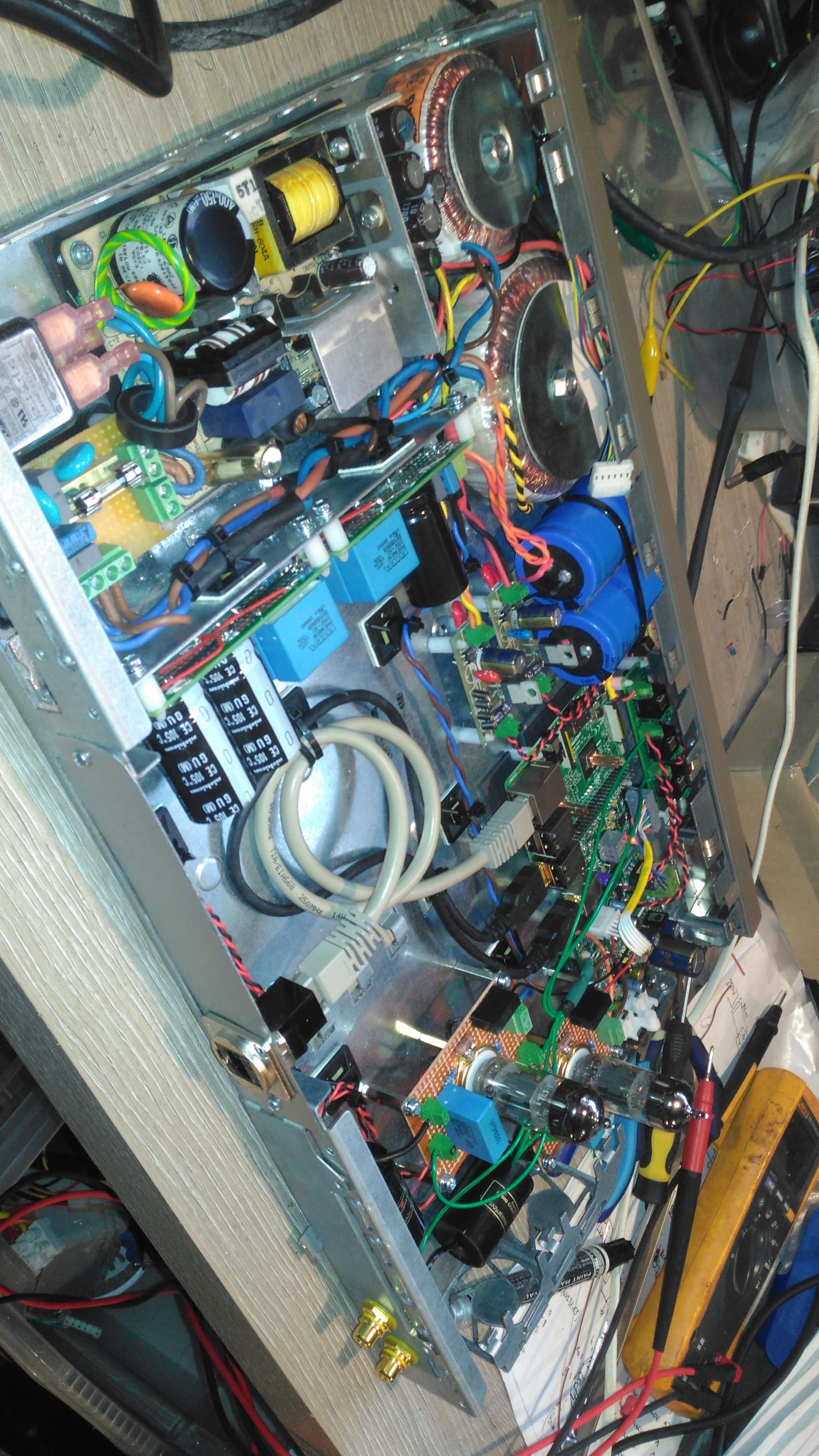

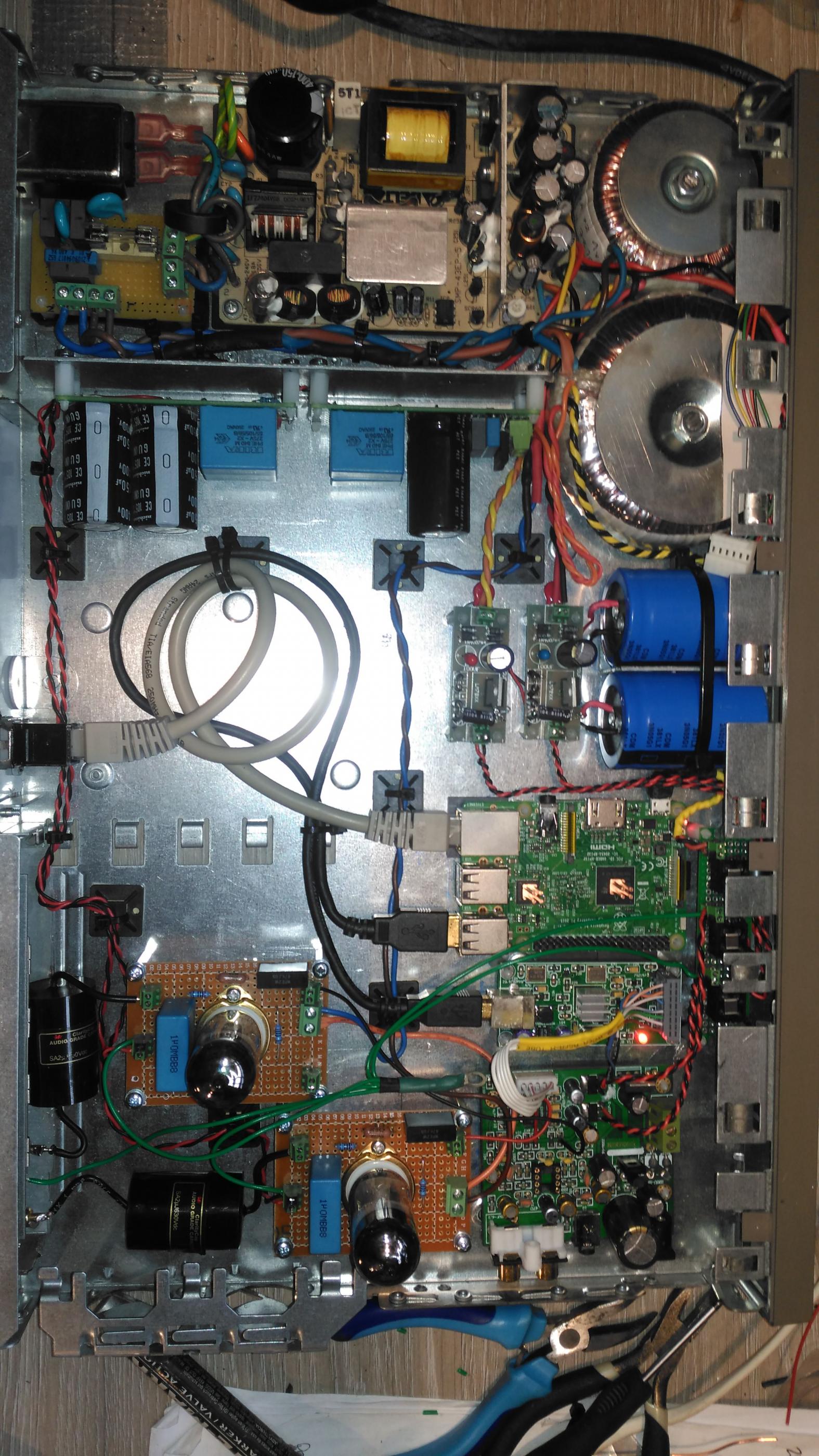

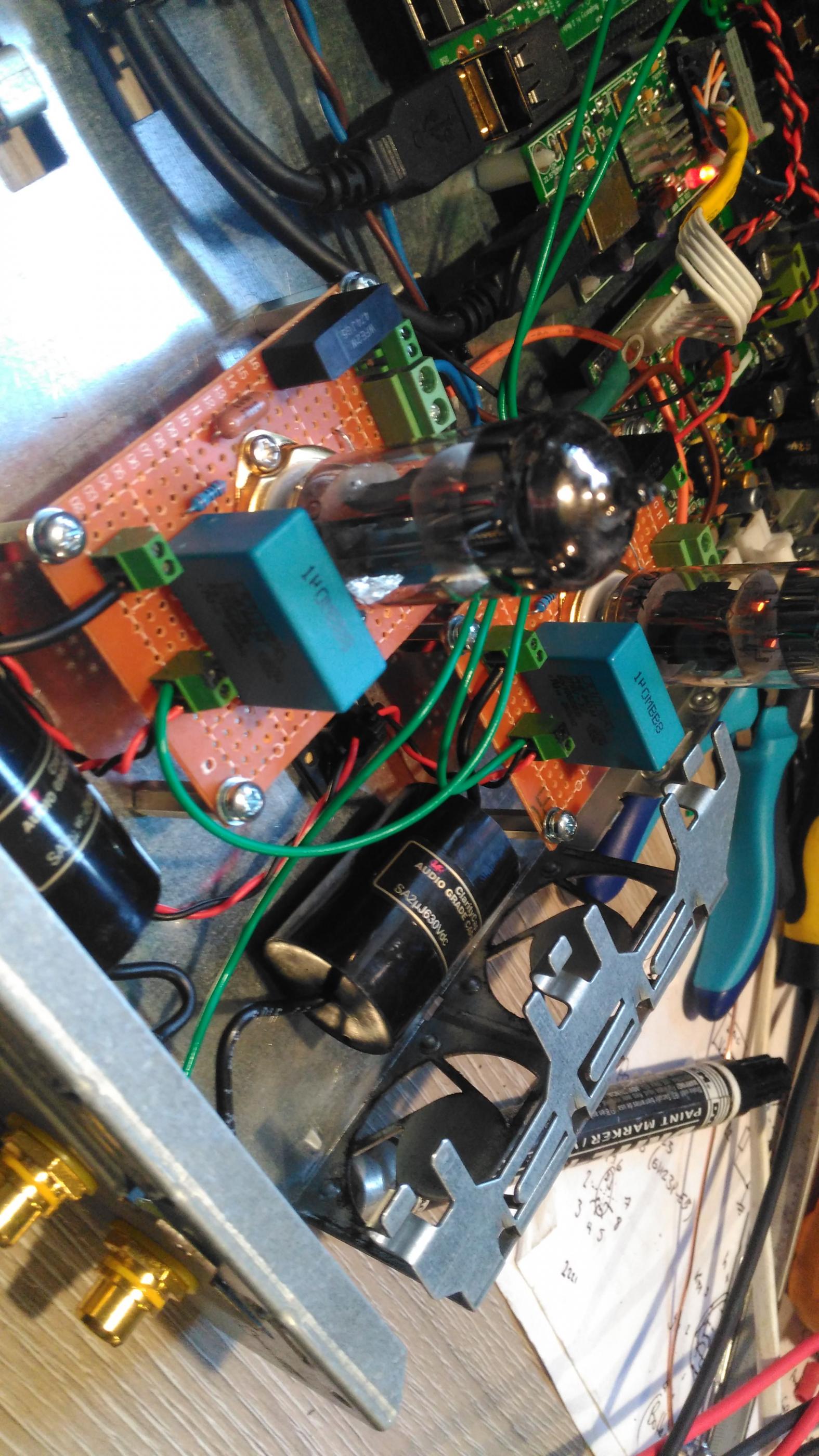

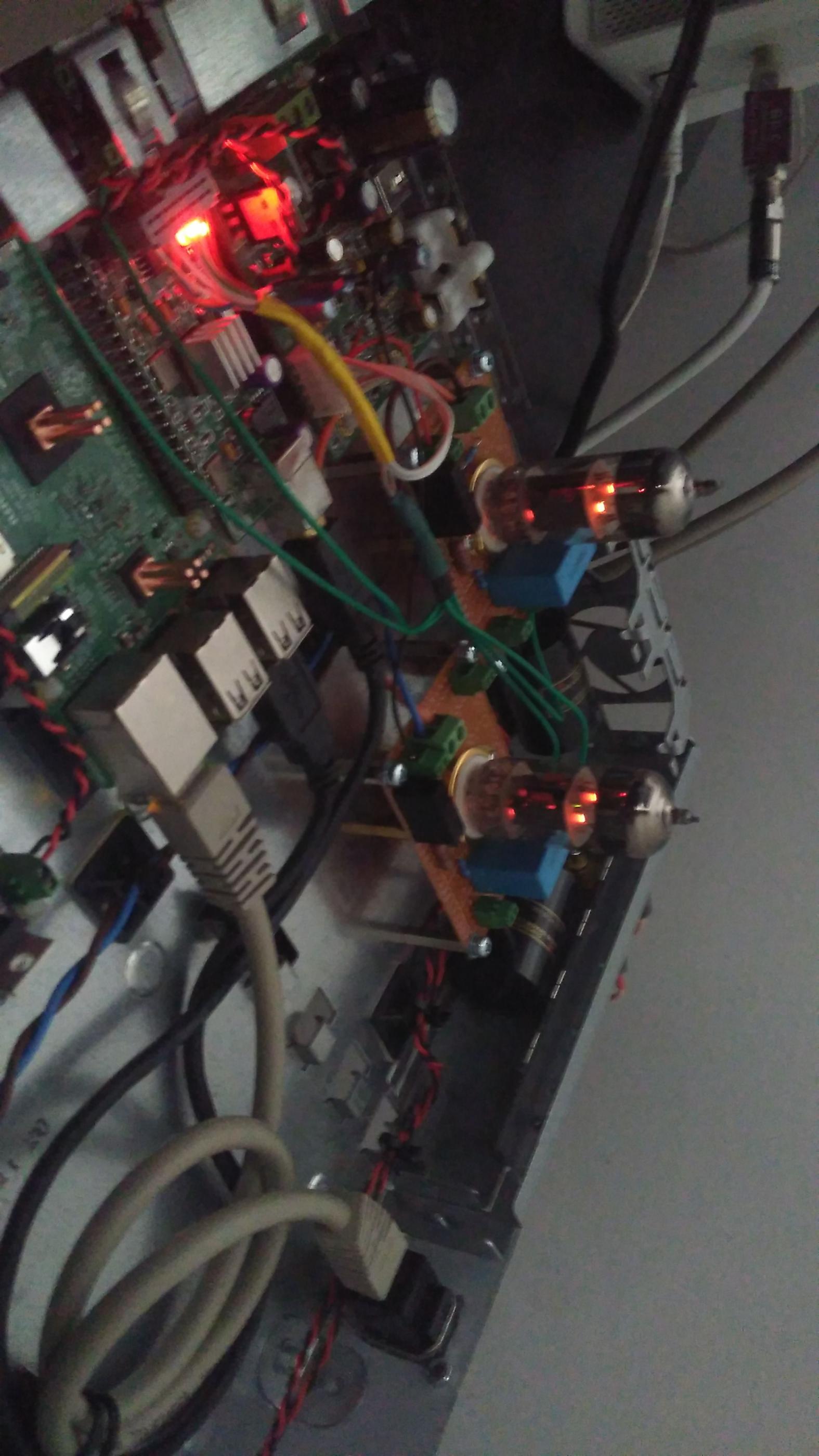

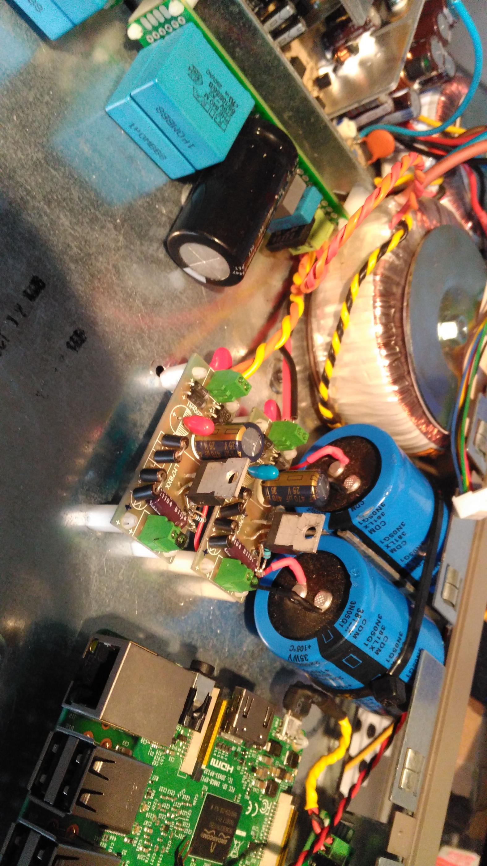

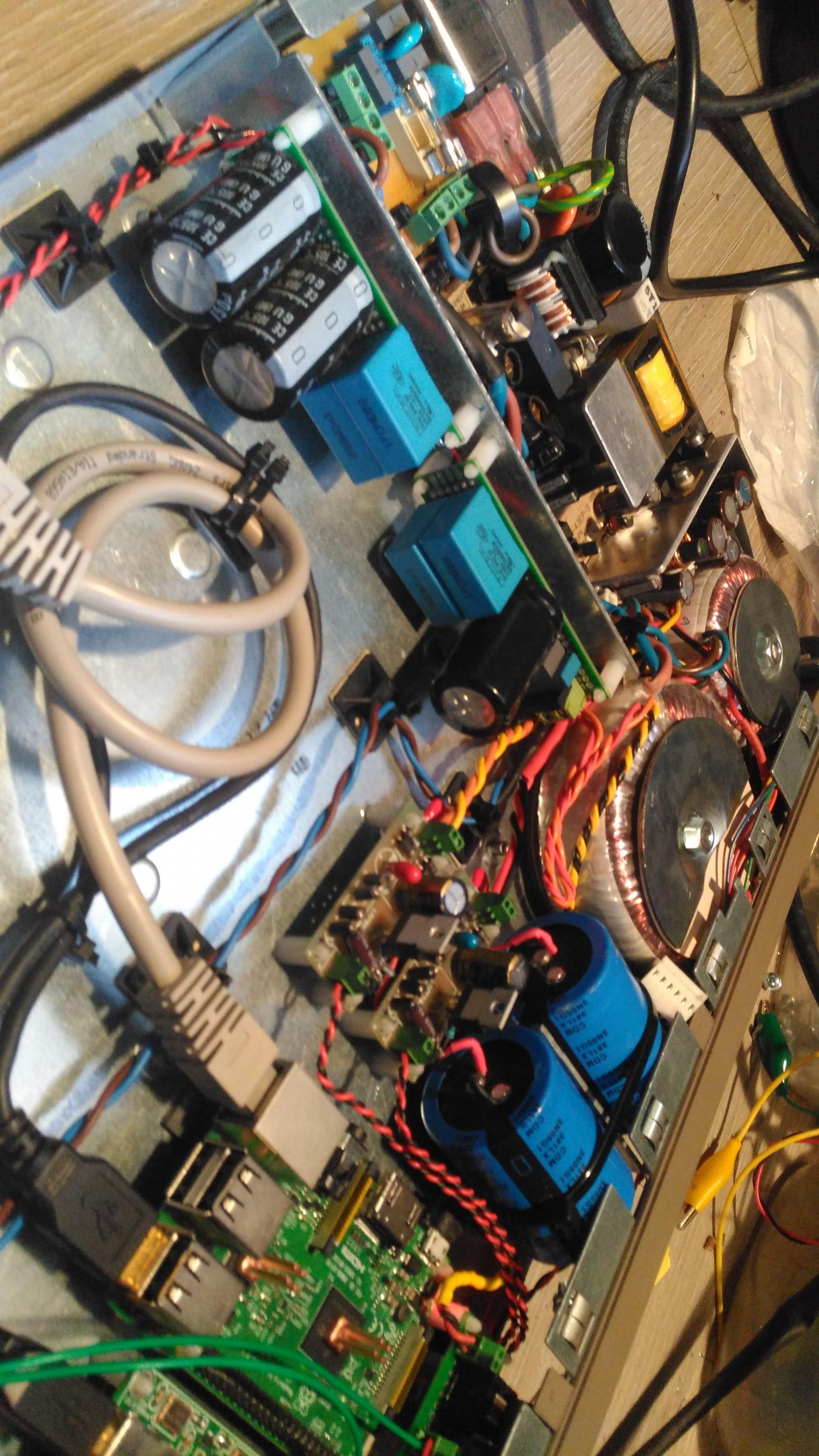

Thought id add to this as i'm on the forum and just spent a while making this.
I got this board last year, as is, tested with a dir9001 gave it a listen and was super disappointed. you can tell when there is scope for improvement and this was too far in the wrong direction. i threw it in the big box of boards and forgot about it. two months a ago i decided to build a 1 box music streamer/DAC with an Rpi this DAC (to prove concept) to listen to DSD and to replace my squeezebox + dac. This is now my main DAC.
pics attached.
enclosure: old network hub thing, used the SMPS within
110v AC 80VA toroid, 180vdc CRC
x2 9V 30VA toroid 317 - 1117, each 317 tapped direct to 9018 board with traces cut to separate
SMPS: +5.25v to Rpi3, +12.6v to heaters
RPI3 running max2play, music stored on network
xmos u8 USB
ES9018K2M (old cheap $9 one not the one with bigger board or fancy black one), literally using 9 components on the board.
SRPP output direct from DAC pins
6N6P valves
clarity cap PP output caps
Ive used only what it needed to keep cost down and i'm amazed at how good it sounds.
pics attached.
xmos u8 USB
6N6P valves
