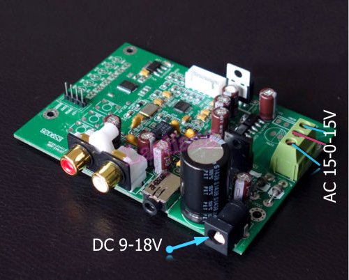

In my case dc was under 12V
My ac is same as you have, but some of the board configure as 0-18-18 to allow non split power inputs. Picture and part number should clear it up.
The 15-015 VAC connector is useless. You only have 2 Diodes there (even not perfect for the AC-DC conversion), and just a single reg, so it does not make sense to power the board with a dual voltage trafo. I use the board with a DC of ca. 11V plugged into the round DC plug.

Here some update to my symmetrical es9028q2m board:
I installed the Kali and now the delay of 2-pin power line is no more necessary. It seems Kali provides a Signal early enough to the DAC so that the volume Setting is not reduced after booting - puuhh ;-)
Sound is very natural and smooth with the LME 49720 and 49710 opamps, but also bass lost a Little texture compared to previous Trial with 5532 and w/o Kali. I also recognized some hizz noises when stopping playback - maybe coming from the I2S coax-wires from Kali to DAC that pass quite Close to the opamps - I will try to move them away from analog circuit.
But one Thing made me worry - I realized a channel switch from left to right I cannot explain. It must be on digital side..anybody has an explanation? Is it the LRCLK wire? Or a different length of I2S wires that could lead to such error or maybe a power-up Setting issue with DAC chip or MC. After a reboot the channel setting was OK again...

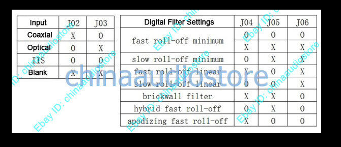

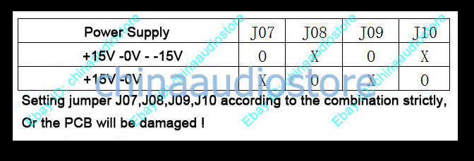

ES9038Q2M DAC Selectable FIR Filter Support I2S DSD 384Khz Headphone RCA Out
Support DSD64 DOP input via coaxial&optical, DSD256 via I2S input
Up for sale is an assembled DAC board of ES9038Q2M, It is the latest product from ESS with improvements from ES9028Q2M, The DAC is under soft control with optimized code, No noise when switching DSD and PCM signal, Three ways input can be connected at same time and can be switched with jumper
High Lights
MCU controllor onboard, The DAC receive I2S and DSD input
Support coaxial and optical input, Support sampling rate from 44.1Khz to 192Khz and DSD64 DOP.
There is a connector for volume control, One 10K ohm potentiometer can be series connected to adjust volume.
ES9038Q2M is successor of ES9028Q2M, The sonic is more mellow and juicy,Support DOP input via optical and coaxial which only coaxial is possible for ES9028Q2M.
Default opamp is NE5532DD, Can be subsitutated with better opamps
Improted high precision oscillators
High quality gold plated RCA terminals, Shielded heapdhone output for low noise
With signal locking indicator and DSD signal indicator.
Support 3.5mm heapdhone out and RCA stereo output.
Note: NE5532 opamp can be upgraded to MUSES8920 or MUSES02, Pls contact us if you want.
Specifications
1)Size: 77mm*83mm
Power input:
2) single DC 15V 120ma
3) Dual DC 15V (15V-0-15V), +15V 120ma, -15V 10ma
Default product is dual 15V, Can be changed with jumper,Pls operate follow the table strictly
4)support sampling rate
Optical&coaxial input: DSD64 DOP
PCM:44.1KHz,48KHz,88.2KHz,96KHz,
176.4KHz,192KHz,352.8KHz,384KHz
DSD: 2.8 MHz (DSD64) - DoP,native
5.6 MHz (DSD128) - DoP,native
11.2 MHz (DSD256) - native
