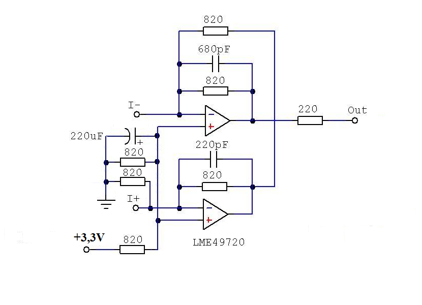

Amazing and cheap boardThe original board shows the third harmonic of the 1kHz 0dB at around -87dB. After the buffer was replaced with this one simple schematic with the +/-15V supply :

After measuring disappointing results, I was looking into how to get the best out of exactly the same board, more particularly starting with finding the particulars of this DAC chip. No specsheet to be found.
Victor to the rescue with this ready made and tested solution. Thanks for posting! I love the simplicity.
What I wonder though is why the upper opamp has a 680pF pole setting C in the feedback loop, and the lower one a 220pF? This might not be correct. I suppose they should both be 680pF (at least).
Best,
Paul
Best,
Paul
Thanks for the response, Paul.
Signal from the lower opamp goes thru the upper opamp and gets it's pole. Ideally would be, when the lower opamp has no pole, but in reality it is impossible. Lower opamp needs a capacitance shunt in feedback for the stability in real conditions. Maybe the 220pF capacitance can be lowered.
The overall measured result is very good (almost perfect), and one of the main advantages is that the both opamps run in the inverted mode when the distortion figures are low as possible.
All the best,
Victor.

I tried the I/V of victor, resistor value changed from 820 to 680, non inverting input connected to ground, i use diyinhk board which use +/-12v rail. Now i get 1.41V DC at output, why does this happened? with the original lpf, the output is held at 0V.
You can try this modified schematic for to get 0 DC at output :
