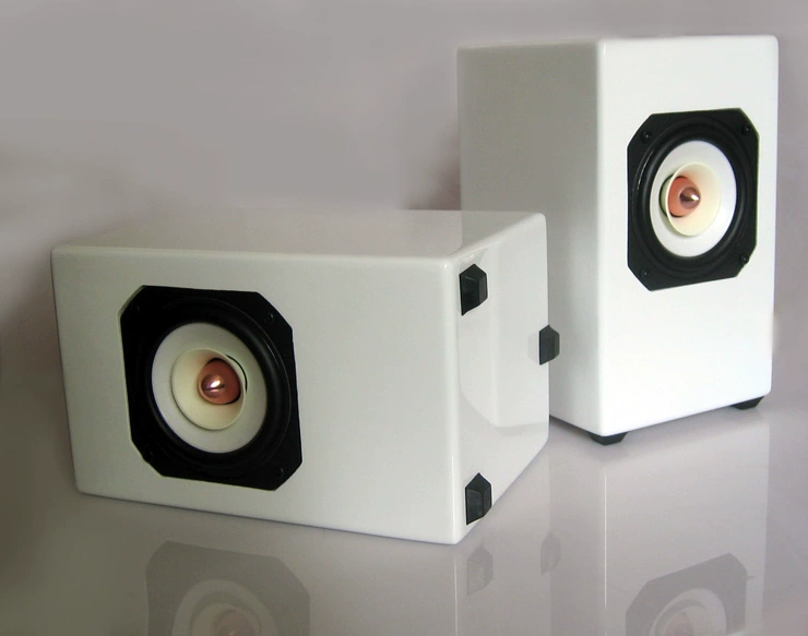

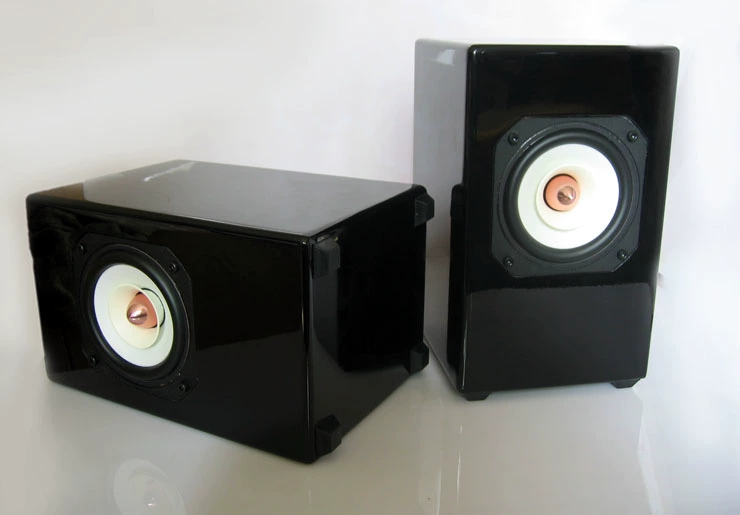

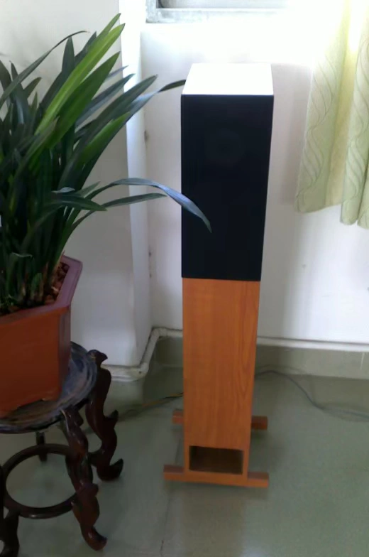

This is to confirm I have implemented my sealed cabinet see image attached.
how low can they go
vmps
how low can they go
vmps
For a sealed box and with these dimensions it can hit -3db(simulated measurement) around 95Hz and I use a subwoofer dial to around 100Hz x-over with it.
I am listening to it right now with the above combo it sounds great anyone building it will be happy. It costs me US$90 for the drivers(2 units) and the cabinet is very simple. I read many reviews on the best 2-way speakers and they one thing in common, the cabinet dimension ratios are very close to each other. I duplicated that dimension ratios the result is it throws a large sound stage(*) for such small speakers. Couple with no x--over it sounds really good and they are driven from a pair of common amplifier(15watts) with an integrated CD player.
* actually I intend to use it as my computer speakers, it exceeded my expectation. Mind you I have built a pair of Fe167E(left unused) before, I like these speakers better. I know what full range sounds like.
Cheers.
Cheers.
thanks for they infor, i may try them out

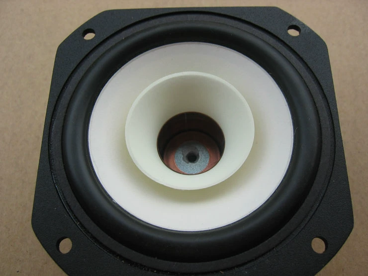

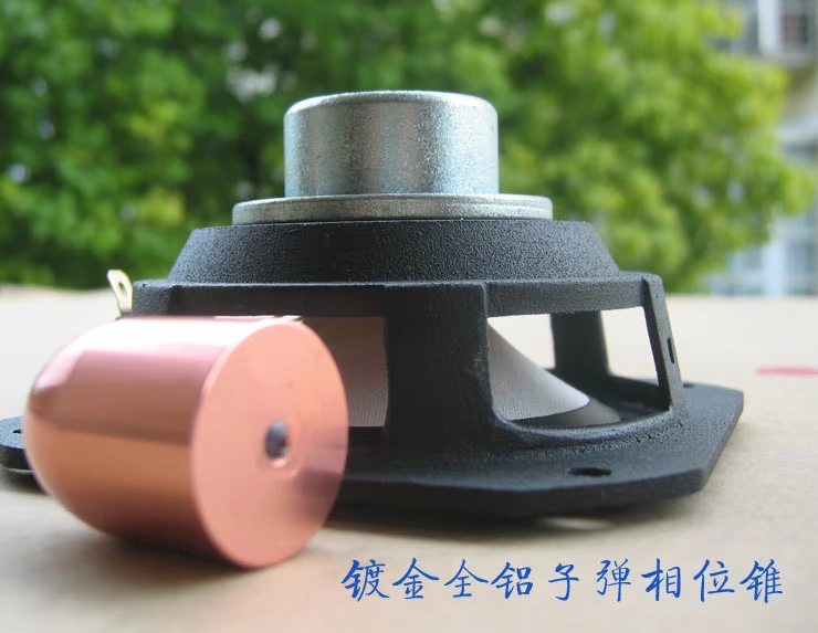

I also bought a pair of these off e-bay, based I have to admit on the photos.
Had I seen a picture of the tiny magnet on the back though, I may have thought twice.
I hope I'll be surprised when I try them out!
Hi, I'm quite interested in buying some of these, what was the buying experience like? Did you have to wait long? What import charges were there?
It's a neodymium magnet, not to be confused with ferrite which needs to be much larger to yield the same strength field.

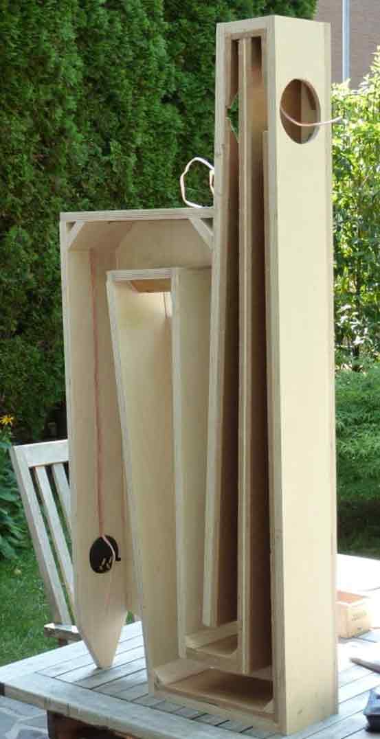

horn
i think my double horn KORNETT will work
very good with a cheap invers driver in the back
like Monacor SPH-60
look my HP
measurements and translate the feedbacks!

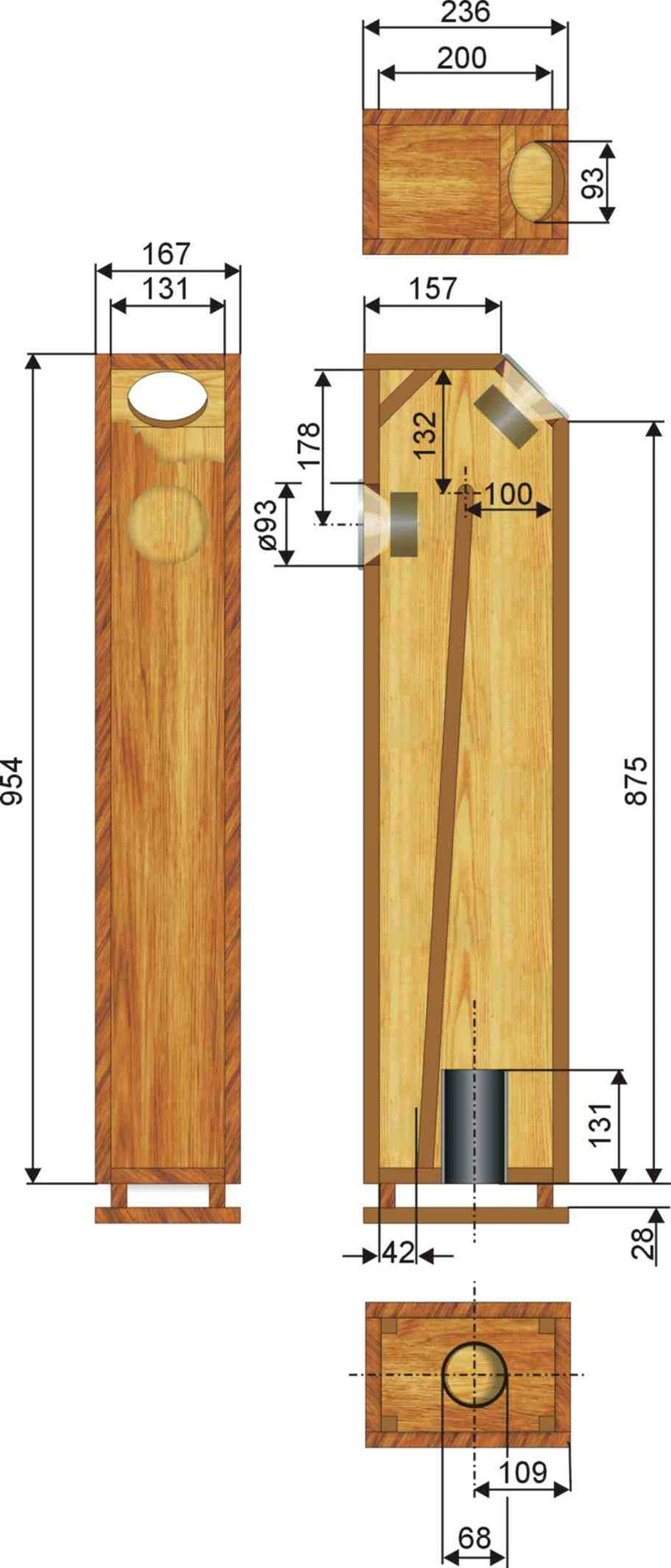

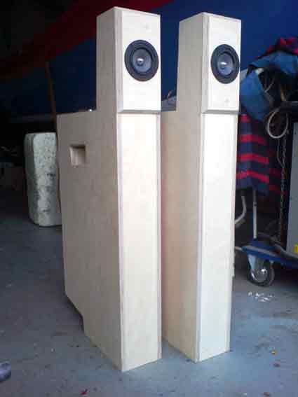

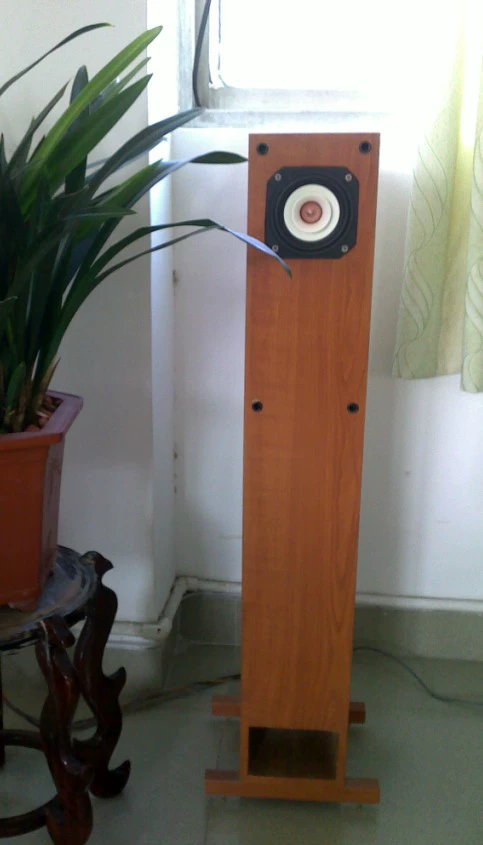

Drivers on Zigma

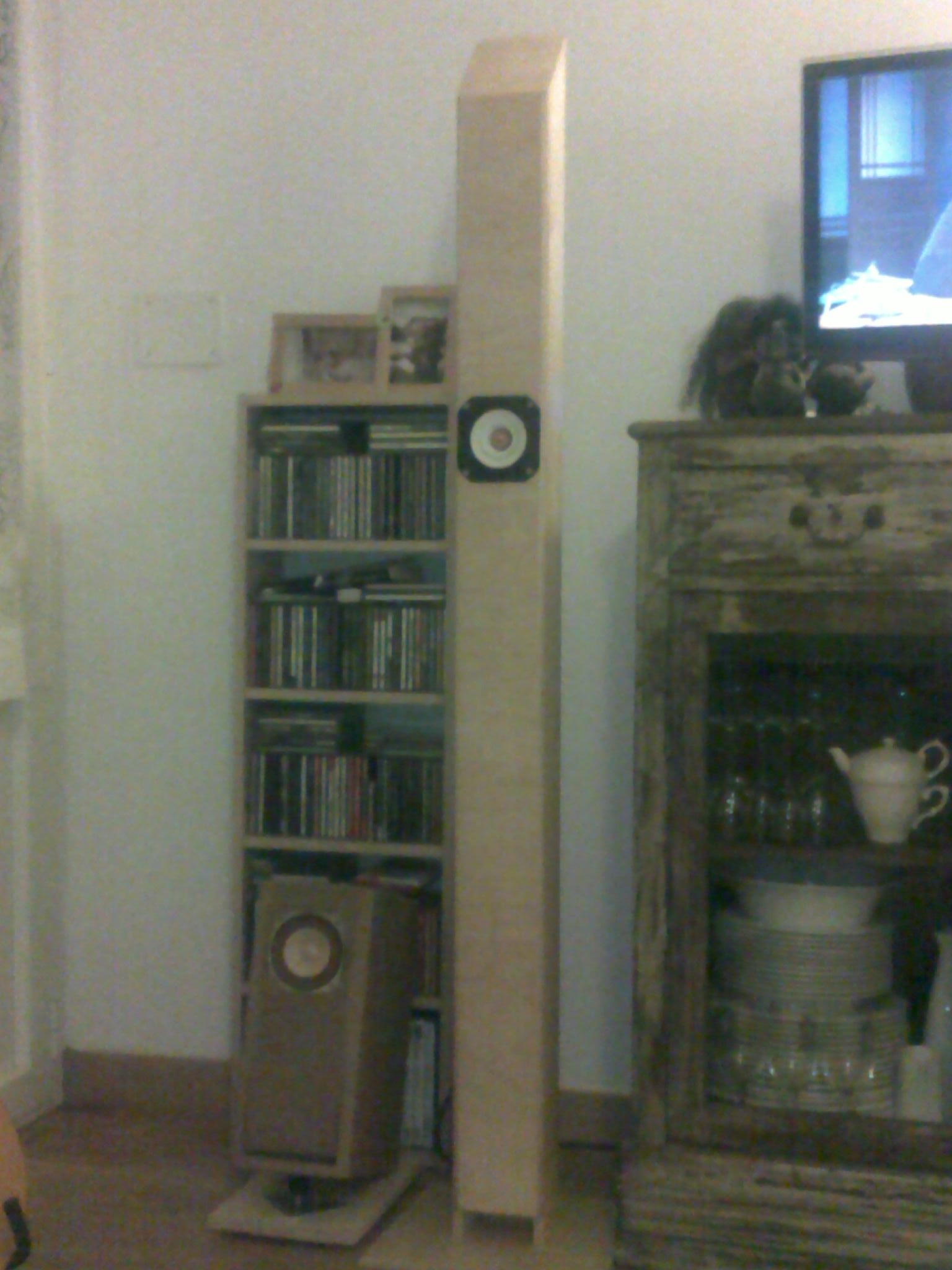

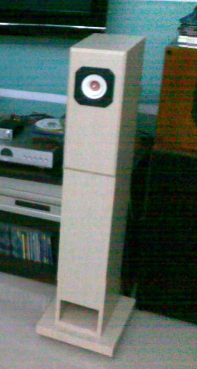

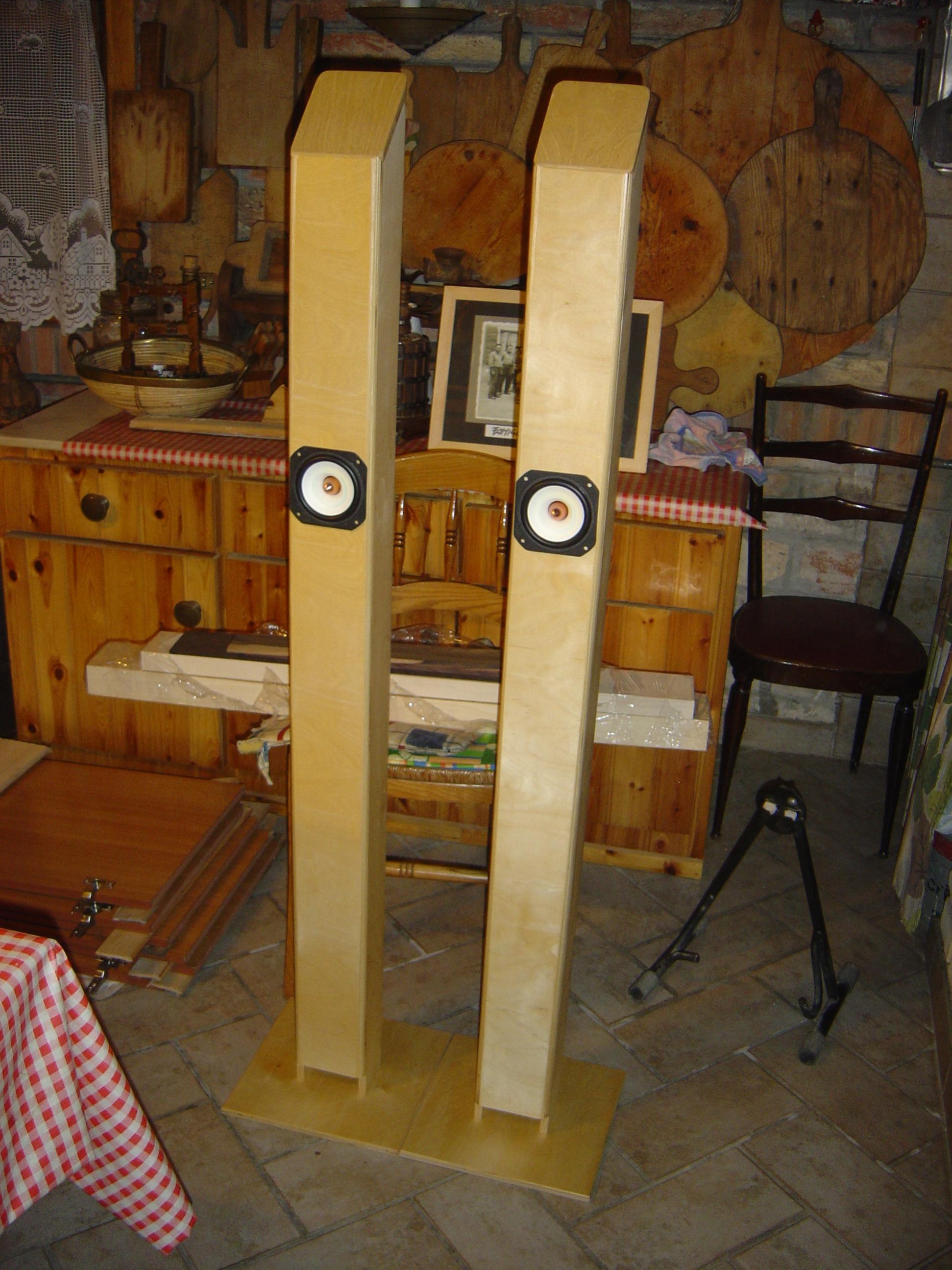

Good evening,
As I wrote before I tried to put these speakers on Zigma's enclosure.
My main speakers are a pair of JBL en3 with s21 (in other word: a bigger L65), so you can image how surprised I was when I clearly heard the bass Moog on "The old castle" (ELP Picture at an exhibition) from those skinny speakers...
(2nd tumbnail)
I also compared them with standard fe103 on the same Zigma and on Pico-Lino coupled on the floor (as you can see). I think the latter solution gain a little more bass.
(1st tumbnail)
So, summing up, I think fostex are more natural on mid and high, but the chinese speakers can go really low and I think their response are al lot wider than fostex's.
I'll post more after the next 25 hours of playing.

I have similar speakers, did you flush mount your drivers?
I found the highs are little more pronounced( I should perform some measurement to confirm this) and should be tamed, after more than 50hrs of listening.
Overall I really like this driver better than my Fostex FE167, they add more body to the sound reproduction, whereas FE267 sounds very thin in comparison.
No, i mount them straight over the wood without carving it. I use 12mm birch plywood, with 45° cut behind the speaker to let him "breath", so I couldn't make the front baffle thinner!
I agree with you: they give more body to the music than my fe103.
How did you tame the high frequencies?
I haven't fix the HF response yet, flush mount will obviously help, I strongly suspect there is a rising response.
My initial thought would be a simple parallel inductor and resistor value (a high freq.shelving equalization BTW, I have yet to measure FR) starts around maybe 6-8Khz.
or alternative
add a tweeter(or super tweeter) x-over at possibly 6-8Khz, a 6dB slope(on either end) may work. This approach will improve dispersion and directivity as well and at the same time will give you a smooth top end.

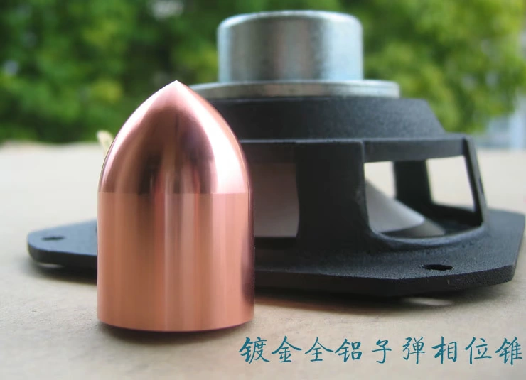

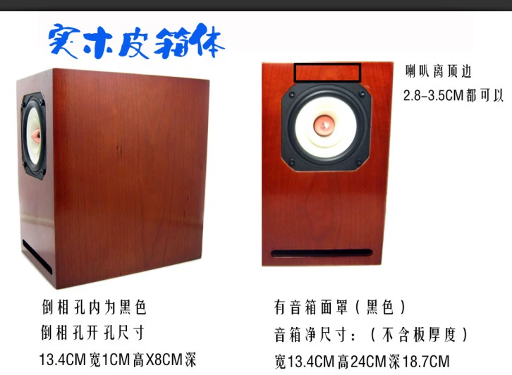

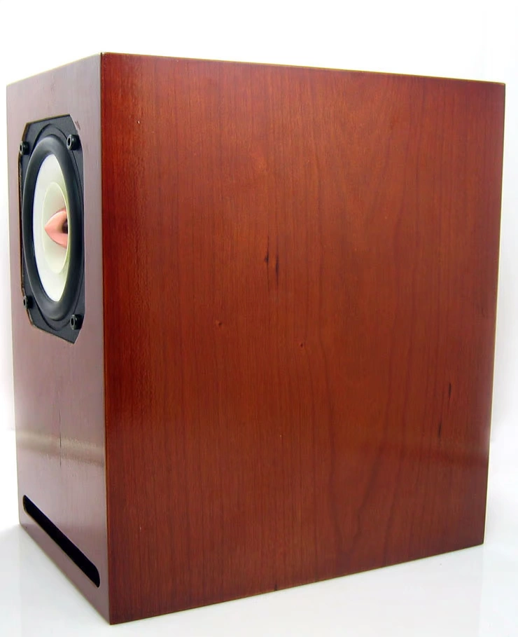

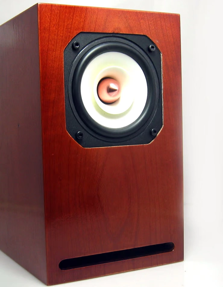

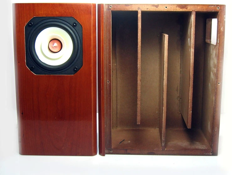

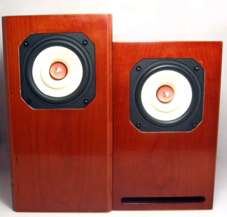

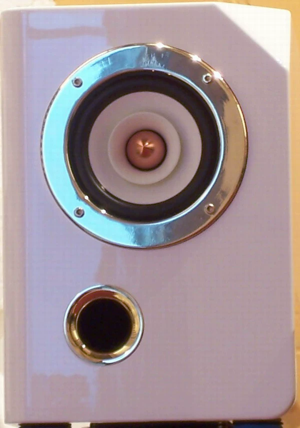

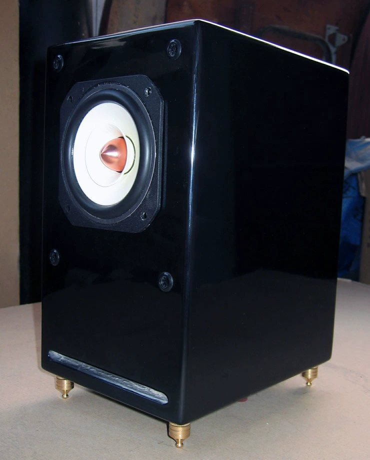

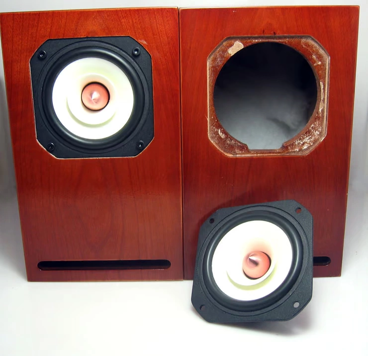

Photos stolen from the internet:
![T2KIxkXdVXXXXXXXXX_!!55799068.jpg](/community/proxy.php?image=http%3A%2F%2Fimg04.taobaocdn.com%2Fimgextra%2Fi4%2F55799068%2FT2KIxkXdVXXXXXXXXX_%21%2155799068.jpg&hash=15d86f2165fb2610a644a2768cd825b8)
![T2zZBkXXlXXXXXXXXX_!!55799068.jpg](/community/proxy.php?image=http%3A%2F%2Fimg06.taobaocdn.com%2Fimgextra%2Fi6%2F55799068%2FT2zZBkXXlXXXXXXXXX_%21%2155799068.jpg&hash=1eab4975043be1207840d054e37d1132)
![T2DItkXkNXXXXXXXXX_!!55799068.jpg](/community/proxy.php?image=http%3A%2F%2Fimg07.taobaocdn.com%2Fimgextra%2Fi7%2F55799068%2FT2DItkXkNXXXXXXXXX_%21%2155799068.jpg&hash=9e3f479a00cf59410c9d8756cac632af)
![T2FAXhXc0aXXXXXXXX_!!55799068.jpg](/community/proxy.php?image=http%3A%2F%2Fimg04.taobaocdn.com%2Fimgextra%2Fi4%2F55799068%2FT2FAXhXc0aXXXXXXXX_%21%2155799068.jpg&hash=c24f27d7395c5e029feb3c2507c9e695)
![T24cxhXX4aXXXXXXXX_!!55799068.jpg](/community/proxy.php?image=http%3A%2F%2Fimg04.taobaocdn.com%2Fimgextra%2Fi4%2F55799068%2FT24cxhXX4aXXXXXXXX_%21%2155799068.jpg&hash=1c8363ea5c812f3427cf2479d76777ed)
![T2dIxhXfJaXXXXXXXX_!!55799068.jpg](/community/proxy.php?image=http%3A%2F%2Fimg05.taobaocdn.com%2Fimgextra%2Fi5%2F55799068%2FT2dIxhXfJaXXXXXXXX_%21%2155799068.jpg&hash=d520719f41c15934b823078c01bba7da)
![T2XcxhXf4aXXXXXXXX_!!55799068.jpg](/community/proxy.php?image=http%3A%2F%2Fimg02.taobaocdn.com%2Fimgextra%2Fi2%2F55799068%2FT2XcxhXf4aXXXXXXXX_%21%2155799068.jpg&hash=ff7eaaf38cbbe92803c427f91ed1c660)
![T2v90pXoVXXXXXXXXX_!!55799068.jpg](/community/proxy.php?image=http%3A%2F%2Fimg02.taobaocdn.com%2Fimgextra%2Fi2%2F55799068%2FT2v90pXoVXXXXXXXXX_%21%2155799068.jpg&hash=10c2d608129480cd0d65dd11e41e4a67)
![T26cphXfNaXXXXXXXX_!!55799068.jpg](/community/proxy.php?image=http%3A%2F%2Fimg04.taobaocdn.com%2Fimgextra%2Fi4%2F55799068%2FT26cphXfNaXXXXXXXX_%21%2155799068.jpg&hash=52fa63edc73ff8a0e3227f3c56d10c66)
![T23ZthXgxaXXXXXXXX_!!55799068.jpg](/community/proxy.php?image=http%3A%2F%2Fimg05.taobaocdn.com%2Fimgextra%2Fi5%2F55799068%2FT23ZthXgxaXXXXXXXX_%21%2155799068.jpg&hash=27b21d9c8f412a1d1ec06aa5adc54f17)
![T2iSxpXilbXXXXXXXX_!!55799068.jpg](/community/proxy.php?image=http%3A%2F%2Fimg03.taobaocdn.com%2Fimgextra%2Fi3%2F55799068%2FT2iSxpXilbXXXXXXXX_%21%2155799068.jpg&hash=ecbe4638f9a735a7511d8b50ff1a6b16)
![T2fSBpXehbXXXXXXXX_!!55799068.jpg](/community/proxy.php?image=http%3A%2F%2Fimg03.taobaocdn.com%2Fimgextra%2Fi3%2F55799068%2FT2fSBpXehbXXXXXXXX_%21%2155799068.jpg&hash=1ca6d41252c288a1eaac6ef17597d4d4)
![T2RDXpXbdXXXXXXXXX_!!55799068.gif](/community/proxy.php?image=http%3A%2F%2Fimg.taobaocdn.com%2Fimgextra%2Fi2%2F55799068%2FT2RDXpXbdXXXXXXXXX_%21%2155799068.gif&hash=ff509eb6d40e30474b9b1a95dca14147)
![T2WCxpXfFbXXXXXXXX_!!55799068.jpg](/community/proxy.php?image=http%3A%2F%2Fimg02.taobaocdn.com%2Fimgextra%2Fi2%2F55799068%2FT2WCxpXfFbXXXXXXXX_%21%2155799068.jpg&hash=3f71c4c7559052c07cfb8ace0a0574d8)
![T2Jm8pXgxXXXXXXXXX_!!55799068.jpg](/community/proxy.php?image=http%3A%2F%2Fimg02.taobaocdn.com%2Fimgextra%2Fi2%2F55799068%2FT2Jm8pXgxXXXXXXXXX_%21%2155799068.jpg&hash=dd39368e5bb97678738bb2f5af70a934)
![T2tMtqXoNaXXXXXXXX_!!55799068.jpg](/community/proxy.php?image=http%3A%2F%2Fimg04.taobaocdn.com%2Fimgextra%2Fi4%2F55799068%2FT2tMtqXoNaXXXXXXXX_%21%2155799068.jpg&hash=e40e8765e2bc54d9dbdeb3254717e1d2)
![T2cMtqXXFbXXXXXXXX_!!55799068.jpg](/community/proxy.php?image=http%3A%2F%2Fimg01.taobaocdn.com%2Fimgextra%2Fi1%2F55799068%2FT2cMtqXXFbXXXXXXXX_%21%2155799068.jpg&hash=74acaa074a51ca362d7fc55e4901a0c0)
![T2Q3pqXa0bXXXXXXXX_!!55799068.jpg](/community/proxy.php?image=http%3A%2F%2Fimg01.taobaocdn.com%2Fimgextra%2Fi1%2F55799068%2FT2Q3pqXa0bXXXXXXXX_%21%2155799068.jpg&hash=c0801b41d01bbb9787471ad18cb6fda5)
![T2DkVqXo8XXXXXXXXX_!!55799068.jpg](/community/proxy.php?image=http%3A%2F%2Fimg01.taobaocdn.com%2Fimgextra%2Fi1%2F55799068%2FT2DkVqXo8XXXXXXXXX_%21%2155799068.jpg&hash=4c79e3b55cc1005b513bf4f531ce426e)
![T2sAVqXXFaXXXXXXXX_!!55799068.jpg](/community/proxy.php?image=http%3A%2F%2Fimg04.taobaocdn.com%2Fimgextra%2Fi4%2F55799068%2FT2sAVqXXFaXXXXXXXX_%21%2155799068.jpg&hash=42a7b92c514341e4a8ebad8a7454f98d)
- Full Range
- Chinese/Taiwan 4” Dual Cone Speakers
