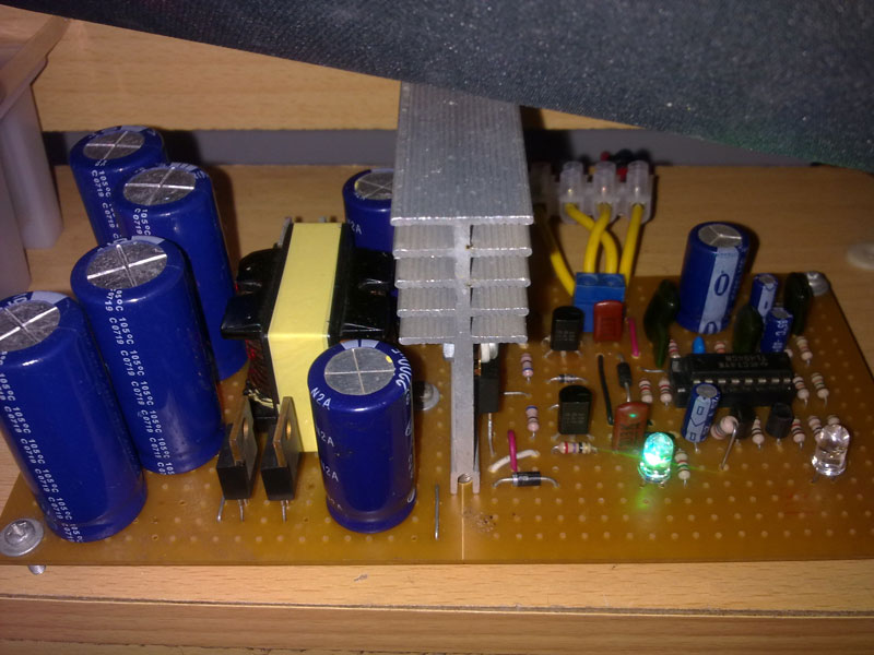

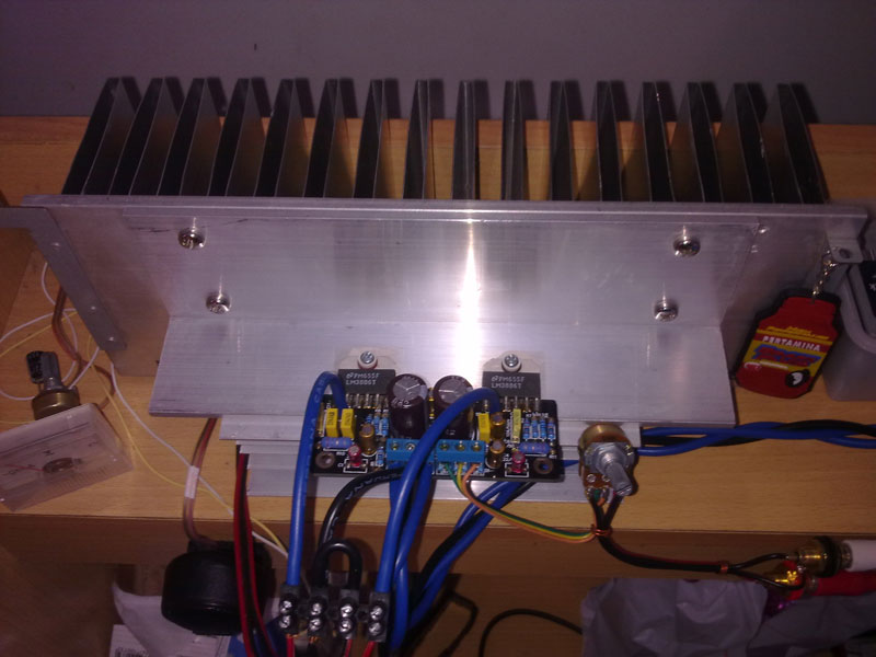

Here's my LM3886 based amp. Acquired the heatsink from local supplier, and the PCB came pre-assembled overseas (from China I think).
The PSU is a DIY SMPS, taking 12V inputs with 20V CT DC-outputs. This is because the SMPS produces no audible hum on the speakers. The amp just seems dead without any signal ;-) A little underpowered because I don't have the time to rewound the EL transformer

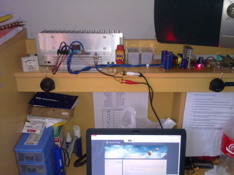

Placed the whole lot on my study desk

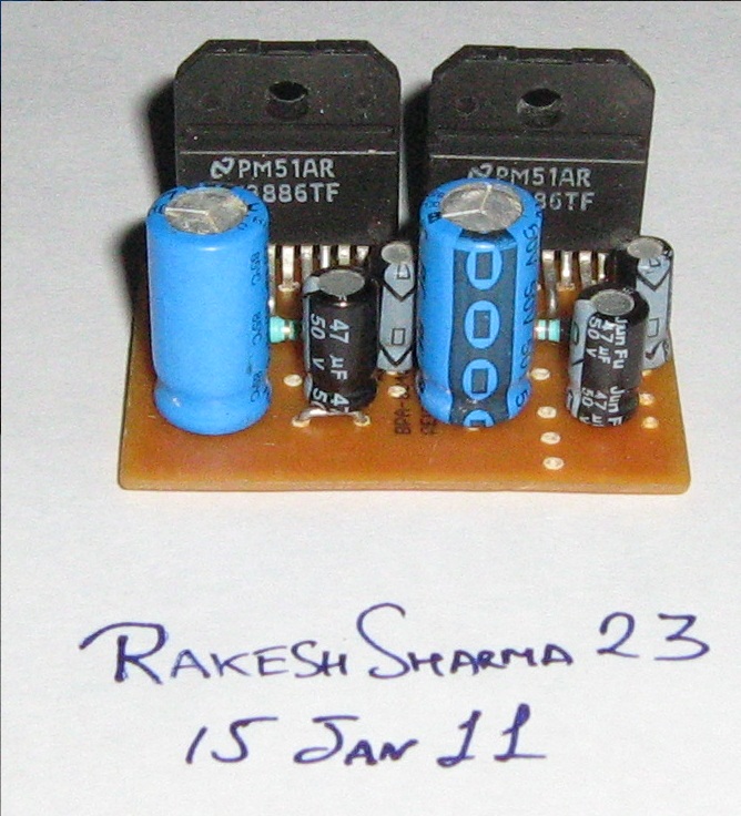

I love the LM3886 chip pins landing on both sides of the PCB. Would be difficult to remove the chip in case of failure but short paths and solid connections when working....
Yes. Love at the first sight for me too
It is quite a thick PCB too, measuring approx. 2mm, dual-layer. I bought it for about US$ 16.20 including postage. Both ICs are like dead in absence of signal, though. Let's just hope that Natsemi does its homework properly, so worrying about molten chips can be a thing of the past for us

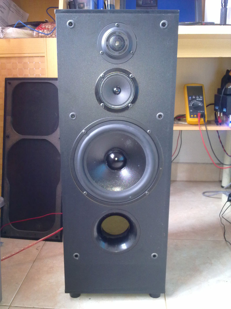

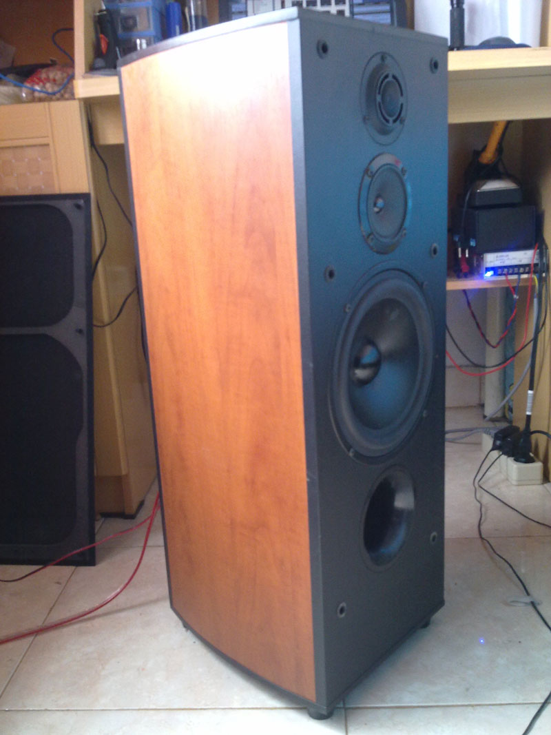

That's right, I am using a couple of Lanzar tweeters there. Although they are made specifically for car audio, their sound quality is pretty impressive IMHO.
As for the main speakers, I'm using commercial 3-way Sharp speakers and removed the built-in amp inside. Each of them consists of an 8-inch 30W woofers at 6 ohms, a midrange and a tweeter, located just on the left and right of my chair. And yes, I really like the setup ;-)
I will take pictures of them tomorrow, as it is 12:42 AM here, a little late already. LOL.

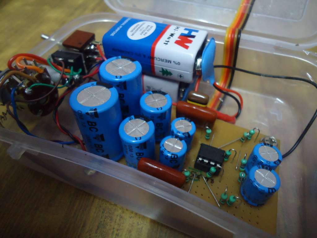

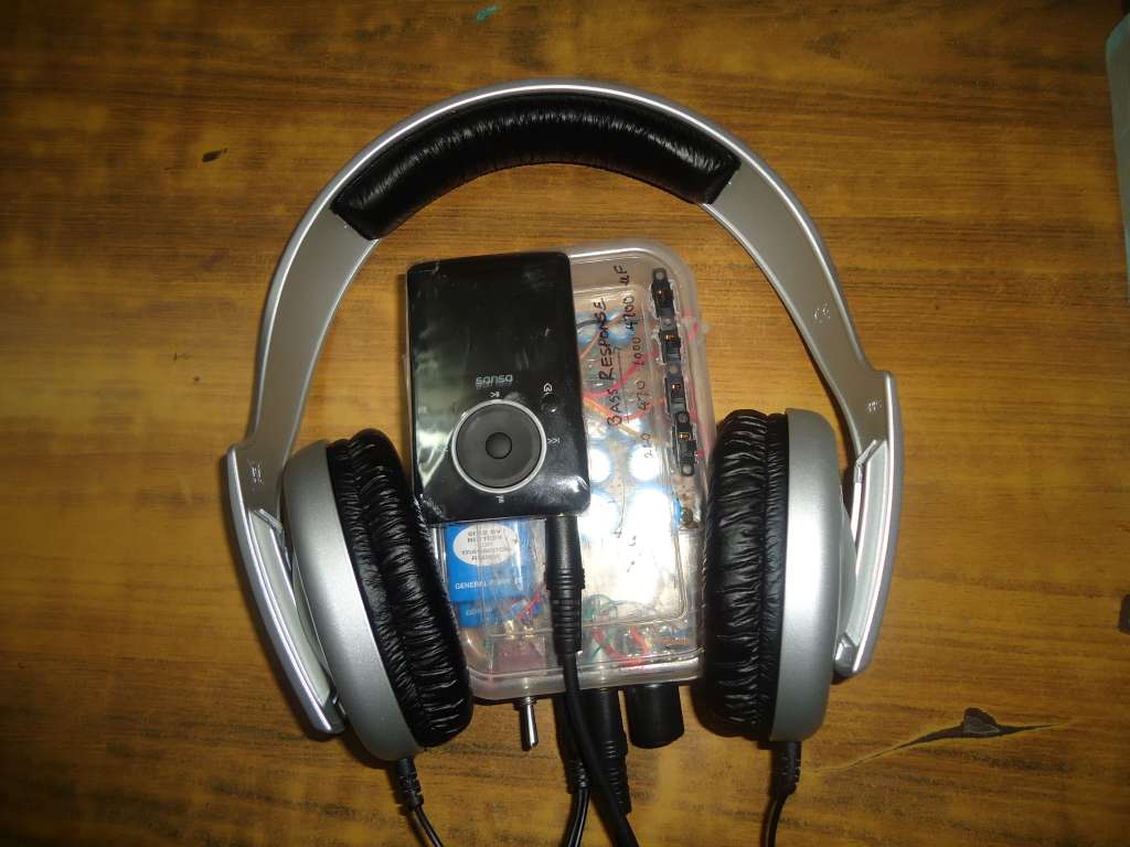

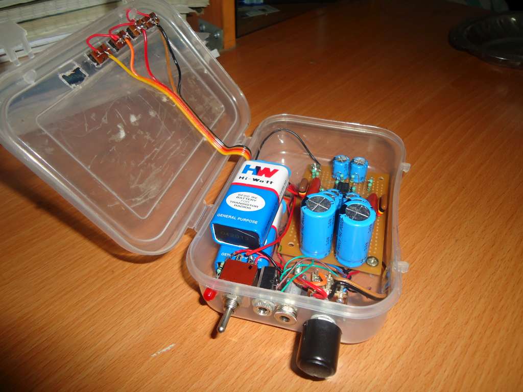

my cmoy with cap selection (4700mF, 1000mF, 470mF, 220mF, and all at the same time 6390mF), also the input caps are selectable (1mF, 0.1mF)
waiting for my Nichicon ES 1000mF and Wima 0.1mF, running with Sansa Fuze 4GB + 16GB, and Sennheiser HD212Pro headphones, everything below 320kbps has a flaw.and sometimes even 320kbps is not fulfilling in details....

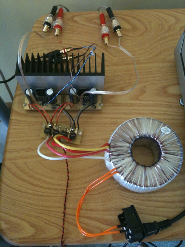

About five years ago I ordered and built the PCBs for an AudioSector SE edition gainclone...
Last Saturday I finally got around to buying the rest of the parts to turn it from a bunch of boards into something that actually produces sound.
Why did I not do this earlier? This sounds absolutely STUNNING! Even with my iPod (playing lossless) driving it and using my fairly average desk speakers, I discovered very quickly why these amps are so well regarded.
Just need to put it in a case and hook it up my B&W DM303s now. Project for another five years, perhaps?
(Actually, I'm heading down to my local electronics supplier to pick up a case of some sort in about an hour... Stay tuned )
