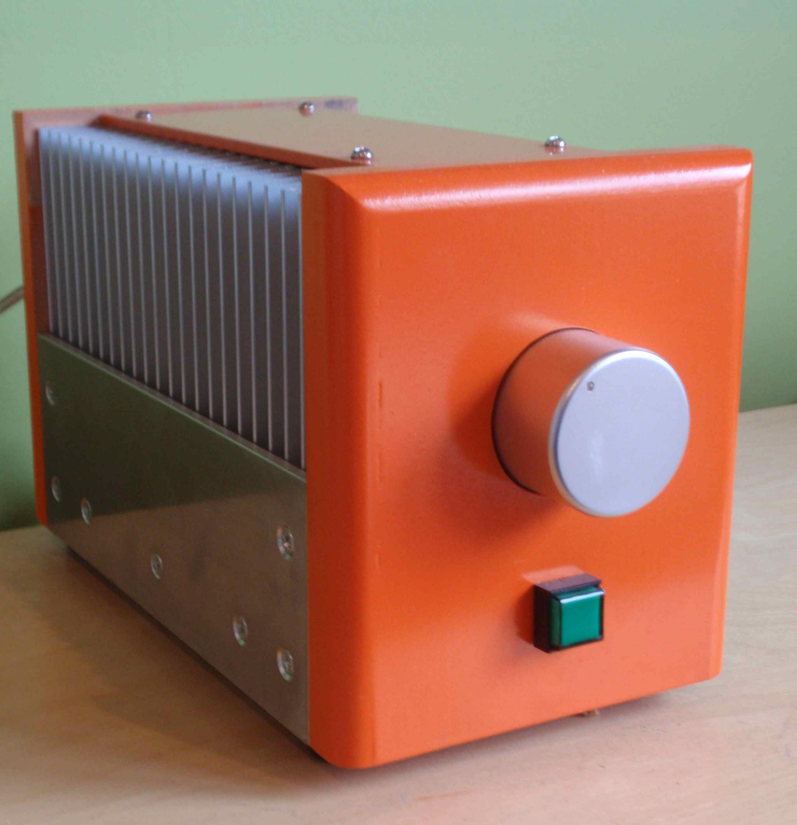

Here is my first SS build. I wanted to see how compact and simple I could get away with. This uses a Lambda switching power supply (in the bottom half) to drive a pair of LM3875s bolted to the large heat sinks in the top half. The circuit probably took me 3 hours to complete, but I fiddled with the enclosure for the better part of 4 months. Final dimensions are 6x5x10 (inches).
Be careful with those sinks. I dont know if you isolated them from the amp chip. With LM3886 I know that the metal tab of the amp chip is good to keep isolated. The reason why is that if you somehow touch the chassis or sink with ground you will zap that chip. I dont think the chassis is isolated from the sinks. Definitely keep sinks away from ground.That is exactly what I thought of when I found the two I am using.

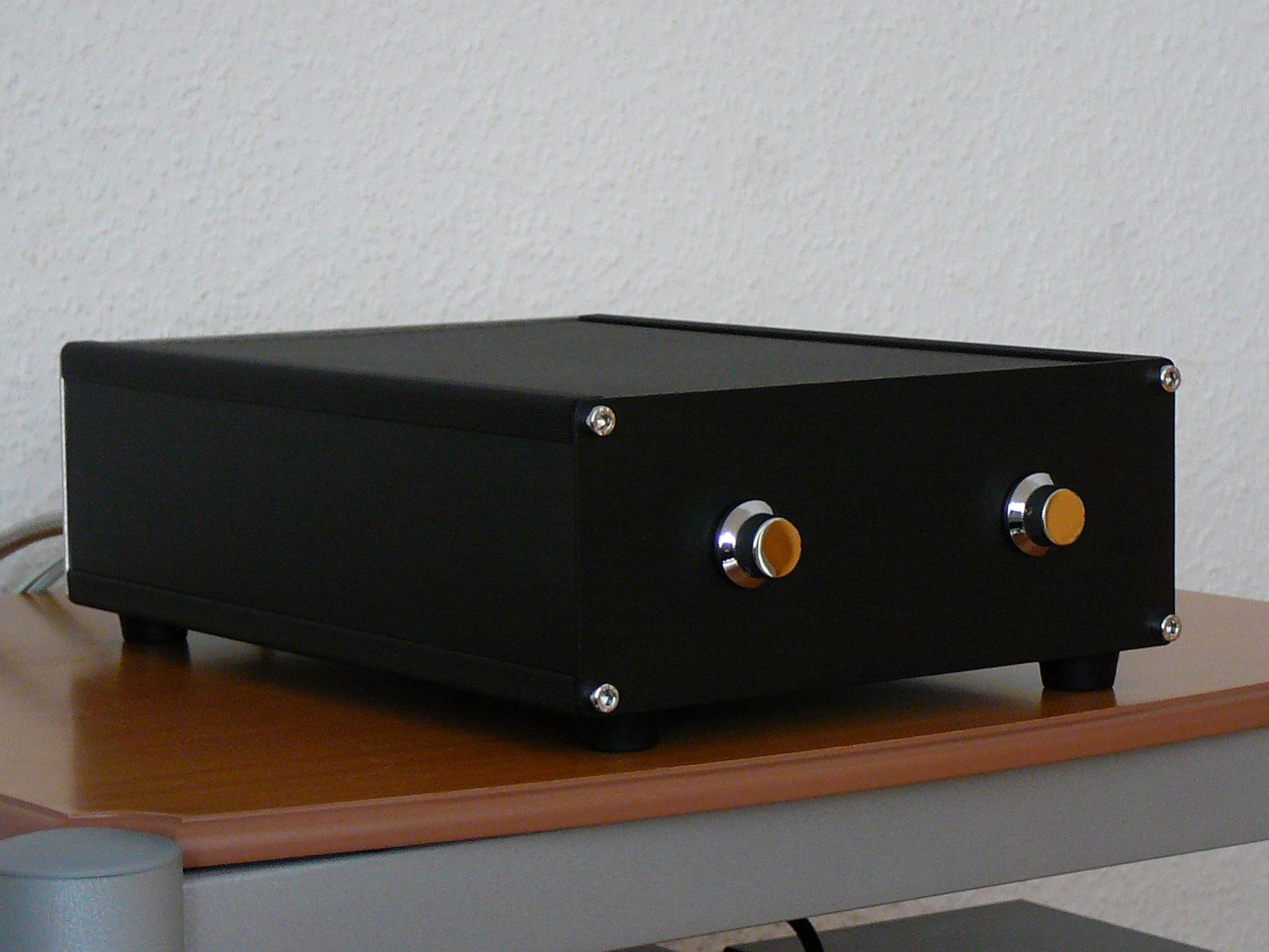

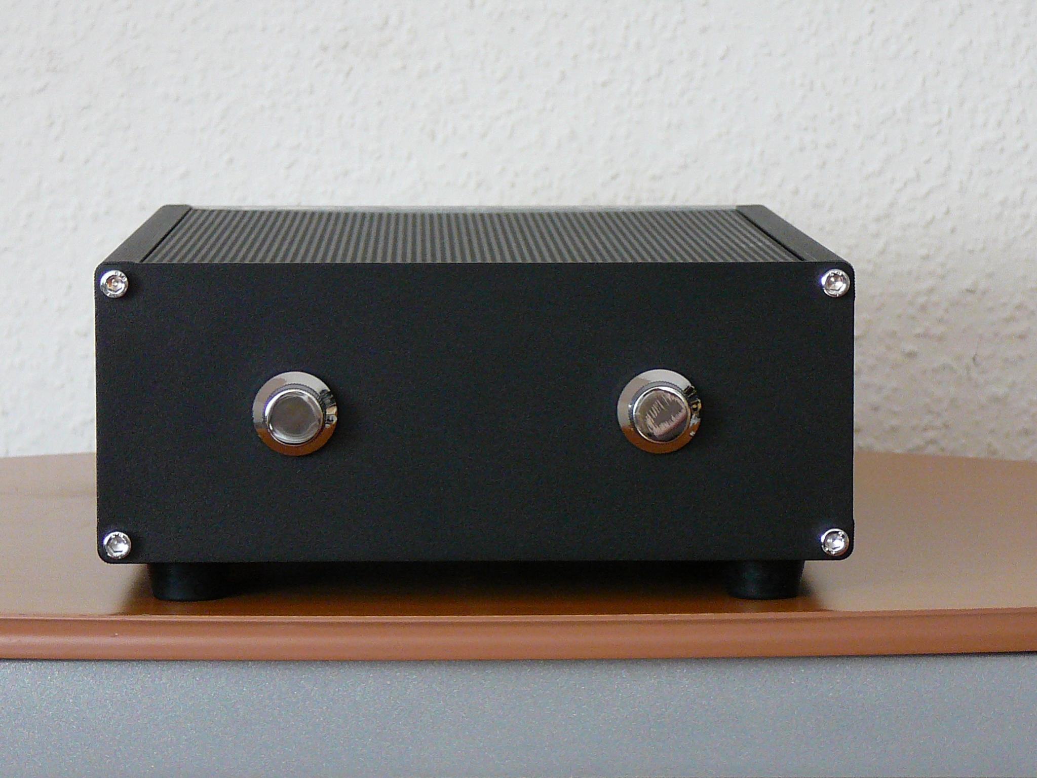

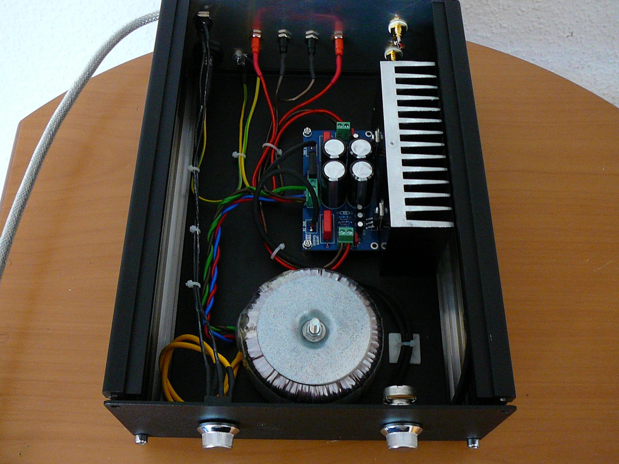

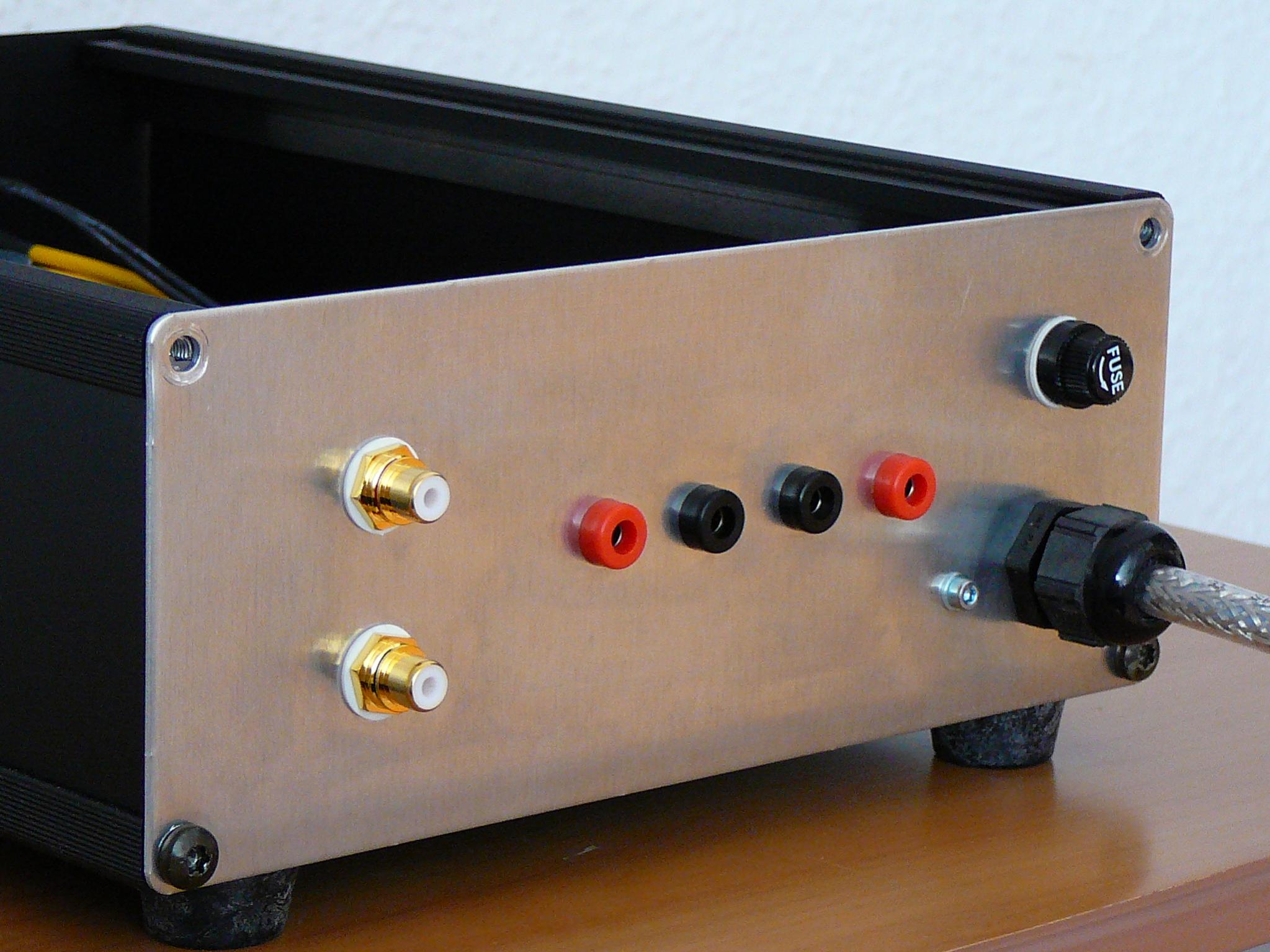

Hello,
here are some pictures of my LM1875 Amp.
I use Panasonic NHG caps, Wima MKS and a 120VA transformer with 2x 15V.
Regards Olaf
