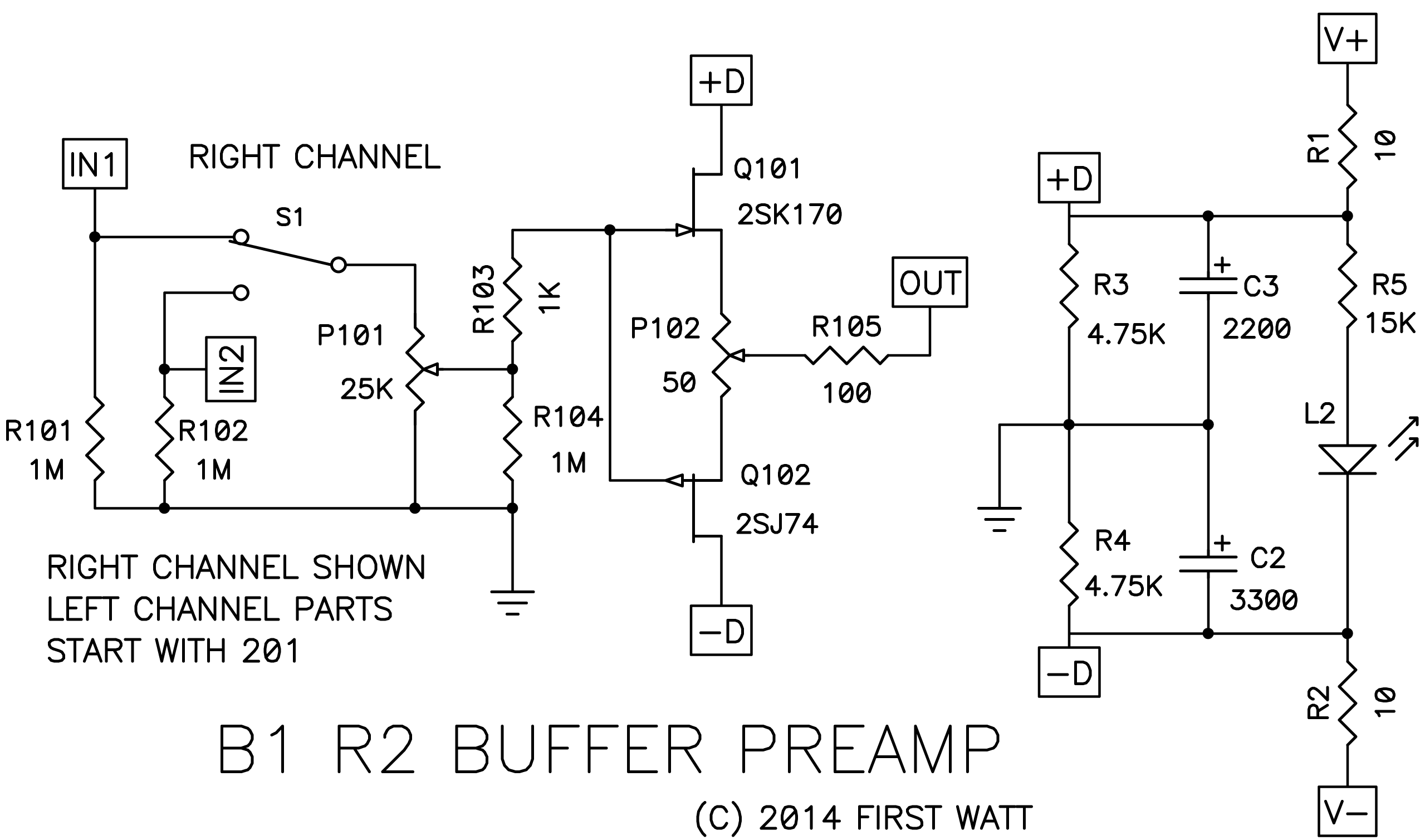

I've just returned to a PASStime that I really enjoyed a few years back. But i never was an electronic genius, not even qualified as a novice, just an interested party. There just seems to be something different about listening to music from circuits self crafted. Anyway, i have an unfinished balanced B1 project and a stash of 13µf 250v Axon caps I was thinking of using in place of the 10µf values originally called for. I would appreciate comments, calculations for effect on frequency response or such. Deeper in the stash is a set of 6µf 140v caps. Are there any mathematical rules of thumb for choice?

Of course you can use the revised B1 circuit which has no capacitors.

Did I fail to mention that I made the B1 push-pull and direct coupled?

Here's the schematic.

What do you like for +-V?
C2 and C3 are different values? A typo or some mysterious reason for this?![]()
typo
