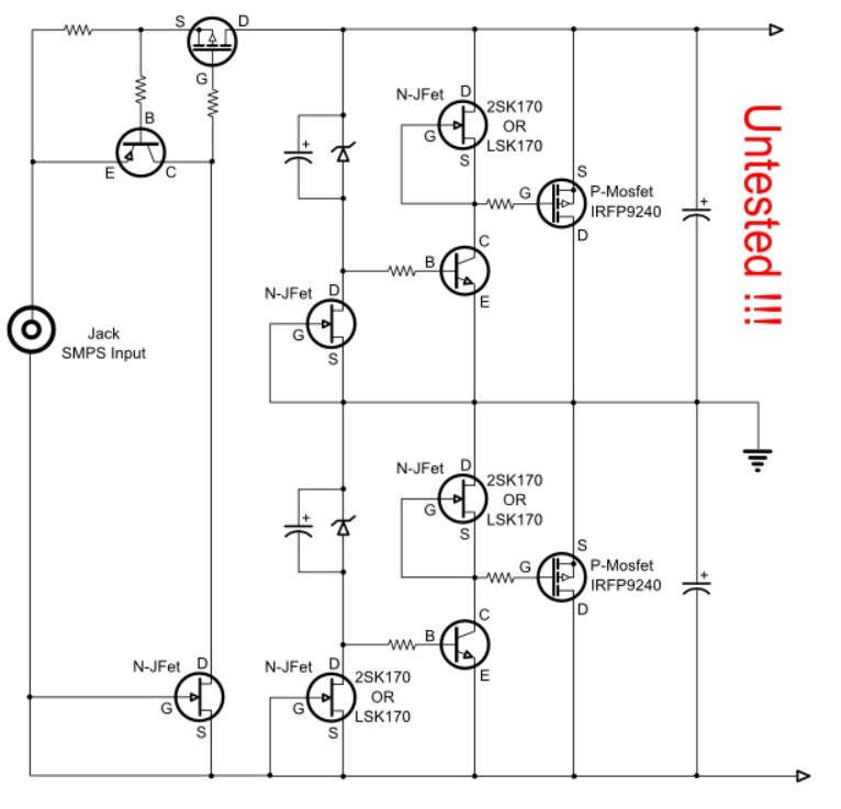

I think I might start a builder's thread to drum some interest in this design - Mr. Pass, would you mind if I re-posted your schematic there?
Yes please!
I have an idea, the Salas regulator and the SMPS wall-wart are not exclusive. You can get a wall-wart in mouser as high as 48v. How about stacking two Salas shunt regulators one on top of the other to make a virtual ground. I have attached a schematic here. This is untested and hastily drawn. I am thinking of the Salas as an overgrown zener, maybe an abstract diagram would have been better to illustrate the concept.
I have some questions as well:
1) With the output resistor on the j-fets dropped down to 100 ohm is it safe to drive a short? Of course all electrical engineers are perfect so that would never happen in real life
2) Does this simple jfet follower benefit from very stiff (low impedance) rails or super low noise? Being a follower it should have very good rejection.
3) Has the thinking from Pass Labs about active regulation changed? Most of Nelsons worked used Mosfets in follower mode connected to a voltage reference with no feedback. 6Moons has taken a picture of the guts of the HPA‑1 Headphone Amp and it shows D2081 and D1259 darlington transistors in the regulator stage. It was designed by Jam Somasundram so maybe it just depends on what the designer selects. I suppose in my hart I know the real answer is you have to try each type and see if it makes a difference to you in your particular application.

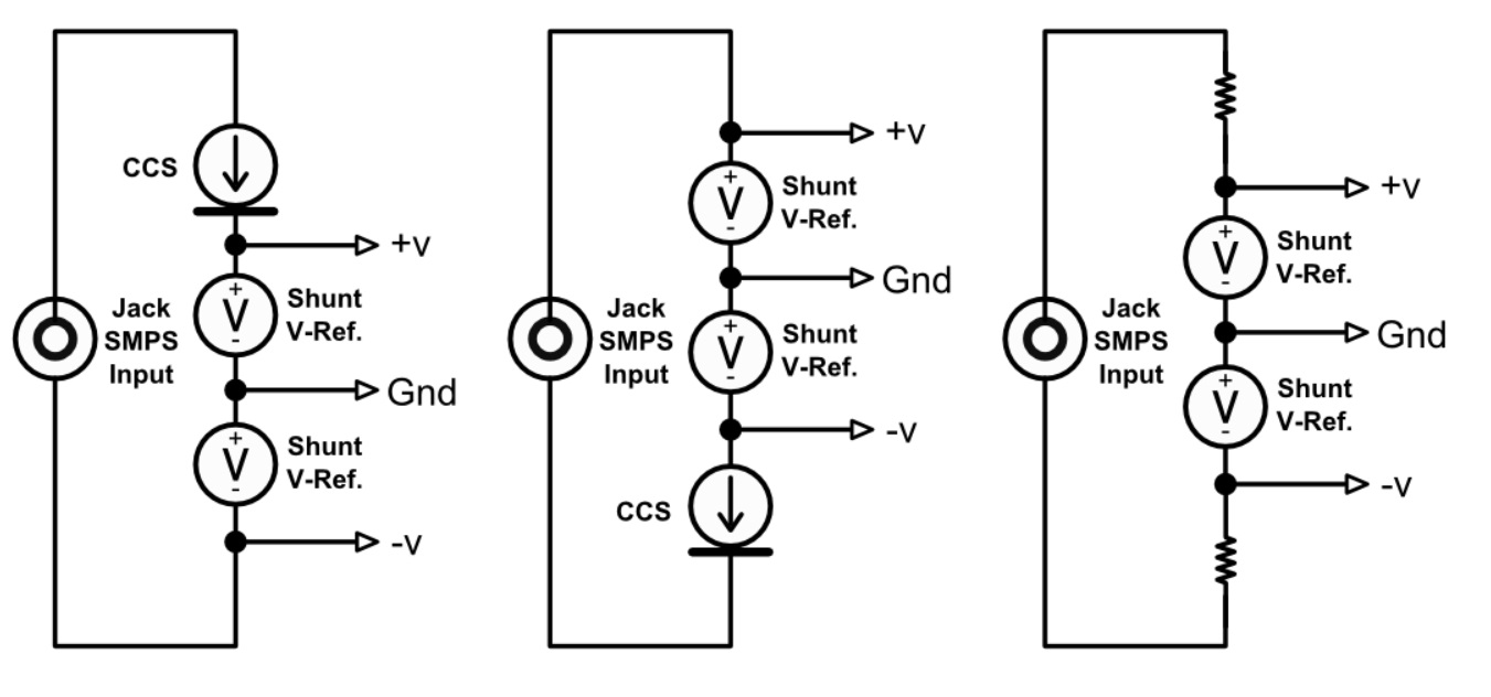

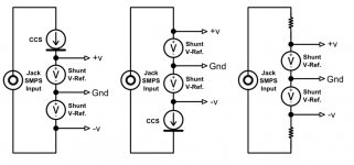

imagine simple positive zenner shunt reg - there is series resistor in rail and zenner itself , as parallel element
for negative , there is series resistor in rail and and zenner itself , as parallel element ;
so , what's missing in your schematic ?
1)pretty much safe even with resistor shorted ; 100R is plentyplenty , anyway
2) yes
3)........ I'm not Pa ....... but- you , as DiY-er - you can always strive for the best** , not good enough for task

So let’s flush the question out. The benefits of an SMPS are safety, UL compliance, convenience, isolation of a transformers magnetic field in a remote case, and small size, while the downsides are the need to split rails more complexity, less reliability, more HF noise and less mains isolation (Y1 caps). Mr. Pass has shown us with the ACA and B1 that that a full audio system of good quality can be made with only an SMPS. Can a supply with an SMPS be constructed with the addition of regulation that sounds as good as a low frequency transformer, in order to allow audiophiles to sleep at night without wondering what they are missing?
Logically this should be possible. The PS just provides an imbalance of electrons and we should be able to get clean low impedance DC via filtration and regulation. Hopefully it will not end up becoming too overly complex to justify the exercise (like Uptone Aaudio UltraCap™ LPS-1). You would think that having a higher switching Hz would make it easier to filter, but caps also have parasitic inductance.
I wonder if Mr. Pass put the 10 ohm resistors in there because he feels some filtration is needed in the form of an RC filter or merely to prevent inrush currents from destroying the SMPS?

Just one small note, you cannot put another current source on the bottom (if that is what you are suggesting) because there will be a small current imbalance between the two. It’s like trying to put two current sources in series. There is no path back via ground for the extra current. I will attach an abstract set of combinations. Mr. Pass gets away with using resistors because they are kind of like "soft" current sources. You could use resistors in the Salas regulator but the CCS offers higher rejection.
