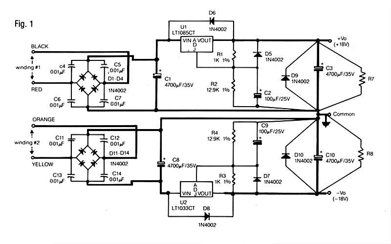

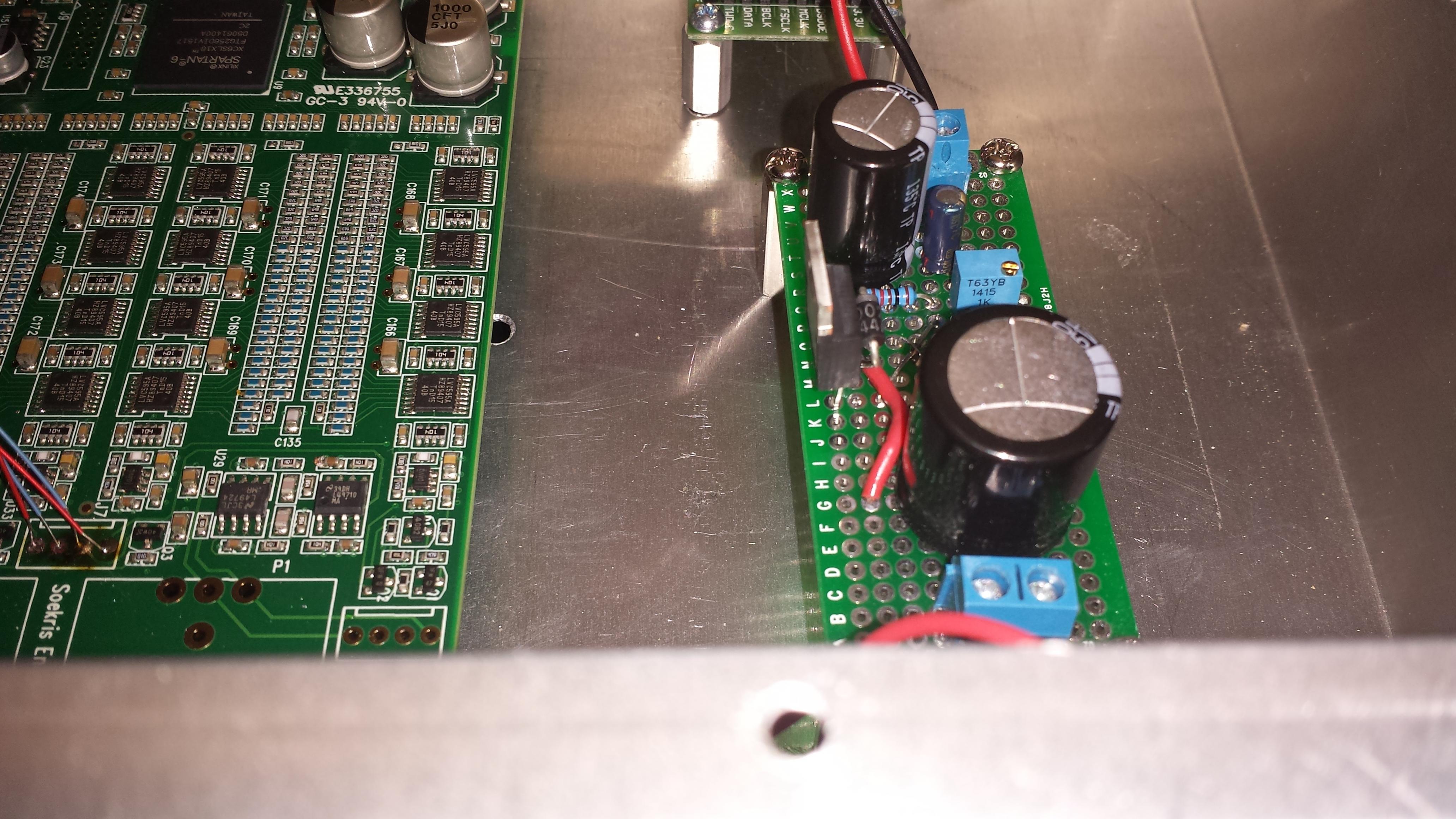

What about a LT1085 type reg? Very simple, better results than a LM317. LT1085 has a negative reg counter part as well the LT1033.
Built one yestetday in about 1 hour point to point.

Here's the schematic.

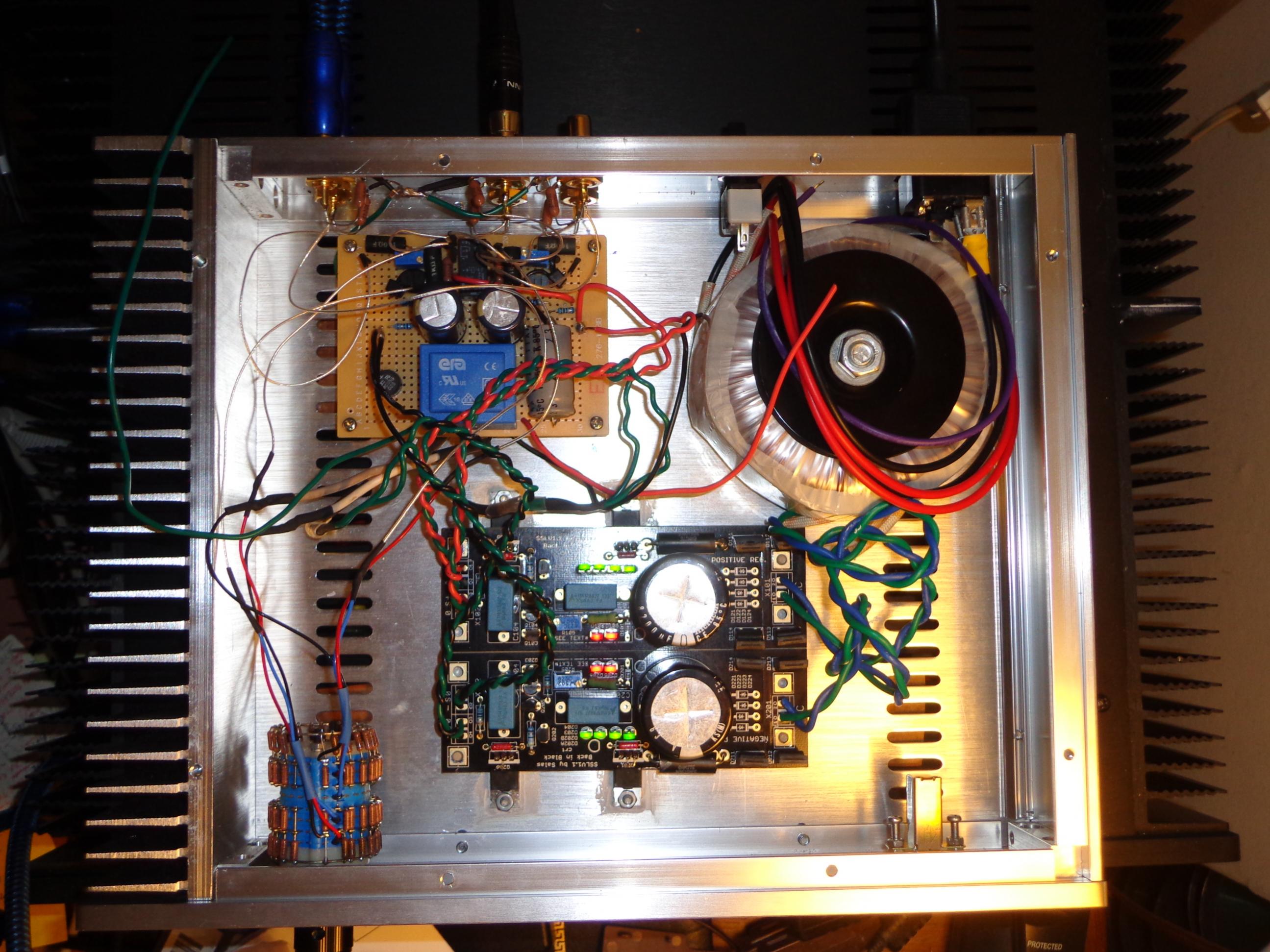

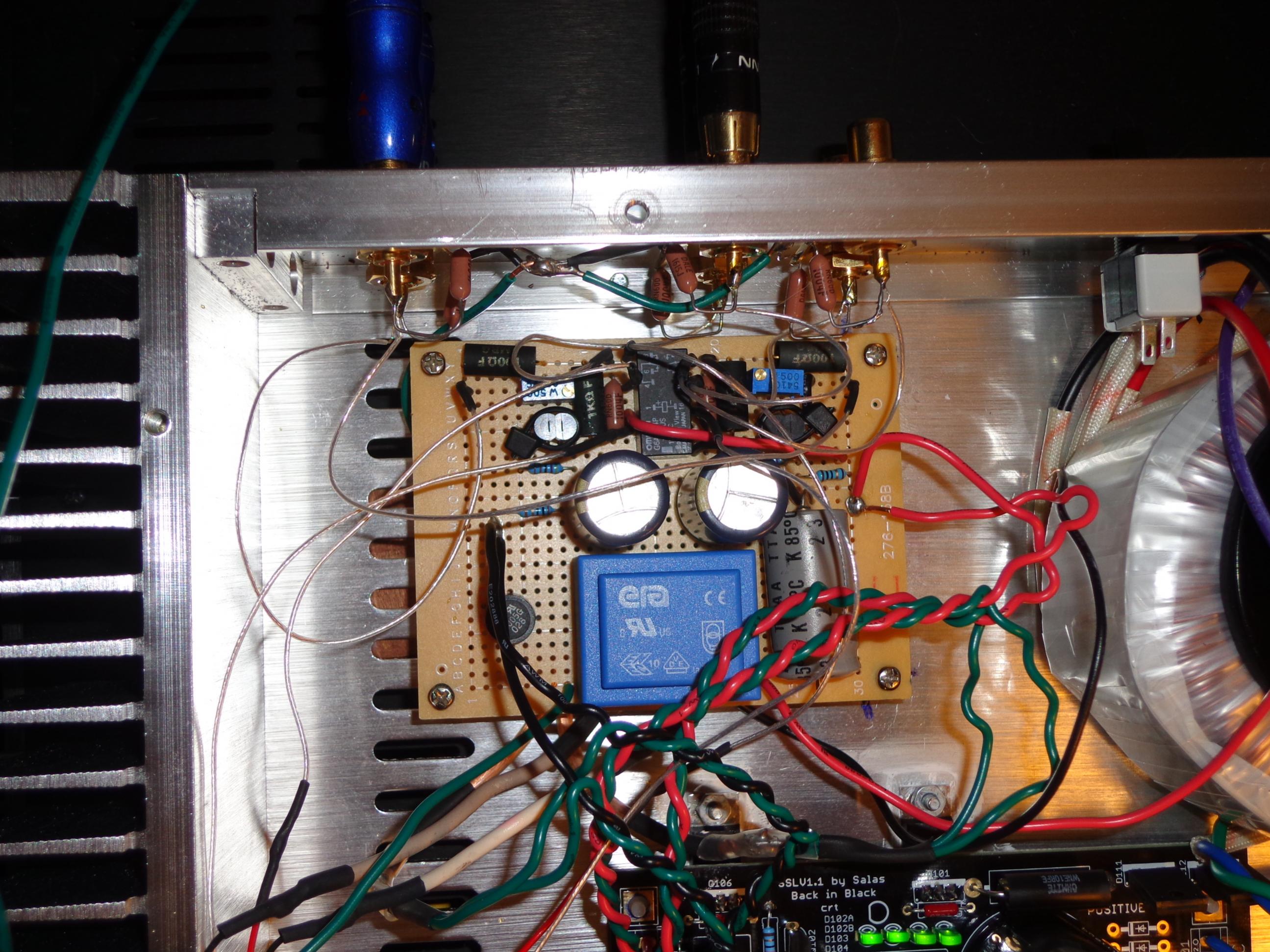

Had to build one of these (see post #17), and I'm happy to report that it sounds fantastic, even though I'm temporarily using a 10K rather than a 25K pot (it's coming). It's at least as good as the stock B1, and much better than the DCB1s I built (which, to be fair, sounded good in some setups but not others). Warm sound, with tremendous bass. Here's some pics of the current state of things, and I'll post more when it's finished. The transformer on the board is to power the relay coil for input selection - I used it because I had it laying around. Haven't hooked it up yet.
The power supply is a Salas shunt with about 300mA spare current.
