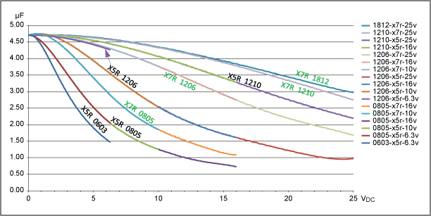

I was told to use 1206 2kV rated NP0 for filters for ultra low distortion applications. I can not find a nice graph however. I have attached a graph for the variation with voltage for a variety of case sizes of X5S, X5R and X7R. I would like to see data for NP0/C0G if I can find it. Obviously the scale would be very different. But such data might be helpful if one is working around -120 to -150 dB distortion levels.
I guess the quick summary is: When using ceramic dielectrics use case sizes and voltage ratings which result in thicker layers and thus lower field strengths. (And of course use NP0/C0G when possible.)
The next question is: Are there differences between vendors of NP0/C0G caps? [Does everyone know what the optimum blends of neodymium, samarium and other rare earth oxides are? Does everyone know how to manufacture them the best way? I am guessing no...]

TDK has Simulation Models for Multilayer Ceramic Chip Capacitors, including DC Bias Models: Multilayer Ceramic Chip Capacitors | TDK
Difference and comparison among Simple Model, Precise Model and DC Bias Model: https://product.tdk.com/system/files/dam/tvcl/mlcc_model_en.pdf
