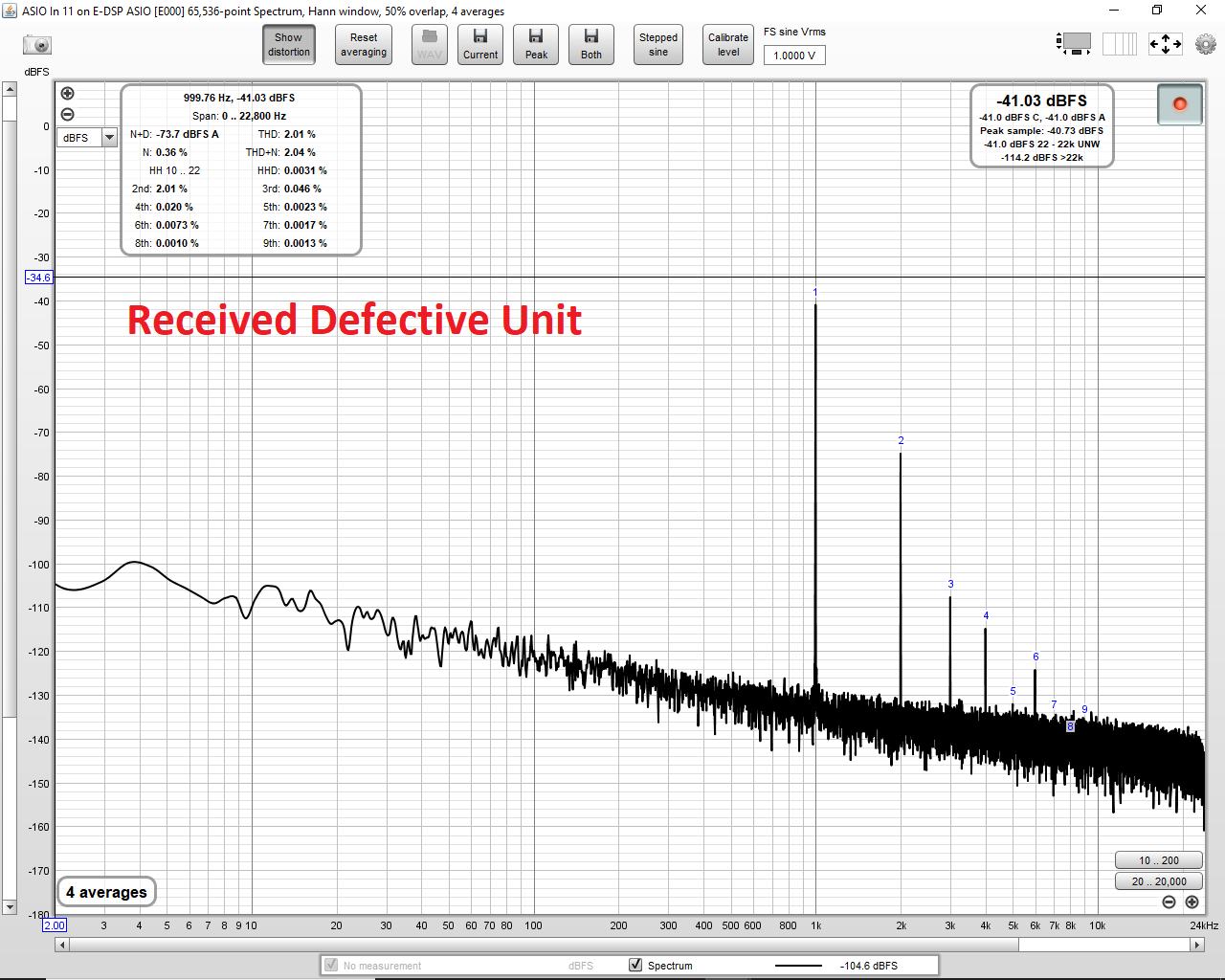

Has anyone seen low and distorted output like this on an E-MU 1616 or 1820?
The mute stuck on with 39 Ohms to ground would likely cause the distortion increase from the NJM2068. (And slightly load down the opamp supplies too.)

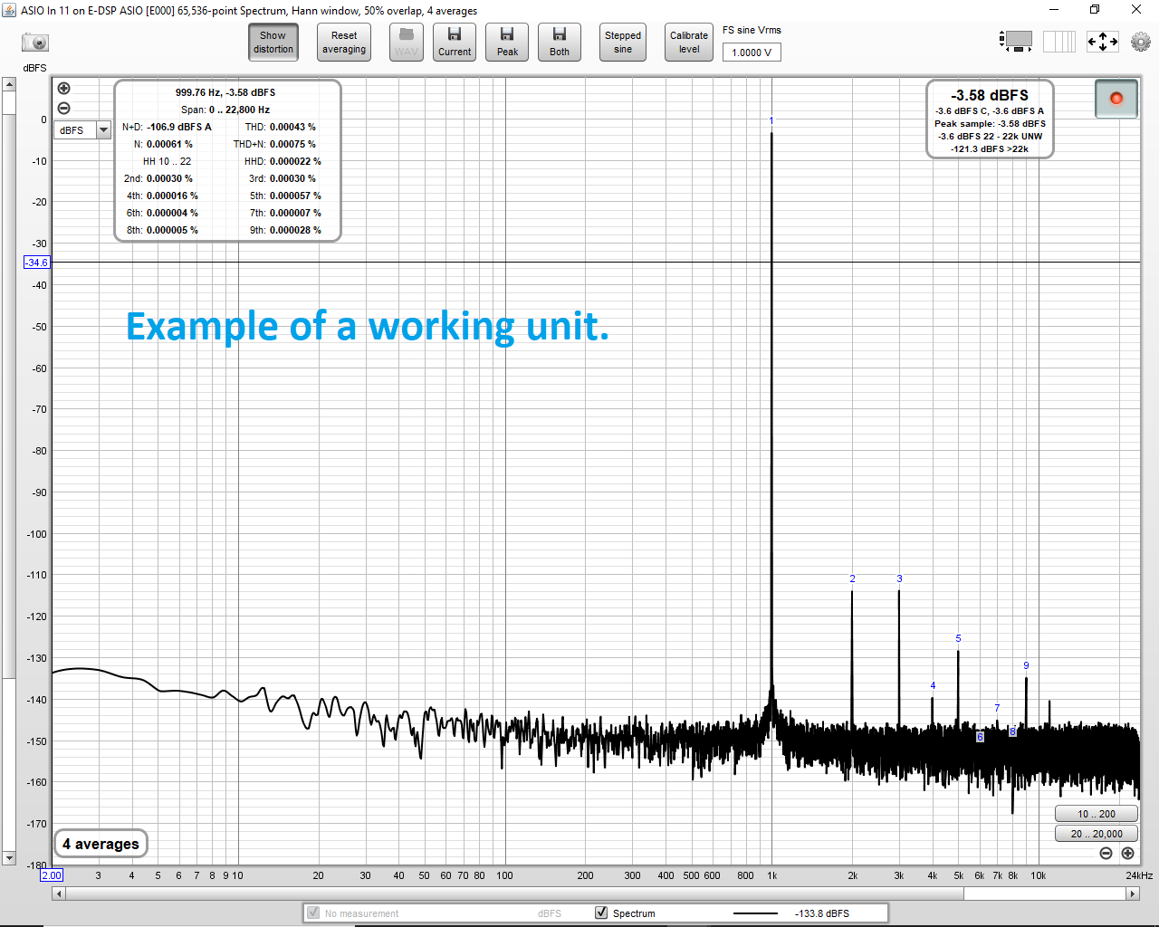

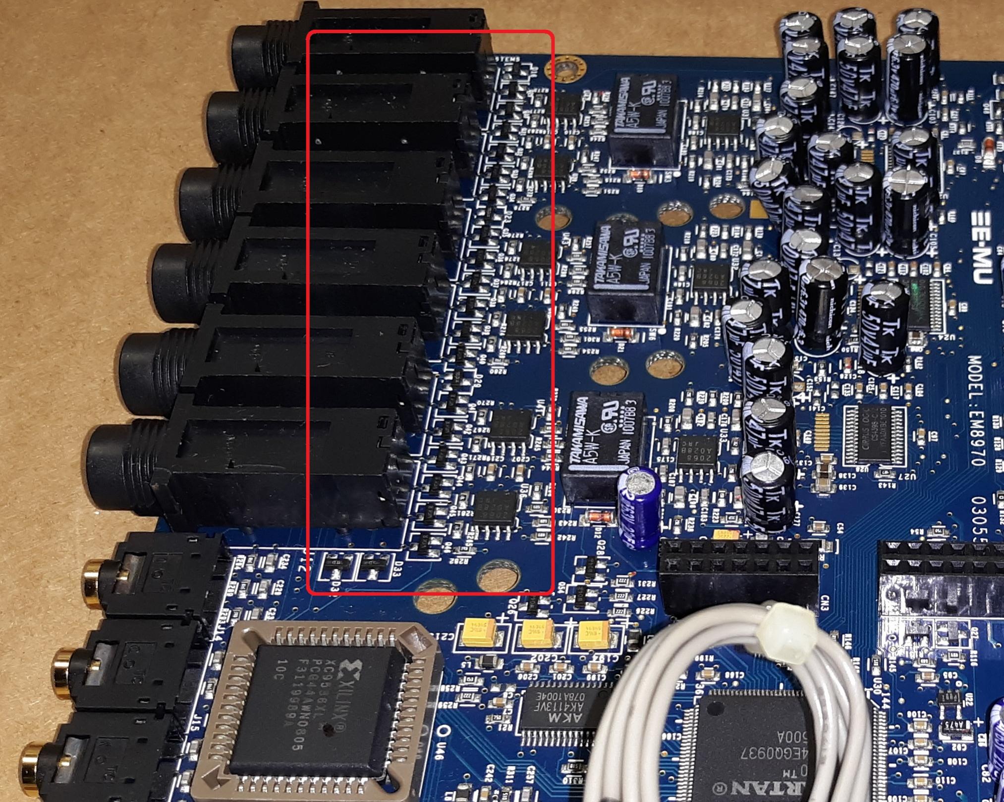

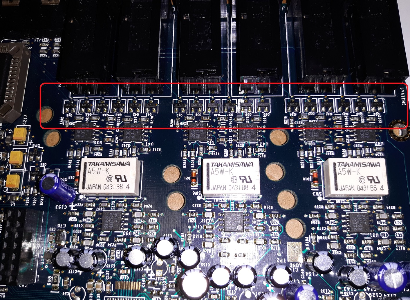

Attached is a photo of the similar but different mute circuit on the defective E-MU 1616m.
The second photo appears to be the driver circuit for the mute circuit. It has SOT-23 marked 1AM (MMBT3904LT1) and another W2A (PMBT3906). There is also a 104 resistor (100k) and a 105 resistor (1M!).
In the first photo it is possible to see the mute devices with the marking "6K" with the sideways "J". From tracing the circuit I wonder if these are "MMBF4391L, MMBF4392L,MMBF4393L- ON Semiconductor" since the driver is driving the third pin which is common for all the mute devices on the PCB. That would be the gate of the MMBF4391/2/3 JFET.

  9. When stuck in mute the outputs will be low and distorted with high 2nd harmonic. The NJM2068 will be trying to drive the 39 Ohm SMD resistors into the mute transistors resulting in high distortion and low output. (See attached imaged.)

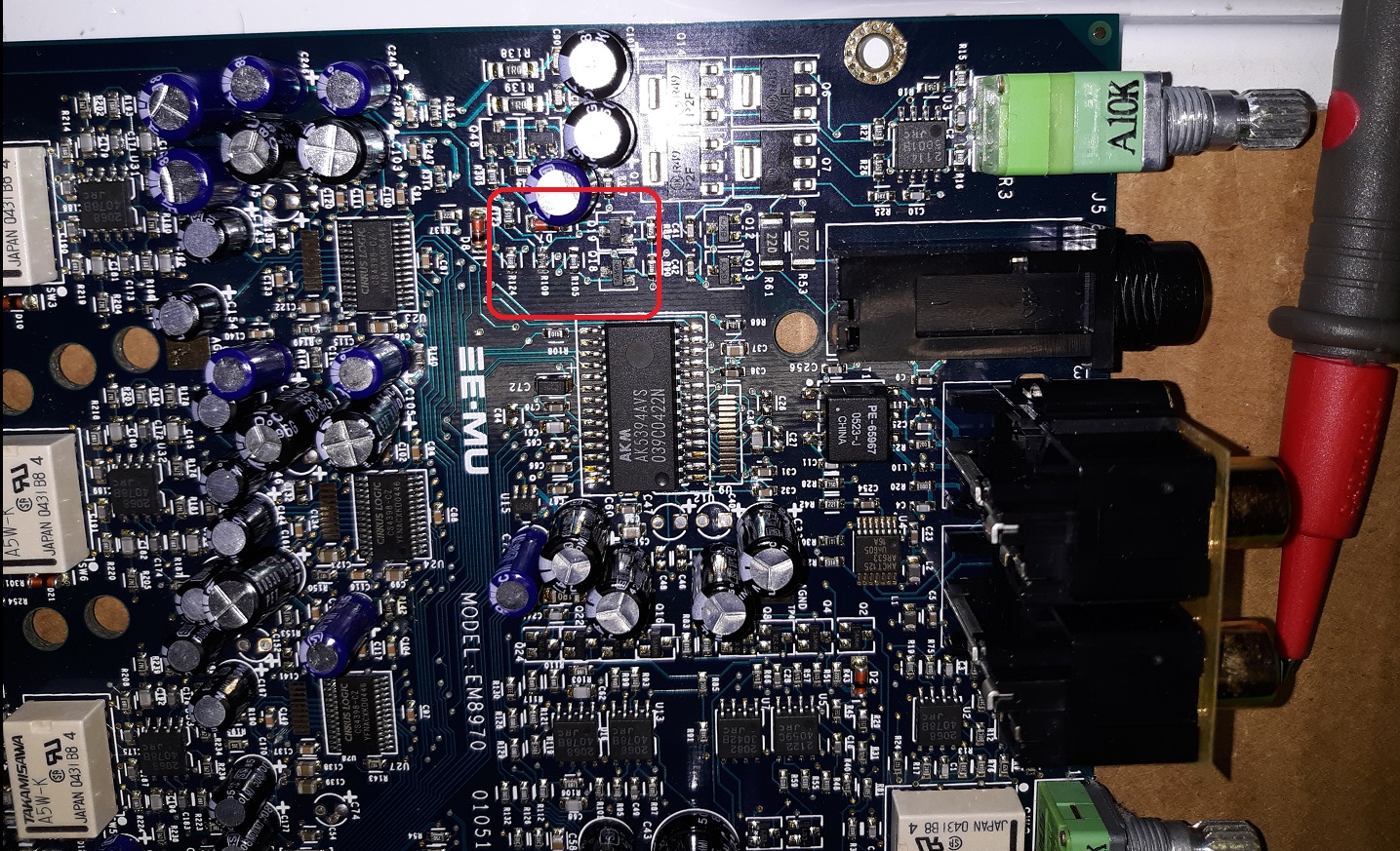

How to debug? The following is an example for the 1616 or 1616m which has a 48V external supply allowing you to probe in a known MUTE and known UNMUTE state. With the 1820 you don't have the external power supply and thus easy access to the two states (mute on and mute off) but you can probe and debug what should be the UNMUTE state when connected to the PCI card.
On the attached image I show two test points. One is shown with a red arrow and that is the base of a MMBT3906 PNP in the mute driver circuit before the last resistors that connect to pin 3 of all the mute transistors. (Those resistors are 100k "104" and 1M "105".) The other is shown with a blue arrow and is pin 3 of a mute transistor marked "6K". All of the mute devices have pin 3 connected together across the entire device so you can probe any of them. I soldered 68k 1/4W resistors covered with heat shrink as test points/probes/wires on those two points to debug.
If the 1616 is working then the MMBT3906 base should measure 12 to 13V when the microdock is NOT connected to the PCI card but the microdock is turned on and connected to the 48V supply. That is MUTE ON. If you then connect the microdock to the PCI card it should come out of mute and read -12 to -13V. If you get something like -1.42V then look for blown mute transistors and a blown mute driver. The blown mute transistor can be on any channel and will drag down ALL CHANNELS.
At the third pin of any "6K" mute device on the board (all are connected together) you should measure 0.5V to 0.6V (one Vbe) when the device is in mute. Test this with the microdock NOT connected to the PCI card but with the microdock is turned on and connected to the 48V supply. If you then connect the microdock to the PCI card it should come out of mute and read -12 to -13V. If you get something like -0.24V or 0V to -1V then look for blown mute transistors and a blown mute driver.

With the mute stuck on the DAC output level is about -20 dB down (the NJM2068 driving 39 Ohm SMD resistors to AGND.) So you will hear ok music and might think that it is working. But if you loopback you will see massive 2nd harmonic and levels -20 dB down. The attached "bad example" is -40 dB down because the capacitors are bad and the mute circuit is blown at the same time.

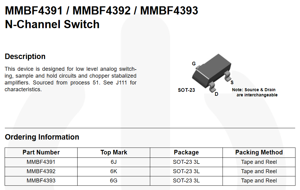

I measured the three removed "6K" marked SOT-23 mute devices from the 1L channel. One was damaged but the other two test as a N-Channel JFET and the pin out matches the MMBF4392 N-Channel JFET Switch. Since the marking code is "6K" for the MMBF4392 that much confirms the device type. [The other possibility for "6K*" was TP0610K MOSFET. That is not the correct device.]
Again only one damaged mute device will leave all channels in mute because the gates are all common and drive by a single level translator and driver.
MMBF4392LT1G can be ordered (at least as of 2021). Perhaps also: MMBFJ112.
