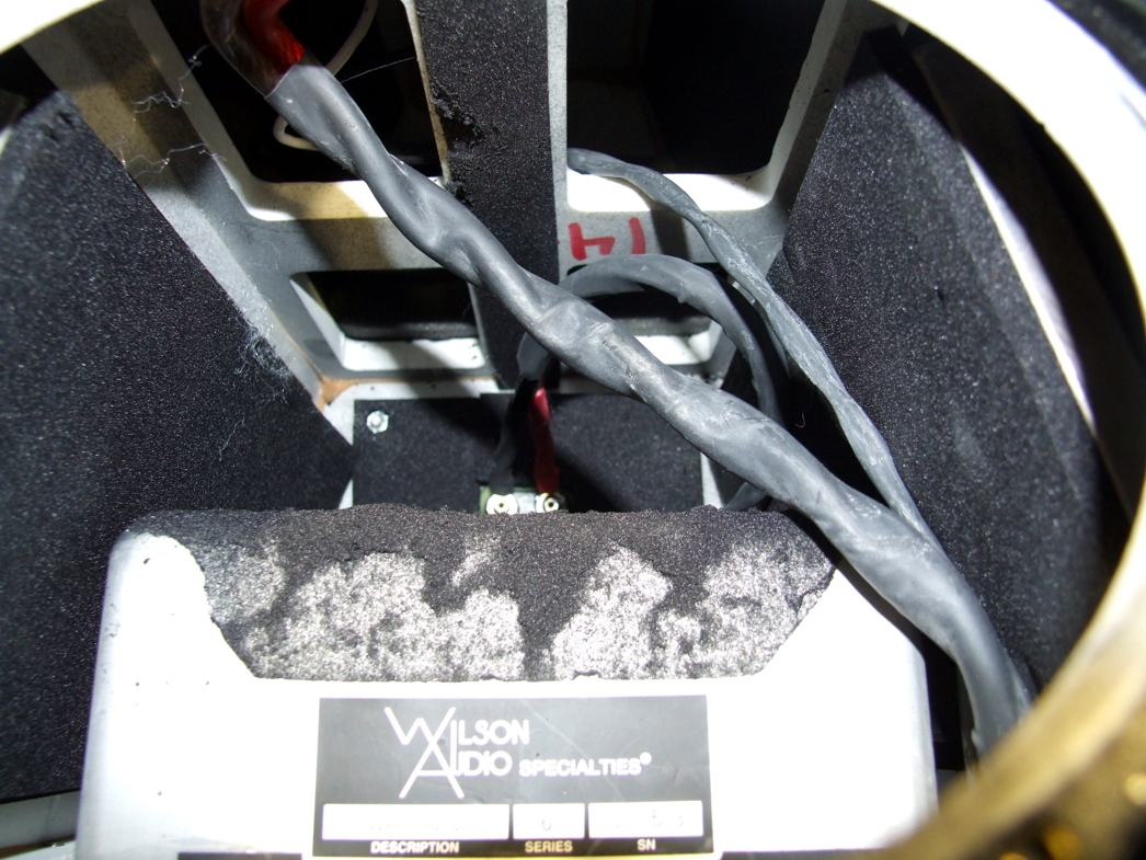

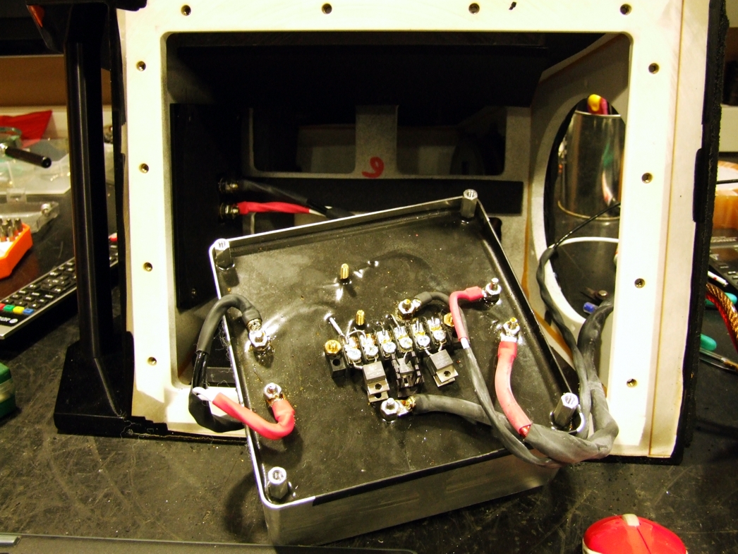

Does this look like DIY, or WATT?
On the chairs (previous picture) are crossover breadboards and this is all you get to see of the crossovers from Series I , at least on my part. With some magnification a significant amount of caps and coils can be seen on each board. This practically rules out a simple 1st order XO with only cap, coil + resistor across the woofer terminals, as stated by somebody (the only person for that matter).

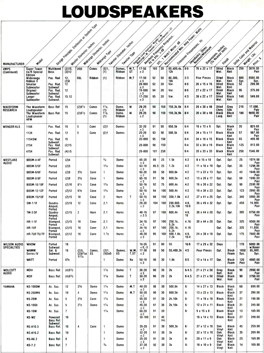

In fact, the WATT's series I & II crossover is supposed to be 1st order, albeit a rather complex one. Probably similar to (vintage) Thiel, with several notch- and zobel networks.
According to 'Audio' (1987) the crossover point is at 1800Hz.
In 1990 - with the introduction of the Puppy Woofer and WATT Series III - the system became a full range 3 Way with an even more complex XO in an epoxy potted aluminium case that was mounted (see pictures) in the cabinet.
Crossover points between WATT and PUPPY: 150 Hz (extended Bass-Shelf alignment), between the SEAS 6.5" woofer and the Focal tweeter: ca. 3500Hz.

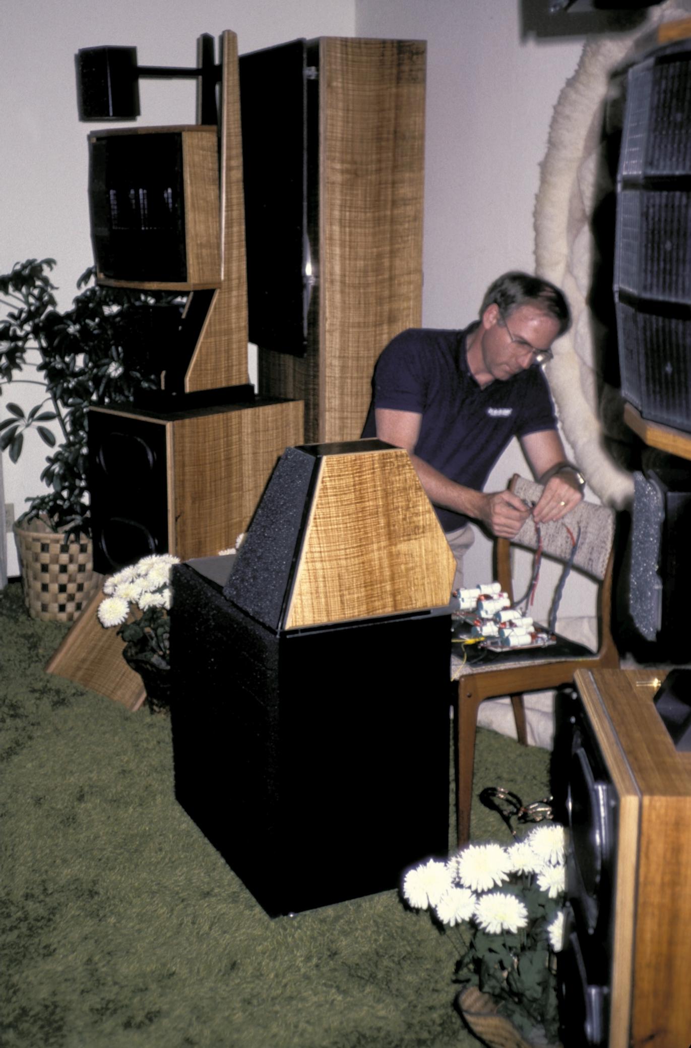

The last picture (from ca. 1989) shows David Wilson David Wilson tweaking the prototype Watt Puppy crossovers on breadboards.
These white caps are likely either Wonder-Cap (REL), Spraque or Cornell-Dublier high quality capacitors from those days.

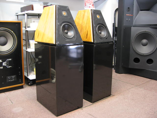

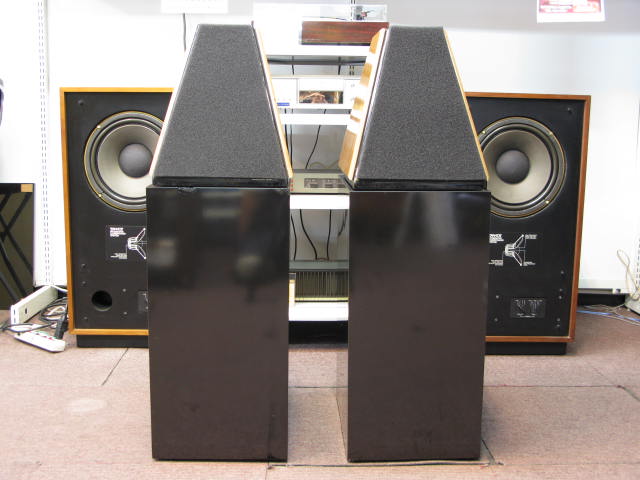

It should be remembered the Tiny Tot was originally designed as a nearfield recording monitor loudspeaker taking into account some boundary gain from the studio control room. For this reason the crossover did not include baffle step compensation. Add to this the small, rather shallow cabinet and it may come as no surprise the WATT sounded rather thin when placed on stands. As a result of the rising response in the midrange and somewhat harsh nature of the tweeter, the WATT was by many perceived as quite a fatiguing loudspeaker.
"In his 1988 Stereophile review, Martin Colloms mentioned the WATT's superb resolution of detail, transparency, focus, and depth as being revelatory, coupled with a build quality which he instanced as being "the most perfect exposition of cabinet construction." However, he had to weigh this performance against the speaker's lightweight bass, erratic response in the vertical plane, and awkward impedance, which dropped to a very low value in the lower treble, necessary to control a dustcap resonance in the woofer.
Wilson's development of the "Gibraltar" stand (see image 1 & 2), which in effect extended the front baffle area downward to the floor, helped the speaker extend its bass response, while many users coupled the WATT with subwoofers, the Entec SW-5 in particular (see image 3), to give a full-range system that preserved the speaker's remarkable qualities. (Wilson recommended that the WATT still be used on its Gibraltar stand rather than sitting on the Entec.) In 1989 the Series 2 WATT followed, with a smoother midrange balance, a more extended, less overdamped bass, a slightly higher overall sensitivity, and a less cruel impedance. Then, in the summer of 1990, David Wilson launched the Puppy, not so much an independent subwoofer as a dedicated woofer to turn the WATT into a full-range three-way system. (This time, the WATT does sit on the woofer.)."
The comprehensive Owners Manual from the original WATT is extraordinary in its completeness and a testimony of David Wilson's dedication to the art. It is worth taking note and you'll find it here .
