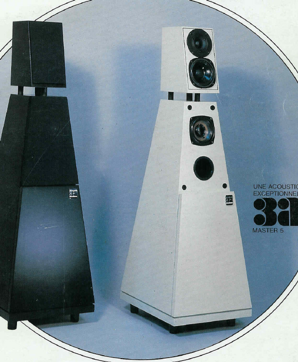

As a tribute to to the tiny SEAS 11F's and its application in the Reference 3A Master MS 5 some images. These were highly regarded back then and share a similar modular design concept with the WATT/PUPPY's, but with different technology and at a much lower price.

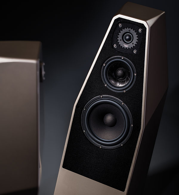

And these were sources of inspiration for development of the Wilson WATT:

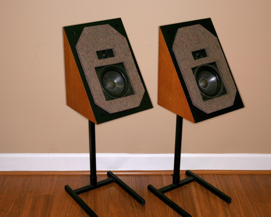

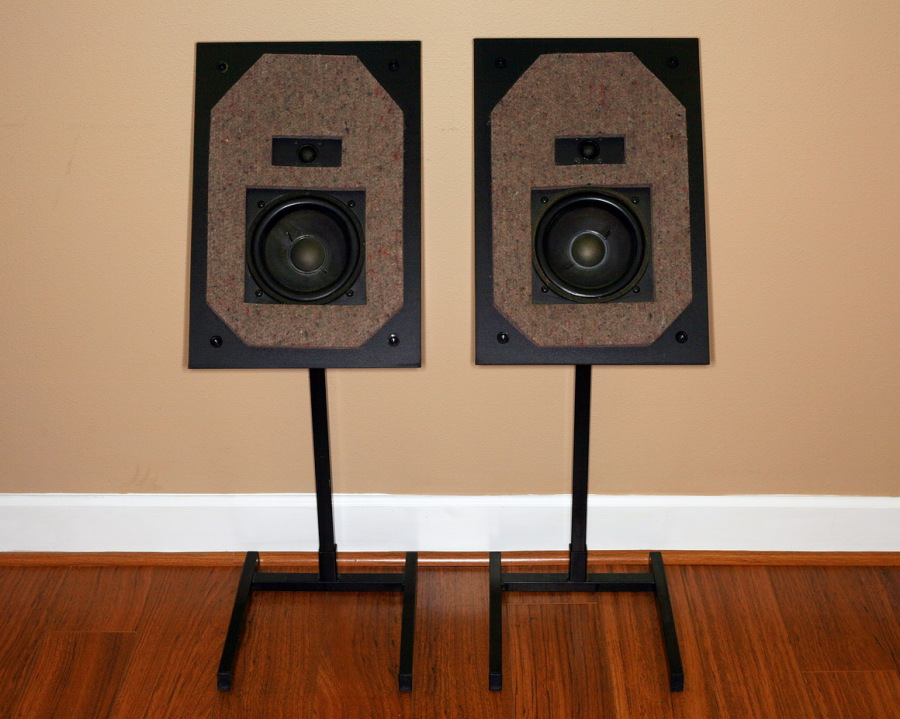

No interminable analysis this time, but a 1984 review from Audio Magazine.

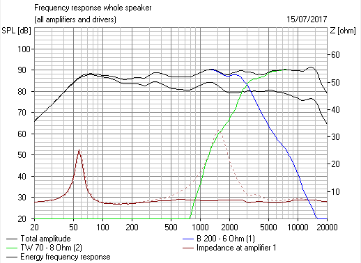

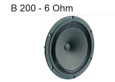

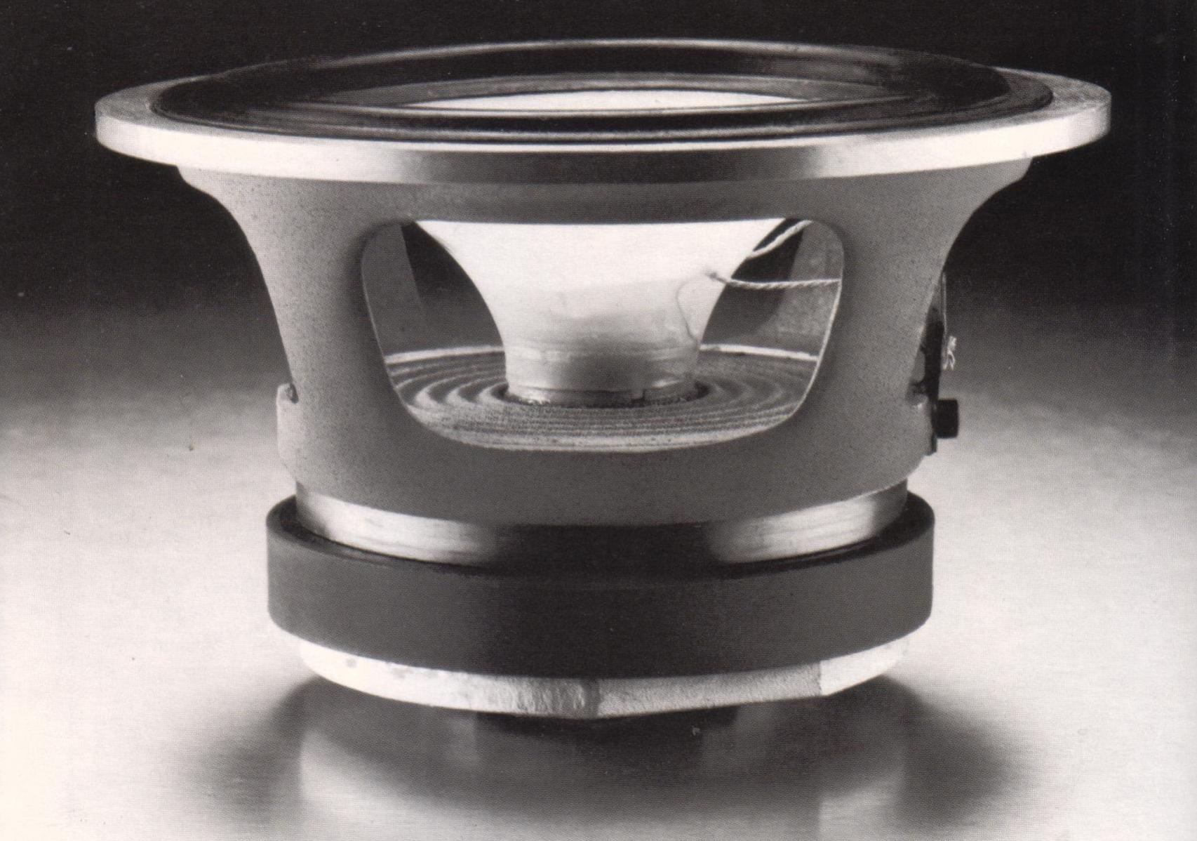

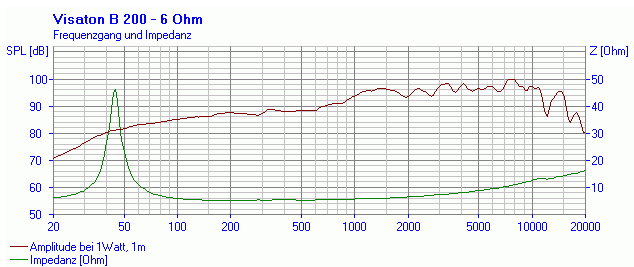

Joachim Gerhard bangs on about low mechanical loss as being a good thing. How's about a Qms around a staggeringly high 8.39? Enter the Visaton B200.
I had a play with this 90dB woofer. It is remarkably like those old Elac ceiling speakers from the 1970s. Small 1" low loss Kapton (Plastic) voicecoil former. Big old magnet, but a Qts of 0.75, saying big 60-70L box.
Say we substitute it for the below heavier coned W200S in a bigger box:
attachment.php

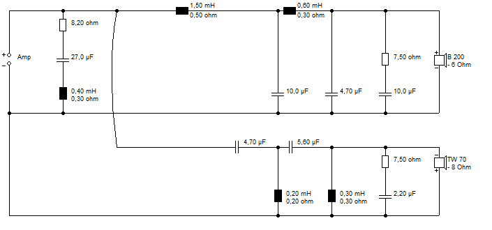

No natural rolloff to simplify the crossover, so we need a full 4th. order bass section and a LCR impedance corrector. It's actually very nice done this way. I suspect this speaker, with limited bass depth and a roughish frequency response, would play jazz very well and very lively. The B200 driver is about £90 in the UK. The TW70 or Monacor HT-22/8 tweeter goes for peanuts! LOL

High QMS is desirable, but often goes hand in hand
with a larger cab as you have stated, Steve.
This B200 is to great extent similar to many vintage drivers. These are regularly offered for decent money in NL or Germany were its a classic among the diy community.
Unfortunately, its power handling is limited, akin to i.e. the JA-8008.
I remember the Spica TC-50. Far better than the Wilson WATT for the simple reason the drivers were better, although the TC-50 was about 2~3 dB less efficient thanks to the heavier cone of the bass driver. Subjective compression limit seemed to be in the 92~95 dB range. It definitely ran out of steam around 100 dB, which was Just Too Loud for the TC-50.
I measured the TC-50, and it had quite good impulse response (approaching the Quad ESL57), an area where the WATT was not very good (the Focal fiberglass and Kevlar tweeters had pretty bad breakups in the 5~8 kHz area). The later versions of the Focal tweeter with titanium diaphragms traded the broad breakup region in the 5~8 kHz range for a very high-Q resonance around 22~23 khz, which was conveniently above the range of most reviewer's test gear, and above the 20 khz brickwall filter of mid-Eighties CD players.
If memory serves, the TC-50 used the Audax 1.25" large-diameter soft-dome tweeter, which had about twice as much energy-handling in the critical 2~3 kHz range compared to other 1" tweeters of the day, which greatly simplified the crossover design. By contrast, the 1" Focal had rather limited energy-handling in that same part of the spectrum, and was not a good match with 1st-order highpass filters. Asking too much excursion from the Focal tweeter emphasized the 5~8 kHz breakup region, and led to a noticeable coarsening of the sound as levels got higher.
Subjectively, the two speakers sounded completely different. The TC-50 was very spacious, sweet and a bit laid-back in the British 70's style, while the WATT was aggressive and forward sounding (in the American West Coast style), mostly due to the tweeter. The WATT also plays about 5 dB louder, which American reviewers really liked.
The WATT would have been a very different speaker if it hadn't used the Focal tweeter (and had a different crossover).

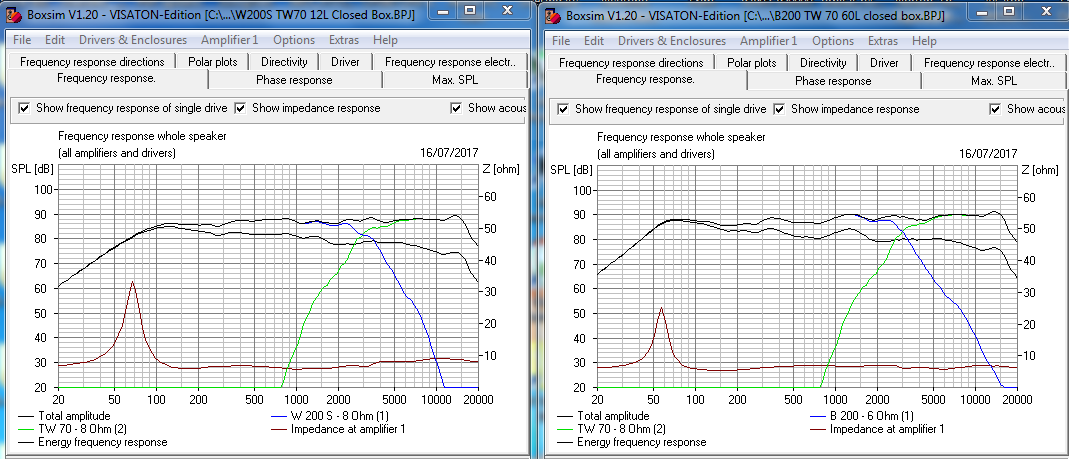

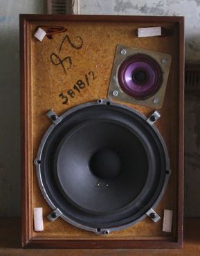

I compared the Visaton modelling for a modern rubber surround, big magnet W200S in a tiny 12L with the very retro cloth surround B200 in 60L. They actually end up in much the same place.
Even on power handling, though you must trust me on this. Anyway, the comparison below. A lot to be said for the small box which works as well as the big one. Wharfedale did this sort of small box back in the seventies with the 20L Wharfedale Denton II with an 8" bass. Possibly the best selling speaker they ever made. FWIW, the cone midrange/tweeter was crossed quite low around 1.5kHz. It was a plastic unit with a built-in chamber around the size of a coffee-cup with some wadding. I quite like the old retro cloth-surround style though. The Sony E44 is so retro, it's laughable. But extremely musical IMO, especially with a good crossover.

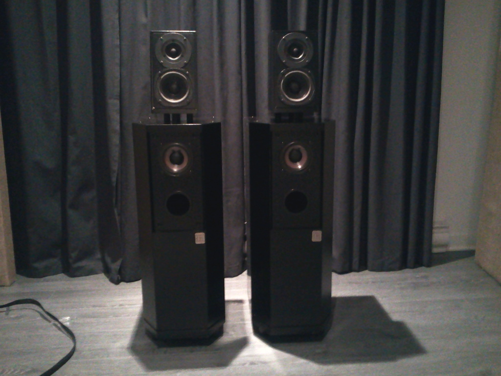

That picture just screams Scan Speak 🙂
For years, Wilson and ScanSpeak have maintained an intimite oem relationship. For the better according to many, the SS based Wilsons are overall better balanced and easier on the ear.
Look at this $785.000 SS array:
Iam pretty sure this still is no match for your arrays as far as response is concerned.
