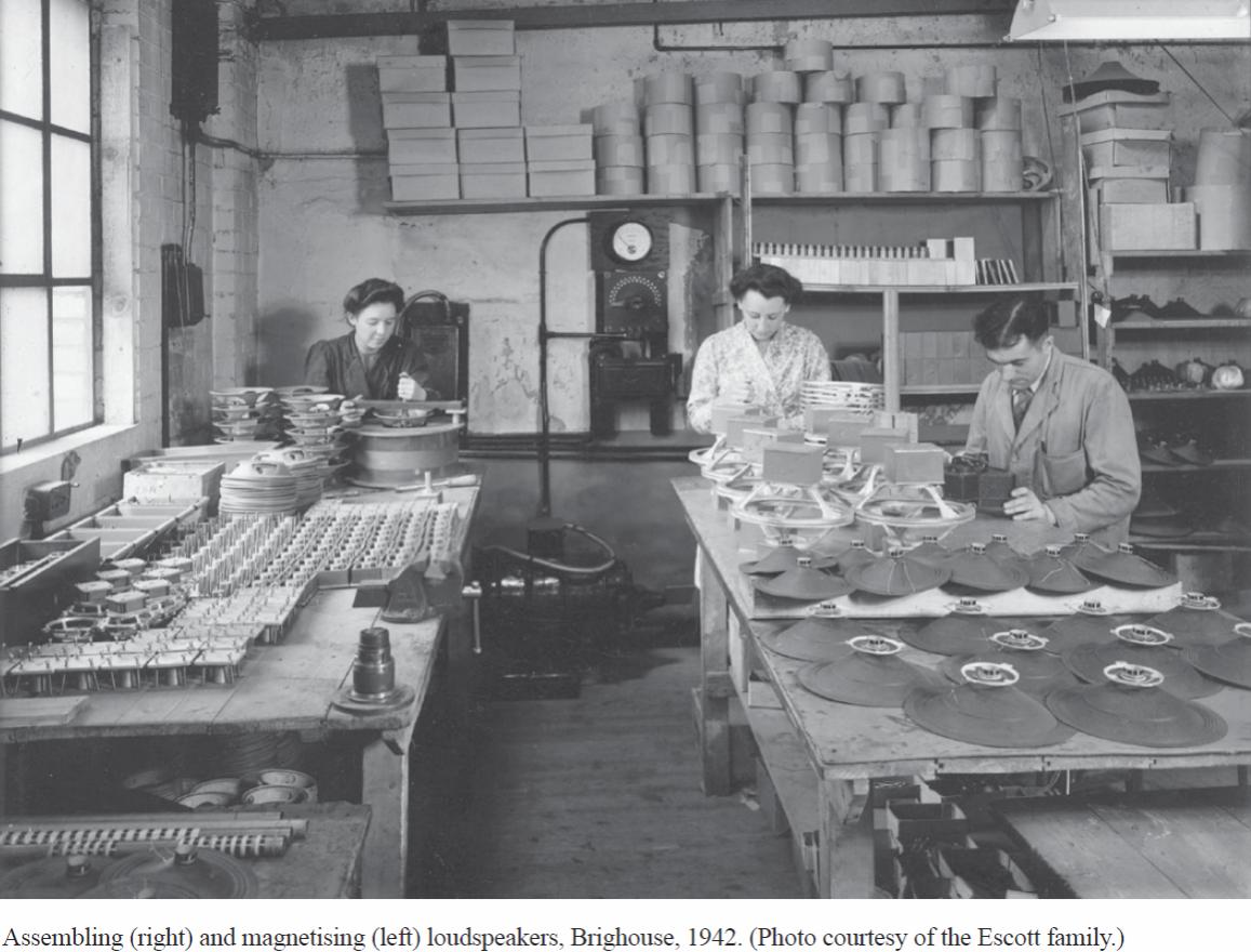

Manufacturing loudspeaker drivers during WWII...

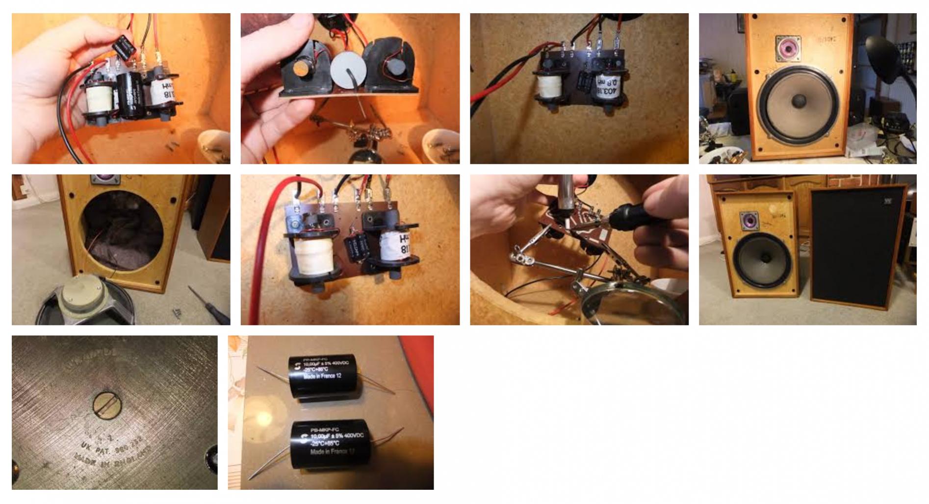

Years ago, I got a pair of Wharfedale Melton 2's and Linton 2's.
I Replaced the ancient caps (4 & 6 uf coupled bipolar caps) with a Mungdorf 10uf, as shown in the collage.
I did not measure the things, but the very thick rubber surround had stiffened over the years.
The tweeters of the Wharfedales from this era is a rather particuliar design. It's called a CAB cone which is an abbreviation of Cellulosic Butyrate Acetate.
I treated the surrounds with natural oil in order to weaken the rubber surrounds and hooked them up to a Chevin Research studio amp. While this was way beyond the power specs, it did open up the sound.
These rather big 2 ways had an overall pleasant sound with good imaging, especially with classic chamber, jazz and similar acoustic music.
Eventually, I fried a voicecoil while playing some electronic music. Apparently, the motor was no longer capable to adequately move the cone due to the extremely stiff(ened) suspension.
The Linton 2's had a similar sound quality, only 'scaled down'. All in all, these vintage Wharfedale loudspeakers are not bad, but obviously most modern drivers are much better compared to these Wharfedale units. Celestion, Kef and Goodmans in particular offered similar loudspeakers systems.

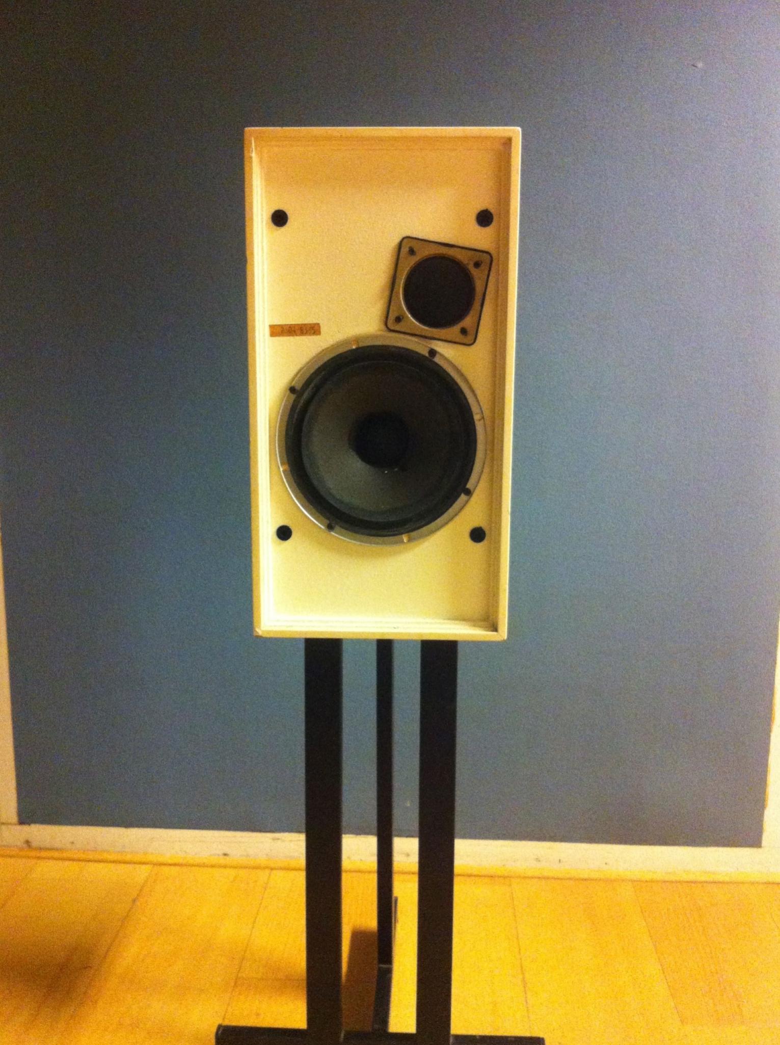

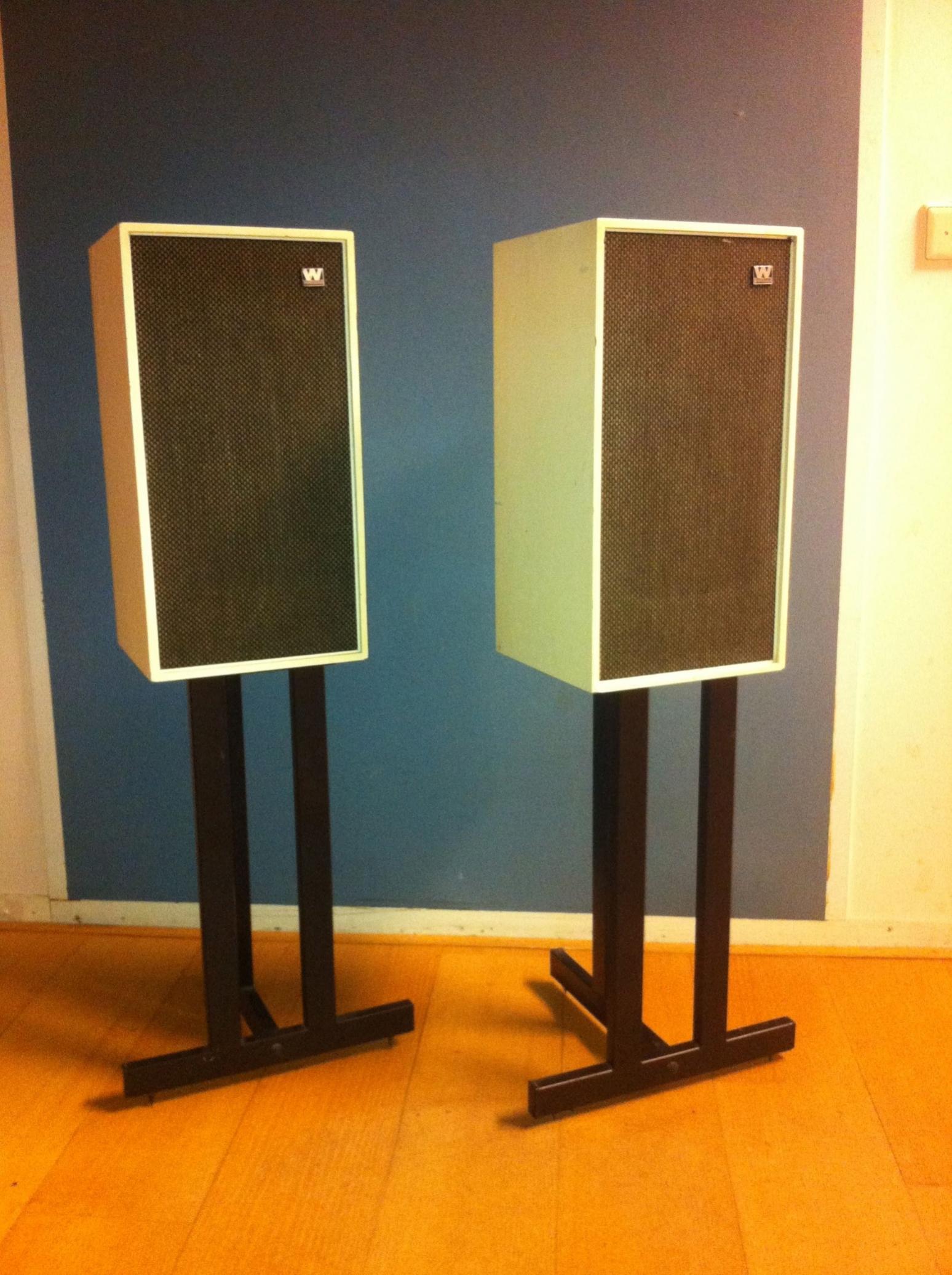

The last photos (bad early smartphone lenses) show 1 of my Melton 2's and a Linton 2. The Linton's still had their original white rubbing varnish coating, which was a rather expensive custom order finish.

RE - Wharfdale factory pic in Post #402
1942 was during WW2, so a lot of war news etc must have been listened to on Valve radios with them in. That factory room looks like so many images from back then. No wall insulation or double glazing etc etc. Hot in summer & cold & drafty in winter. At least conditions have vastly improved since then. But, i bet they were happy, & had more fun working than many in recent times.
A friend of mine had the Wharfedale Linton's back in the day. We & lots of our friends spent many hours over the years, listening to Plenty of Great music on them. Thanx 4 the memories 🙂

We seem to have shared the Wharfedale experience, Ro808. I had the Lintons and the Meltons. The Melton was possibly more effortless and went deeper.
The tweeter was really a 3" midrange in a small coffee-cup sized plastic enclosure filled with wadding.
Seems like Wharfedale gave it 10uF and 0,18mH. Bass filter to suit around 1kHz.

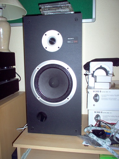

I have the Sony E44, but it doesn't look like an old SEAS unit to me. But very musical. The tweeter is good too. The original woeful crossover was just 3.3uF to the tweeter. I tidied it all up considerably. Very nice.

The woofer of the Sony E-44 is not from SEAS. It appears to be a light cone with a finely structured, coated fabric surround. Similar to a pro mid/low woofer.

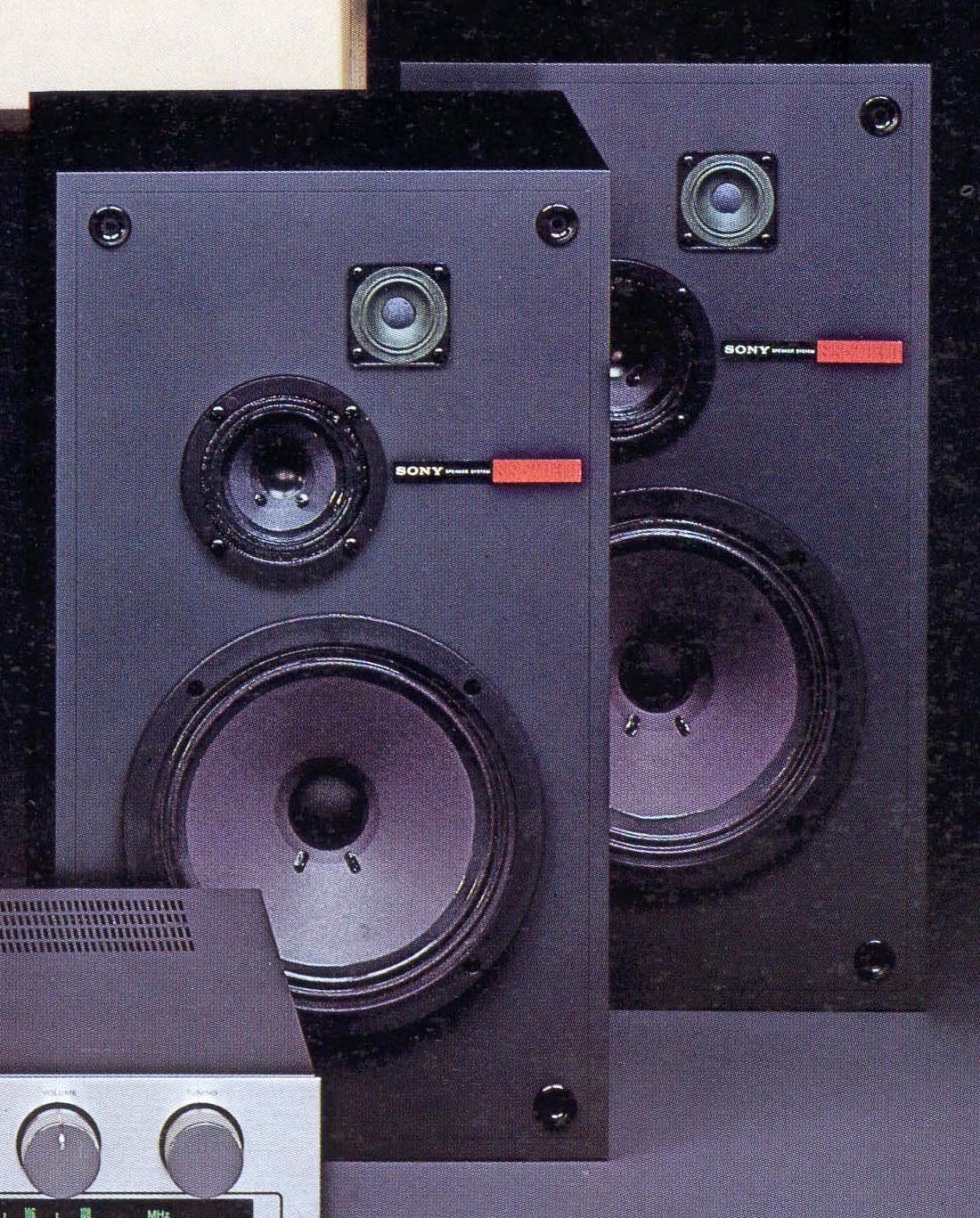

This is one example:
Sony SS-2030
Specs:
3-way configuration,
closed box,
paper cone woofer Seas 21F-GWS 200mm, textile surround, diecast basket,
paper cone midrange Seas 10F-LG 100mm, textile surround, diecast basket, acoustic chamber,
paper cone tweeter Seas 5TV-HFS 50mm, AlNiCo magnet,
30W@8Ω,
45-18000Hz,
sens. -- dB,
mm 280x500x229, kg 7,0.
All drivers and crossover are exposed here

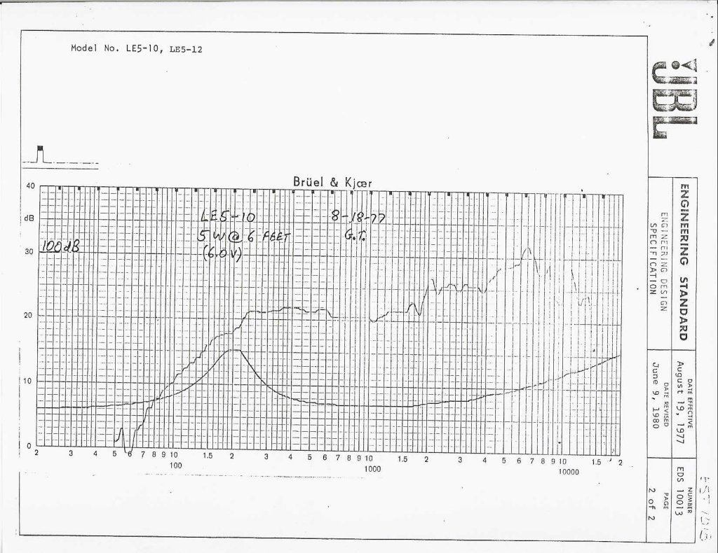

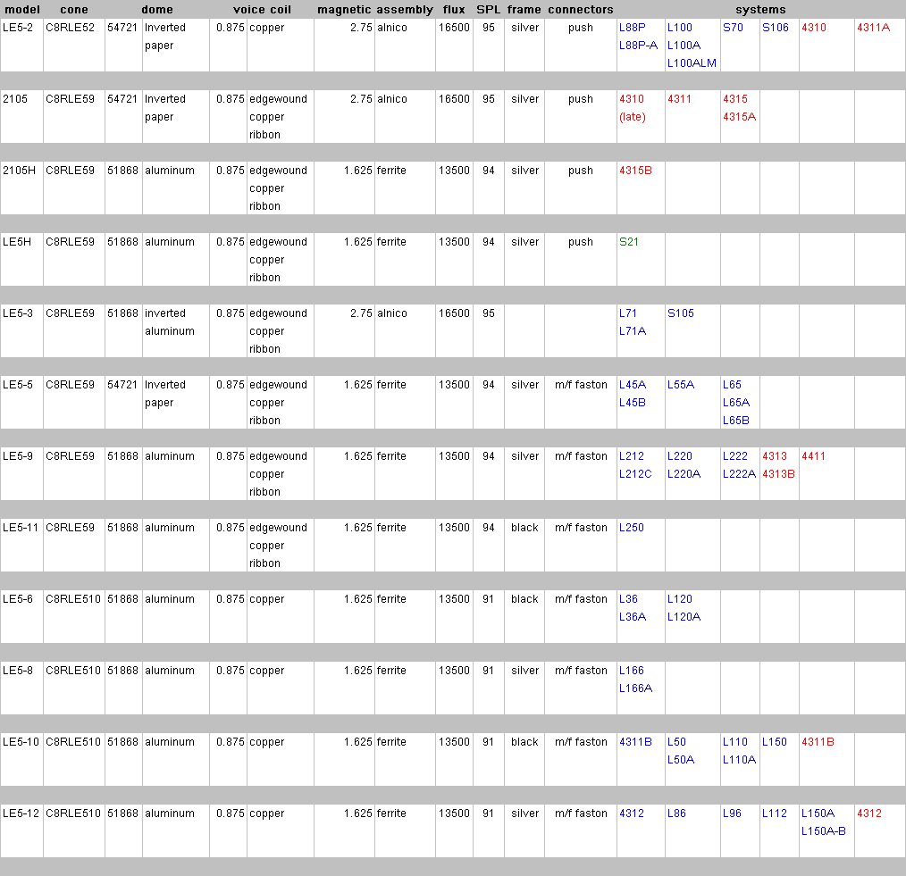

Some interesting notes and official JBL documents on the different LE5 versions from legendary JBL engineer Greg Timbers.
(Source: audioheritage).
The Alnico LE5-2 and LE5-3
For reasons not very well understood, there are two versions of the LE5-2, the round wire version and the ribbon wire version. Just knowing the model number doesn't help. Later versions of the LE5-2 were round wire only and the LE5-3 became the ribbon wire version. The Alnico motors had a .080 gap height and a flux density of 1.65 T.
The Ferrites
The ferrite motors had a .140 gap height and a flux density of 1.35 T.
General
All the LE5's used the same cone and spider. Dust domes were either paper or aluminum. The voice coils were either ribbon or round and all of them had a .125 voice coil height. The odd model numbers used the ribbon voice coil, were more efficient and had a more level curve good to ~ 8 to 10 kHz. The even model numbers used the round voice coil, had more of a rising response and were good to ~ 16 kHz.
The Ferrites
General

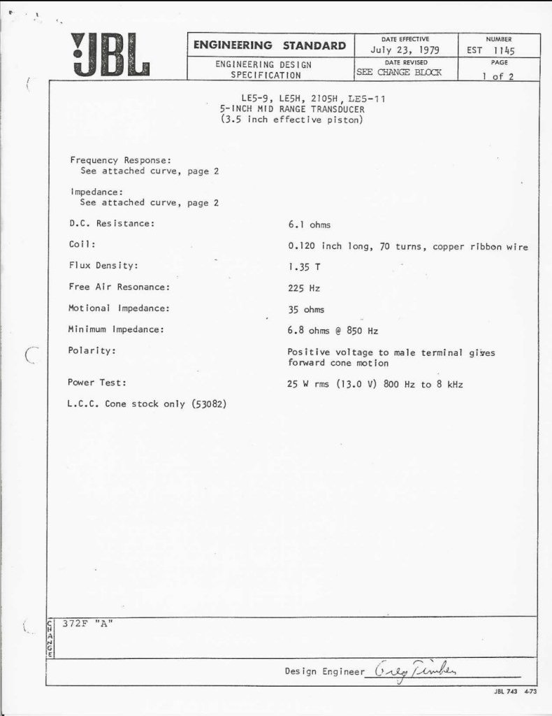

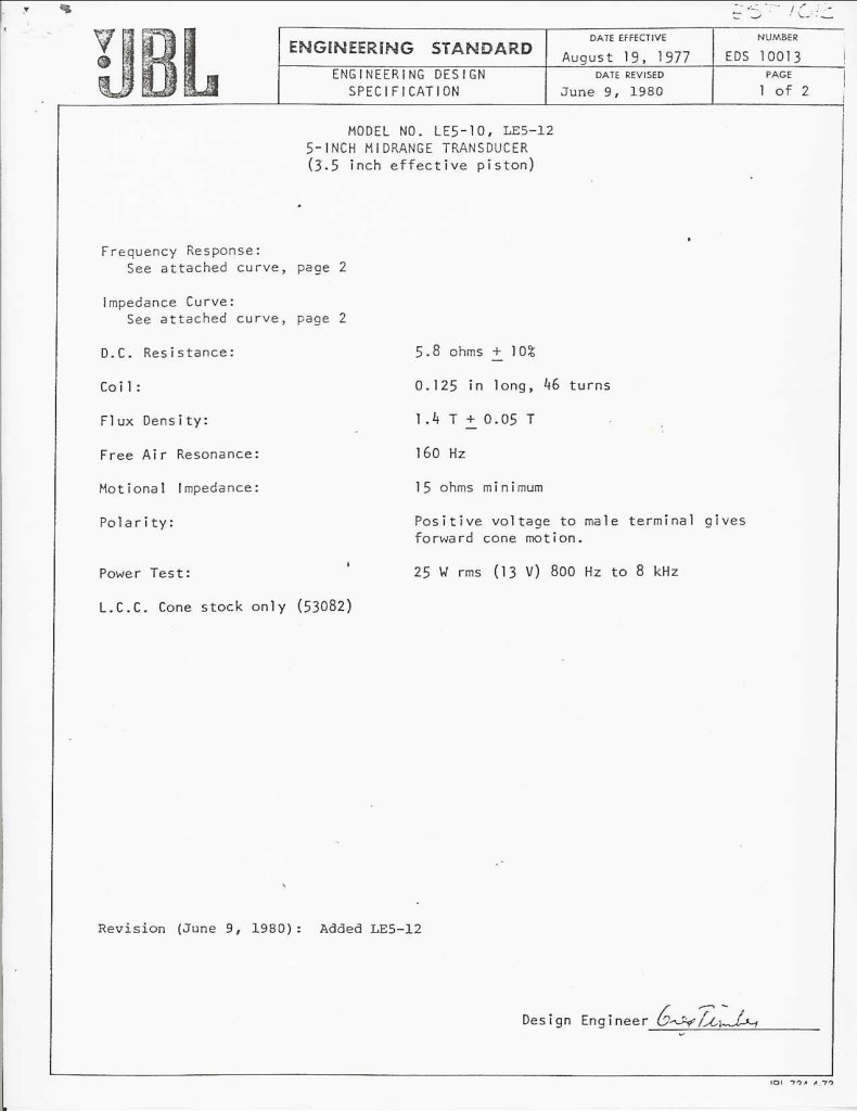

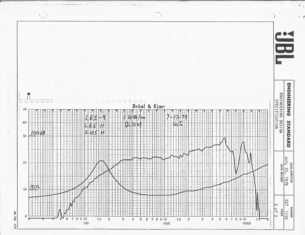

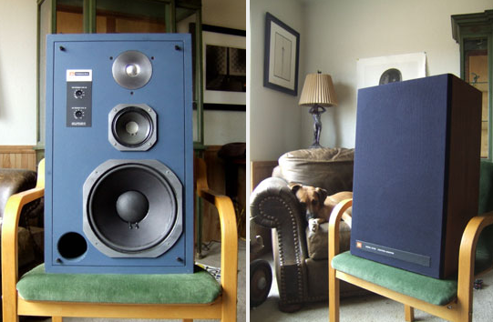

The LE-5/8 is a classic, but it's a difficult driver according to Troels.
Crossovers in vintage JBL monitors should be reworked and upgraded.
European HES LE-5/8 alternatives:
The FANE vintage 5m
RCF's classic 5".
Here is an article that I employed with the croosover replacement with an additional .01uF bypass that you may find interesting. Bypassed and Biased Capacitors
I was aware of the practice from regular JBL literature, but these examples are educational.
Bypassing makes sense, especially when high value caps are involved and is useful in 'voicing' a crossover. The latter is common practice at Living Voice, Audio Note and many other small manufacturers.
It seems an immensely repetitive job in order to find tiny (subjective) improvements in sound quality.
I do believe in the added value of a quality cap, figuratively speaking. But from an electrical point of view and as a proponent of straightforward engineering, I don't see any merit in going overboard with exotic beewax bull....
Paper in oil, tin foil.... It depends.

This post crossed my mind while hunting for the origin of the woofer in Steve's Sony E-44's. I have found it and will dedicate a seperate post tomorrow.

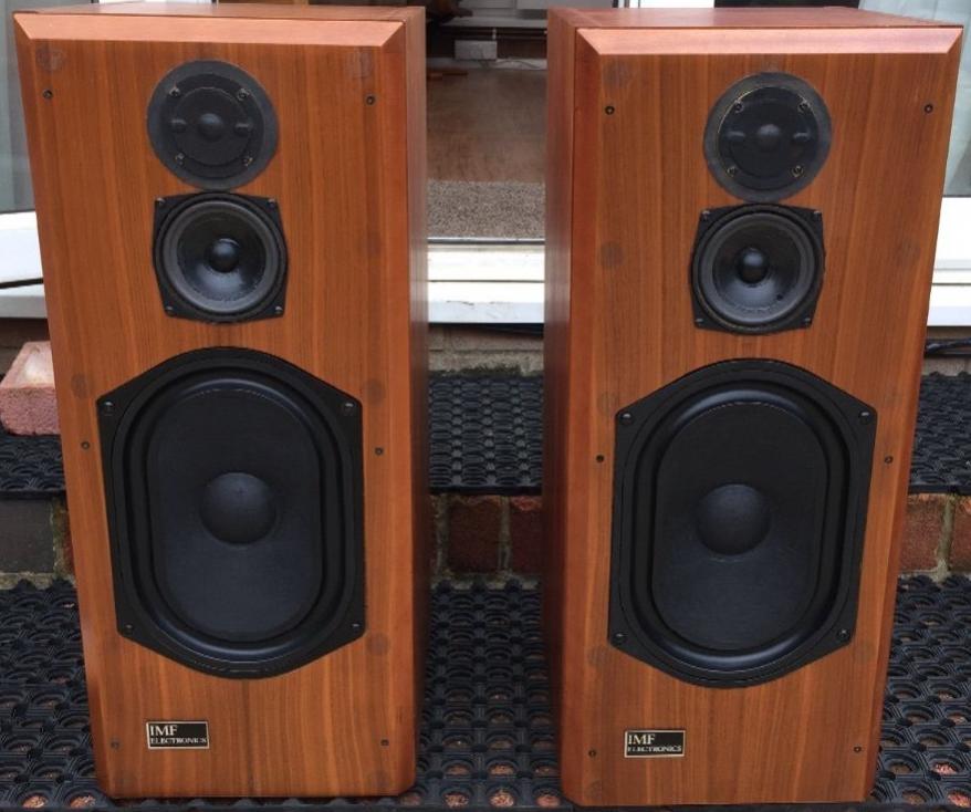

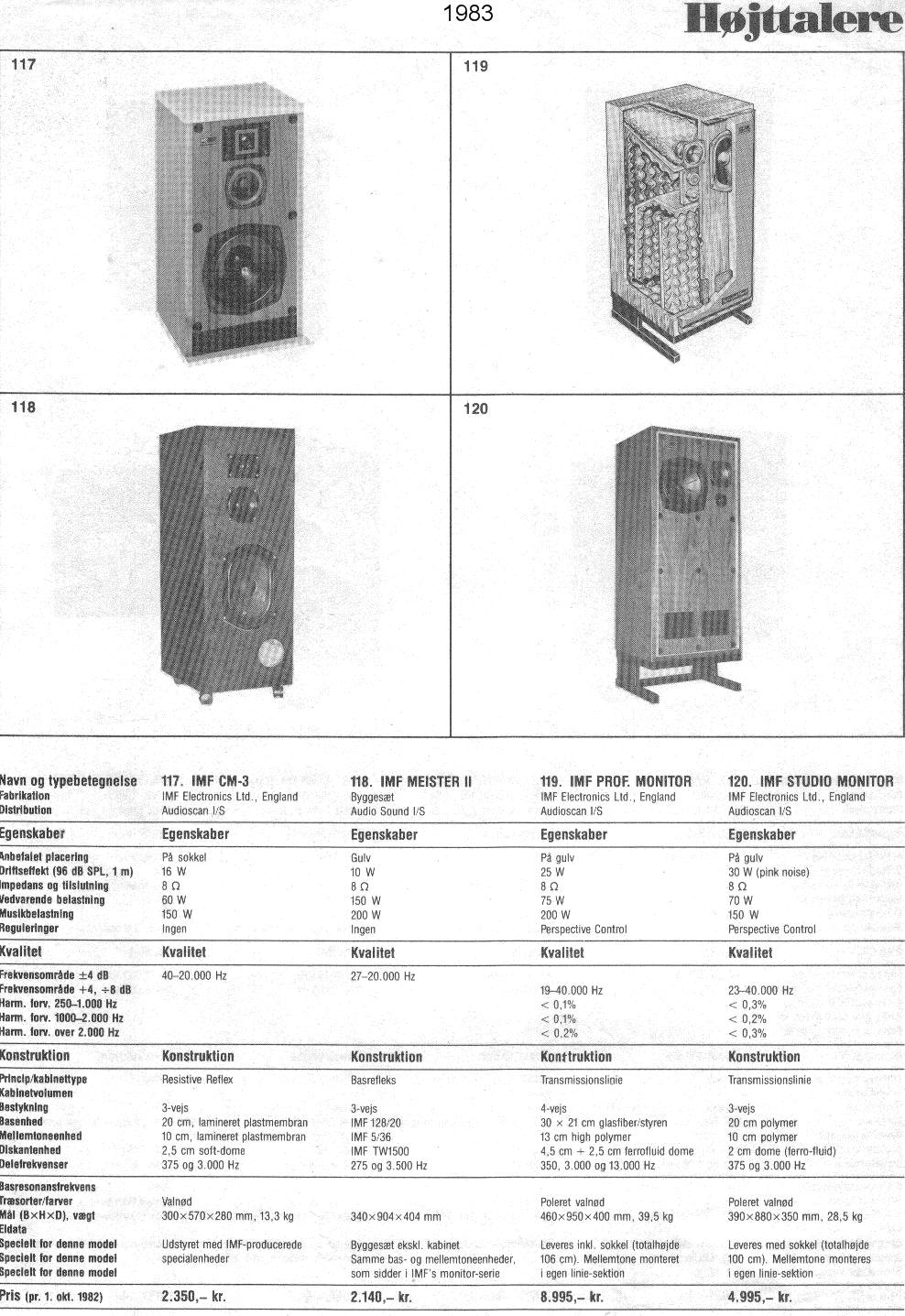

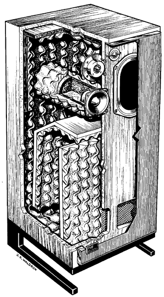

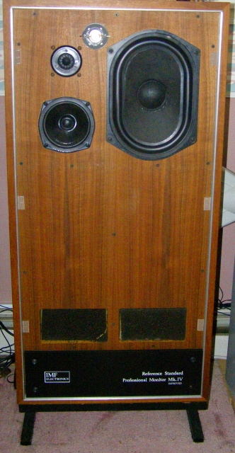

The late Irving “Bud” Fried (1920–2005) blazed a trail through high-end audio’s formative years, first as an importer of classic British gear and later, starting in the 1970s, as a manufacturer of transmission line (TL) speakers under the Fried name. His strongly held beliefs about loudspeaker design were based, as he put it, upon the inexorable laws of physics, and he wasn’t afraid to promote and defend his ideas within the audiophile community. Fried maintained that the ideal loudspeaker would preserve the audio signal’s time coherency, which explains his fondness for the non-resonant bass response of TL designs. However, his pet preference for series, rather than parallel crossover networks, seems a bit quaint today after 40 years of progress in this field.
At the suggestion of Saul Marantz, the IMF (Irving M Fried) trademark was registered in 1961, a trademark that was eventually applied to many advanced developments in music reproduction: cartridges (IMF - London, IMF - Goldring), tone arms (SME, Gould, Audio and Design), amplifiers (Quad, Custom Series), loudspeakers (Lowther, Quad, Celestion, Bowers and Wilkins, Barker, etc.) In 1968 a British branch of IMF was opened. This combined Anglo-American company produced the now legendary IMF Monitor, the first truly wide band loudspeaker the world had seen. In 1975 the English and American divisions of IMF were split, and the trademark FRIED was thenceforth used on all of Bud's designs. The new designs were based upon the same inexorable laws of acoustics that had created the IMF Monitor in addition to new technology as it became available. FRIED benchmarks include the Model H System, the first modern satellite/subwoofer system, the Model M (1977), the first satellite transmission line subwoofer in one unit, the SUPER Monitor (which many still consider to be one of the premier speakers of our day), and the B satellite series (1976 to 1979).
TDL continued the IMF legacy with improved TL designs.
Quote from diyaudio member dnsey:
"I ran a pair of TLS50s for a couple of years.
The bass was truly impressive - tighter than most reviewers would have you believe, and extended right down to 'feel' frequencies. Acoustic bass was particularly startling in its realism.
However, the imaging seemed almost non-existant (four drivers), and the midrange was distinctly woolly. Changing the crossover caps for decent polys helped a bit.
These days, I'd happily have another pair, but mod them into 3-way units with decent MF drivers."
