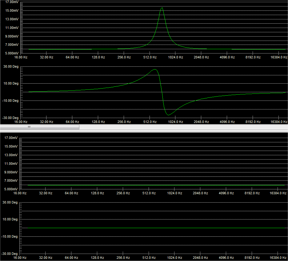

Yes and speaking of which, a few things that may cause the ideal RLC correction to fail are: The model is idealistic and component tolerances and our calculations may cause this correction to be all but complete. Driver non-linearities might cause dynamic imbalances, and flawed components might possibly bring their own signature. Only this last one however is a potential reason not to do this (IMO).
Phase is of course an indicator of reactance. This plot shows nothing that hasn't already been shown. (Top to bottom...magnitude/phase - without/with correction)

sounds like quite a lot can go wrong, with those 'variables' you mention
for one, Fs may change in time, no ?
phase still turns through out the whole system(speaker), and always will, no ?
and not to forget that relative phase varies even on each driver cone, in its own passband(and stopband)
I suppose thats not easy to simulate, is it ?
I fear there is still a lot that could tilt even a perfect model
and my personal experience is that when it tilts, it is very audible

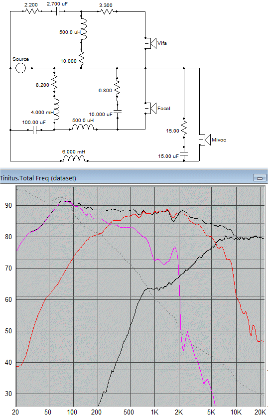

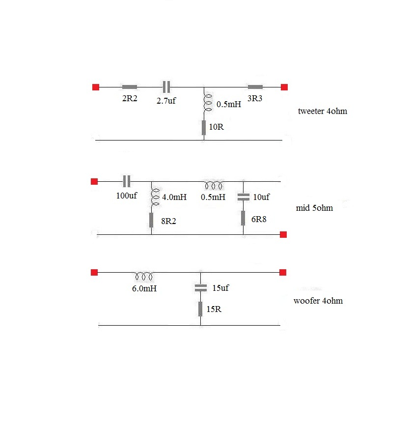

I've come up with a draft plot. There are some limitations. They are as follows....
I got some response files from Roman Bednarek. They are for the XT19, and the Focal 5W4211. I think this mid is very similar to yours, different cone material though. I also am not sure of the baffle conditions of the response measurements. I couldn't get an impedance plot for the woofer so I simulated it, then modified an impedance plot for another 12" woofer I had. The response is from Mivoc's site. The box volume wasn't included but that's easy to add in by sight. The baffle wasn't included but it will be obvious anyway, and no acoustic phase has been allowed for.
The response looks good, considering. Flat where it's important, baffle looks compensated for, and you seem to have a top end roll-off very similar to the roll-off I go for myself.
Would you like the .swd files?
Very interesting. Thoughts. The Focus 5" is almost a car bass/mid speaker...good from 100Hz to 5kHz. The tweeter is very extended in FR to 30kHz. The Mivoc bass has about 3dB of lift from 60 to 300Hz which makes the efficiency a bit vague but relatively high here, good to 800Hz.
I make that Mivoc 12" bass: 90dB, Vas 97l, Qts 0.31, Fs 27Hz, 4 ohm, 3 ohm Re. Rough good enclosure size: 40-55l.
Focus 5" (albeit from different unit): 87dB, Vas 13.7l, Qts 0.28, Fs 46.5Hz, approx 4 ohm. Rough good enclosure size: 8l.
Peerless/Vifa XT19 vented tweeter: 87dB without waveguide, Le 0.01mH, Fs 780Hz, 3.3 ohm Re. Qms 3.1, Qes 0.83, Qts 0.65.
FWIW, quite a high Q on the bare tweeter without waveguide. Possible to overdrive it quite easily without high order filter or compensation, I'd think. Not sure if it has ferrofluid. Looks like not, but it's a very nice looking tweeter.

I didn't include acoustic phase data and left it flat to begin with, so the polarity is of little relevance. I could have used minimum phase data, but unlike measured data, without delay and diffraction contributions included it would have been misleading.

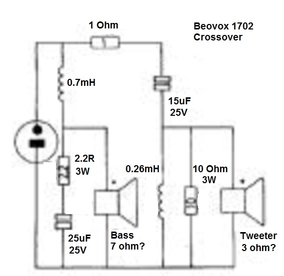

Most of that stuff found its way into the Museum of Modern Art in New York. I had the matching Beovox 2702 small speakers which had 6" woofer and 2" tweeter. Designed to work with the main 3 way 5700 models in 4 speaker Ambiophonics. Very good dispersion and some neat touches like rear wall mounting plates. Lovely to look at, of course. The foam surrounds do tend to rot though. I have included the crossover, which is standard 2nd. order stuff, but interesting for the bigger than expected bass capacitor and resistor which probably tweaks the phase a bit. A little attenuation on the tweeter which helps damp Fs and a crossover of ca. 2.2 KHz, I reckon.

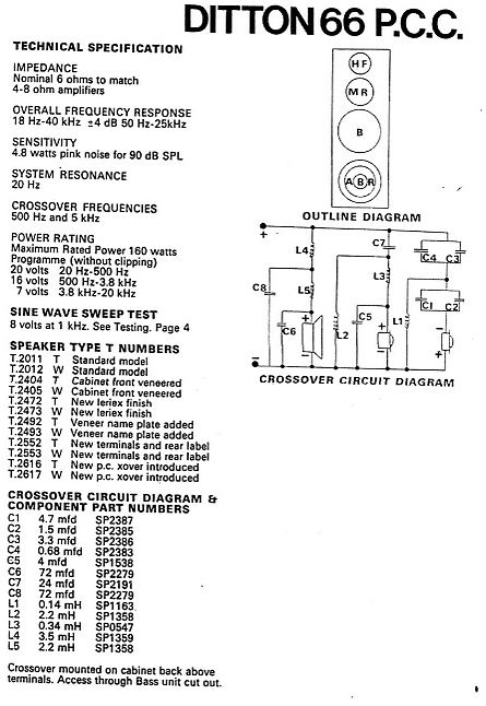

The very keen eyed will notice the nice 2" dome treble in the Bang & Olufsen loudspeakers. It was made by Celestion, who made everybody's 70s party speaker, The Celestion Ditton 66. Man these impressively huge things could ROCK! :D
There's a secret lurking in that unique Celestion 2" dome midrange if you think that 5KHz sound has a wavelength around 3". These babies were close to linear phase, because the midrange is almost the same size and location as the tweeter, unlike what you get with 5" and 8" units. In contrast, it plain doesn't matter with the bass 500Hz crossover point where wavelength is near 2'. The result is good dispersion off-axis and very little cancellation. :cool:
The passive auxiliary bass radiator was good for its time too. Speakers had much higher Qts in those days, and reflex was not so easy to do. ABR got some very unsuitable drive units going quite deep!
Crossover is nice too. 4th order on the bass is quite unusual these days, but probably kept cone breakup under control.
