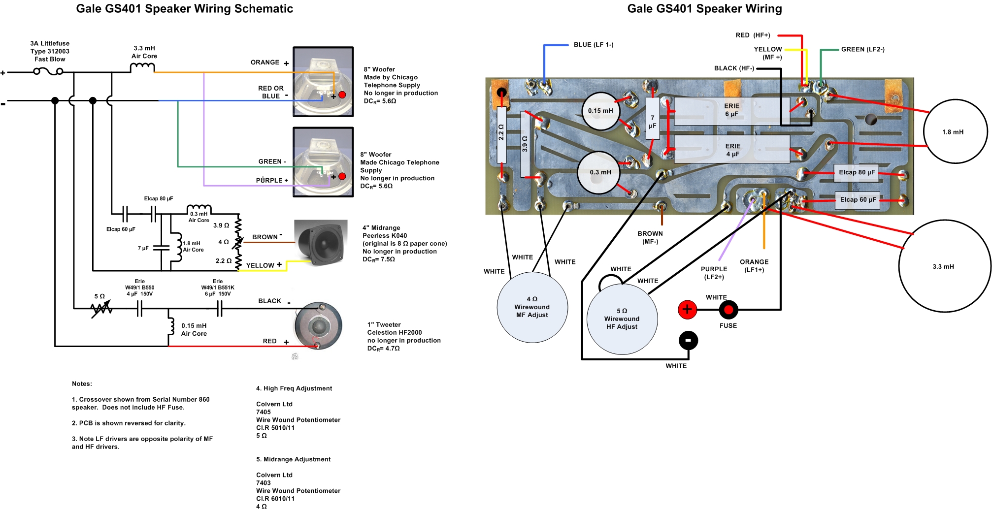

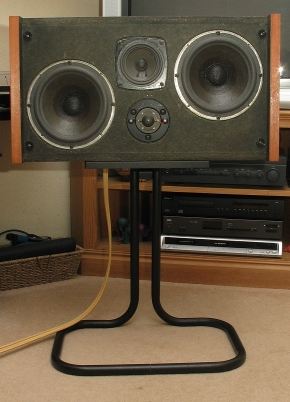

You can tell I am warming to this theme! Here's a mighty pretty loudspeaker, the Gale GS401A, that made everybody's jaws drop when playing Led Zeppelin's awesome Black Dog at 70's HiFi shows... 😀
This baby had punch like an Acoustic Research unit and slam and presence like a PA speaker and detail like a Quad electrostatic, and I was left plain wondering what magic stuff was hiding behind those grilles that sounded so GOOD! I'm gonna tell you... 😎
Firstly, the bad: it was a hideous 4 ohm load for amplifiers and had a reputation for frying them. 😱
The good: two AR derived foamed 8" paper units wired in parallel as in PA applications, with a simple AR type inductor for an overall second order rolloff to take care of the bass up to 500Hz.
Next was a 4" foamed paper Peerless midrange in a simple sealed plastic tube that went up to 5KHz. The midrange was a particular strength, and considered better than the dull and peaky KEF B110 5" bextrene midrange used in BBC type monitors. Secret sauce? Probably the resistive padding used on the drive unit and after the second order midrange filters. Early models had 4X 10R wirewound padding the midrange and flattening impedance.
From 5KHz, re-enter the excellent mylar domed Celestion HF2000 unit on a third order crossover. Often considered better than the KEF T27. Third order protects the tweeter from LF well, and acoustically matches a second order from the midrange. A lot to like there, and some ideas that found there way into the very fine and lively Wharfedale E70. You can read its history here.

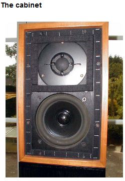

The 1970's BBC LS3/5A has legendary status in small monitors. This one was designed to work in small BBC broadcast vans. Astonishingly real reproduction of voices is its strength. Surprising bass for a small box too. Naturally efficiency is not its strength, which applies to all small boxes.
The old 5" KEF B110 8 ohm bass/mid and T27 tweeter are not that exciting by modern standards IMO, but commendably neutral when equalised carefully. The BBC did a lovely job of equalising in the crossover, and building a very neutral cabinet out of 12mm light birchwood ply with carefully considered damping.
The small drivers, crossing over at 3KHz (think wavelength around 5") give good dispersion, baffle step correction is applied via L1/R1 to rolloff the frequency response above 500Hz which accounts for the impressive bass, near 6dB applied here, and a little LCR trap around 1 kHz to tame a peak in the B110 output. The T27 gets little special treatment beyond a third order crossover and a Zobel network (R4/C6) to level impedance. The autotransformer doesn't do anything special beyond giving variable attenuation and can be treated as a simple inductor, in fact later versions used an inductor and resistors. I expect the overall response follows the usual BBC pattern of declining slightly (ca. -2dB) with increasing frequency, which is very unfatigueing to listen to.
Overall, very nice. I heard the Chartwell LS3/5A version of these, and found it hard to believe how so small a box could make such a big and clear sound! 🙂
Is that the real crossover? No wonder amplifiers fried. 7uf directly across the amplifier terminals!
They did make a cool looking turntable, though.
David S.
(Appears to be a drawing error.)
A friend of mine had the boring version with the standard cabinet, nicely made but never could understand why when he could have had *chrome*. He kept blowing the output stages on his Amcron power amps with them 🙂
That turntable was beautiful, cost a fortune too I seem to remember, wonder if anyone has one...

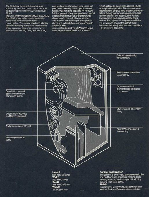

Time we looked at a transmission line as popularised by IMF in its huge 1/4 wave monitors, which has the optimal resistive bass damping according to its adherents...😎
This is the 1970's B&W DM2A, which is the (then) fashionable 8" bextrene bass, Celestion HF1300 tweeter and Coles 4001 supertweeter in a 1/8 wavelength line. In fact the HF1300 had its origins as a horn compression driver. 3rd. order butterworth filtering was also the BBC standard in those days. Nice impedance at the price of a slight SPL bump at crossover.
Much to like there. The offset drivers (this is the RHS cabinet) are designed to reduce diffraction problems, and the inverted tweeters should be more time-delay coherent. I had a listen to these, and can't fault them. The bass excursion was quite impressive. 😀

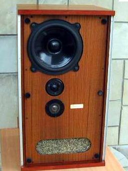

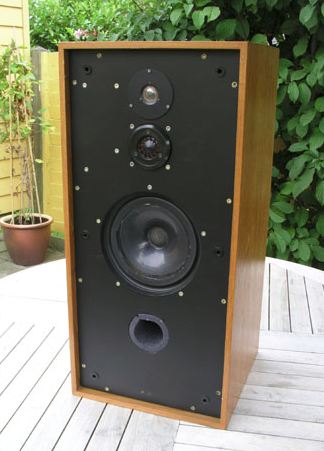

Much the same drivers were used in the reflex-loaded Spendor BC1, which was a legend for lack of colouration:

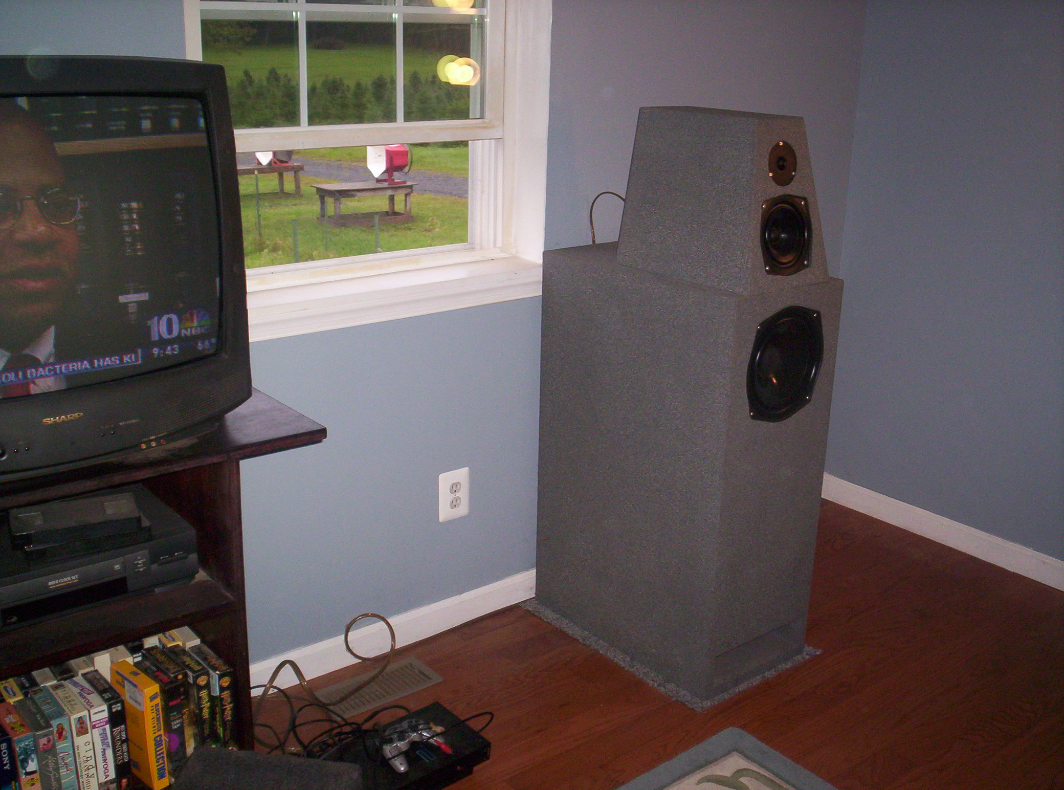

hey, beginning to look like a speaker, kind of, or maybe off 😛
well, they were supposed to be bookshelf speakers
but I decided not to abandon the true "spirit" of hifi :clown: and built a pair of stands :smash:
and I can tell you, even without drivers, they are bloddy heavy 😱
well, bloddy many small details to take care of, and still a few remains to be sorted

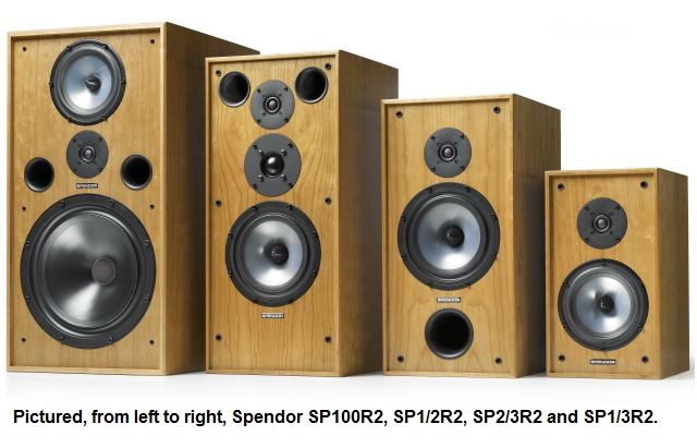

Unfortunately there are very few USA Spendor dealers. The Spendor Classic line model SP100R2 looks similiar in design to the BC1. It still uses a 12" damped bextrene cone.
The SP100 is quite a bit larger than a BC1, which used an 8" woofer.

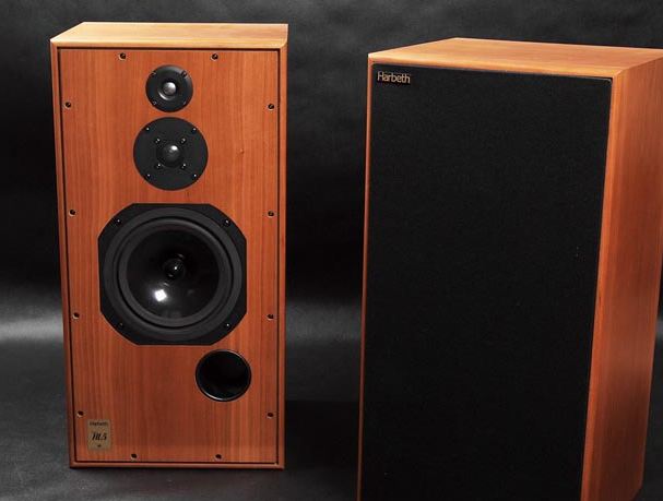

The SP100, and the Harbeth 40.1, are both sort of spiritual descendents of the BBC LS5/8.
The closest thing in Spendor's current lineup the the old BC1 would be the SP1/2R2.
Good to see that Spendor and Harbeth are keeping the BBC Monitor flame burning!
These are evidently exceptional neutral loudspeakers at a price. Retained is the thinnish damped cabinet and plastic bass cones and complex crossovers. Tweeters have moved on, of course, and those look like modern SEAS units, even (shudders...LOL) metal domes in the case of the Harbeth.
6moons audio reviews: Harbeth Super HL5
