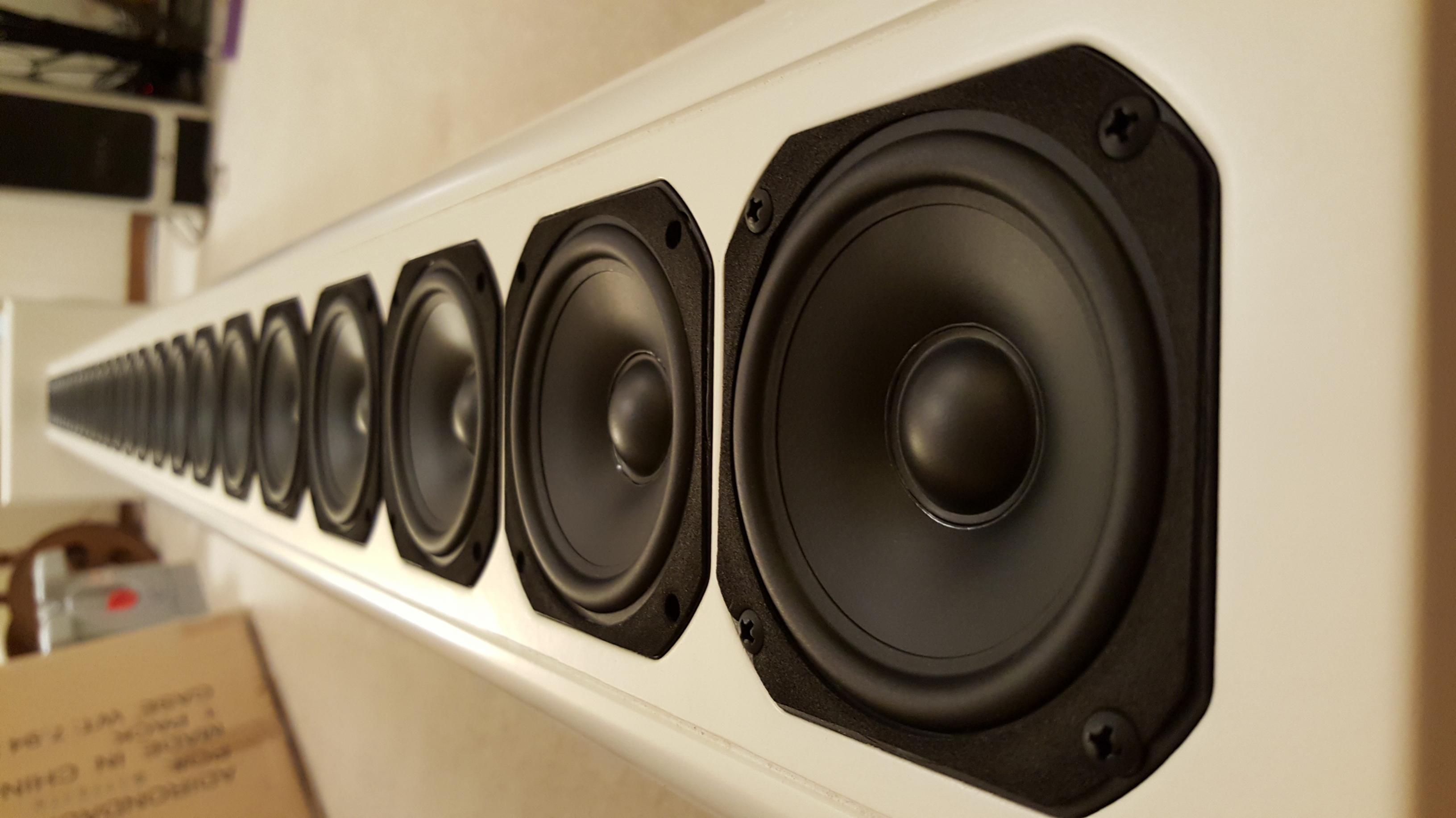

The only concerns I have at the moment (other than affording the drivers!), is high frequency roll off, and enclosure size.
Re: HF roll off, I have my doubts as to whether most recordings can even make use of the area past 17khz, especially those on LP records or analog tape. Second, I don’t know whether I or most other people would notice that last little bit of freuqncy on 99% of recordings even if it were there, given how much other tones predominate, and also given the poor quality of most people’s hearing. I take good care to protect my ears from loud noises, but my youth has been slipping away for some time now, and it has been some time since I’ve had a proper hearing test
digital recordings can make use of the full spectrum, but how many of our recordings were originally made on analog tape?
As to size l, I’m personally inclined to go along with what the original designer worked out, since he has a long and proven record in the field. But I’m wondering still what the effect of building a larger enclosure would be, and whether there would be a noticeable benefit to a larger volume?
As wesayso puts it, the floor area is about the size of an A4 paper.
It is best to have individual space for each of the drivers, but if that is too much work, grouping the drivers of same wired polarity together works well too. For example, if you have 25 drivers, it would be 5 shared space for 5 drivers each.
Regarding LF and HF, line arrays need some sort of EQ. There's no way around it. Going active is the best way. That way, you can also add DRC to time align all those drivers to your listening position.

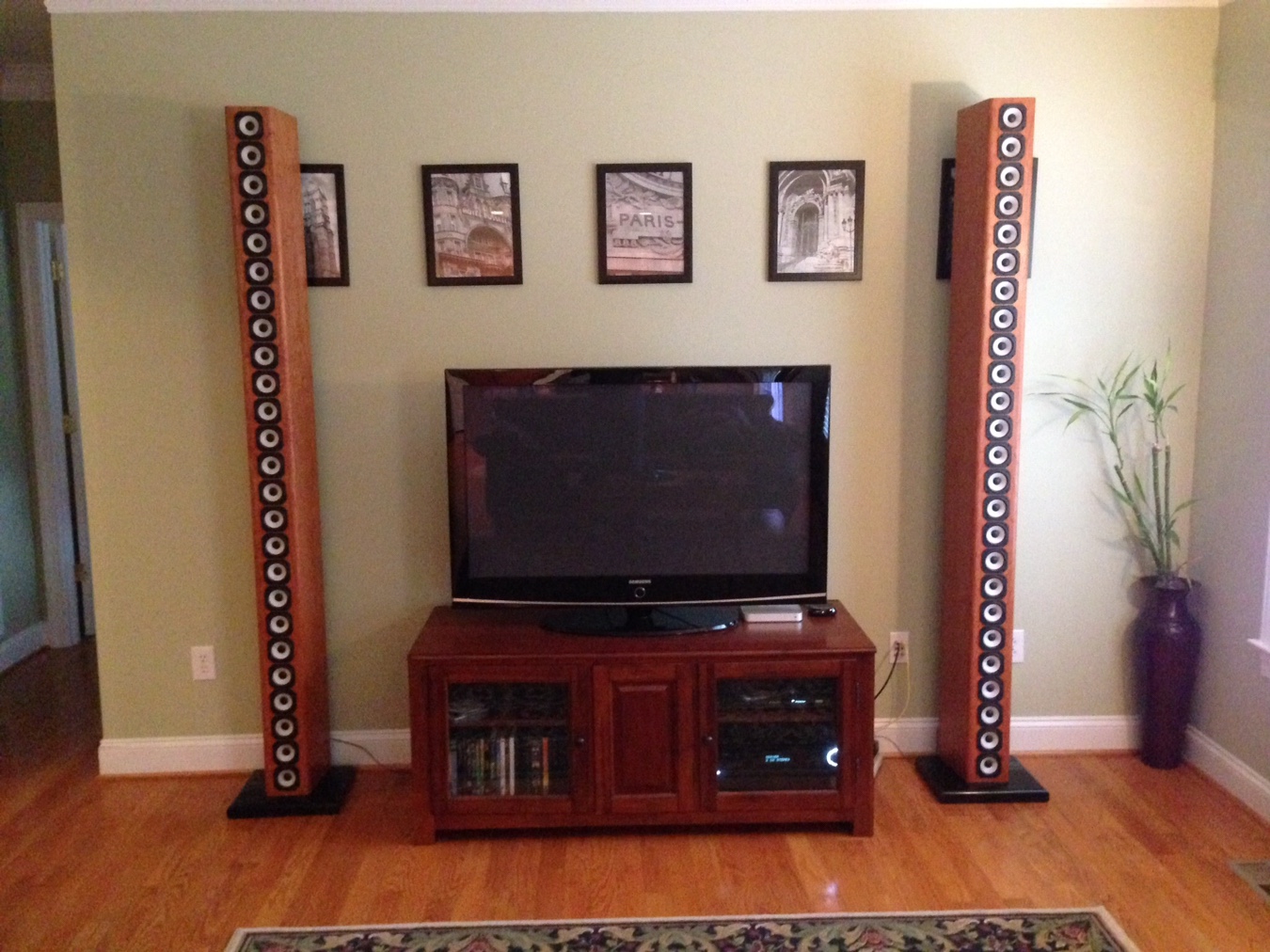

Build a set....you’ll love them
You've got tall ceilings! Your line arrays look nice by the way. How do the TC9's sound compared to the TC9's? Mine were made with the TC9.
