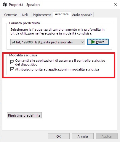

Could be it be that Exclusive Mode is not configured right?

Thinking the same. WASAPI exlusive mode require application to:Could be it be that Exclusive Mode is not configured right?
Since most decent dacs support ASIO, and some support DSD, if Windows tried to resample DSD the resulting audio stream couldn't work (Windows does not support DSD with its Sound Engine so far as I know, except maybe in WASAPI Exclusive mode, not sure). So it seems like there must be a way to tell Windows not to mess with the audio stream. Maybe it can be flagged as a non-PCM stream?
1. request WASAPI exclusive mode, check status whether is granted.
2. set pipe parameters, quite many. I can't help with this particular wrapper.

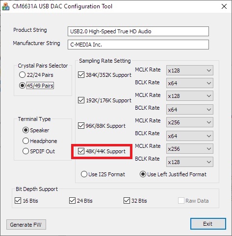

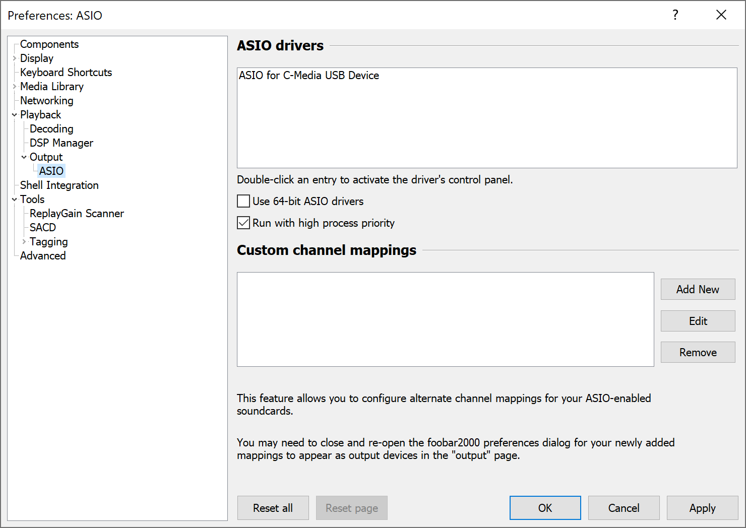

Thank you all, problem partially solved in this way on a Windows 7 OS machine:
- firmware regenerated as in post #867 and flashed on the CM6631A by a Windows XP machine
- Cmedia ASIO driver installed on the W7 machine
- DC samples played with Foobar on the W7 machine via ASIO
This way the DC samples are not resampled.
Now I have to check if this way works even on my W10 machine using the dotnet application and ASIO driver for Windows 10.

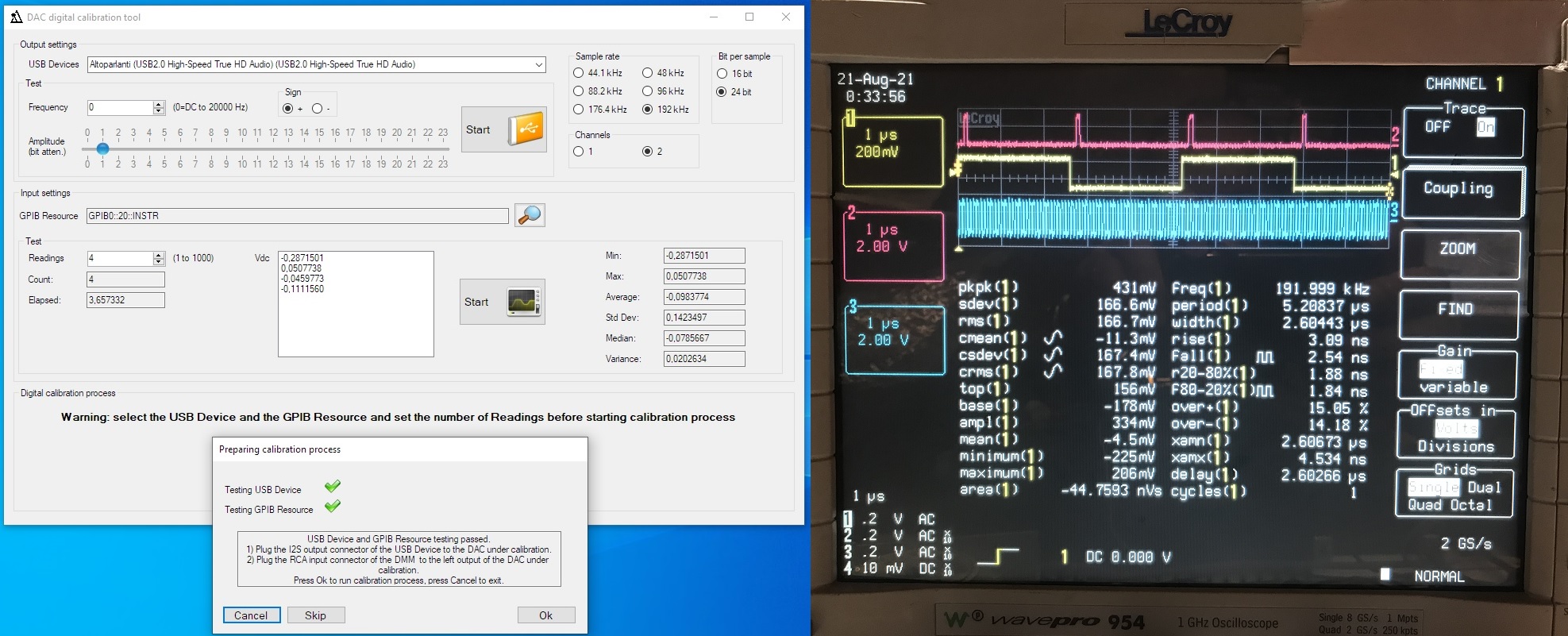

Succeeding in Windows 10 with WASAPI exclusive mode, now the DC samples are rendered correctly without any resampling in its originale format 192kHz/24 bit.
While is quite simple automating the measurement process of a Keythley DMM by using NI GBIP USB Interface and its libraries, Windows Digital Media is a real madness, one have to get crazy to do the simpler job like playing DC samples.

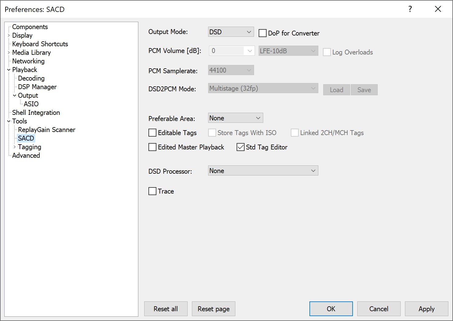

I am using a DIY development board based on CM6632A where LEDs are connected to all GPIO ports for indication. For testing I am using firmware "6632A-ES9018DSD-0305-ALL. hex" file from the SDK without any changes. Thus VID and PID used with default values (0D8C 0141), so using a driver from Windows Update, as it was written about this on this forum earlier. As a player for testing, I use Foobar 2000, as the most common option for outputting a DSD stream. I set up the player according to the instructions on this link, since the same IC is used in that DAC. No matter what DSD files I tried to play with any player settings, I never had the LED light up signaling the presence of a DSD stream. I tried other players like JRiver or Album Player that can output a DSD stream, but I never managed to output a DSD stream.
Can you tell me what I'm doing wrong? What should I do with the firmware, driver or player to output the DSD stream from CM6632A?

A picture guide is missing important steps, by example what output is selected in Foobar? Use the latest software, this one is very old, it ask you to install proxy, it is only needed in a specific situation and is incompatible with the latest Foobar version. Uninstall everything and follow this guide: Foobar 2000 for Dummies (Part 1) – General Setup | DIY-Audio-Heaven
A guide is frequently updated, DSD playback in the second part, but don't skip the first part. Try basic setup first (without proxy), it will transfer DSD embedded in DoP frames over WASAPI or ASIO, see valid output selections (screenshot): https://diyaudioheaven.files.wordpress.com/2015/11/outputs_zpsyoxcjuld.jpg
It starts from DSD:WASAPIxxx:<your drivername>
or DSD:ASIO:<your drivername>

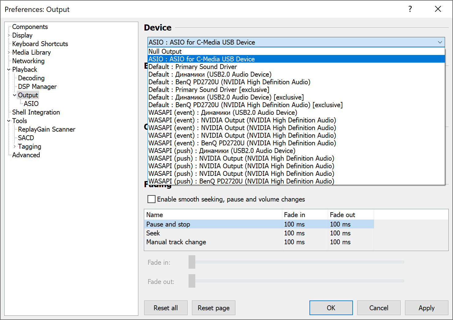

All right. I upgraded Foobar to the latest v1.6.7. It didn't break anything, can play PCM and DSD files as usual. There is one important change that WASAPI shared is no longer default output, but WASAPI exclusive. It means what WASAPI component is not longer needed. It is said in the release notes clear.
So I uninstalled WASAPI component. Nothing has changed, except there is a need to reselect driver. Previously there was WASAPI event: [drivername] and WASAPI push [drivername], now the word WASAPI disappeared, replaced by two positions:
Default : [name of the driver]
Default : [name of the driver] (exclusive)
I gather that the first one will be shared access (goes through system mixer) and the second one is the old (with addon) WASAPI exclusive. Only the second one should be used when playing DSD. Shame, the word 'exclusive" is on the end of string and is obscured in my Toolbar switcher. For @P.M. it doesn't matter, as long ASIO output is selected.

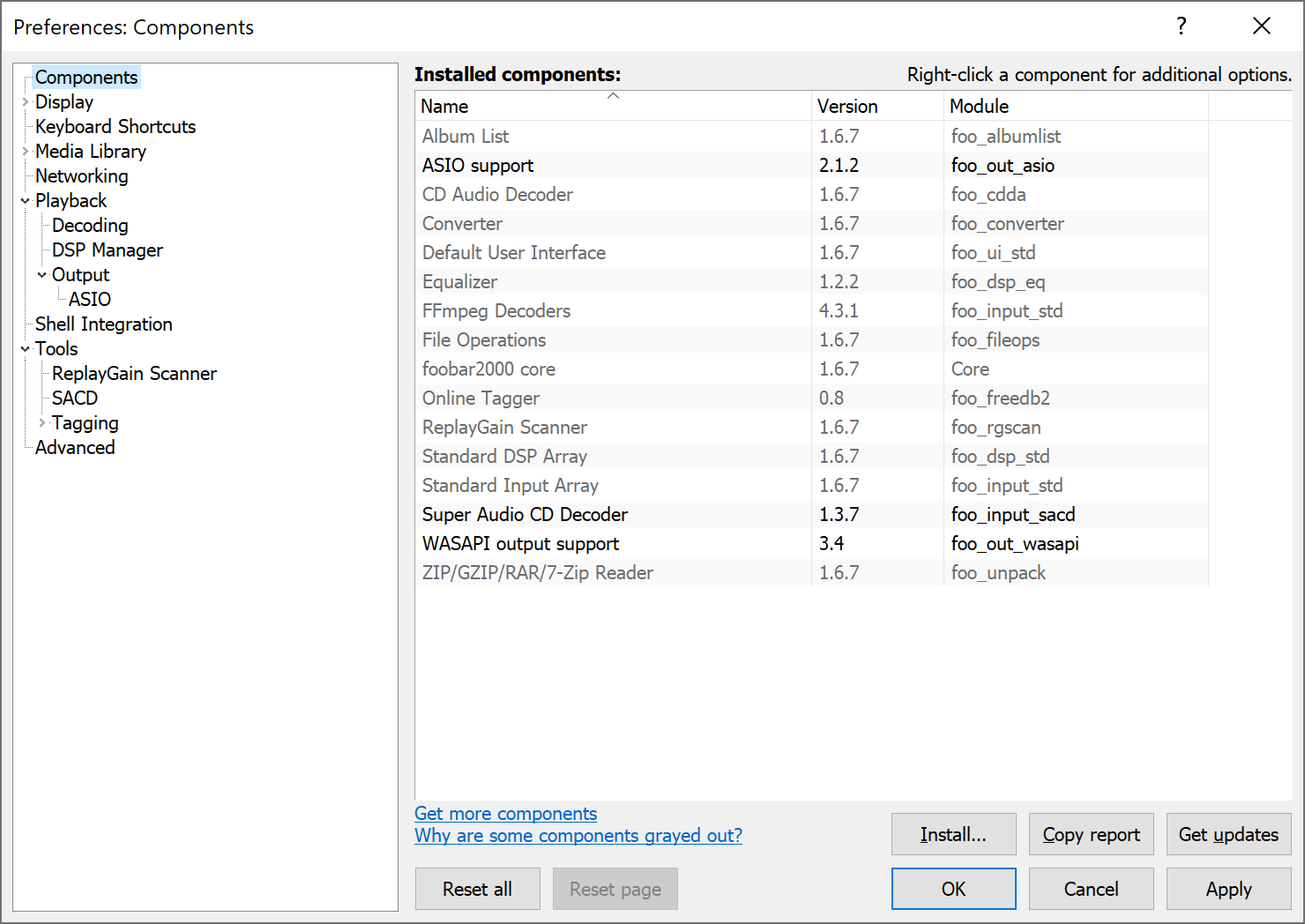

In next step I updated SACD component to the latest v.1.3.7. The only change is following Foobar's simplification of output device list. Now SACD component is fully integrated with Foobar, there is no separate output called DSD:xxx. So don't need to worry about as long it plays DSD files! A quote from a plugin Q&A:
It means that autoproxy feature replaces DSD:xxx output, there is no longer DSD:xxx

A. 1.3.x line has introduced "autoproxy" feature when SACD plugins outputs DoP if it is set to DSD or DSD+PCM. 1.2.x does the same when foobar output is set to "DSD : ..."

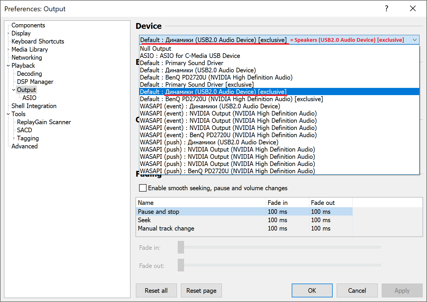

I switched the output to the second point, as you recommended. In my case, the output is called - Speakers (USB 2.0 Audio Device) [exclusive]. When I try to play, I get an error message. I tried to set different output data format in the settings, but it didn't help.
Is there a way to check the DSD support by the driver and the firmware of the CM6632A?

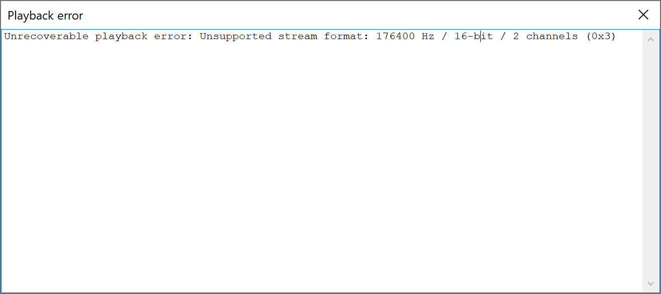

The output device is correct. On the second sreenshot problem is identified:
"Unsupported stream format: 176400 Hz / 16-bit"
It seems 16-bit Output Format is set on the same page (obstracted by the expanded view of output devices, so I couldn't see it). When you play PCM, output will be truncated to 16-bits, but when playing DSD, it is a wrong word size. Change to 24-bits and it should play DSD fine.
You will also find that ASIO plays as well. 🙂
