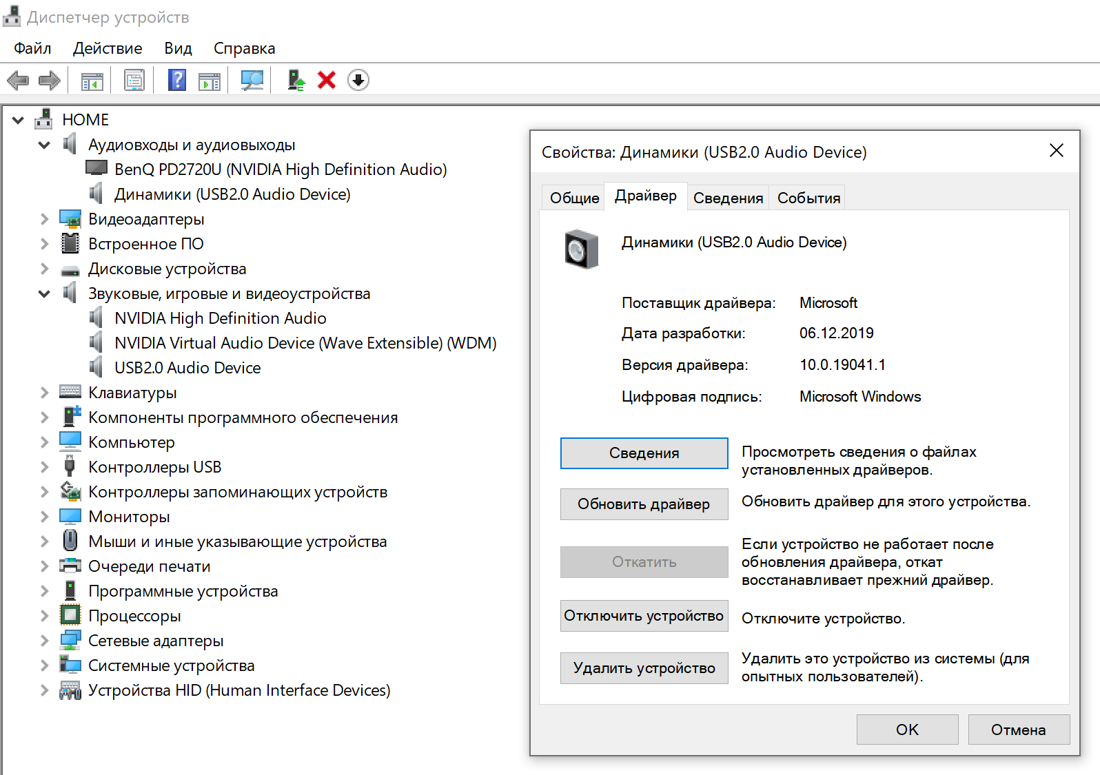

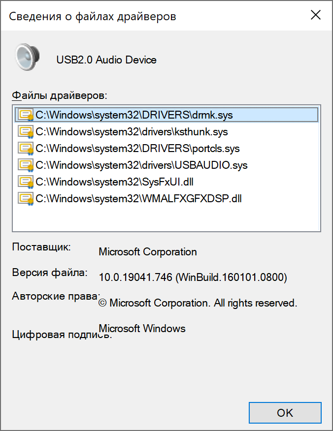

But I tried all output data formats from 16 to 32 bit. In all cases, the same error message appeared.
If I select ASIO device, then another error message appears when I try to play it:
Unrecoverable playback error: Could not initialize the driver
Such error give indication that firmware on the receiver is hang or on the host you have active multiple instances of the same driver, some dormant. If Windows 10, it can be wrong installation of the driver (a clash between built-in UAC 2.0 and CM driver. Uninstall CM driver and restart computer. Try with a built-in UAC 2.0 driver first. If decided to install a driver again, do it with device unplugged. Installator may ask you to plug-in device, then do it. Otherwise wait till it finishes successfuly. Now it is a time to plug-in USB cable. This is a general guide to deal with Win 10 problems.
However you had a different message before. Don't play with different word lenght, stick with 24-bit. Then unplug USB cable, verify that device have disappeared from Device Manager. If not, remove driver manually from the list. Power cycle the receiver and try again.
I am not here to argue, but where your ASIO driver comes from?
On the installed drivers list in Control Panel (the place you would uninstall ASIO driver) check for other drivers marked C-Media. I would even temporary uninstall ASIO driver to see if it help.
It's amazing, but I don't find C-Media drivers in the list of installed applications. I also deleted everything related to ASIO. However, I understand you, since I myself see ASIO for C-Media in the output devices list. Most likely, there was an incorrect removal of drivers sometime. I'll try to figure it out.
It will be difficult case to deal from a distance. I know that Nvidia drivers can mess up, I would suggest to uninstall Nvidia audio drivers. If you didn't install C-Media ASIO drivers, I bet it is done by Nvidia installer. But it means a complete mess...

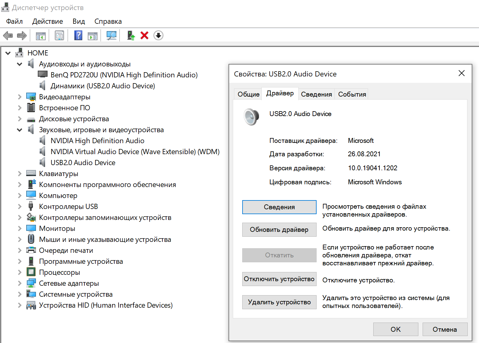

How to configure S/PDIF output in Windows
I would like to use SPDIF output of CM6631A based controller on Windows11.
I have popular CM6631A based USB sound card like:
HiFi CM6631A 32bit 384K USB To SPDIF Coaxial Optical Fiber Output DAC Board 4891652178744 | eBay
After plug WIN11 recognised only:
Some time ago I used this card in Linux and it recognized both:
I use default Windows drivers:
Microsoft, ver.:10.0.22000.1, Date: 05.06.2021
I also found (in the internet) and installed C-Media drivers:
C-Media, ver.:10.0.12.9, Date: 29.11.2016
But without the difference: still the system do not see SPDIF output.
Is there any way to configure this in Windows?

For some USB boards the SPDIF output appears as a separate sound device in Windows. For other USB board the SPDIF output appears as the same device as the I2S output (in other words, there is only one device shown in Windows). IIRC the type of board or device you are using only shows up as one device in Windows. Have you checked the I2S and SPDIF outputs with a scope when music is playing to see if any signal is there?
Yes music is playing.
I would like to use SPDIF to passthrough multichannel signal to the external AVR (AC3, DTS, etc decoder). It worked fine in Linux when I selected 'Digital Output (S/PDIF)' but in Windows 11 only two channels are passed. I don't know how to configure it and whether it is possible at all with the current Win drivers...
Windows assumes by default audio streams are PCM and will automatically resample such streams as it deems necessary. That can ruin DSD and or other non-stereo steams. Using ASIO drivers or else WASAPI Exclusive Mode can cause Windows to leave audio streams unmolested. If there is no ASIO driver for the USB device then maybe the freeware ASIO4ALL driver could help. Don't know.
See how Kodi in Linux recognise the two output of the CM6631A USB card:
The difference is deviceType (PCM vs. IEC958). The first (Default) output has 'No passthrough capabilities' the second 'Digital Output (S/PDIF)' can send streamTypes: STREAM_TYPE_AC3, STREAM_TYPE_DTSHD_CORE, STREAM_TYPE_DTS_1024, STREAM_TYPE_DTS_512, STREAM_TYPE_DTS_2048.
Why Windows can't handle SPDIF passthrough? Is it due to poor Windows drivers?

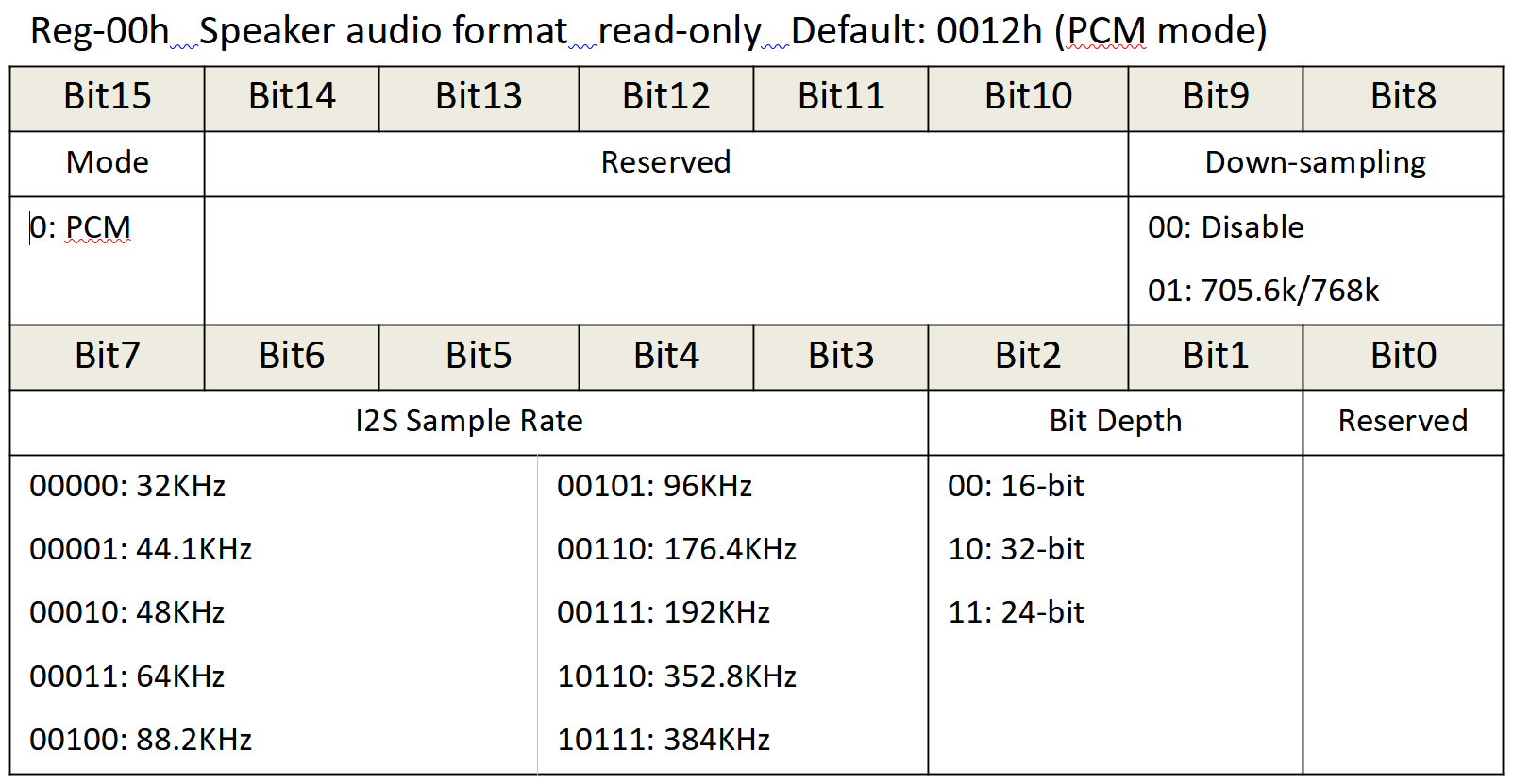

I noticed that when playing music through KODI (OpenELEC) in the corresponding CM6632A register I can see the 24-bit format. But in Windows, the format exactly corresponds to what I set in the device properties.
In the KODI settings, you can only limit the sampling frequency, but not the bit depth. What is the reason for this?
I want to clarify. When playing through KODI (OpenELEC) a 16/44.1 file, in the status register I read the values corresponding to 24/44.1.When playing a Hi-Res file 24/176, the value in the status register now corresponds to the input file. It turns out that for some reason, CM6632A in Linux always runs at maximum bit depth. In the firmware, I limited the bit depth to 24 bits. Later I want to check what will happen if I limit the input mode to 32 bits in the firmware. I suspect that in this case, all files, regardless of their bit depth, will be played in 32-bit format.

I tested it on my CM6632A development board with firmware that allows 32 bits to be played on two computers. Ubuntu 18.04 (pulse audio) is installed on one computer, and OpenELEC is installed on the other computer.
When playing a 16/44.1 file on a standard Totem player, I see 16/44.1, but when playing a 24/192 file, I see 24/48. As if there is a limit on the sampling frequency of 48 kHz.
When playing a 16/44.1 file on OpenELEC, I see 24/44.1, but when playing a 24/192 file, I see 24/192. In this case, as if there is a limit on the bit depth of 24 bits.
I have attached reports on your recommendations for Ubuntu and OpenELEC to the message.
There is only one word in the hw_params file. As far as I remember it word "closed".
I think in order to ensure bitperfect, it is necessary that the bit depth and sampling rate correspond exactly to the file being played.
