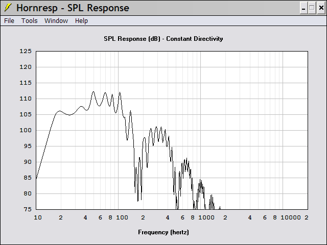

Anyway, here are the HR FR plots in 1/4 space (pi). My rough sketch build plan is based on a baffle/external wall height of 450mm.
Please note that I'm very new to DIY audio and while I'm happy with the overall result in my room, I'm sure there's lots of room for improvement. Basically I had some very specific requirements for size and frequency response, otherwise I would have just copied someone else's design 😀. I've been following this thread for about a year now, so thanks to all who posted/helped and also thanks to Mr Mc Beans fantastic software. And last, but not least I think we all can appreciate a wife that'll tolerate such an absurd room to speaker ratio! So thanks Mrs Steve71! :clown:

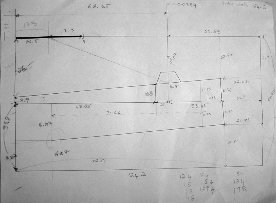

Here is the rough build plan.. sorry Brett, this wasn't really meant to be understood by anyone but me.. and even then only for a brief period. D
If you have any questions, just let me know. Obviously this build plan doesn't take into account the internal baffle thickness. And as I said before the baffle/wall height is 450mm.

Thanks for that Steve, it's great.
I can't get HR to run with Vista and won't be going to XP Pro for a month or so and have drivers, wood and a new sawbench and want to play.
Cheers

No worries mate, glad I could help someone out. I'd be interested to hear your impressions once you get it built. Have fun with the new tools.

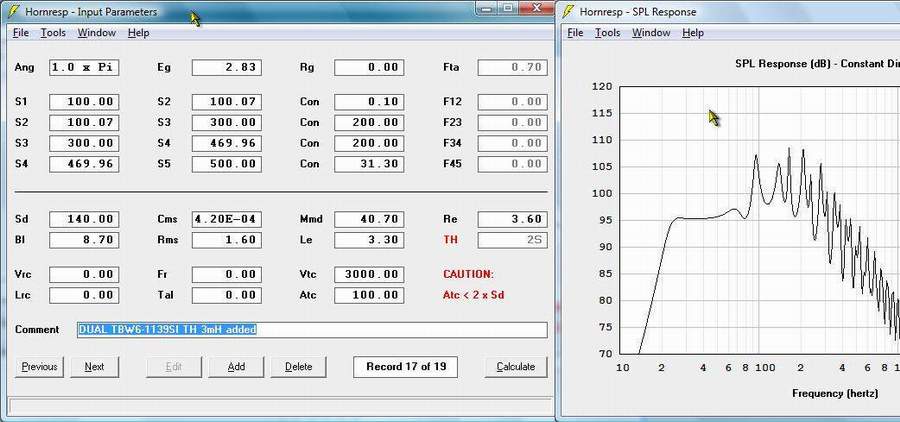

I have a few unused TB W6's, looking at JLH's PP cool design pushed me to fire up hornresp and this is what I came up with so far. My goal is to mate it to my 80hz horn.
Just wondering if you guys could critique it or check if I messed up somewhere. One thing I was not sure of is the TS specs, if anything gets doubled or halved in a PP arrangement.
SPL response is not bad for a $29 driver.

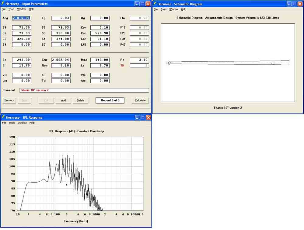

JLH, I have looked at using some Sony Xplod XS-L1036's that I have laying around not being used, and some Titanic 10's that are in sealed enclosures, but lack the confidence in my skills at using HornResp to come up with a successful design.
I played around with the Hornresp and seem to have an OK design at about 21' and 4.34 cu ft (if my metric conversion are correct). This is assuming I know what I am looking at.
It may be unbuildable and it has rather nasty peaks above 70 hz.
For fun I included my current iteration of the Titanic 10" Hornresp. I am using 2.0 x Pi in order to get a realistic guesstimate of in room response. Since this is a 4 ohm driver, what should I use for Eg to get a 1 watt approximation? The Driver TS specs come from the PE Dumax report.
Once I get past the fun of Hornresp, then comes the actual design of the box, as far as I know there are no programs to design a tapped horn with folds etc. This means pen and paper. Now I need to build it. It seems to me that I have a bunch of places where I can make mistakes along the way which may compound each other, yielding a rather large, heavy, white elephant.
I guess what I am saying is I would like to try and design and build this from scratch, but feel the chances for failure, or worse, mediocrity are great.
