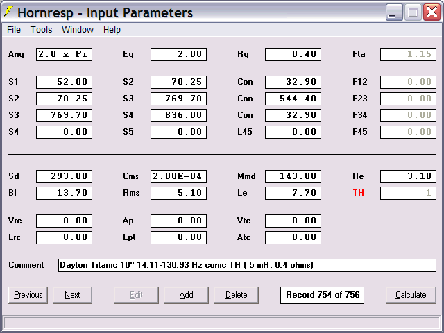

JSS said:I have a few unused TB W6's, looking at JLH's PP cool design pushed me to fire up hornresp and this is what I came up with so far. My goal is to mate it to my 80hz horn.
Just wondering if you guys could critique it or check if I messed up somewhere. One thing I was not sure of is the TS specs, if anything gets doubled or halved in a PP arrangement.
SPL response is not bad for a $29 driver.
As soon as you select Series or Parallel configuration, Hornresp takes care of all the behind scenes calculations. The only thing you need to manipulate is Le if you choose to use an inductor to smooth response. If you are using two woofers in series, then you need to split the inductance value in half and add it to the woofer’s Le parameter window in Hornresp. So, if you want to use a 3mH inductor, just add 1.5mH.
Rgs, JLH

Thanks JLH for the help and your design.
Not having built/measured any THs about all I can say is that compared to mine and others designs there's nothing fundamentally wrong with it AFAIK.
If you double click the 'Eg' field it will pop up a window that allows you to spec 'x' watts @ 'y' ohms, so inputting 1 W and 4 ohms yields 2 V.

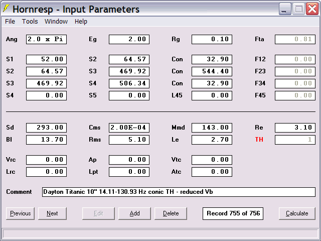

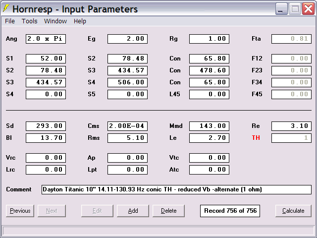

FWIW, I did some sims of this driver awhile back, all of which are bigger than yours, so are more efficient, but they will probably be easier to build than your end loaded one.
This one has 5 mH, 0.4 ohms:
GM
GM
