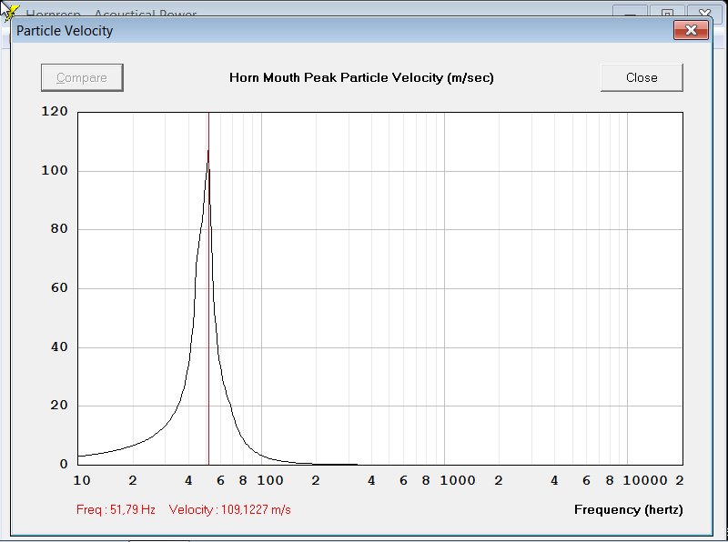

A theoretical simulation of a port trying to output enough energy to create 144 dBs some distance away does not account for the enormous losses due to turbulence both in the port itself and even more so when the very high air particle velocity and very high pressure leaving the port will mix very turbulently with the still air inside the car cabin.
Here is an example of the air particle velocity inside a typical port. 120 cm2 port area, 19 cm port length. 50 liters box size and a Cerwin Vega Stroker 10. 1000 watts and 16 mm xmax.
This is an air raid siren, not a loudspeaker.
The only thing this shows is that you don't know how to properly design a ported box.
The HR design in #263 is awful. First you have to EQ out the enormous peak 70-105db with EQ
Yes, that is one way to look at the spl response graph. Another way to look at it is that you have an enormous efficiency in the mid bass. DSP is dirt cheap and that mid bass peak is very easy to EQ flat or to your liking (seldom flat in real life use). In the old pre "dirt cheap DSP" age you always tried to tune your loudspeaker to a flat spl response. Today it is usually better to build a box that maximizes efficiency and takes great care of the driver. Room acoustics will wreak havoc with the spl response anyway.
10 times the sensitivity in the midbass just gives 10 time the headroom in the midbass and one tenth the demand on the amplifiers in that same frequency spectrum.

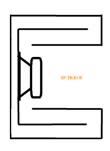

SP-TH-DCR
@ Matthew Morgan J et al
What do you think of this ?
Super Planer-Tapped Horn-Dual Chamber Reflex
Well, something like that anyway
There could be more, or less sections depending on the target goals.
Edit
Regarding the BIG peak, which would sound nasty
