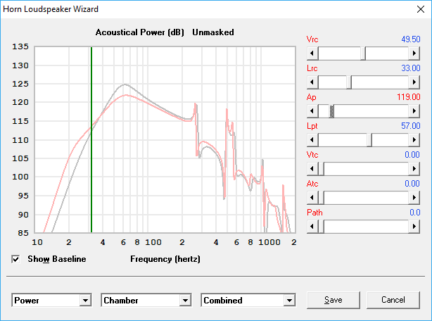

There's a bit of "theory" behind the use of high-Q drivers in car audio like that. Imagine what the response would look like with the average 12dB/oct lift below 80 Hz or so that you can get in-car...
JBL produced a series of high-Q car audio subwoofers (the MS series) with this in mind. Modelled, the drivers would exhibit a peak at 80 Hz and a rolloff below that. Factor in the cabin gain, and the output gets a lot smoother at low frequencies.

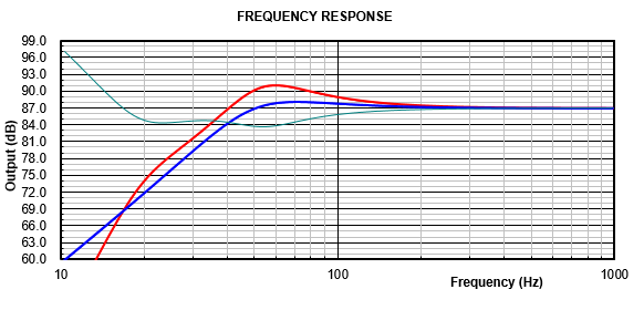

Sure, but the sim I showed rolls off way too steep to flatten out from cabin gain. I'm pretty sure the max cabin gain you can get is 12 db/oct and I don't think you can always count of the full 12 db.
There's usually also a peak at the car's resonant frequency which will peak that peaky response even more.
I'm all for measuring cabin gain and making your sub have the inverse curve so it plays flat with no eq but the sim I showed is just too extreme to end up flat.
Anyway, measuring is essential since this pic shows that cabin gain could be just about anything - sometimes not nearly 12 db/oct, sometimes bumpier than the road.
With a 41Hz Fb, suggesting that the purpose of this box is for SPL use, yes, the rolloff below Fb will be too steep. However, drop Fb to 32 Hz, and then you'll get a response rolloff that's pretty close to 12dB/octave, all the way down to 20 Hz.
Of course, no car has a perfect 12dB/octave increase in cabin gain. There will always be peaks and dips in the response. But taking an average cabin gain of 12dB/octave into consideration in the design does get you closer to a good response in-car compared to not taking it into consideration at all.
