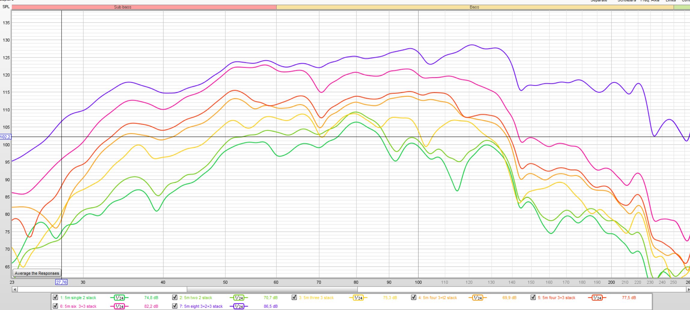

I recently did a test for the frequency response for the Paraflex TC2E-115, one vs 2,4,6,8 cabinets. outside measurement mic at 5 meter on ground. The point was only to see how multiple cabs affected response overal and not how loud. No volt calibration. only spl meter readout entered in rew which was 96db at 5 meter for the first cab. Crossover set at 35hz 24dB/BW HP and 100hz 24dB/BW LP. The 8 cab (top purple/blue line) set crossover at 25hz and 250hz.

Good to see some measurements done at large scale!I recently did a test for the frequency response for the Paraflex TC2E-115, one vs 2,4,6,8 cabinets. outside measurement mic at 5 meter on ground. The point was only to see how multiple cabs affected response overal and not how loud. No volt calibration.
With an increase from one to eight cabinets, we expect to see around +18dB gain, (+6dB per doubling) which seems fairly consistent in your test from around 50-80 Hz.
In the 35Hz range, it appears there around a +30 dB increase, +12 over "standard" gain.
Even accounting for increased mouth area (and the HP change), that seems unusual.
Any explanations?
Art
@Art and BP, like i said it was not about db's but about frequency response graph over the bandwidth. I had to adjust my mic input every two cabinets or so to prevent clipping, i set all 3 amps to the same gain level output. And sometimes I use one channel for two cabinets and sometimes one channel for one cabinet so it switched from 8 to 4 ohm. So maybe that is why some graphs are not one different levels. But like I said that was not the point of my test.
Next time I drag the stacks out, hopefully this time with some help, I will try to adjust every amp output to 2.83v and spl calibrate and output every channel to its own cabinet. Then we can do a spl/db type measurement. I also wanted to do some stacking option and cardioid setups but I was alone and was unable to handle the cabinets on my own.
