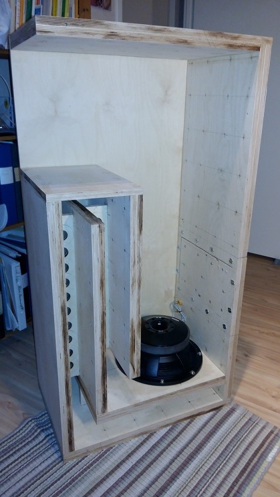

One Swedish guy who built a hometheater sub based on the ROAR concept (large front resonator) with a B&C 12TBX100 fooled his wife that there was a helicopter hovering above their house.
Even though it is tuned to 35 Hz he has a very powerful and energetic response down to 10 Hz indoors.

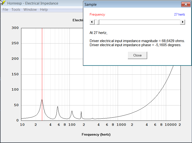

![ROAR12-IMPEDANCE.png ROAR12-IMPEDANCE.png](https://www.diyaudio.com/community/data/attachments/591/591538-e8200adbb9be6f737b9cbb8b77194cb0.jpg)
Here is the simulated impedance for my ROAR12 with a B&C 12PS100. It is tuned to 45 Hz.
The frontresonator adds a lot of mass to the driver and lowers the Fs substantially.
A ROAR12 standing in a corner indoors still have a simulated efficiency of 101.8 dB/w/m at 33 Hz.

Did the double wall construction eliminate the need for bracing around the mouth?
Yes. He had to buy two sheets of birch plywood for the (mostly) single layer plywood box, so he used the rest of the second sheet to double up on all parts of the build. I guess it is quite sturdy and heavy.

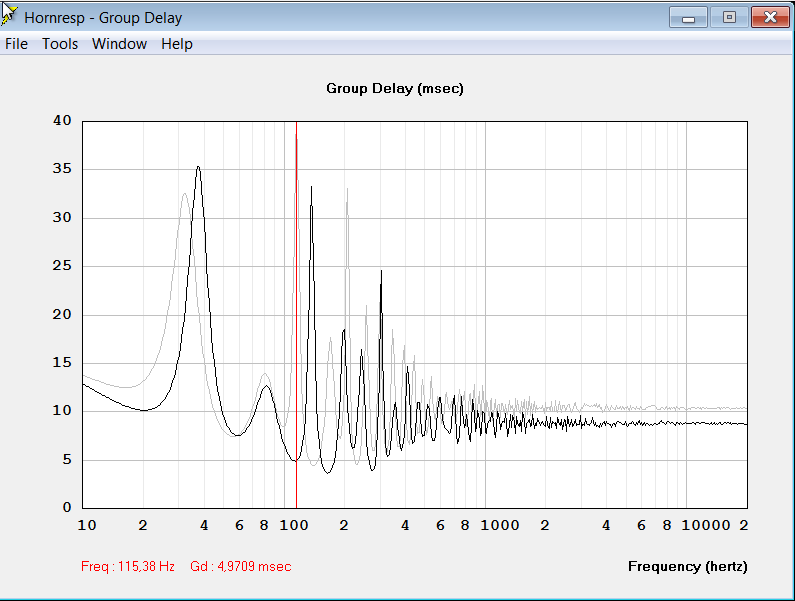

![GD-jmf-ROAR-FT30.png GD-jmf-ROAR-FT30.png](https://www.diyaudio.com/community/data/attachments/572/572337-a71a0da4afc6f0eef1c797db275c3995.jpg)
Here is the simulated groupdelay for the ROAR18 (black trace) and for the FT30 tapped horn (gray trace).
The ROAR18 has a peak in the groupdelay curve of 33 ms at 137 Hz effectively ending the useful passband there. The FT30 has a 42 ms peak at 114 Hz, effectively ending the useful passband at that point.
