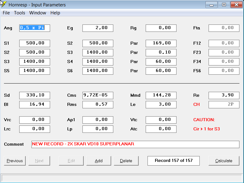

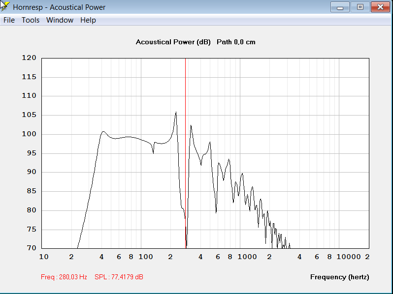

I had some requests for SUPER PLANAR cabinets that could be used in a vehicle with high excursion drivers .... We needed something that was more forgiving in regards to T/S parameters (relative to the ROAR and standard Super Planar QWP) ....
Inspired by the use of a single abrupt expansion as seen in Martinsson's ROAR i decided to try applying that to our Super Planar model and voila it gave birth to a type of Super Planar that could properly accommodate some car audio style subs and produce fantastic performance!![checked :checked: :checked:](https://files.diyaudio.com/forums/images/smilies/checked.gif)
Below are a few Hornresp model collages and a few suggested folds (but there are many ways such a thing could be folded) , notice the extraordinary output from two budget drivers.... Low Group Delay, and excursion is well controlled.... .. .... These are simulated in .5 Pi (also called 1/8th space), we used this option since i was working on a model for usage in a vehicle and 1/8th space is as close as we can get to a vehicle's cabin gain or transfer function, though still very conservative, meaning output is still not just a tad conservative but completely understated from what i gather (compared to what we would really see in the cab of a car, truck, van or SUV etc ..)
NOTE: The Skar drivers would need to be measured to verify their T/S parameters .. I am just using their published parameters here as an example..
and below we have different dimensions, ......
and once again there are a variety of ways that such a design could be folded ... Going with a split-path is not entirely necessary even though that is what is being shown here ...... Can be built using all 90 degree angles like the ROAR and many of the classic Super Planar designs and some of the old ML-Transflex designs ..
NOTE:
I realize the mounting of the dual drivers in the rough sketch concept below is not entirely practical ...It is just an idea... . A different approach would be better ..
Here (below) is a lovely 3D sketch that our friend Dustin Morgan made for us and as you can see it is drawn for a single driver but if made almost twice as tall it could easily accommodate two drivers . .
and here (below) shows the difference in output between the ROAR15 (custom optimized for the 15LB100 which is VERY hard to beat in terms of value) and this new Super Planar BLH-RLH (stepped) with dual Skar VD10 drivers ...... ............ The 1w sensitivity/efficiency (voltage adjusted to compensate for impedance) is actually very similar in these two cases and both are excellent performers but the Skars can handle more power before reaching their Xmax rating which allows them to have increased maximum theoretical output ....... ...................However, thermal power compression is not taken into account here and unfortunately that form of loss can be a big factor with these sorts of subwoofer drivers ....

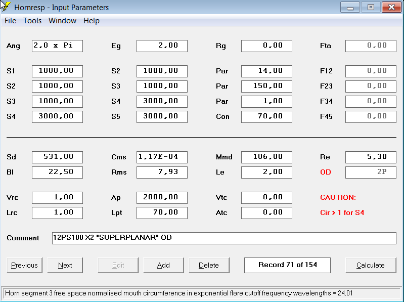

I played with your frontresonator enhanced SUPERPLANAR idea. Since I use B&C 12PS100 I had to try those. This seems like a great idea. Very nice performance.
Black line is 2.0 Pi and grey line is 0.5 Pi radiation angle.
Johannes

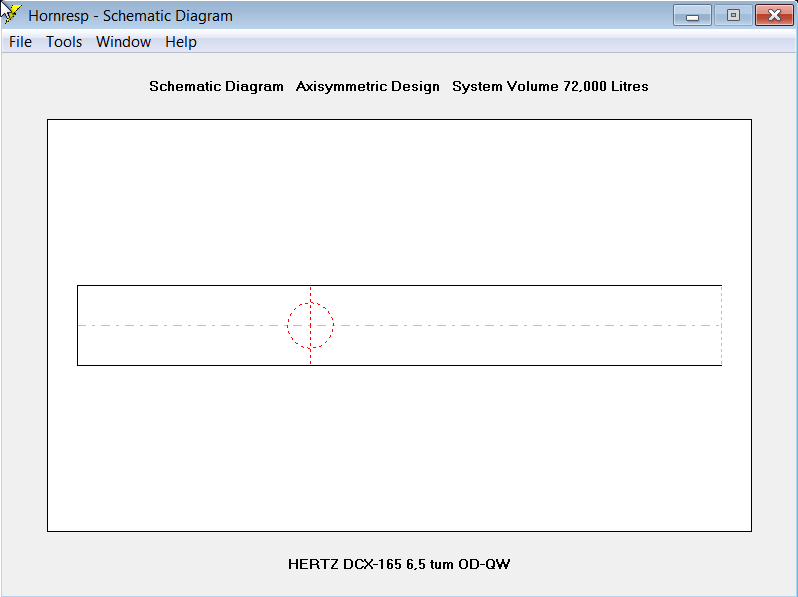

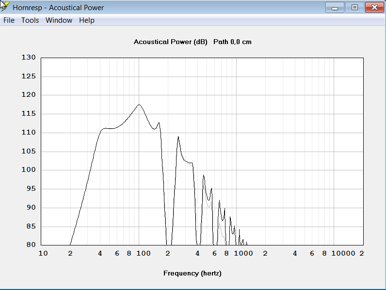

I have been playing with an extra pipe mouth resonator section to fill in the deep suckout in different OD-QW loudspeakers we are building at the moment.
![ODQW-HERTZCOAX-size.png ODQW-HERTZCOAX-size.png](https://www.diyaudio.com/community/data/attachments/582/582834-a298794f49bd1e985c96d52301be8f64.jpg)
![ODQW-HERTZCOAX-spl.png ODQW-HERTZCOAX-spl.png](https://www.diyaudio.com/community/data/attachments/582/582840-b8da0a9fbc0c0ff3d705d8304c01381c.jpg)

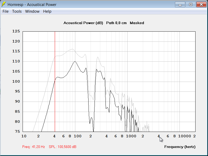

With an added section you get a smoother passband without the deep suckout. In the ROAR series I view the suckout as a good feature. In a backloaded OD-QW used as a fullrange loudspeaker it is a problem.
![ODQW-QW-size.png ODQW-QW-size.png](https://www.diyaudio.com/community/data/attachments/582/582849-4180ce21c08b8221531e4ba80bd784c1.jpg)
![ODQW-QW-spl.png ODQW-QW-spl.png](https://www.diyaudio.com/community/data/attachments/582/582856-f981fed2e0c2d274cbf594cba50d17ad.jpg)
Johannes

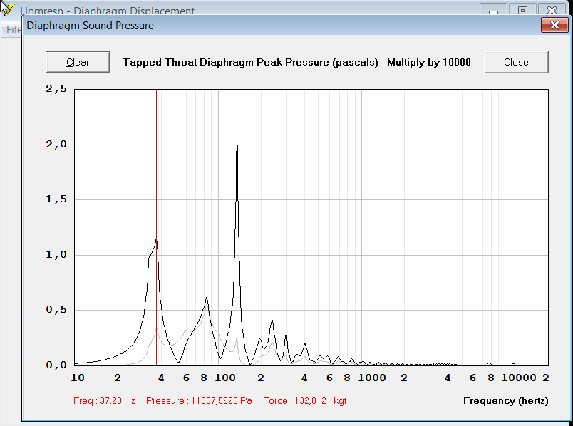

I like your "SuperPlanar" idea, but I see some drawbacks with your early layouts compared to our ROAR designs.
Since the ROAR has the tapped pipe section exit into the front resonator symmetrical around the driver you get a very efficient cooling of the driver. The large differences in pressure and the pumping action of the tapped pipe and the very sudden area expansion just around the driver acts somewhat like acoustic cooling. If you put your hand very near the magnet and cone of the driver while running 100 watts or more through it you can easily feel an surprisingly efficient cooling centered on the magnet. It is not air-movement or just air blowing through the cooling canals in the driver. It feels like sticking you hand a static low temperature zone like a freezer.
I want to encourage you to go with the split path symmetrical layout. The pressures on the cone is pretty intense.

Here is the simulated driver diaphragm pressure with 3200 watts and 12,0 mm xmax in a ROAR18.
132,8 kg peak pressure is quite taxing for 240 grams of fiber-reinforced paper. Adding some cone warping asymmetry to this peak pressure will not help the working life span of the driver in any way.
Johannes
As a side note I would like to add that 11587 Pa equals 175 dB sound pressure which puts it squarely into the non-linear acoustic domains of wave-steepening shock wave formation.

Johannes,
The thought of 130+ kilograms of weight being placed upon an 18" paper cone definitely does give me feelings of anxiety
Yikes! Scary stuff, it really is amazing that we don't shred and blast apart cones more often with these high compression Tapped Horns and Front Loaded Horn designs that are so popular .....
Intuitively it does seem like the symmetrical split-path arrangement would provide a more evenly distributed pressure upon the cone and lend to longer driver survival rates in high compression situations ...... Seems like we should have a definitive answer on this by now since W-Bins have been around for decades , and even Mr Ercegovic's CYCLOPS design has been around for several years now... It would be great if someone could abuse an 18" driver in a CYCLOPS or a ROAR while at the same time abusing the same model driver in a standard 40hz Tapped Horn with the same compression ratio, until failure occurs.... This would verify that the symmetrical loading does indeed extend driver life as we suspect that it might ..... In turn it then may inspire designers to start employing symmetrical loading concepts in their work more often ..
