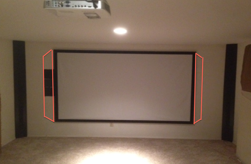

I tried to damp it using a 2" lining of denim insulation but it did not cure it fully. Finally, I just took the screen off and that confirmed the source. Because it is a long edge parallel to the line array, it creates a very strong reflection. It is fairly close to the array too.

Building a pair of deflector "ramps" for the sides of the screen would eliminate the reflection. Tempered 1/8" hardboard (Masonite) is cheap and takes paint well, you could even have the local big box store cut the strips for you no charge.Yes, I do like the screeneven though I don't use it much.

Maybe consider painting a "screen" onto the wall?

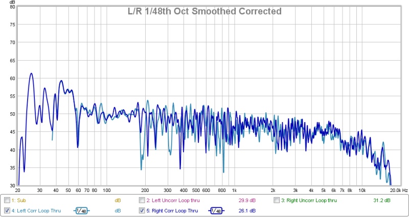

I am still in the processing of removing the reflection mentioned above and maybe it is best not to rely on the current correction supplied by DRC. Though, I have to say it sounds pretty damn good. I will post the correction when I get to the next stage. Thanks!

Very interesting that your projector screen has such a strong signature. I use an acoustically transparent (ish?) screen which now has the LCR speakers behind it as well as some broadband bass traps. I can definitely hear the difference when it is off. Now I am inclined to make a measurement.

Or even a short section of one, ala waveguide floor to ceiling to keep the highs off the walls. Can't remember were there horizontal mid cancellations too?what about a 2' x 8' x 4" or so false wall panel between each line array and the back (front?) wall so that the drivers can't see the frame of the screen
I toyed with some deflector panels. Yes, they do work! But since then another reflection got unmasked. It's coming from the non-perfect transition between the speaker edge and the wall. The cabinets are not perfectly 90 degrees, about 91-92 degrees and maybe the walls aren't flat either. After filling in the gap between the wall and cabinet with some wood strips, the new reflection goes away. So, I will be working on two things in the upcoming days.

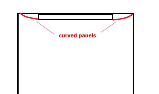

It would be nice if "wings" were symmetrical, but I guess ra7 must give up to that. Curved/oblate spheroid panel in front wall side wings all the way form floor to ceiling could be possible? From plywood or even plaster board. Side walls could be "au naturel" as they are.
Yes, naturally because the source is located inside the vertex formed with the room walls. As you have asked, I think OS would be a poor choice out to an obtuse angle because it would take the highs out with it headed for a discrete reflection per side. No, the highs are better held away from the room walls and diffracted with care in close enough proximity that the lower mids can jump off.Isn't it always?
OS is still satisfactory for training a wavefront within an acute angle but is that even necessary in this case? OS/conical, throat angle/throat size, it can be done either way with little difference to the target mid frequencies affected by the cancellation, and hopefully with little collateral disturbance to the upper mids. Even hypex could be fitted into this role.

I haven't responded to this thread recently, but, as others suggested, I have been working on deflector panels to kill the remaining reflections. They work pretty well actually. I just made some measurements last night and there are improvements. I'll post pictures and measurements when I have something substantial.
