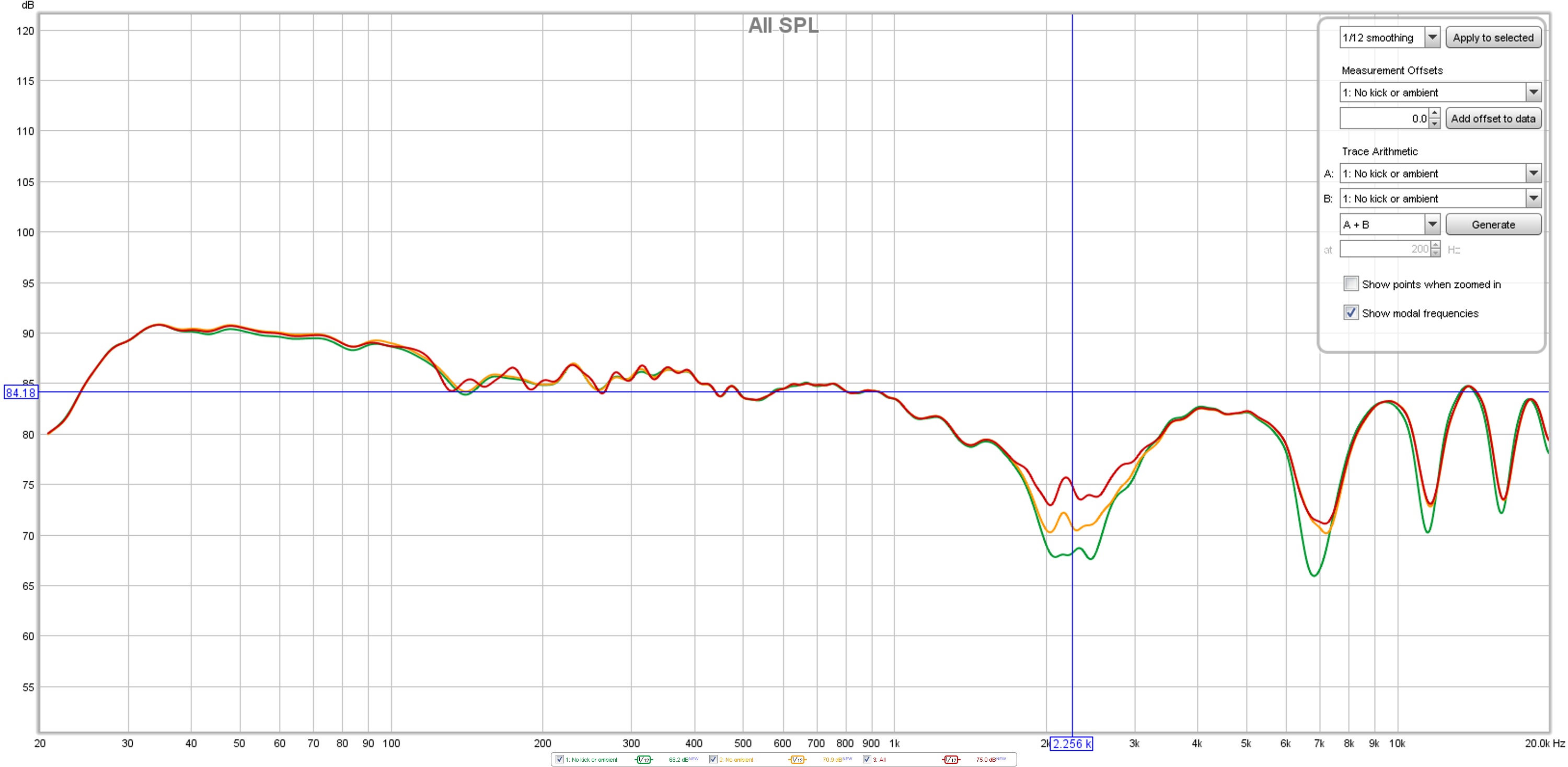

Pretty close to what Jim1961 measured in his well treated room:
(this was a simulation with a mic and something fluffy, trying to copy one binaural ear.
So not an actual measurement at the ear and we see slightly different frequencies, but the same overall trend)

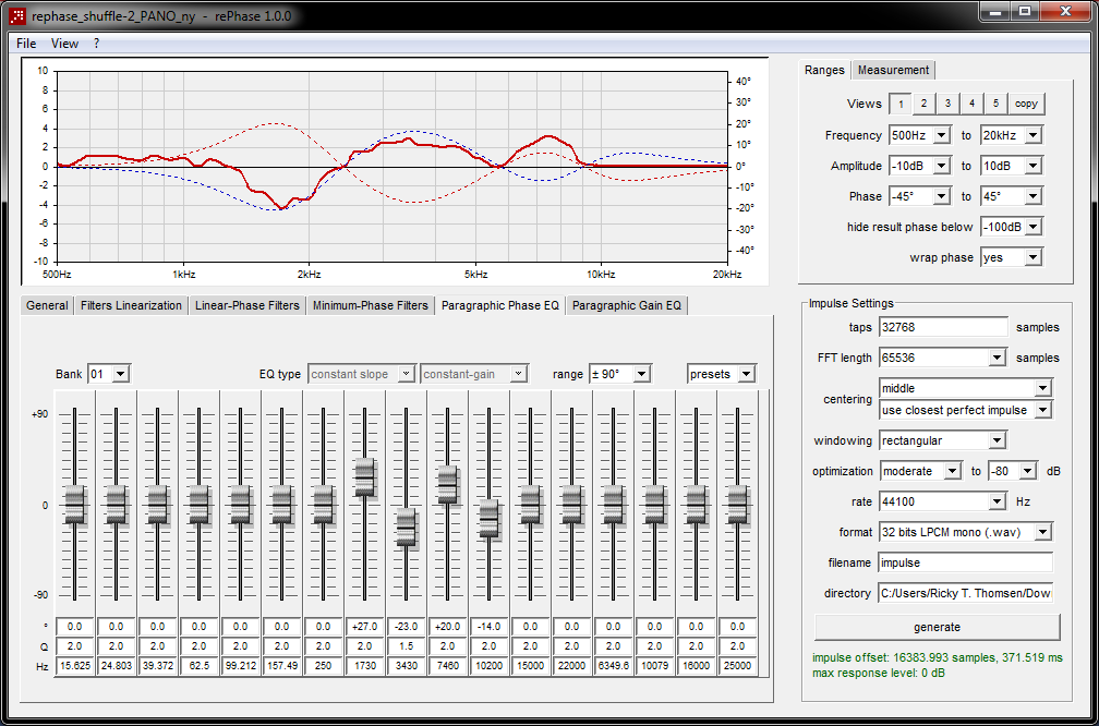

Even closer to what Toole measured from a stereo setup with an actual dummy head in a reflective room:
(pictured here beside Pano's phase shuffler)

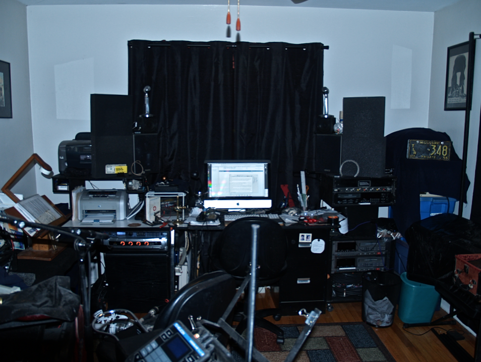

Wesayso,
1) The cross talk comes in from a wider angle in a near field set up, (at least the way I have mine set up) which makes it easier to detect R/L difference.
2) Definitely, the off axis speaker response interaction with the room is quite obvious, of course no more obvious than using your own ears.
3) In spite of noise induced hearing loss causing a deep "notch" around 4000 Hz in both my ears (slightly different frequencies) my spatial perception still seems pretty good. I do notice that while I used to be able to locate a dropped object by the sound it made, my accuracy at that has diminished with age, and the usual reduction in HF sensitivity above 10kHz.
4) I hate the "EQ Out" switch on sound consoles, spent far to much time twisting knobs that were out of circuit back in the day when I could detect 1/2 dB changes. I don't make that mistake much anymore, as I don't bother much with tiny EQ adjustments unless using test gear, in which case the screen will tell you instantly what's happening, or not ;^).
5) I'm sure we could work out an affordable rental, but I'd have to come up with another 10" high stand, the binaural head box is between two equipment racks under my right Tannoy..
Art

Wesayso,
To each is own, my preference is no room, which I get to mix in more often than not, most of my gigs are outdoors.
I prefer a room with as little reverberation as possible while not being overly "dead" up high compared to low.
If I want to add ambience to a recording, my preference is digital reverberation, which I can dial in with any "room", (or chamber, arena, cathedral, etc.) emulating one appropriate for the genre, beats per minute, or my feeling at the time.
Anyway, now that power has been restored after a 28 hour outage due to Matthew's visit, I have the option of listening to something other than headphones again 🙂 .
