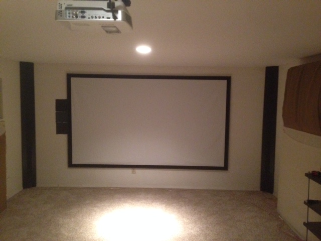

Hi RA7 - if you were to get a screen today, would you do a paint on screen? I'm considering the goo systems reference white pair product instead of the framed screen I had originally considered after reading about your null issue. Not sure if you could actually hear the difference after fixing the issue or not though so I thought I would ask what you would do if you were to make that decision again today.
Hi oneplustwo, a paint-on screen is a good idea. If you can get quality paint that doesn't degrade picture quality, go for it!
I didn't do enough testing to see if I could hear a difference. I felt much peer pressure and so I had to do something about it
But it was a pretty strong reflection because the edge ran parallel to the line array. If you did some sort of averaging measurement from multiple locations around the couch, maybe it would go away. Hope this helps.

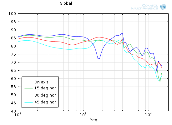

Hi ra7!
I'm trying to simulate corner line arrays to be able to design a waveguide. Your speakers are the ones that look most like what I'm planning, so I have some questions:
Whats the width of the baffle (looks like 20-25 cm)? What's the CTC-distance for the speakers (looks like 84 mm)?
Do you have any measurements at other horisontal angles? How much off-axis are you in the sweet spot (measuring point)? 15 degrees?
/Anton
/Anton

Simulation result
Hi again!
I did a sim with a 20 cm wide baffle and an approximated geometry for the TC9. It looks like this:
Blue is baffle, red is wall, yellow is centre symmetry, grey is driver membrane and green is vertical symmetry.
I'm assuming that
- the line array keeps its 84 mm ctc distance all the way to the floor and ceiling
- the membrane keeps a pistonic motion from 100 Hz to 16 kHz.
- walls are rigid
- the corner is infinitely deep (no other walls, infinite room). Equals a gated measurement before first reflection.
This is the resulting frequency response in the far-field at 15, 30 and 45 degrees off axis:
Not bad, especially the 15 degree curve.
Here is one with on-axis response as well:
Here we see that the on-axis response has a dip at 1700 Hz. I'm assuming this is due to the discontinuity when the baffle meets the wall. Half wavelength for 1700 Hz is 0.1 m, which is identical to half baffle width.
I'll be at least close to on-axis with my line arrays when sitting at the outer positions in the couch. I take it that you are far enough back in the room to avoid this?
/Anton

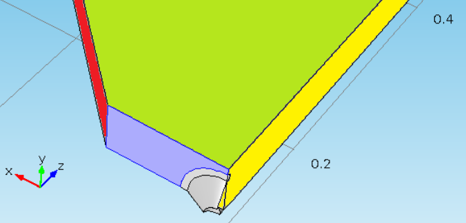

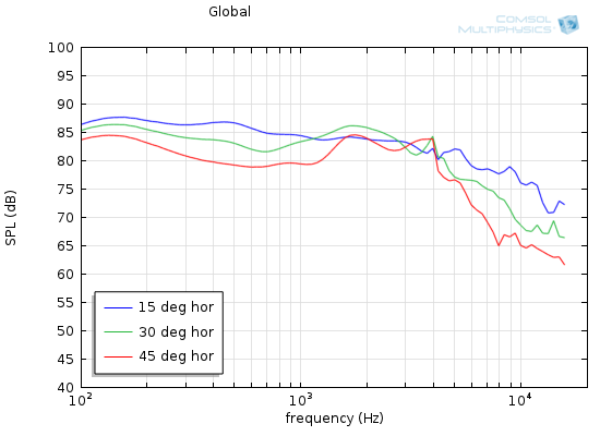

Hi again!
![602383d1488461486-corner-floor-ceiling-line-array-using-vifa-tc9-geometry.png](https://www.diyaudio.com/forums/attachments/multi-way/602383d1488461486-corner-floor-ceiling-line-array-using-vifa-tc9-geometry.png)
I'm assuming that
- walls are rigid

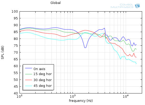

![602385d1488461811-corner-floor-ceiling-line-array-using-vifa-tc9-0-45-deg.png](https://www.diyaudio.com/forums/attachments/multi-way/602385d1488461811-corner-floor-ceiling-line-array-using-vifa-tc9-0-45-deg.png)
- walls are rigid
/Anton
Wow, excellent sims. I'm having trouble understanding your first diagram, but the sims look believable. Like I said, I did not measure off-axis horizontally. I am far enough back that I sit at about 15 degrees off-axis.
I did have problems with the baffle to wall interface and there were some reflections from it. I solved most of it by adding a thin piece of cardboard to make a sort of waveguide that went from the driver to the wall. This helped get rid of some of the reflections. Although my solution was temporary at the time, it has stayed in place for over a year, mostly because I haven't had time to look into it.
You might want to push the drivers as far back inside the corner as possible so that the frequency where you get the dip gets pushed higher. I tried hard to correlate the dip to the baffle width but I recall that it did not match.
Alright, I'll remake the sim with 15.2 cm wide baffle. The photos disagree though... If I measure the width in the photo from the first post I get that baffle width is about 2.5 times that of the driver. 84*2.5 = 210 mm. Maybe 152 mm internal?Hi Anton,
The baffle width is 15.2 cm (6 inches). I went for as small a baffle as possible. CTC is 84 mm.

What about the sim is hard to understand. The geometry?Wow, excellent sims. I'm having trouble understanding your first diagram, but the sims look believable. Like I said, I did not measure off-axis horizontally. I am far enough back that I sit at about 15 degrees off-axis.

The addition of the cardboard waveguide essentially reduces the width of the baffle to ~76 mm. I made a simulation of that:
The reponse below 3 kHz is greatly improved compared to a 200 mm wide baffle:
(I remade this sim with a more detailed geometry for the TC9).
It makes the first dip narrower and at a higher frequency, which should sound better. Moving the dip even higher in frequency is probably preferable if you want to listen on-axis. That might be possible to achieve by rear-mounting the drivers and adding a separate waveguide to each driver.
/Anton
