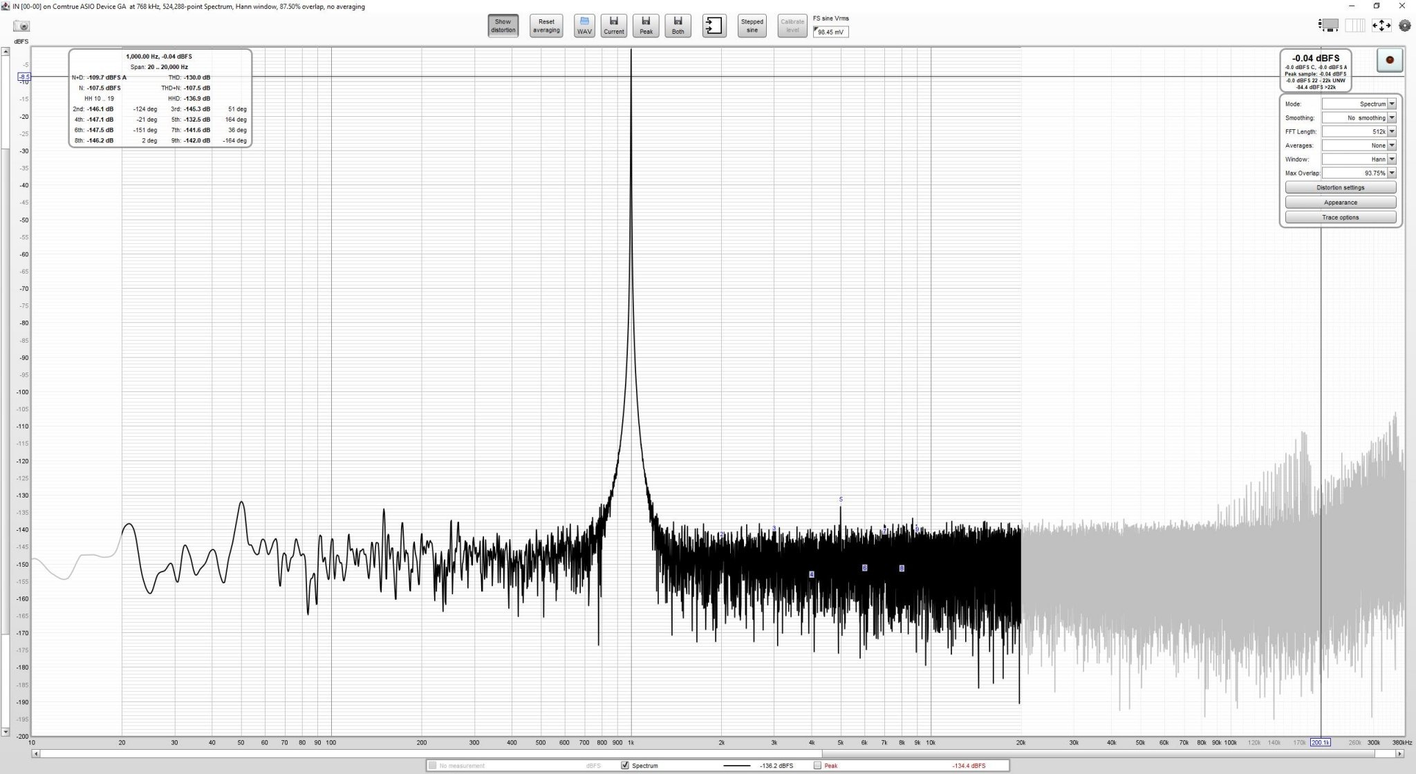

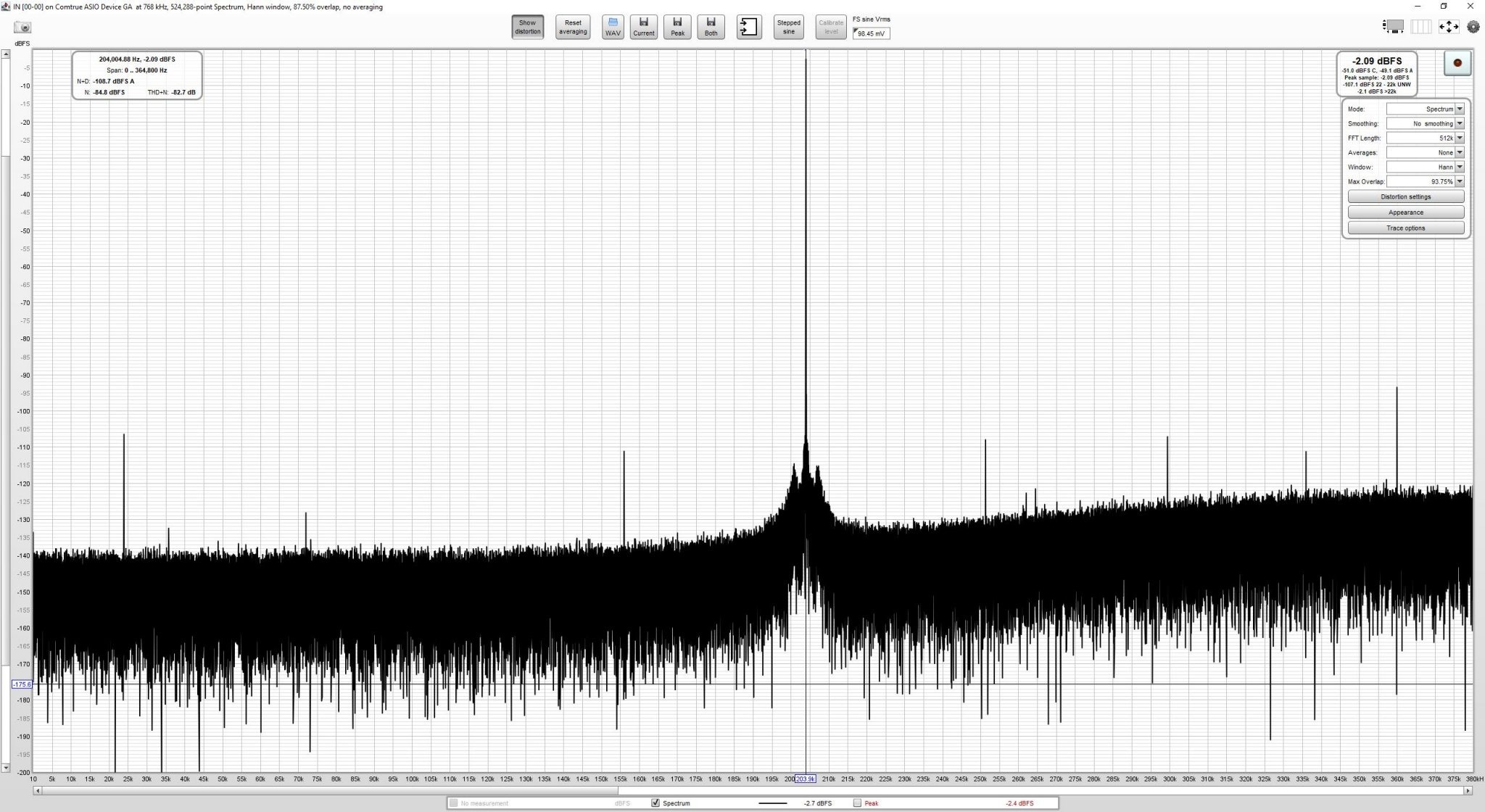

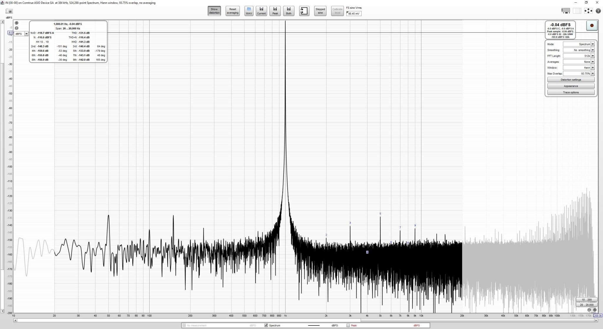

I found that just by the new FW is possible to expand the sampling frequency up to 768kHz. However, the modulation noise isn't as cool as at 384k but quite Ok for the frequency response tests up to 380kHz, with the correction file in REW(the analog input response is limited by the 1st ord LPF at 180kHz). To get 705k and 768k Fs work Windows needs Comtrue ASIO installed, that's a weird installation method found by our dear StaticV3(pls search the cosmos in our discord channel). Mac, Linux, and Android users should have no problem. The FW contains DSP RIAA as well, so don't be surprised if at the middle of the volume slider you'll get the RIAA EQing

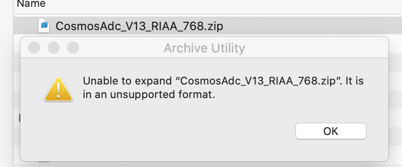

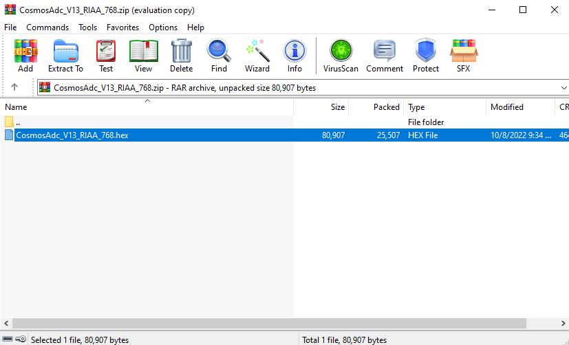

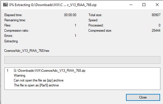

But the ZIP file is corrupt, I tried to unpack it on Linux.
Please repack the file with 7-zip, not that other SW.
https://www.7-zip.org/
Hm, here is the Cosmos ADC thread as well and nobody complained about the file, pls try to download there https://www.audiosciencereview.com/forum/index.php?threads/e1da-cosmos-adc.27038/page-34
And google drive https://drive.google.com/file/d/1IHqKmcZ6f7NlnNiRyYGV0rmsPSnynyrT/view?usp=sharing
