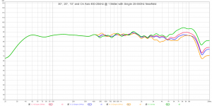

Picking up where I left off... the SPL/FR measurement was both good and bad.
After sharing the measurements with others (thank you, Mattes and Chris), I learned that I had a port/cabinet resonance problem at about 150Hz. The length of a 150Hz sound wave is 90 inches, and the internal height of the cabinet is 45 inches (1/2 of the wavelength) which means that stuffing the middle of the cabinet (1/4 of the wavelength) just until the resonance no longer appeared in the graph may work to correct the problem, albeit at the expense of some precious bass output.
This is an old measurement pulled from a prototype driver version, but taking a 1 meter full range measurement (in black) and overlaying it with a nearfield measurement at the port mouth (in red) shows that the problem also was at or near the fundamental output of the port.
http://www.kensonger.com/field_coil/br1/left_nearfield_plus_port.png
So, another option to correct the problem may have been to move the port location.
A third option is an Internal Helmholtz Resonator. That can be either a ported box internal to the speaker cabinet that is tuned to the standing resonance frequency, or it can be a barrier layer median to the inside of the cabinet with a series of holes of the right diameter drilled through it in a specific, calculated grid pattern.
The IHR will eventually be the gold standard solution in my loudspeakers, but for the short term I've found that minimal stuffing of the cabinet at the midpoint has resolved the problem admirably, even if I did expend 2dB of SPL below 100Hz in trade. The difference in clarity and imaging has been a clinic in critical listening. It's so much easier to identify the artificial 'thickness' of cabinet/port resonances in a speaker after having first lived with it for months, and then suddenly having had it removed it from the presentation. I can see why some designers deliberately design for a resonance that they find desirable, too - that 'thickness', particularly in the vocal range, has a certain panache to it. I thought I'd likely be one of those 'panache' guys, subscribing to the idea that the speaker itself is the last instrument on stage... but, it turns out that I'm not after all.
What I still don't understand is how the trained eye initially identifies a cabinet resonance among room effects and other artifacts. For example, this is a measurement with the last prototype driver in cabinet that shows the 150Hz resonance:
http://www.kensonger.com/field_coil/br1/left_frequency_impulse_response.png
If anyone would like to offer insight on the topic, I'd love to learn more.

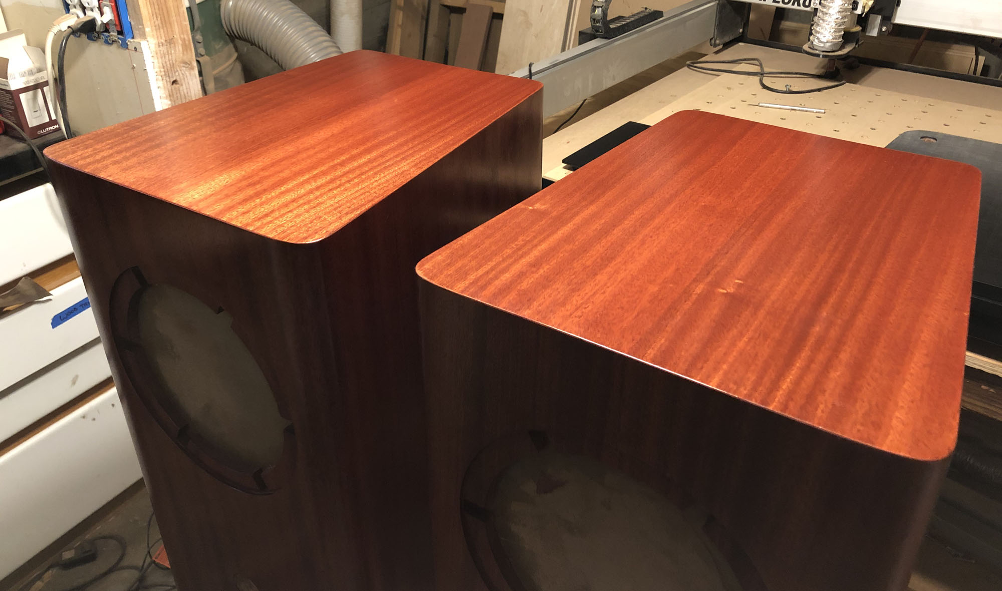

The first finishing step is staining. For these cabinets I wanted a rich, warm mahogany color. The final shade that looked best to me was a diluted blend of vintage cherry and empire red dye stain from General Finishes:
http://kensonger.com/field_coil/stain.jpg
Sapele mahogany is an open-grained wood with fairly large pores. For woods like this, the next finishing step is to grain fill it. I chose a crystal clear, non-toxic water-based product that wouldn't interfere with the natural appearance of the wood itself. Once dry, it's sanded gently back just to the exposed wood, being careful to leave the filler in the pores and not sand through into the stain.
The next step is three coats of shellac, to seal the stained wood and impart depth to the grain and a nice golden hue. The beautiful chatoyance in the mahogany really starts to show (you get a sense of it in the front corner of the furthest cabinet):
http://kensonger.com/field_coil/shellac_applied_tops.jpg
For a durable top coat, lacquer is my favorite choice. I apply six coats of Deft, and after curing for a couple of days it's ready to be rubbed to a final satin gloss. That's done with a piece 0000 steel wool, saturated with Murphy's Oil Soap. Pictured below after that step, the bases are sitting on top of the cabinets, and the unpolished brass accompaniments dropped in place just to see how it's all shaping up so far:
http://kensonger.com/field_coil/ready_for_brass.jpg
As you'd imagine... by the time these were complete (particularly, made in such humble accommodations) I couldn't wait to listen to them. And, to turn my attention back to the less physically taxing matter of taking the final steps to perfect the speaker response.

Around the time that last picture was taken, I circled back to the prototype drivers to decide on shorting rings. A shorting ring for those of you who haven't heard of them, is typically a single shorted turn of copper or other conductive metal. It's either a thin sleeve in the magnetic gap, or a somewhat thick ring just above or below it. The effects of the ring are to flatten out rising impedance in the upper frequency range, which improves treble performance, and to reduces voice coil inductance modulation, which in turn reduces distortion.
I went with a thick shorting ring below the gap, attached to the pole piece. Measured in DATS however, I didn't see any effect on the impedance curve. I can't explain that, unfortunately... theories are welcome. In cabinet on the other hand, the effect on the sound was easy to hear. The image was sharper, and detail retrieval was simply amazing. It was definitely a little too bright, too, but a brighter presentation may just change where and how much attenuation was needed for the BSC circuit.
Confident of the improvement, I added shorting rings to all of the production drivers as well, and... they didn't sound good at all. The first listen was in the final cabinets above, in a spacious room with reasonably good acoustics. Where the prototype driver pair had sounded a little too bright, the production drivers were searingly bright. They were too bright to listen to for more than 30 minutes or so before experiencing ear fatigue - none of the past versions has ever caused that. I spent quite a few days thinking it over, trying to figure out why two drivers that seemed so identical could sound so different with the same modification.
The only difference I could think of was the surface treatment on the motors. The prototype driver motor was just polished, bare carbon steel. But steel even under the best of circumstances will eventually rust; so, for the production drivers I had a fairly thick bright nickel plating applied to them inside and out. The only part of the motor assembly free of the nickel plating was the gap.
Nickel is not as conductive as copper or aluminum of course... but it certainly does conduct. And with that in mind I started to think back upon a comment I read some months prior from the esteemed driver maker Haruhiko Teramoto, which at the time I must confess I dismissed as a bit ridiculous. In discussing the surface treatment on his latest drivers, he claimed that different finishes on the steel altered the way the driver ended up sounding. He ended up choosing a special kind of lacquer.
Maybe he was right after all... and in any case what he said has provided me with a theory. The nickel plating covers the entire motor and when I think about it's geometry on the surface... it's actually a big, shorted ring of conductive metal. It gets better: there are two of them. One of them is of course on the exterior of the motor, with it's effective inner diameter being the gap, which has no plating. The other is on the inside surface, likewise covering the entire surface of the steel and terminating at the gap. And that, as crazy as it may sound, is why I think the production drivers are both brighter and more detailed than the prototypes are. They already have shorting rings of a sort, both above and below the gap.
The last variable that I can see in my experience with and without shorting rings is the manner of amplification - I'm using a tube amp. These speakers really shine with tube amplification, and that makes a good deal of sense for a highly self-damping field coil driver. But also of importance, tube amplification power is directly proportional to speaker impedance. Conversely, in a solid state amplifier power delivery is inversely proportional to speaker impedance, and therefore power decreases as the speaker impedance rises. With that in mind, it seems plausible that drivers with shorting rings make the best sense for solid state amplification (and, may not at all for tube amplification) because they improve what would otherwise be falling treble performance as impedance rises and solid state power decreases right along with it. I'd venture further to guess that for optimal all-around performance in a solid state system, a multi-way speaker further improves design opportunities for tailoring a balanced response. If all of that is generally accurate, then it likewise could follow that in the case of a point source full-range field coil loudspeaker, tube amplification isn't optional... it's all but a necessity.
