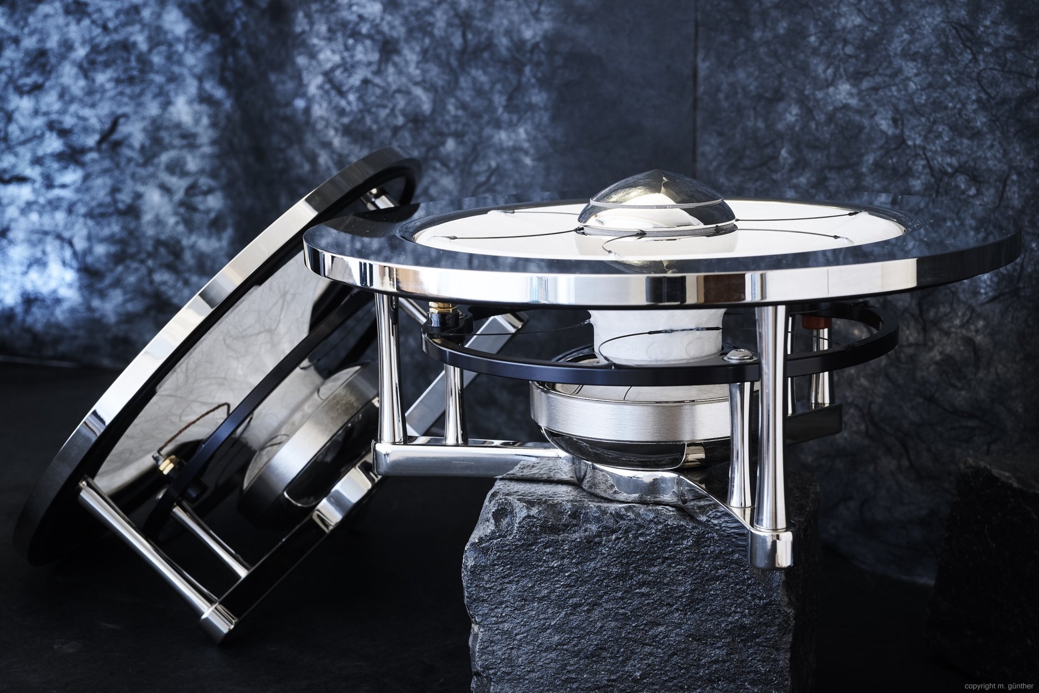

Hey @rhythmsandy -
While the field coil motor is very strong, mass still matters a great deal for a full range driver like this one. As an illustration, the 1.4 gram difference between the CCA voice coils and the older copper versions is more than 10% of the total moving mass. That weight savings has been instrumental in getting good frequency response in the last octave, along with a faraday ring integrated into the base of the aluminum phase plug. In my experience, transducer weight is the most important factor above 10kHz.
The change in Qts is very important as well. If you have a box modeling software to experiment with, try changing the Qts of the driver in one of your single driver designs from .18 to .43. You'll see that it makes an enormous difference with respect to bass response.
So what happens if we use 0.18 Qts driver in open baffle? will there be a hump in response at the lower part of the spectrum?
Very impressive production.
Your vestigial spider is a really imaginative invention. But..... I thought the spider in conventional drivers was the good-guy for providing spring action that is linear compared to the non-linearity expected from half-round rubber surrounds?
The critic said the magnetic field is "thousands" of times stronger than a permanent magnet. What would that be in terms of Bl product or other familiar metrics? After all, folks at DIYaudio are, I am certain, immensely interested in your magnet force and other advantages of a field coil.
Ditto for the moving mass of the cone assembly.
The write-up had no REW or other acoustic measurements. Again, that just doesn't cut it with the measurement-happy crowd around here. Can you please post FR, distortion, and similar parameters that matter to us.

Hey @bentoronto,
Yes, the reviewer made an error there - what he should have said was that the magnetic field is hundreds or thousands of times "stiffer" than a hard magnet, depending on the material that is used. That applies to any field coil, and isn't any special invention of my own - it's simply a reflection of the fact that an electromagnet can achieve very high permeability, because it can reach saturation of whatever the material in question is. In the case of low carbon steel, permendur, iron etc that is a comparatively very high number, which results in a very high degree of control over the moving mass.
You do of course want the greatest degree of linearity possible, however if somehow that could be achieved in the absence of a surround and spider entirely you'd have the ideal circumstance for a dynamic driver. Check out Ilumnia - they do fascinating work in that regard. Anyway... in my view, the goal of the spider should be simply to center the voice coil in the gap, move in a highly compliant and linear manner, and to otherwise be as absent as possible. I'm not sure what you meant regarding the rubber surrounds, I apologize...
If you look back a bit in this thread, you'll find FR, distortion and off-axis measurements, although they are from a past iteration of both the driver and S1 speaker. It's come a very long way over those three years... although, my posts here over that time have been quite infrequent.
Posting measurements certainly takes on a different character for me now, than it used to. That's surely a good topic to expand upon here some day. In any case, if you'd like to see something specific I am happy to share.
Thanks for quick reply.
Magnet explanations are over my amateur head. Since this is the single most important feature, can you please explain more. BTW, the whole matter of horsepower or force or don't-know-what is badly handled in the audio world. My guess is that another parameter really matters and that is something like "degree of control in proportion to the weight of the cone assembly". That would combine Bl and cone mass and would also permit comparison to motional feedback ("smart") control.
You have to have a force restoring the cone to normal position. If the vestigial spider isn't serving that purpose for you, what is? Do I see you have a 29 Hz resonance in the link? So some spring of almost conventional force is present.
I'll look for those old FR measurements you mention. But any buyer with $35,000 to spend might want to see measurements of your latest offering.

Yes, there are two important qualities regarding the magnetic material - limiting it to just the nature of the magnetic field in these comments. Of course the first is the strength, measured in the gap. This driver at maximum recommended current generates a field of about 1.7 Tesla, just a little shy of that - it's quite strong. The other quality is permeability, and the lower that number is, the more elastic the motor control in response to the AC signal running through the voice coil - and that elasticity of motion manifests as a form of distortion. An interesting example of how the two qualities may counterintuitively vary in a material is neodymium, which carries the potential for an even stronger magnetic field, but has a very low permeability - it's no better than ordinary ferrite in that regard, around a 1μ. Alnico is higher, coming in typically between 5-7μ. However, saturated low carbon steel is in the neighborhood of 2000μ - vastly higher - and that means that the accuracy of motion is correspondingly high.
You know, I'd actually say that the governing factor in my driver is that it is a large, full-ranger with a whizzer cone with unusually high compliance and low mass, and not that it's a field coil. Turning to analogy, while it is true that reinforced concrete is a stronger foundation to build upon than gravel, it doesn't follow that the more beautiful or lasting structures will be built upon one, and not the other - there are so many amazing loudspeakers in the world, and only a handful of them use field coils. I have heard some that suffer from any number of subjective deficits... shrill, shouty, thin, fatiguing, etc. I've also heard some that were, at least for me, astonishingly good. In each of those cases, the field coil was only a part of the whole story.
Indeed, my spider is definitely acting as a restoring force - in fact it's holding the entire moving mass in light tension. Crazy as it may sound, I have found little or no need for pistonic restraint from the spider at all, other than in the sense that the underhung coil must at rest sit in the middle of the gap. If I could somehow at this moment do without the spider, I would - and, you can bet that I spend a lot of time thinking about how. I place all of my trust in the motor, and at least so far, that philosophy hasn't let me down. The free-air resonance of the current driver after a day of break-in is just 17Hz - I'm surrendering as much of the suspension control as I can.
In those older measurements in post 23, bass was measured nearfield right at the phase plug, up to 600Hz. The rest of the range is measured from a typical listening position across a 30° listening window. The better way to have derived that part of the range (and, how I do now) would have been from 1 meter across a 30° window. You're right about the resonance @50hz - it was the result of a poorly considered design feature of the interior cabinet which, naturally, had seemed genius to me at the time. You're right about the distortion, as well. I shoot for 1% or less until I'm south of 100Hz, and aside from a few tiny hiccups here and there my best efforts can get to 60Hz or so before I'm over that figure.
I'm torn about sharing measurements these days... it's a topic that I could and still may write about here, at length. They are the essential foundation of sound decision-making, effective troubleshooting, voicing and so on during development, and yet not the final arbiter of what the subjective listening experience will be, for any given individual. What's more, while you bring obvious acumen with you, many do not... and the idea of litigating the more narrow views on the topic in a forum thread... ugh. What you may find surprising is that the buyer with $35k is usually what I'd describe as a music lover, and not an audiophile. In any case, I'm thankfully wise enough to know that hiding any real defects I find in measurement is of no value. And conversely, I love hosting people for listening sessions - it's wonderful to watch people react to the work, especially those that have never experienced a well-made field coil driver. Exhibiting at shows this past year was a joy.

Loudspeaker motor especially in fullrange applications are very sensitive to the magnet gap strength. For example 12g 8inch cone construction, with more winding will create higher Bl as the magnetic gap strength increases. As a result when the magnetic strength increases, the frequency starts to form an incline shaped responses with the mid/high range starts to becomes louder than the lower half.
A field coil allows the fine adjustment to set the sweet spot for the gauss level.
Fix magnet motor don't have the luxury to do so, and it is a lot of effort trying to design using alnico or neodymium to get that prefect range which prevent the driver from behaving like a maniac. And every builder has a different design for enclosure, different baffle size and so designing a motor with one size fits all will be a challenge. So an electromagnetic comes in handy.
